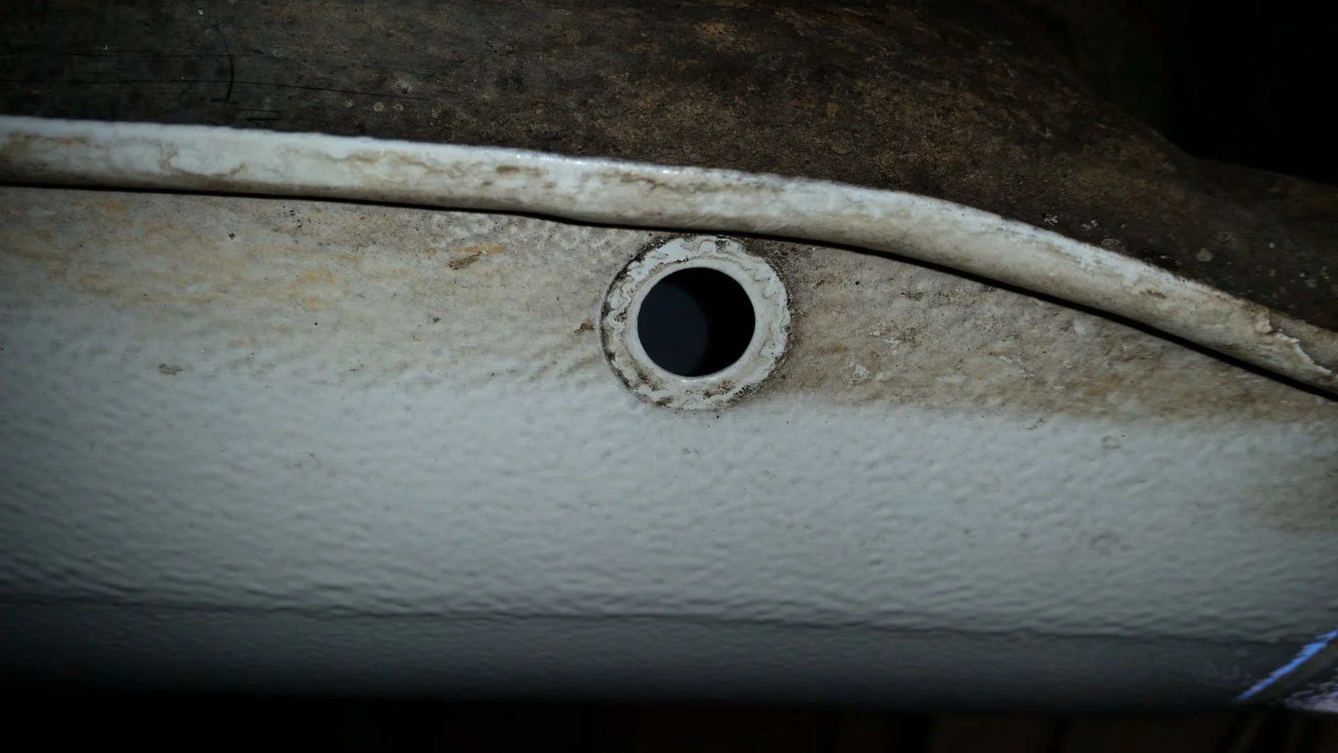

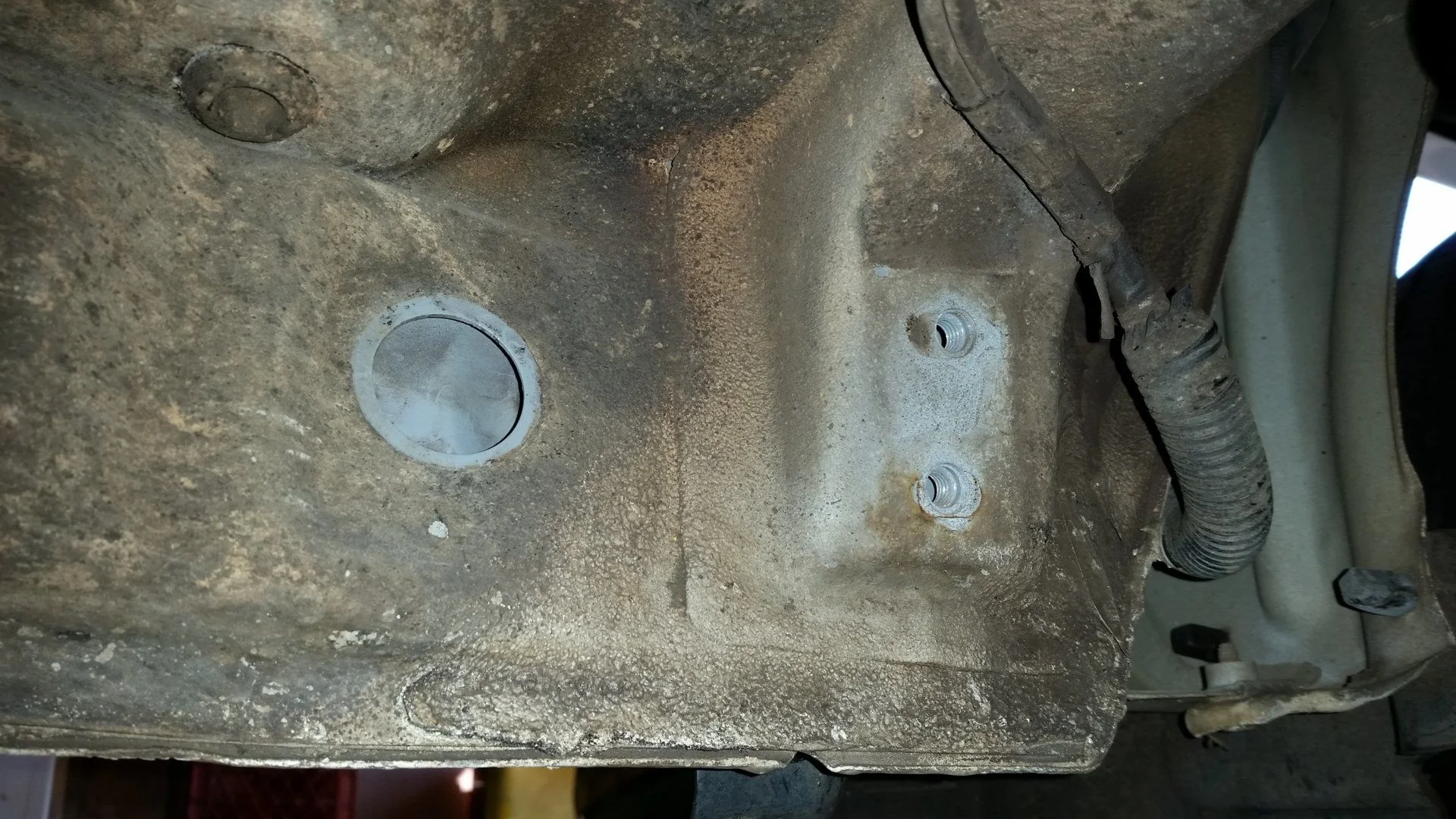

In my experience, the drain hoses rarely become clogged. What does happen is that the rocker panel drains get clogged, and the air pressure builds up in the drain hose when the pan is full of water. The first step is to verify that your pinch drains are clear.
Then move to the hose. Check your pan (you'll need to remove the wind deflector; it's a couple of screws) and make sure it's very clean. If it's not, help yourself out.
Pull the first three (from the front) rocker panel plugs.
These plugs are below the pinch drains.
If there's water in there, it'll drain out. You may also need to remove one or two large plugs, to allow air to escape.
I've removed my running board, to make access easier for me.

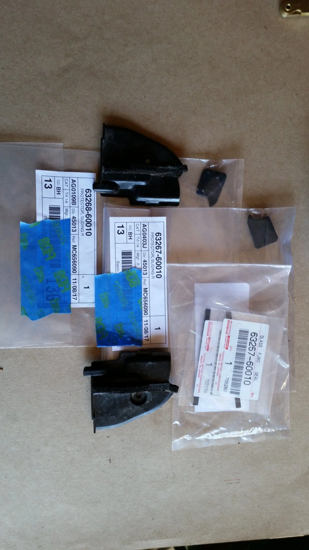

The system is designed to exclude dust and allow water intrusion. It has two primary components: the sunroof seal and the drains. The sunroof seal is not removable (unlike the 100 and 200 series; Mr. T did learn something) and requires a couple of parts which aren't obvious.
The strips are wedges which are inserted into grooves in the corners of the sunroof seal. The other parts are mounted in the pan and serve to deflect water into the drains. If all these parts aren't in good order, the system fails and the sunroof leaks.
The rear drains, which are used only when the front if the truck is pitched upwards, discharge through the inner fender, behind the wheels. The front drains discharge into the pocket, behind the kickpanel trim. From there, once the pocket, or well, fills up sufficiently to escape, the water flows into the rocker panel. If the system works properly, the water then discharges through the pinch drains. When it doesn't the wells fill and discharge onto the floorboard.

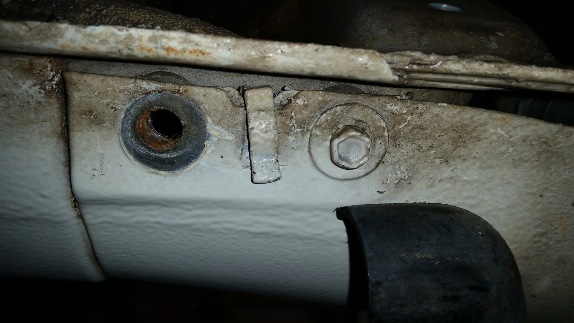

The long term solution is to remove one of the two outer fender body screws and enlarge that hole. (You could argue that two screws are necessary, but this is the only corner with two screws) The choice was made for me. When I attempted to remove that screw, the weldnut (on the reverse side) broke free, due to corrosion resulting from lack of adequate drainage over time.
Replace the existing front drain hose with a rear hose (the front one is too short for this fix), and route it through the new hole, using the grommet for the rear hose. This is the rear drain design. This way the water has safe exit and will never fail to drain. It also ensures your rocker panels won't rust out.

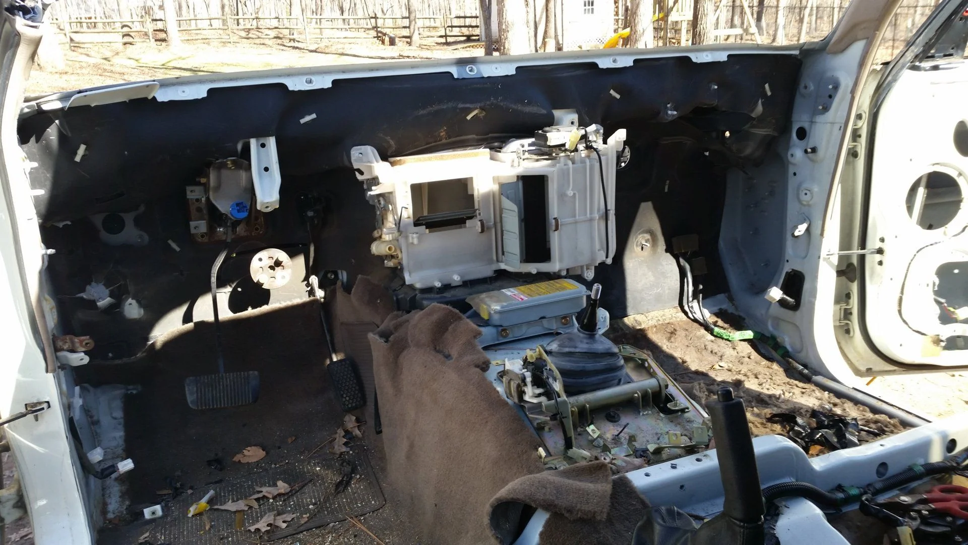

This is what your heating system looks like:
The heater core is on the right side of the white box. If it leaks, it'll leak coolant onto the passenger floorboard. It may leak onto the driver's side, but the primary mess will be on the right.
