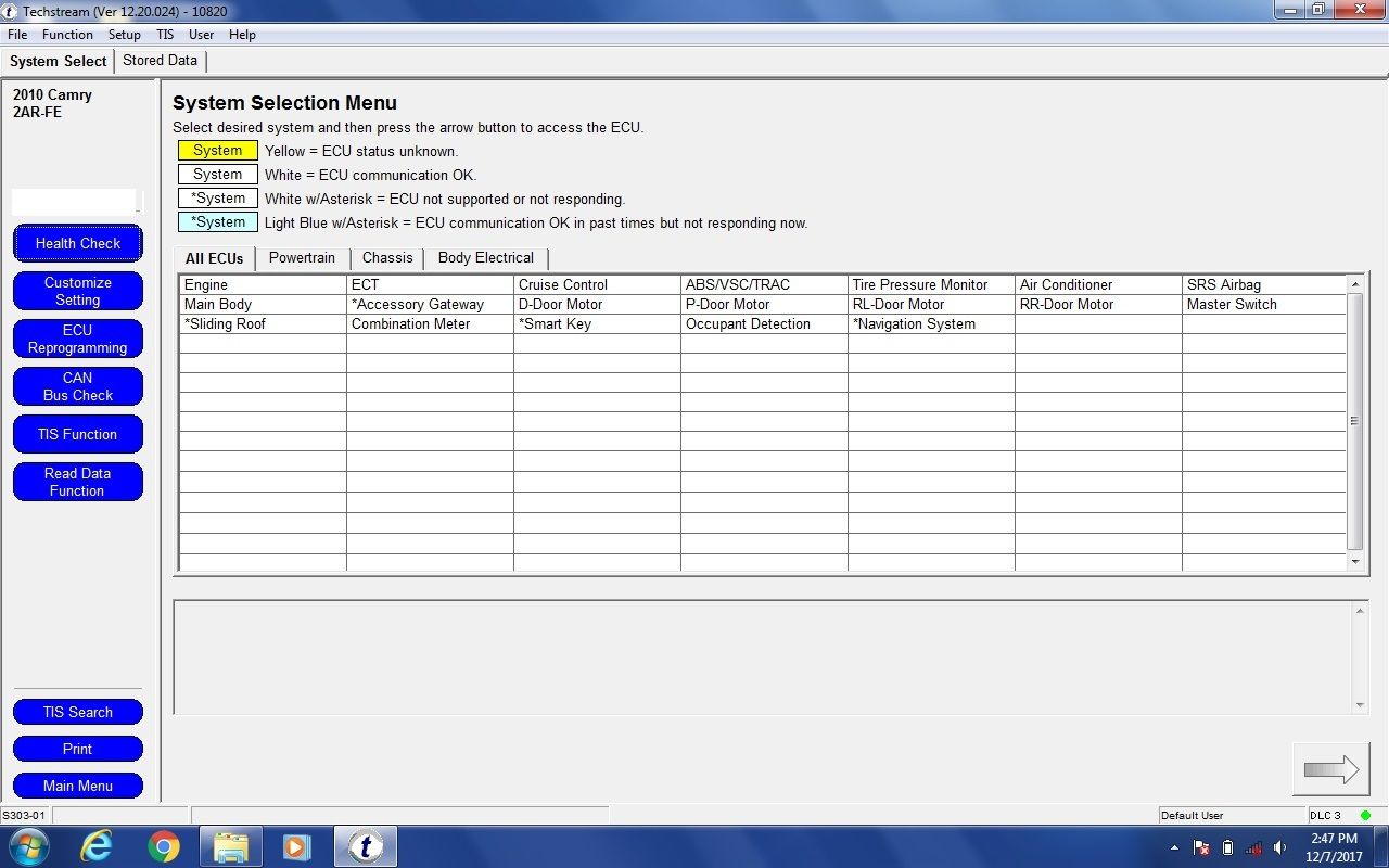

Thinking I had solved all my problems, I went back to the Cruiser and added power to the Hub from a USB/cigarette charger. Noticed I now had the red light at the OBD port and I was pumped! Still, no joy. I gave up at this point for the day, which really had been a 2 day process by now.LBridges. I appreciate your advise. Luckily, after hours of playing around with it, I've finally found out why Techstream wasn't fully functioning for me. It was by accident and is something I never thought would be an issue. The reason is because of the sequence of my installation of Techstream in relation to the MVCI Driver & Cable. Here are the steps I took to initially install Techstream onto my Dell D430 laptop running W7-Pro:
***What didn't work***
1. Installed the Techstream (installed version 12.20.024).
2. Installed the X-Horse MVCI driver software (which also contains the driver update tool)
3. Changed the Main.exe hack file.
4. Turned on TS for the 1st time, entered Location, User information, etc.
5. Then I entered the registration key and it successfully activated.
6. While still inside, I went ahead and plugged in the MVCI cable, then opened the X-horse update tool to check the cable to verify it was fw v.1.4.1.
7. I went out my car and plugged the cable into the OBD port and then laptop USB.
8. Opened TS and I noticed it's no longer activated, which I thought was weird but didn't think much of it.
9. I then entered the registration key again and TS is reactivated. No problem I thought.
10. Continued on TS and connected to USB, when it reached the SYSTEM SELECTION menu, the only buttons I have on the left column are TIS FUNCTION and READ DATA FUNCTION. Nothing else, which is useless for me since I needed to check my TPMS sensor parameters and do some customization. I uninstalled and reinstalled everything again multiple times with the same results.
***What ended up working***
1. Installed Techstream
2. Installed X-Horse MVCI driver software.
3. Swapped the Main.exe hack file.
4. Turned on TS and entered Location, User, etc...but did not activated it.
5. I went to my car, opened TS, then plugged in ODB and USB. Windows automatically prompted for the cable driver to install.
6. Clicked on "connect to vehicle", TS popped up and asked for the key. I then entered the key and it activated.
7. Pressed continue and the USB connected to ECU. It recognized my car model, year, vin number, etc.
8. When TS entered the SYSTEM SELECTION menu, everything was there (ie. Health Check, Customization, etc.). See the results of my screenshot below.
Apparently, after I changed the Main.exe and completely activated Techstream, I thought it was ready to go. However, when I later installed the MVCI driver software, then immediately plugged in the MVCI cable for windows to install the driver, the cable/driver installation process somehow screwed up my "hacked Techstream", which also caused the 5000 day activation to disappear (step #8 above); as a result, I ended up with a crippled version of TS. Re-entering the activation key after this point didn't help either since the software is tainted. What I've learned is to NOT plug in the cable immediately after installation, but wait until you go out to the car, then plug in the OBD cable. When you press connect, it'll pop up and ask for the key, this is when you enter the key to activate, and then continue on to connect to ECU. Whew!
