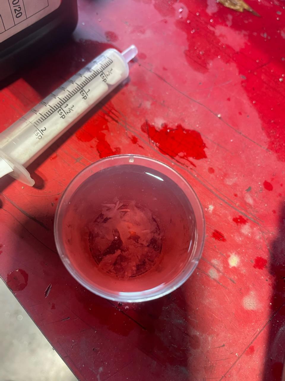

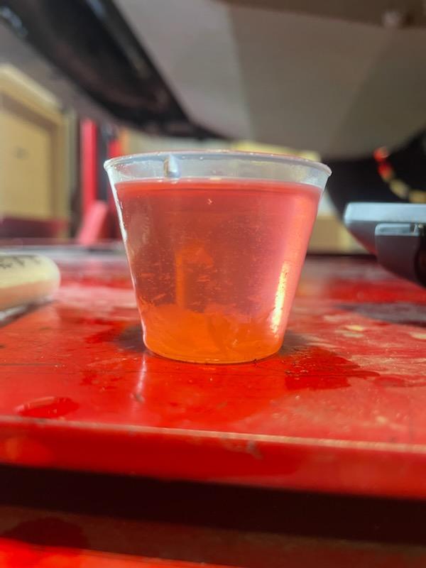

Same here. Bought a 1l plastic bottle from a Toyota dealer and after adding fluid, noticed this. Now AHC would not raise or lower. Dealing with dealership, Corporate Toyota and Corporate Lexus was a waste of time. Dealer wanted $4,600 to replace. Removed AHC and went with Dobinson IMS.

Damn dude you rage quit on AHC? lol.
@Madtiger come collect your reward.
At least get compensation man, there is plenty of evidence that this is their fault and youre performing recommend maintenance by the book.

Everyone I spoke to was, "We have never heard of that happening" I needed heavier springs anyway, so it grip it and rip out
