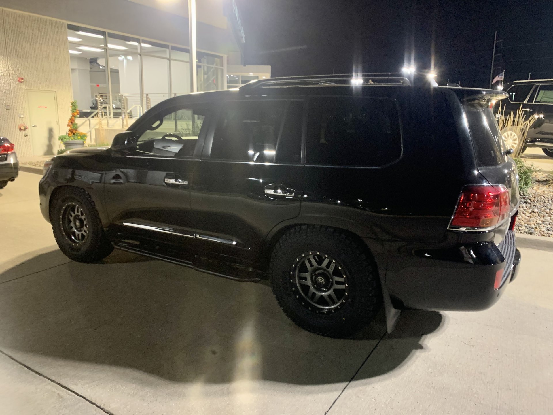

What size meats are those? Looks awesome!
