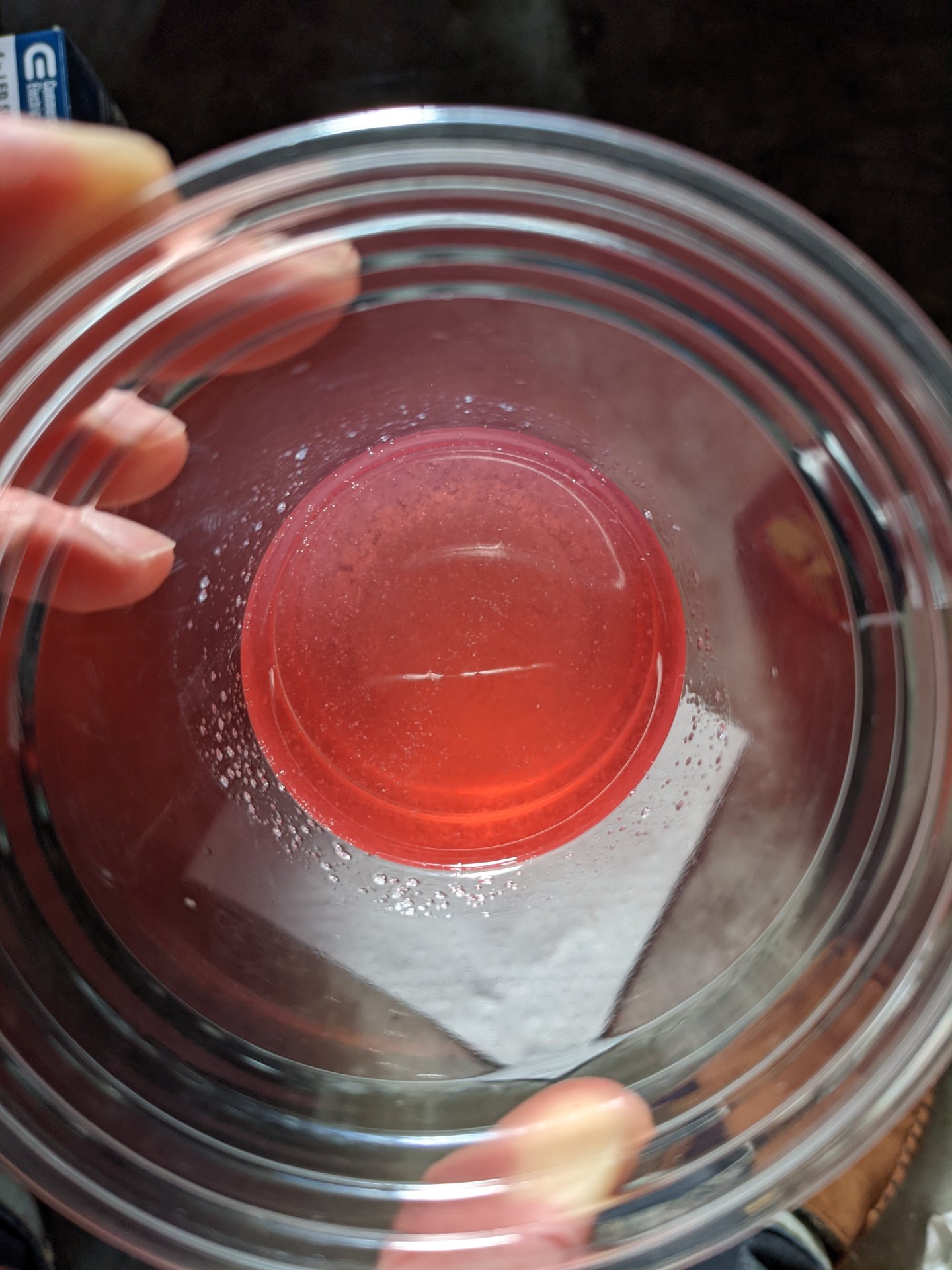

I had just bought it and used it the same day. Here's a pic of what the fluid looks like straight from a bottle. Notice the gel clumps it leaves on the side of the cup.
I had just bought it and used it the same day. Here's a pic of what the fluid looks like straight from a bottle. Notice the gel clumps it leaves on the side of the cup. View attachment 2850354
Did Toyota do anything to remedy the fluid you already poured in? (Maybe you already posted this somewhere and I just don’t remember).
Unfortunately no. The dealership that sold it has been really rude about it. They refused to even look into it. I talked with the dealership that took care of @danny23 and they were helpful and shared as much info as they could. I've talked with people at corporate a few times, but that hasn't gone very far. They keep telling me someone from the dealership will call, but they don't. From their point of view, the dealership that sold the bad fluid is the one that needs to make things right. Dublin Toyota is the place that sold me the bad fluid and they have zero interest remedying the situation. It's still ongoing. I will share if I make any progress or learn something that can help others navigate things.

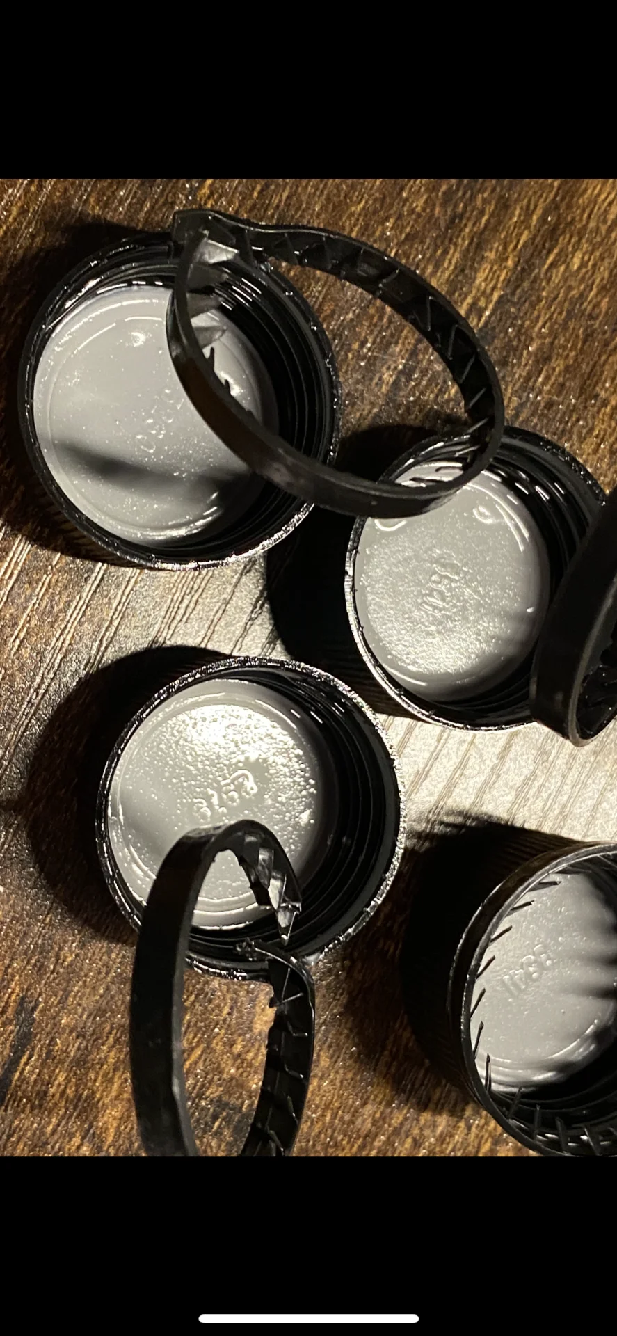

Seems to be everywhere now and I’ve no clue what it could be. My bottles had no lot identification or expiry dates or anything serialized. Just the part numbers and something stamped in the cap. When I did mine, I didn’t notice a different number on the bad bottle. If I recall half were the same code only one of 4 was bunk.
