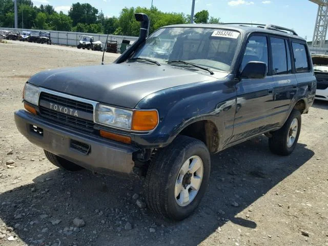

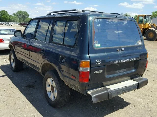

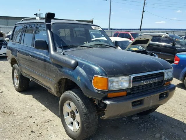

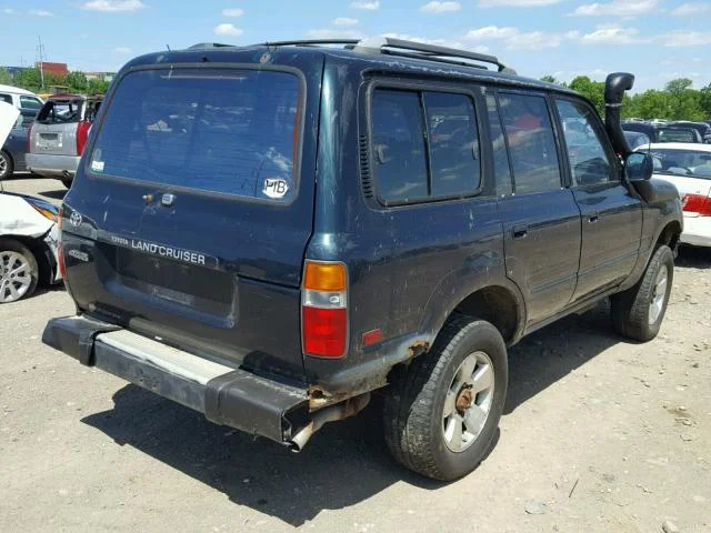

Hello everyone, new to this forum and new to land cruiser ownership. OK I already took the leap on a FZJ80 1994 with k294 on the door tag. I haven't taken possession of it yet as I brought it over the internet at an auction (copart, thoughts and comments on copart are totally unrelated to truck but I've been buying from them for years ) I won it for 1000, but fees and shipping have me in it for 2000 total (still not bad but hold on). It stated "runs and drives " but good luck on it actually being fully running and driving if you know copart, but like I said I've had really good luck with them. I honestly didn't realize it, but it has a salvage title as I only bid on clean title cars, but somehow I bid and ended up winning this particular truck. So running the VIN the car has had about 5 or 6 owners and did most of it's miles early on (has 246 on the clock) . It's an Ohio truck so I'm expecting rust but hoping for minimal (one picture shows rust but hey also shows signs of primer so I'm hoping for a few good owners in it's past) . And funny thing is that the car gained it's salvaged status on Jan 31 of this year. My guess is that it was donated to copart and they can't sell used cars to unlicensed buysers (as I'm not a dealer ) so it gets salvaged and then the public can buy (looked up some legislation that was recently passed in Ohio for this exact purpose, as the car has no physical damage). It's missing the end caps of the front and rear bumpers and looks like the rugs are removed. It has a snorkel. The only visible rust is on the lower rear, right behind the tire. Slavage doesn't bother me cause I've always wanted one and at this price point I'm good, and resale won't be as much but again it's just like passing on the savings . I should take dilvery buy this weekend or Monday the latest. Can't wait to see what headache I got myself into. That's my story and I'm sticking to it, anyone out there recognize it let me know, any keen observers see something I didn't mention again please feel free to let me know
Damn. Good luck, applaud anyone trying to resurrect an 80 but that is a lot more than I'd personally be willing to undertake. Might be a decent trail truck if that's your goal, but IMO that is too far gone to justify putting the big $$ it needs into it. Assuming it actually does show up locked though you are in good shape for $2k. If the axles aren't starting to disintegrate you've got at least $2k right there should you decide to part out.
Don’t look that bad. The rust in the rear looks like the worst thing. Most people add after market bumpers, the carpet in these old truck is usually stinky and needs replaced anyway.

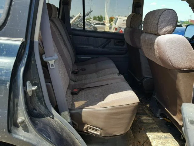

It also appears to have some sort of poverty pack. No wheel flares or holes, the glass look clear no running boards & cloth seats.
Plus a 94, I prefer the 93 /94 years.
If your looking to build nice trail reg I think your off to a good start.
PS don’t let the miles Or the purists scare you

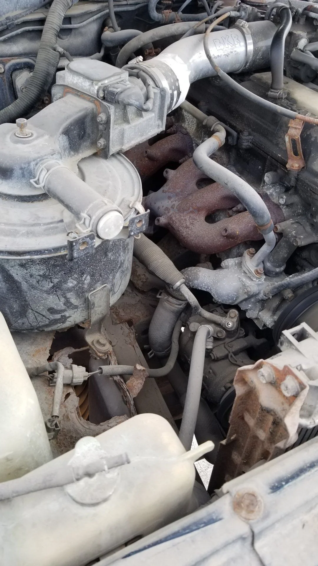

How strict is NY state concerning rust? That giant hole isn't supposed to be there in the last pic...
...although a piece of sheet metal or discarded road sign i'm sure could rivet in there nicely.
Yea, I said ouch out loud when I saw that. What's looked for mainly in these type of inspections, from my knowledge, is that if there were any repairs done to the vehicle that no stolen parts were used.
I think the term GOOD LUCK! is now a term of "Rotsa Ruck!
OMG. That one pretty much needs a bullet. I have not seen one where the inner fenders were rusted away!

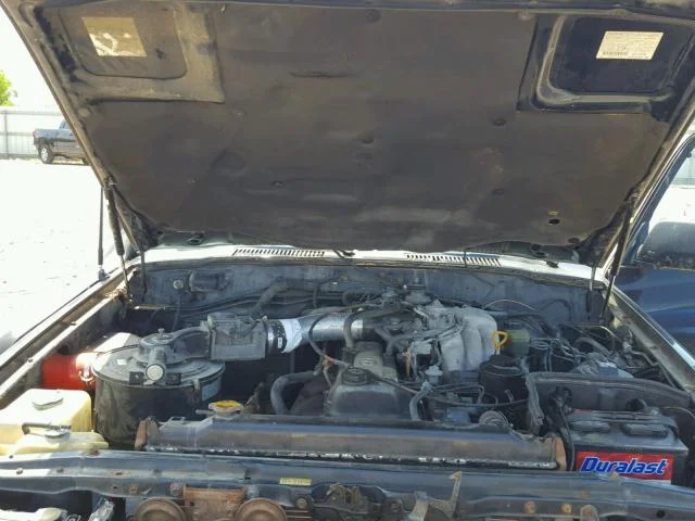

Inspected/registered - (this is where I think you are going to have problems - You'll probably need the Ebrake working (Im going to bet this doesn't work), and anything that came from the factory should be there (the emissions removal will be a problem)- No CEL light (im betting its on due to the emissions stuff removed) -I'd be shocked if there isn't any codes). Exhaust might be a problem Y pipe probably has a hole in it)

I don't think the body is that bad rust wise. Hatch, doors, Front of hood all look pretty solid. - Rear quarters are a semi easy fix if you cut them off flush and weld a flat piece in and I wouldn't even worry about the inner fenders.
I'm guessing someone swapped the seats at one point. I would think it should have leather based on the door panel. Carpet already gone, someone did you a favor.
