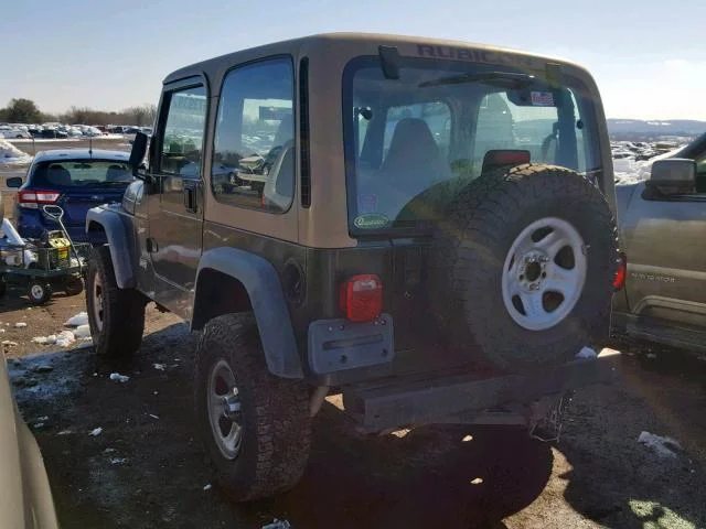

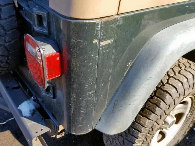

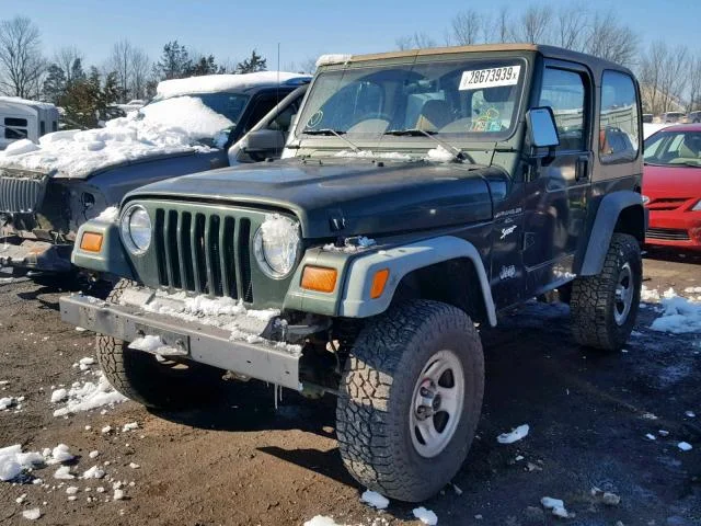

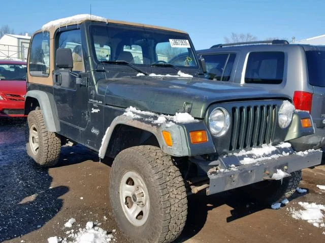

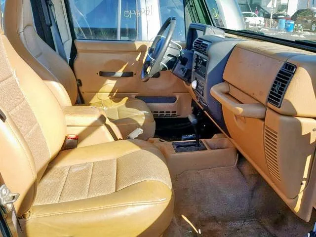

Ok, so there's no easy way to say this so I'll just come out with it. I'll start off by saying, I never make the same mistake twice, I make that s*** like 3 or 4 times, to make sure it was a mistake. I've always wanted 2 types of cars and now I have a couple of sheckels to rub together I had a budget to get a car, work on it on the weekend while using it during the week. Long story short I brought another truck today. 1997, wrangler sport, with about 164k on the clock. This one has a clean title at least but I'm in it for 2500. The crazy part is that I'm not sure I wana give up on the fzj, another crazy coincidence is that they're almost the same color. Runs and drives and I paid 35 dollars for a PPI (not a very good one) but it states rust is minimal. Please, let me know what you guys think as I love hearing opinions and thoughts. Here are a few pics and I should be getting this car dilivered by mid week (hopefully) I literally have to hide this from my wife as she'd cut off my n*ts.

Clean the Jeep and wax it up. Run a can of stp multisystem cleaner through a tank of gas. Put in a new fuel filter and get the interior spotless. Get the tires balanced well and sell it for 5k.

Looks good. Some of the TJ Sports came with a dana44 rear end as an option. Not as stout as a 9.5” but loads better than a dana35 (standard rear axle in TJs.) If tou plan on off-roading a lot you May want to swap a Ford 8.8” in either way.
That’s the biggest difference in an 80 and a Wrangler. All Wrangler owners have to upgrade axles (sooner or later) and I’ve never heard of anyone swapping their 80 axles.
The automatic should be the 3 speed which is much better than the crappy 4 speed autos they put in them after 1999.

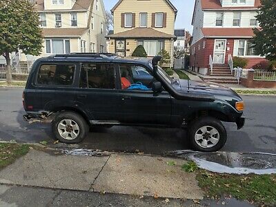

Well OP, what did you do before this thing was crushed? Or is there a resurrection somewhere?
It's still siting in my mother in laws garage. I visit her (both truck and inlaw, lol) about once every 2 or 3 weeks. I get in there start her up and let her run till temp then shut her down. I gave all the information to my buddy who's supposed to get a transferable registration from Rohde Island for me. After I get that in hand, I'll know more of what I'm doing with the old rig. Starts up 1st try everytime, I'll give it that.
So the journey continues!
So this thing sat in my mother-in-laws garage since I got it, but 2 weeks ago, my brother and I were talking and he mentioned that he was in the market for a hooptie . So I offered this truck, I said it's been sitting and is rusted to s***, but it needs break lines and tune up (spark plugs, oil and fluids mainly I won't waste any more than that) and best of all I said you can have it for free (i'll ask him for some $$ later on down the road, lets see how far it goes) . So we took it out the garage washed the exterior, fixed the break line and illegally drove it around the block, (no plates) . After having it on for about an hour it purred like a kitten, with it on for about 20 minutes I could hear a regular tap (like every 20 seconds) but then a good rev and once fully warmed up it went away. I tired to engage the lockers and it wouldn't engage ( but the solenoid looks rusted to all s***, or at least I believe thats what that is). He's getting a salvaged Pennsylvania title for it and should have it on the road by next week or the last week of November at the latest. He's hoping (and so am I that it makes it through the NYC winter with minimal maintenance. He basically needs a point a to point b car probably about 4 or 5 miles round trip (cause who wants to be catching a bus after transferring from a train during these cold days) so it should serve it's purpose.
