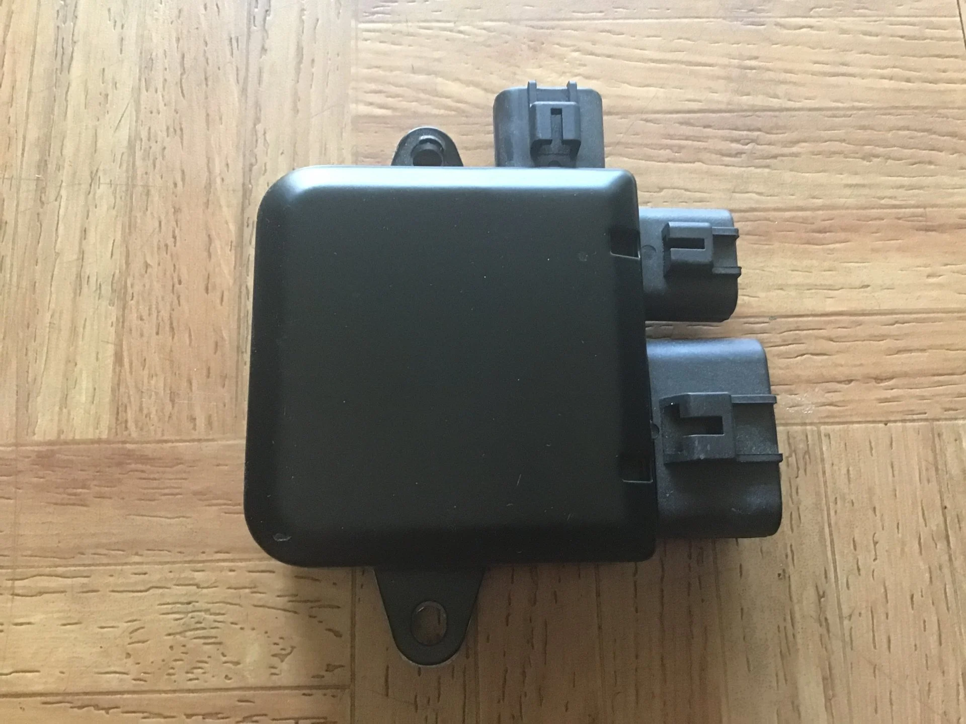

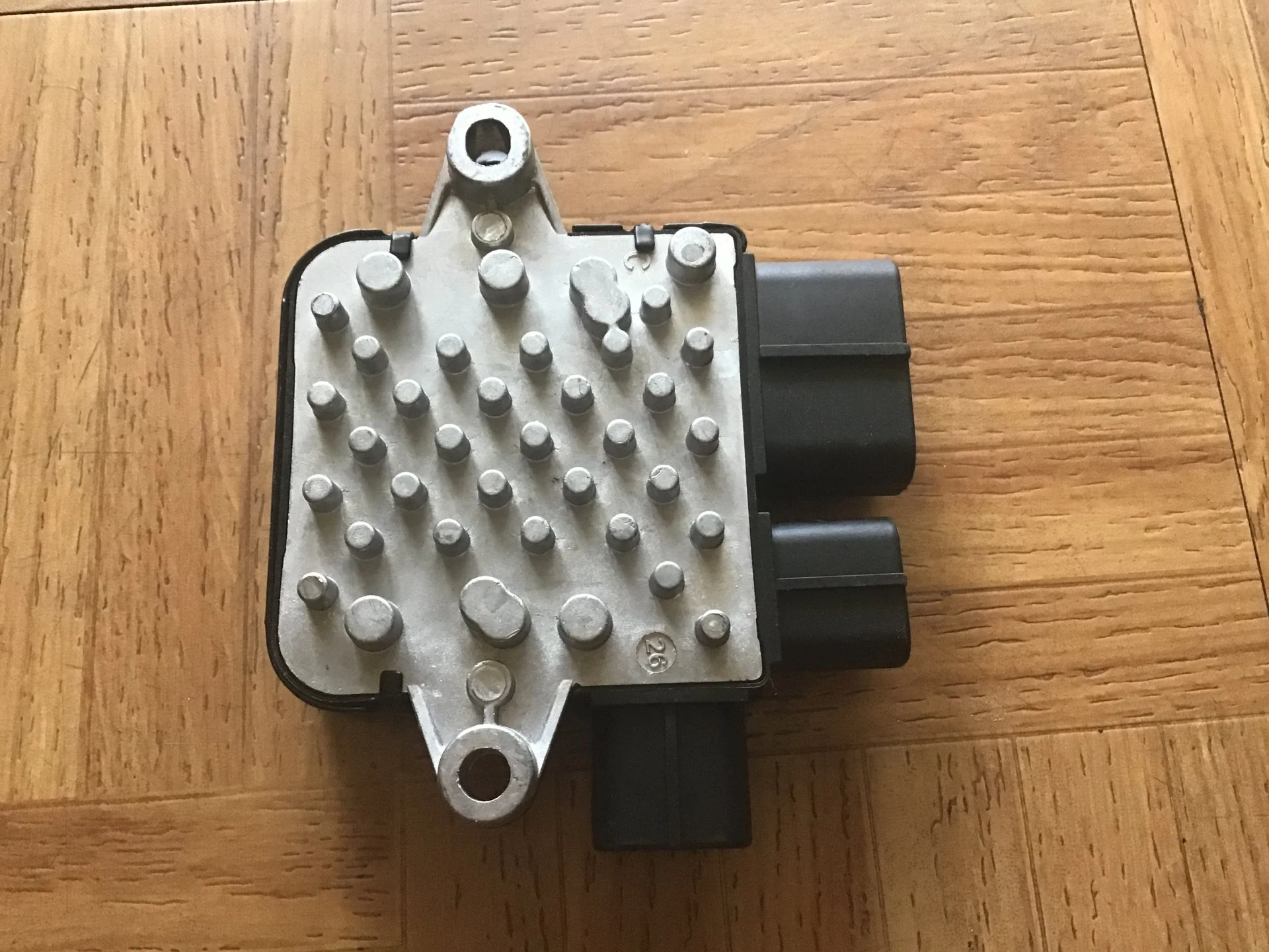

I just remembered a module that I used on a few of my projects should also work for you.
it is a electric fan module that can be controlled by PWM or 0-5 volts. ( potentiometer )
It has 12 different power levels and can handle at least 40 Amps, also only cost about $12-15.
part number: D105-1355A

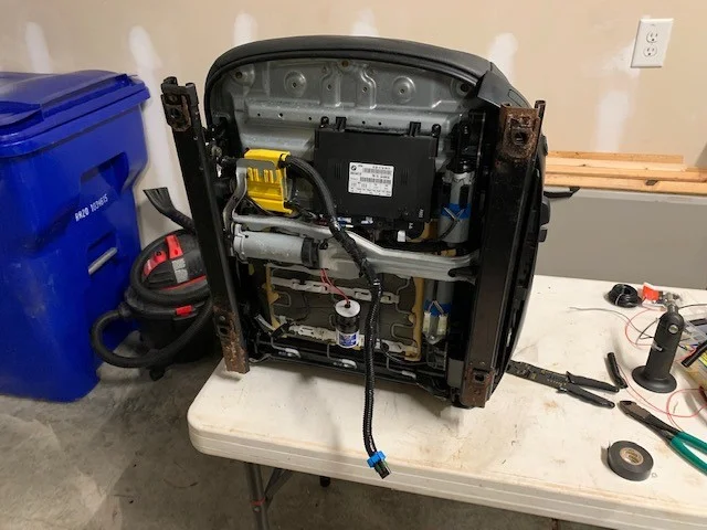

Thanks for this thread. It's been very helpful, but I have a question. I have a pair of BMW seats that I installed in my truck and I'm trying to get the seat heaters working. My seats only have the one computer on the drivers seat, and not on the passenger side. So my question is do I need to run a wire from the DS computer to the PS to get the heaters to work?
Nope. The wiring with each seat is different. Treat them independently. If you don't have wiring diagrams that you found on Mud, there are some that will distinguish between the two seats.

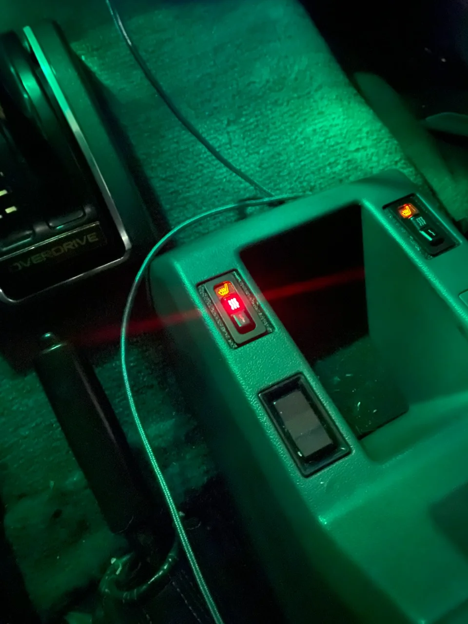

The switches have a built in voltage monitor and the seats don't really heat unless the truck is running so the battery doesn't run down. Pretty cool feature. Very happy with this setup!!

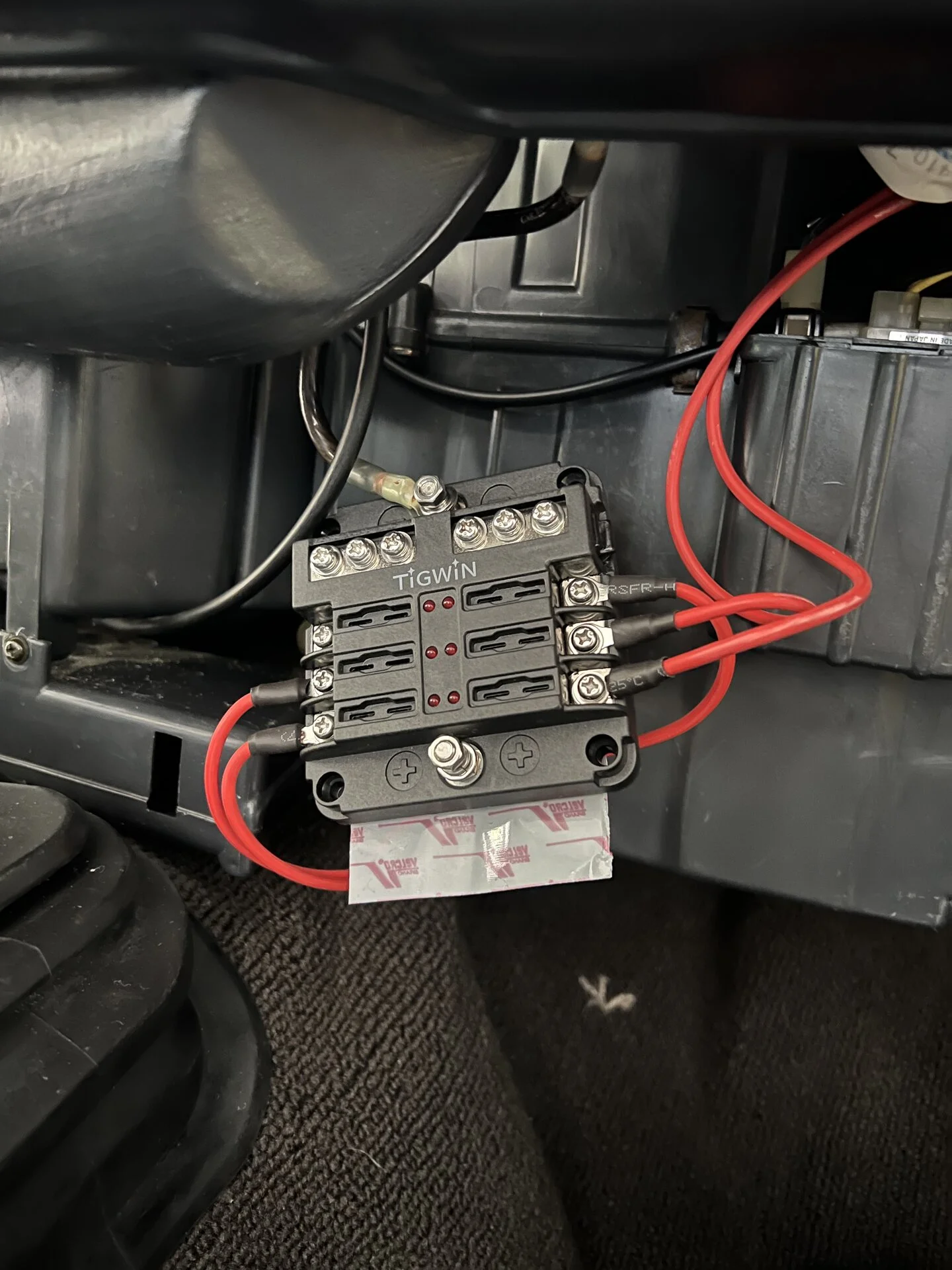

The power for the seats moving and the seat heaters are coming from this fused distribution block which is powered directly from the battery. So it’s constant power and not ignition switches power. That makes sense because I want to be able to move the seats even if the car is off.
