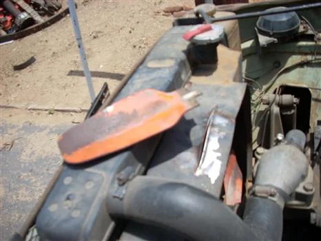

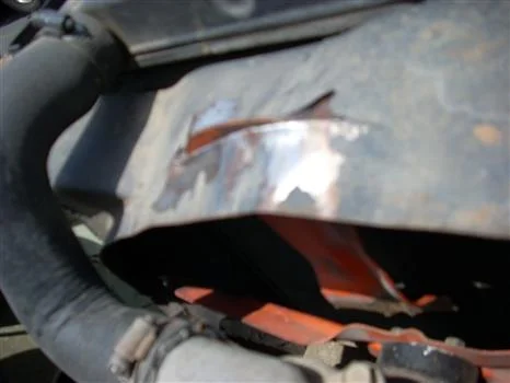

We were out driving the 45 the other day and all of a sudden I thought we had thrown a Rod. The Cruiser started shaking apart. Once I shut it down and opened the hood this is what I found :crybaby: SCARY !!! So I will be changing all my Cruisers over to plastic fans. Funny I was talking to Mark today and before I could finish my story he had already guesed what happened. So Just throwing this out there Dont let this happen to you :cheers:
Caught by the fan shroud. AMAZING!
I had one go and dent the hood. It also took out the radiator. You have to check them periodically for stress cracks, which generally precede complete fractures. I know that happened to mine because we could see the rust surface of the old portion of the crack.
Good one:beer: I need to replace the fan on my green 40, It has had a crack for the last 5 years.

910 and 911's You bet Dan . We will be up grading to the 6 blade plastic fan. :wrench: Yes I had always heard stories kind of like an urban myth about blades breaking off and causing alot damage but seeing it first hand was something else. :cheers:
