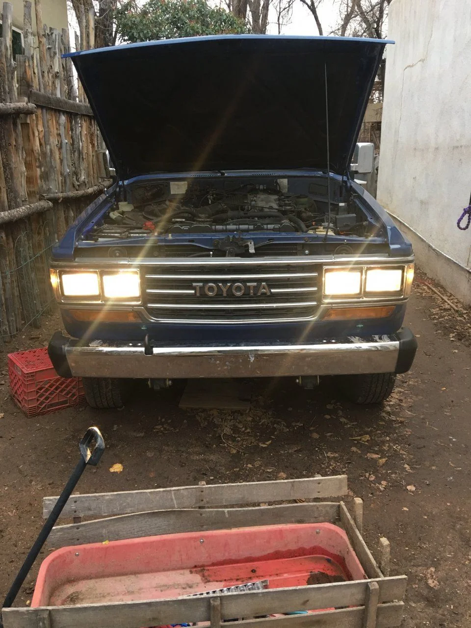

VERY nice product! Thank you! True to words "plug and play." Can't wait to get the H1 and H4 units!
The craftsmanship on this harness is incredible. I can't wait to get some new headlights into my rig!
Thanks again!
