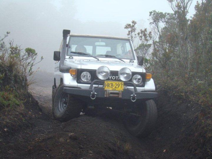

Driving people crazy with 10 gazillion candlepower is the fun part. :)

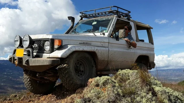

They were truly bolt on in Tencha .. you will found here ( MUD ) thread about TruckLite LED with some pics of how they work at night ( not only from Tencha )
old pic
I've got the same lights on my HJ75 although I'm not sure of the wattage. They are actually quite good.
old pic
Love my TruckLites!
