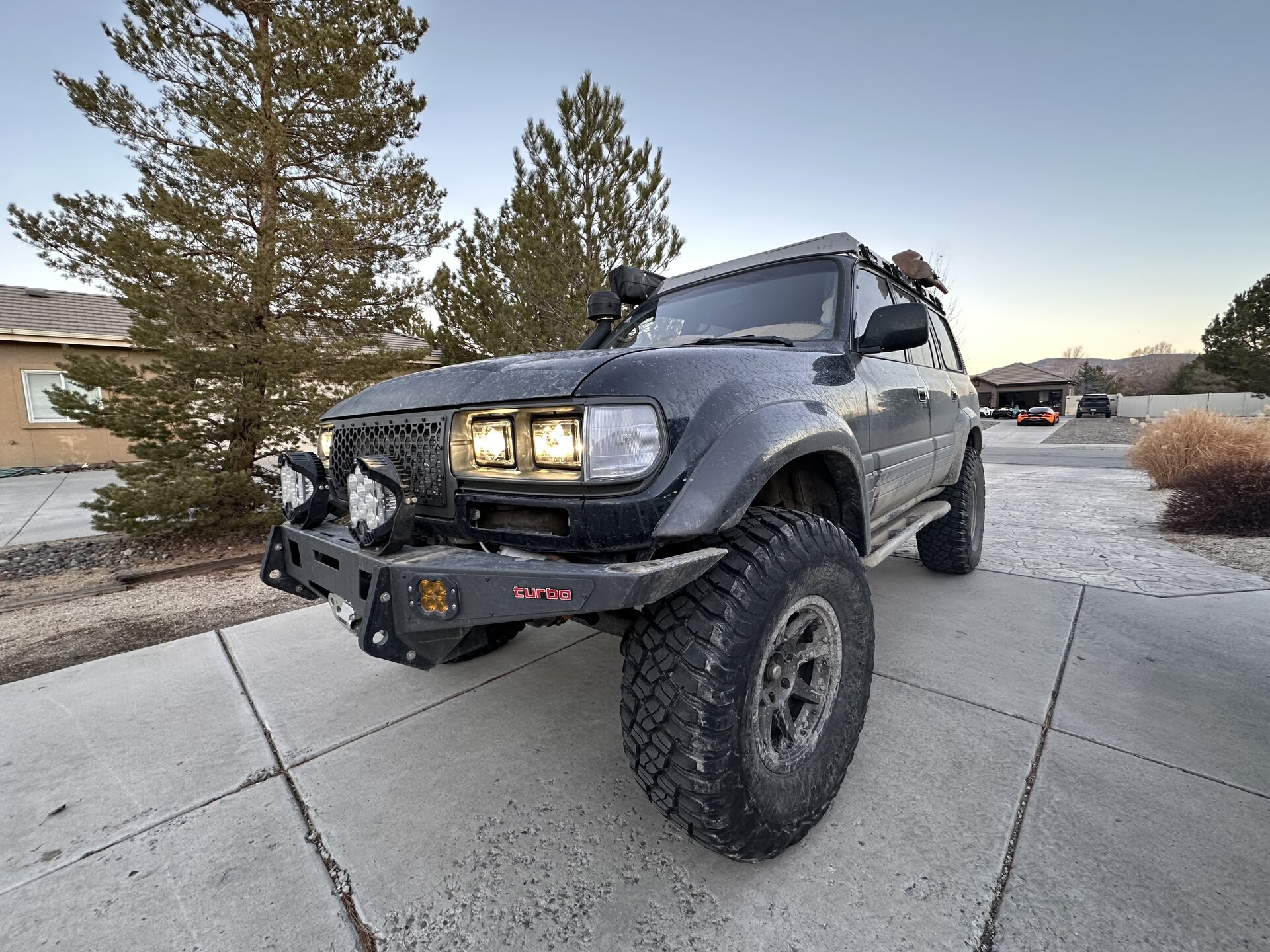

I'll add a twist to this topic. I went with a set of quad beam housing fitted with heated JW Speaker 8800s and Kelly's center grille section. I'm still working through the install but here are a few teaser photos.
I just have to figure out where to relocate the turn signals to since the intercooler piping interferes with the factory lights. I had previously run turn signal wiring into the corner light assemblies using a two-filament bulb but that won't work anymore because the quad-beam side marker lights don't have room for such an arrangement.
