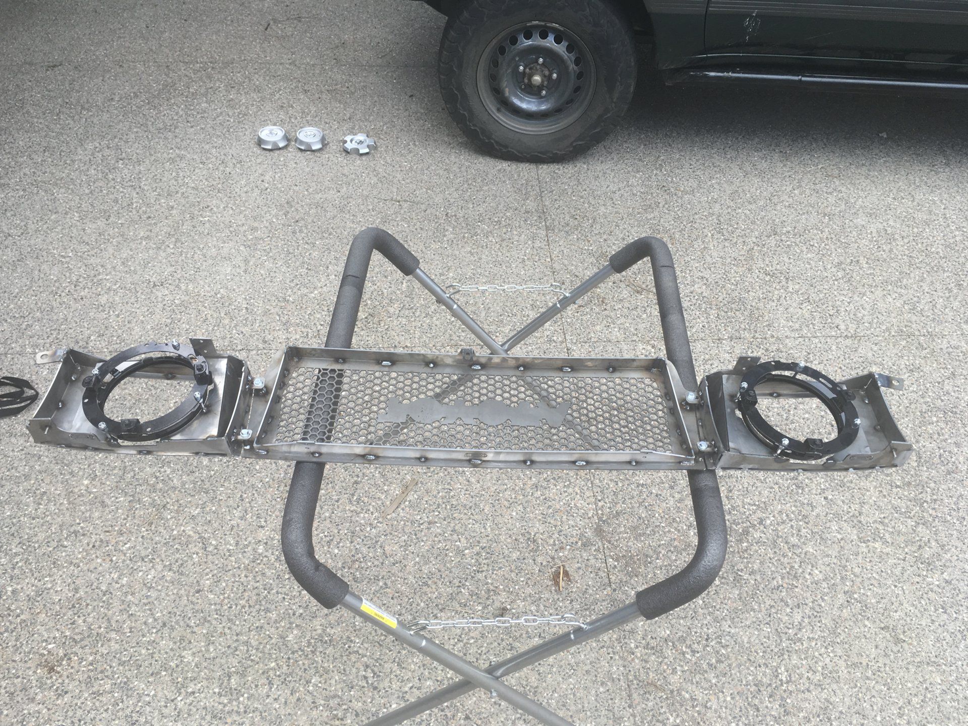

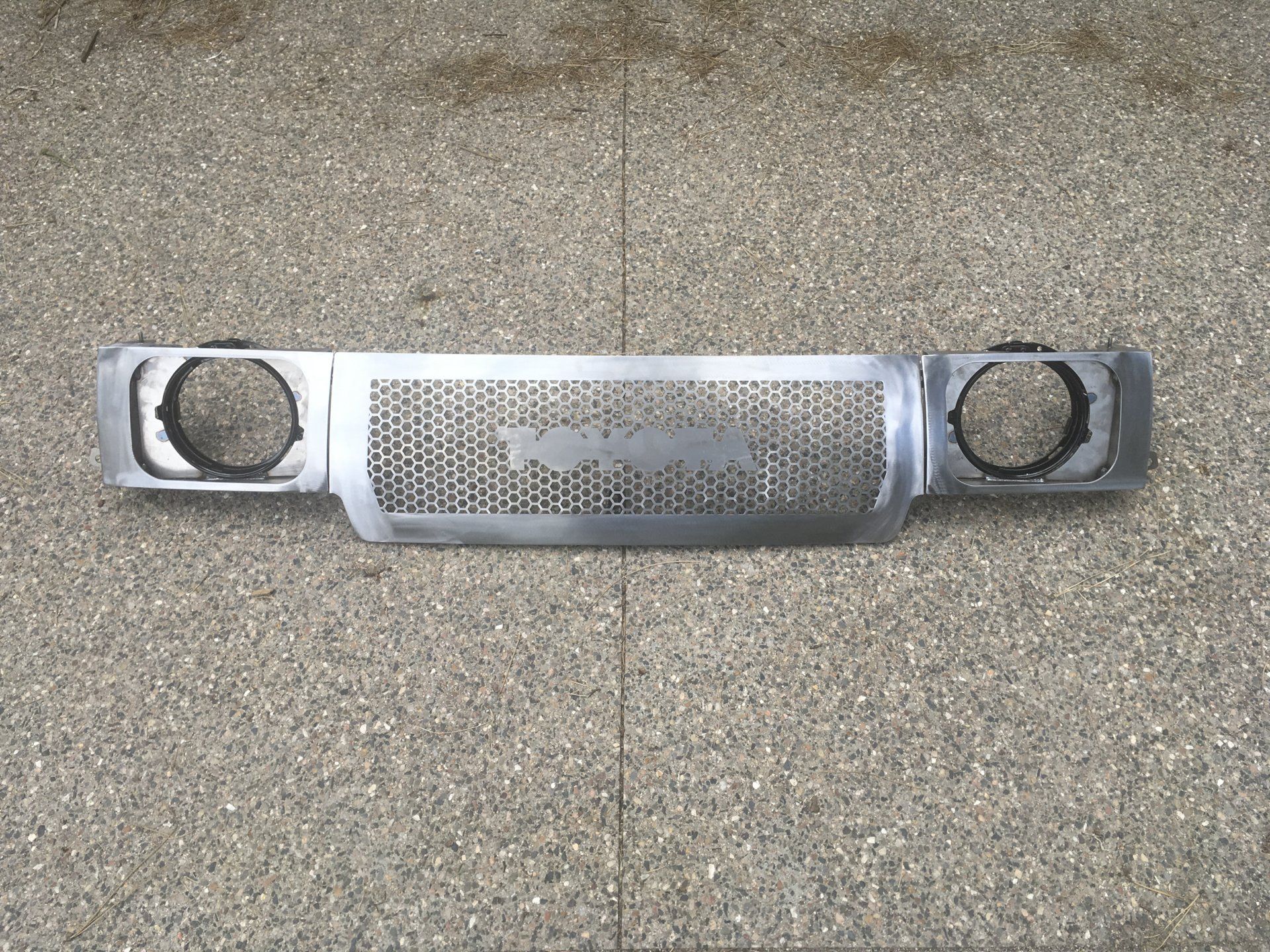

80 headlights and grille. More boring bare metal pics from my driveway. :p
The more i see the straight edges between the grille and lights the more I wish I had gotten them. I still think the look is awesome!
I know! I did try to talk you into it though;) if you decide to change it, I will do it at a discount.
Yeah I know you did. I was just impatient. I’d wanted them for so long I didn’t want to give them up. Thanks again for making these.

New design based on the 60 series look. Changed the seam between headlights and grille, made it more vertical. Added trim to the headlight housings and using round holes instead of the rectangle openings. Might look cool?View attachment 2044788
This is definitely on my list of cool-stuff-I'd-like-to-do. Headlights are a big issue with me, and the stockers suck. I think this round hole style looks great. Would the stock chrome Toyota badge fit over the script in the center? Just thinking about a little bling.
I can make it to fit most emblems.
