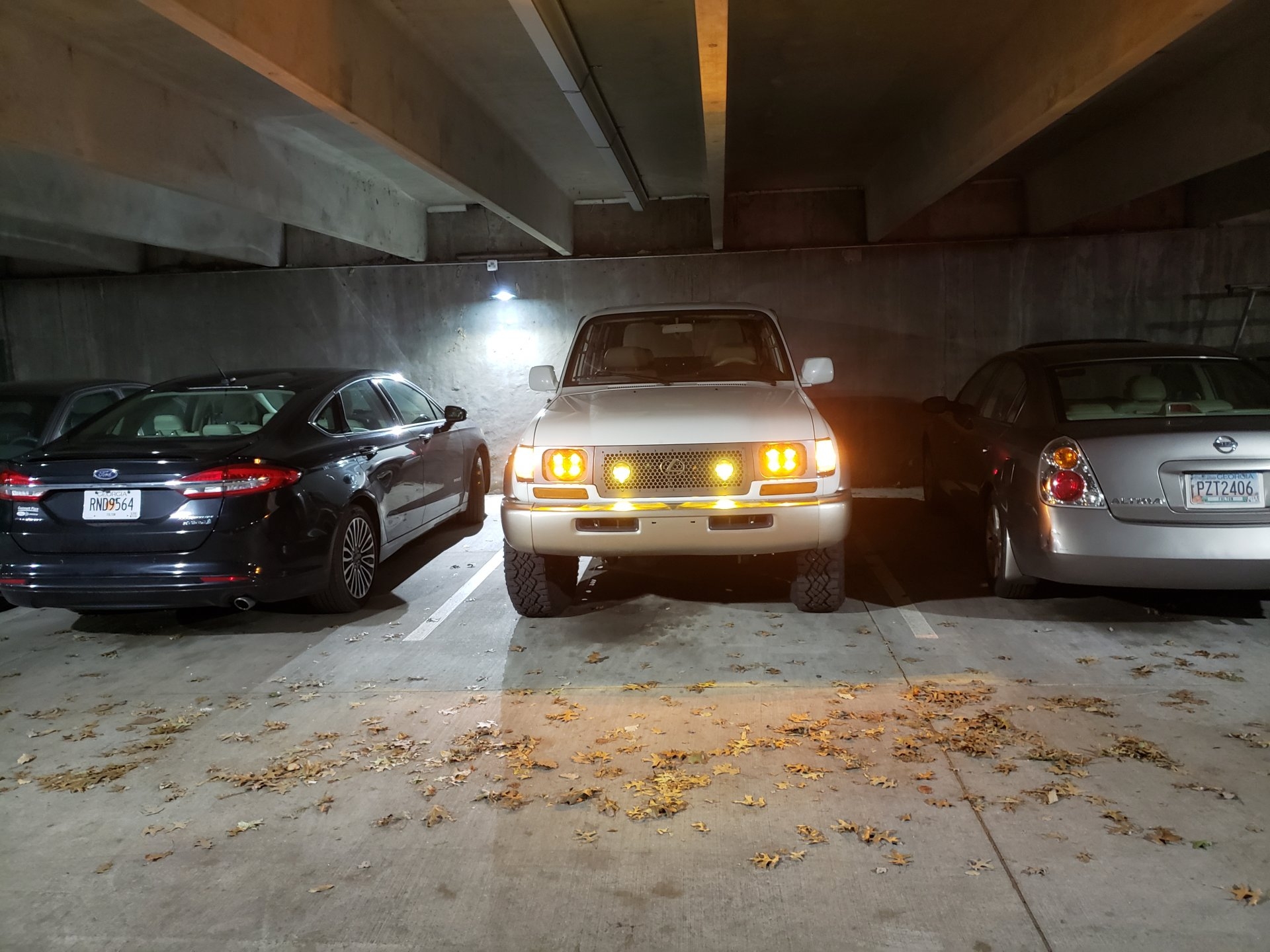

The light output is crazy good compared to what I came from (stock). The added benefit of integrated DRLs is also a "cool" factor. Decided to to utilize the turn signal functionality.
Ultimately, very happy with the selection.
Yeah i really like how they came out for mine.. i run the amber lights with the side markers and i don't use the drl white lights at all. The cut off is great too.

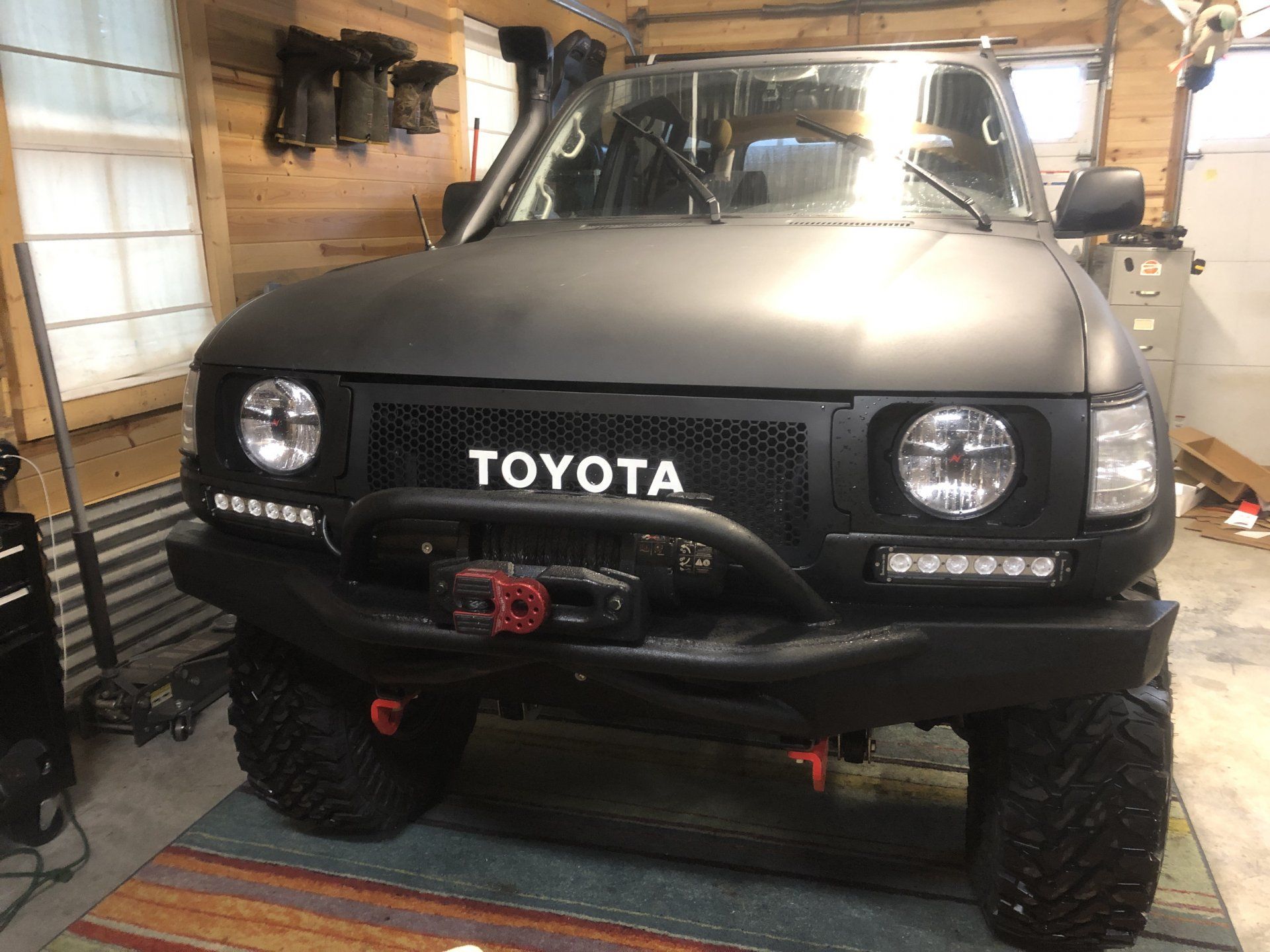

I like what you did with the front running lights - who makes those LED’s?
Any chance you got amber, or are they white/clear?
I’d just stuck clear depo lenses / amber bulbs there like ~15yrs ago, they are finally clouding over & looking ratty.
The ones in the valance are from ***NEW**** 2017 F250/F350 Double Hidden Grille Mount LED Lights (Includes two 11" LED Light Bars, two hidden grille mounts, and wire harness) - https://www.southernliteled.com/new-2017-f250-f350-double-hidden-grille-mount-led-lights-includes-two-11-led-light-bars-two-hidden-grille-mounts-and-wire-harness/
They are white off road lights. @slow95z found a similar light bar on Amazon for a lot less.
I moved the indicators to the corners and it’s a switchback led white when on and changes to Amber with the turn signal.
