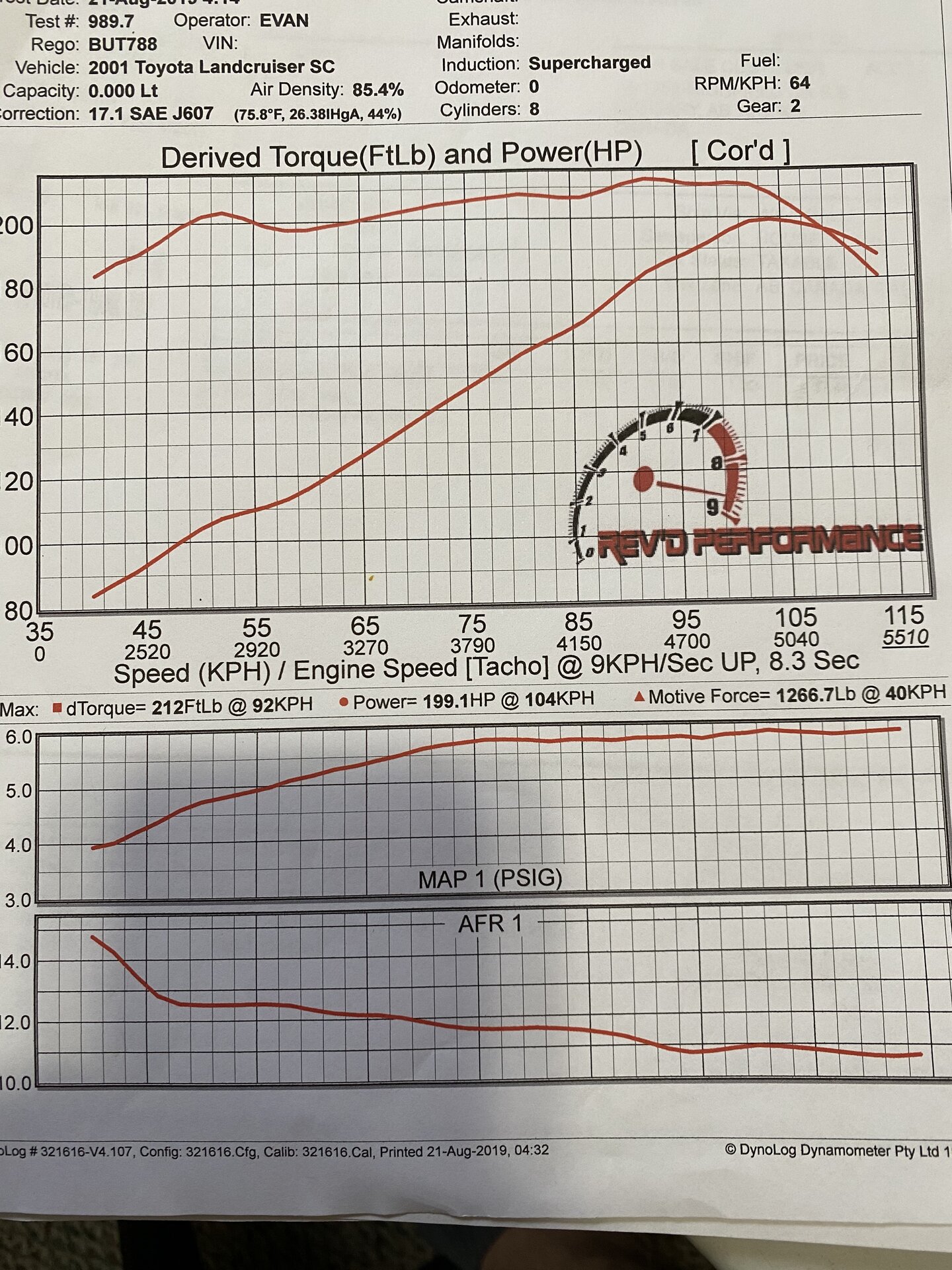

Also, what kind of horsepower/ torque should I be expecting from having the supercharger? When the dyno was performed
How would I get a reading on boost?
Also, what kind of horsepower / torque should I be expecting from it being supercharged? When the dyno was performed it came back with 199HP and 212FtLb torque.
You can add boost gauge to the driver side boost port. Can ask where dyno guys got it. Boost is on your dyno sheet. Looks like 5.5 psi at wot. That's not bad really. Fuel is rich but not terrible.
Only thing off is I think you should be closer to 250-275hp at the wheels. 199 whp is pretty close to stock. Can you post some pics of your SC.

FWIW my 2007 VVTI truck made 179whp on a dyno when it was stock, so yours at 199 is not a great bump. All dynos are different, so who knows but it does seem low.

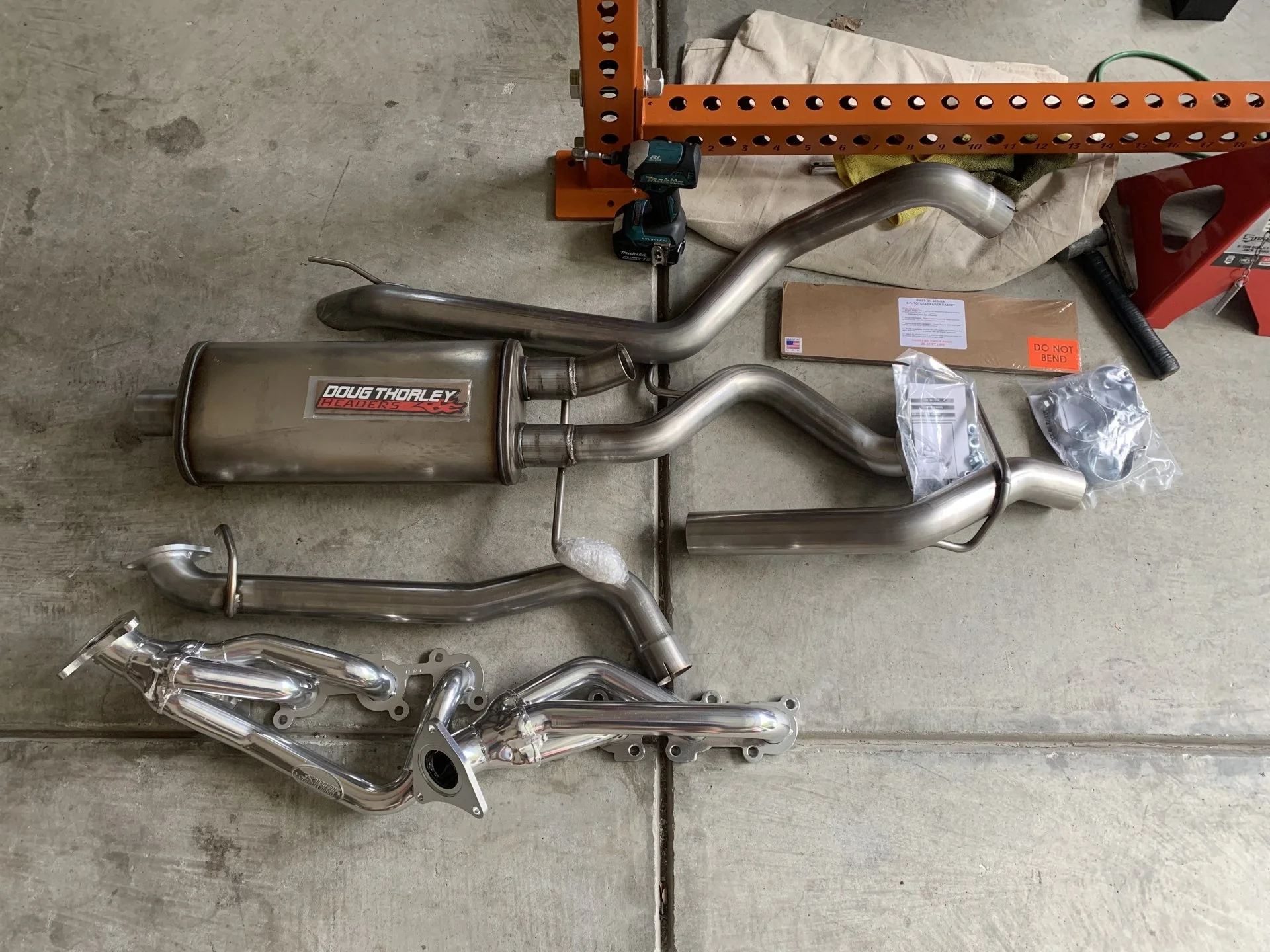

DT headers are absolutely worth it. I have a Borla exhaust also and it is a lot better than the stock exhaust also. This year I plan on changing my exhaust to a custom built 3" catback now that I have a supercharger as I think it's holding it back now.
The DT headers on my truck definitely woke it up. There's some dynos floating around this forum but they are noticeable to say the least. I wrote a thread detailing my install for others as reference. It's not as bad as it seems, just tight working space.

That definitely seems low. Was this an AWD dyno or was it run in RWD with the front driveshaft removed?
I would expect mine to be somewhere around 180-190 wheel on a rwd dyno.

So this Cat back full system interests me and possible cat delete the restriction. I am sourcing the DT Heeders and Cat Back now awaiting a call back. If successful I pass on the reseller... the prices are better than retail at other places I have looked. Now if they can get the parts is another thing.

Heard back from the suppler that resales DT products.
Doug Thorley has picked up operations and moved to Arizona from Ca. The suppler said give it 30-45 days and revisit. DT is out of stock on these products now. Unless a retailer happens to have stock, they are temporarily unavailable.
But with time DT will be back on the scene supplying product.
