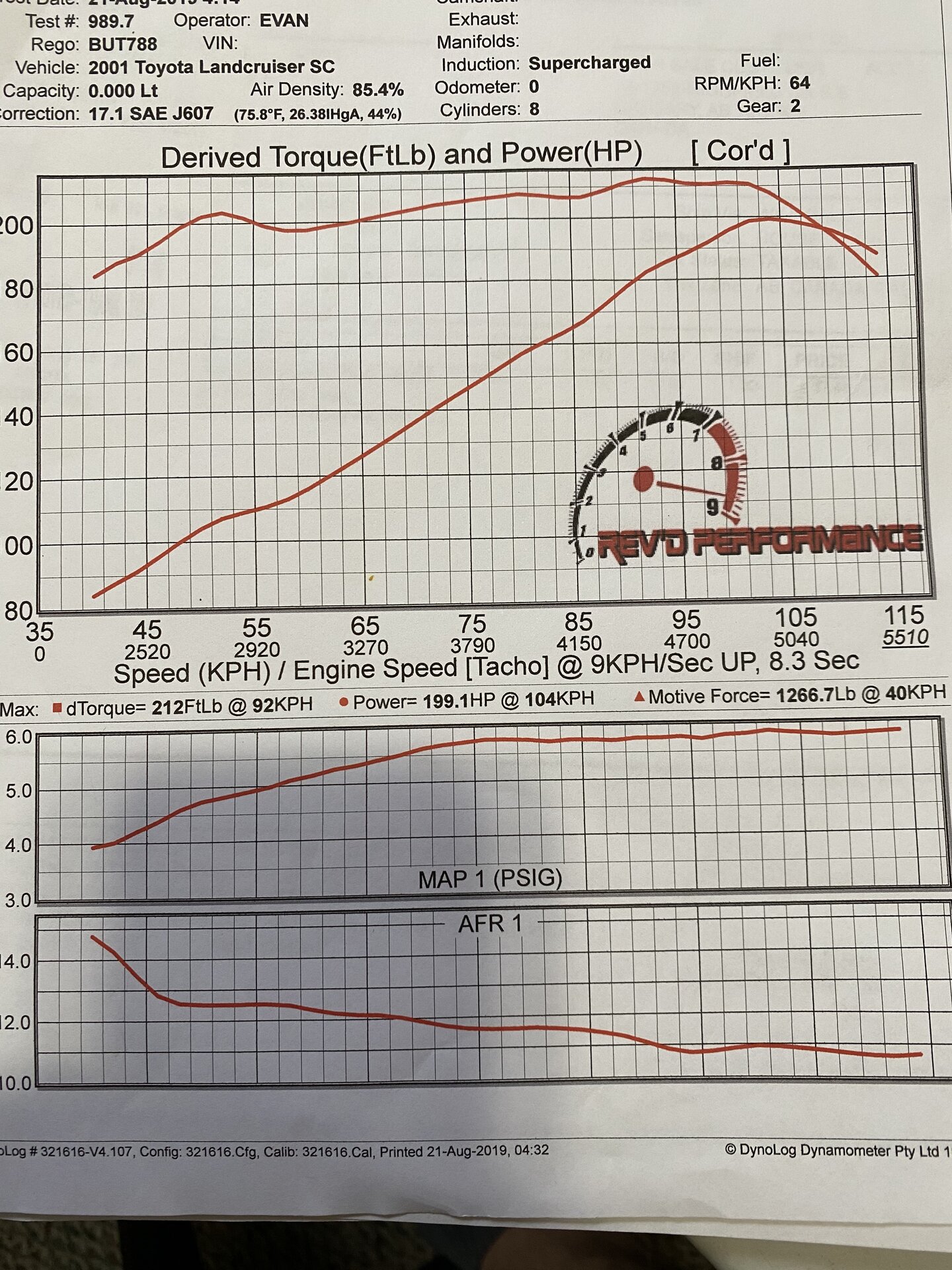

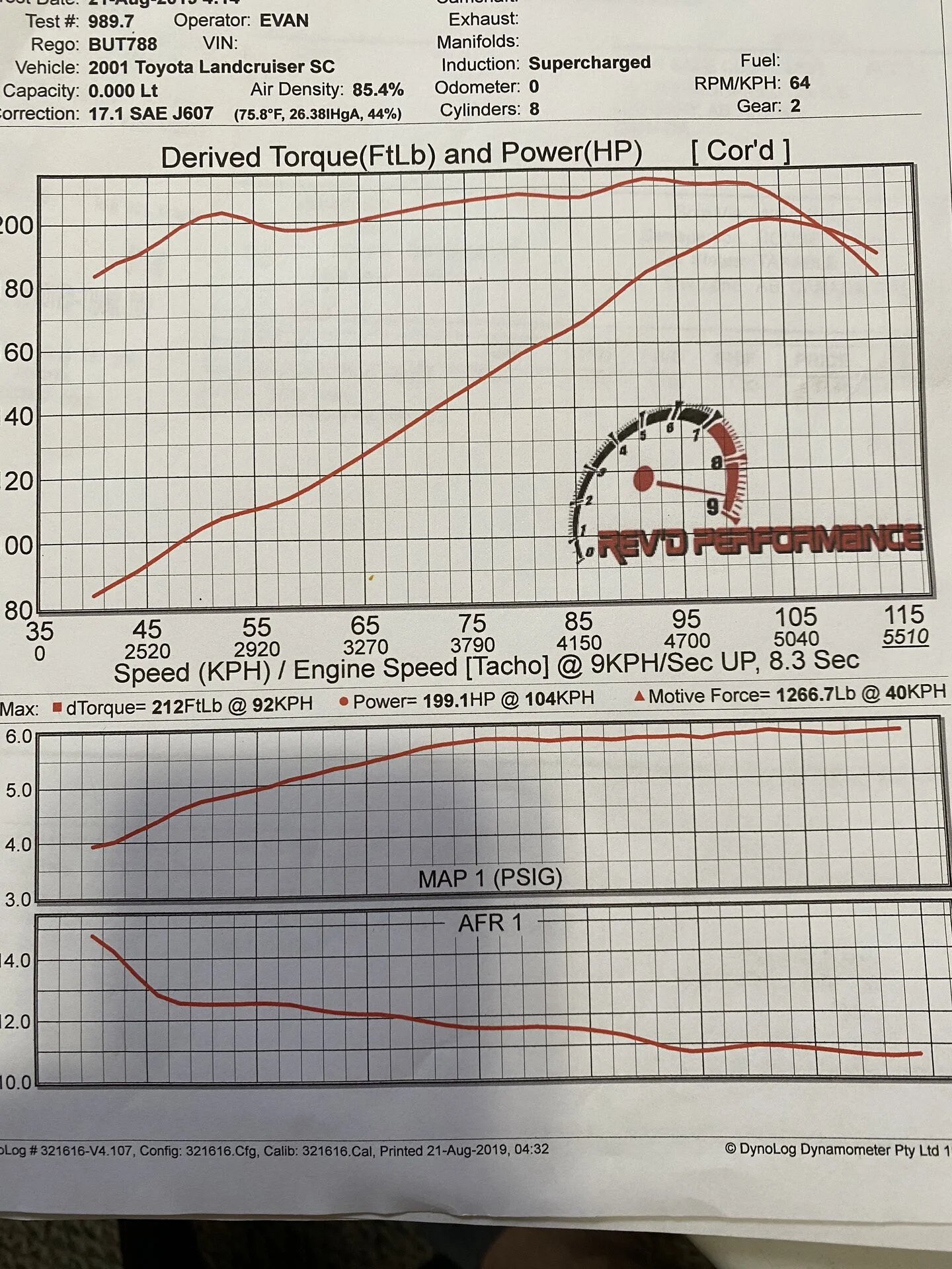

How would I get a reading on boost?
Also, what kind of horsepower/ torque should I be expecting from having the supercharger? When the dyno was performed
You should check for restriction in intake and see what your current boost is. If you intake is restricted with the SC the exhaust wont help much in my opinion. Intake was the biggest performance increase for me with Supercharger. Just make sure you aren't going lean at WOT. Long tube Headers are extremely hard to fit in LC100 on driver side. I would do intake, check fueling, upgrade from headers back , check fueling. Then headers. Just some thoughts from my experience with TRD SC.
To check restriction on intake I just noted boost with intake all sealed up. Then I opened lid and secured filter ,went WOT again and noted new boost psi. I picked up 2 PSI from stock intake to open intake with filter.
Also, what kind of horsepower / torque should I be expecting from it being supercharged? When the dyno was performed it came back with 199HP and 212FtLb torque.
