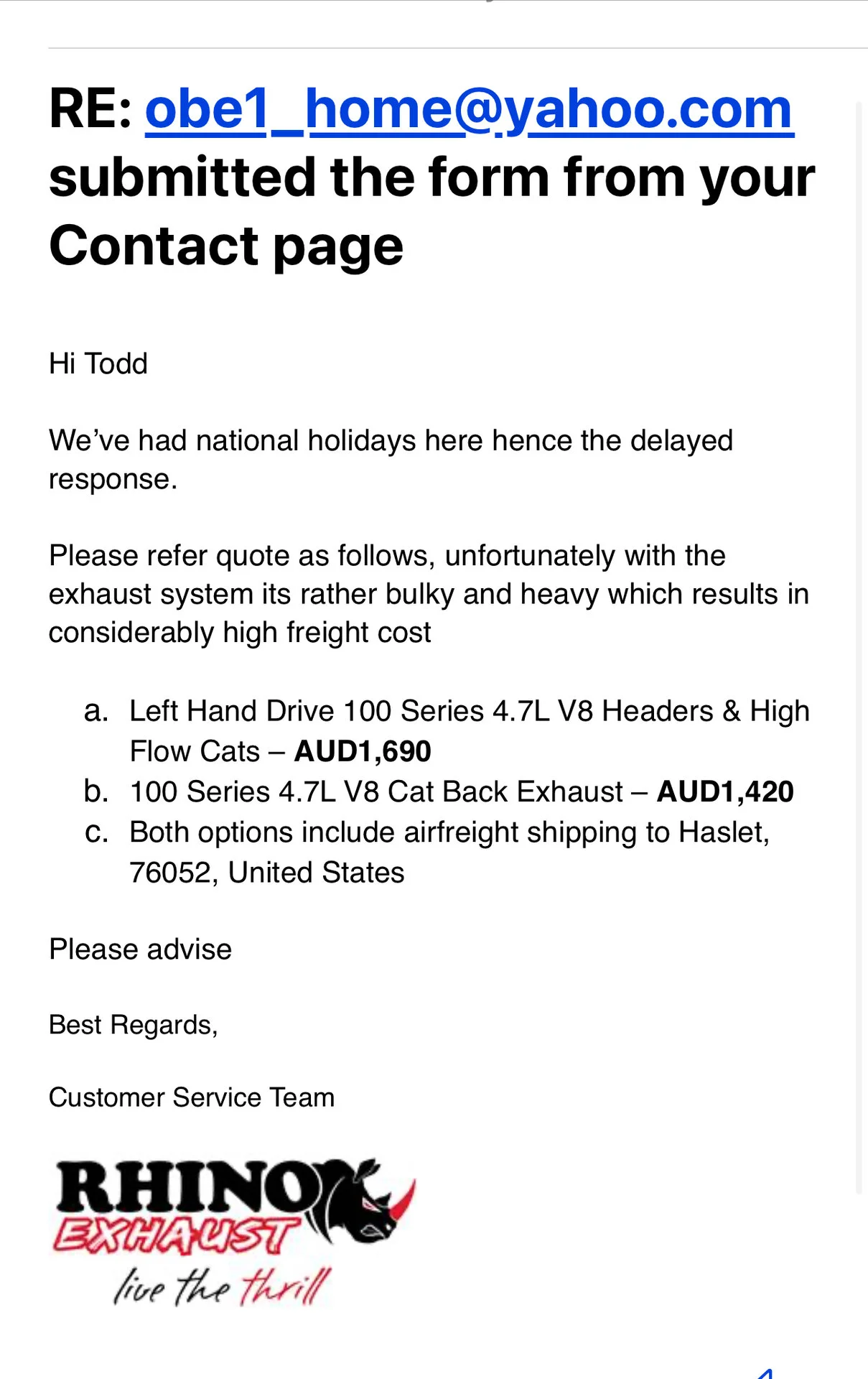

I contacted Rhino directly. The cost shipped 1690 Aus to US now 1100 ish dollars.
About 100 AUS dollars less … not much bust some. Don’t know is eBay is collecting tax on this out of country transaction or not.
Tex
Tex
J1000, I followed you lead and asked also what the extra cost shipped for Heeders and Cat back full exhaust too.
