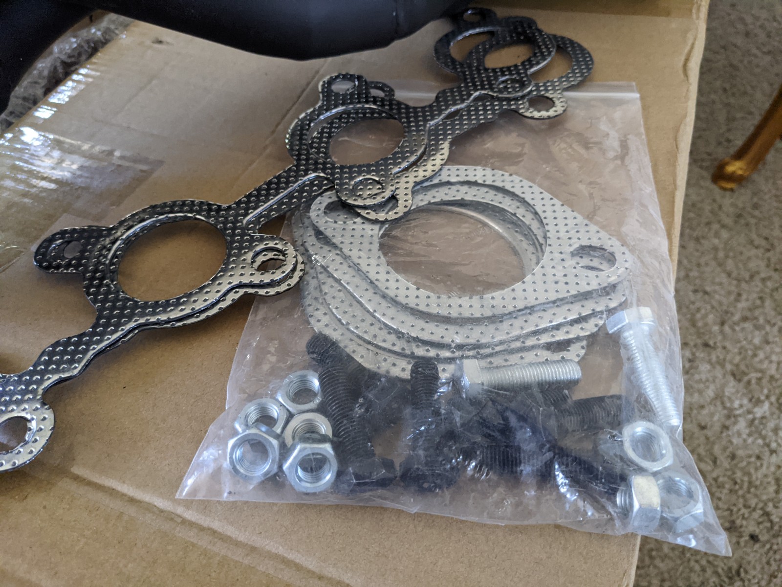

Here's what the hardware kit looked like that I received with the full Rhino exhaust. It appears to be all of the gaskets and hardware to connect the exhaust system besides what's needed to connect the headers to the engine. I'm planning to order all new studs and nuts before I do the install.
Just FYI, my cats and manifold gaskets were actually packed with the headers and not in the larger box. It was hard to believe they could even fit in that tiny package, but there they were.
Fwiw-no first hand experience but Ive read many suggestions on using only OEM manifold gaskets-
