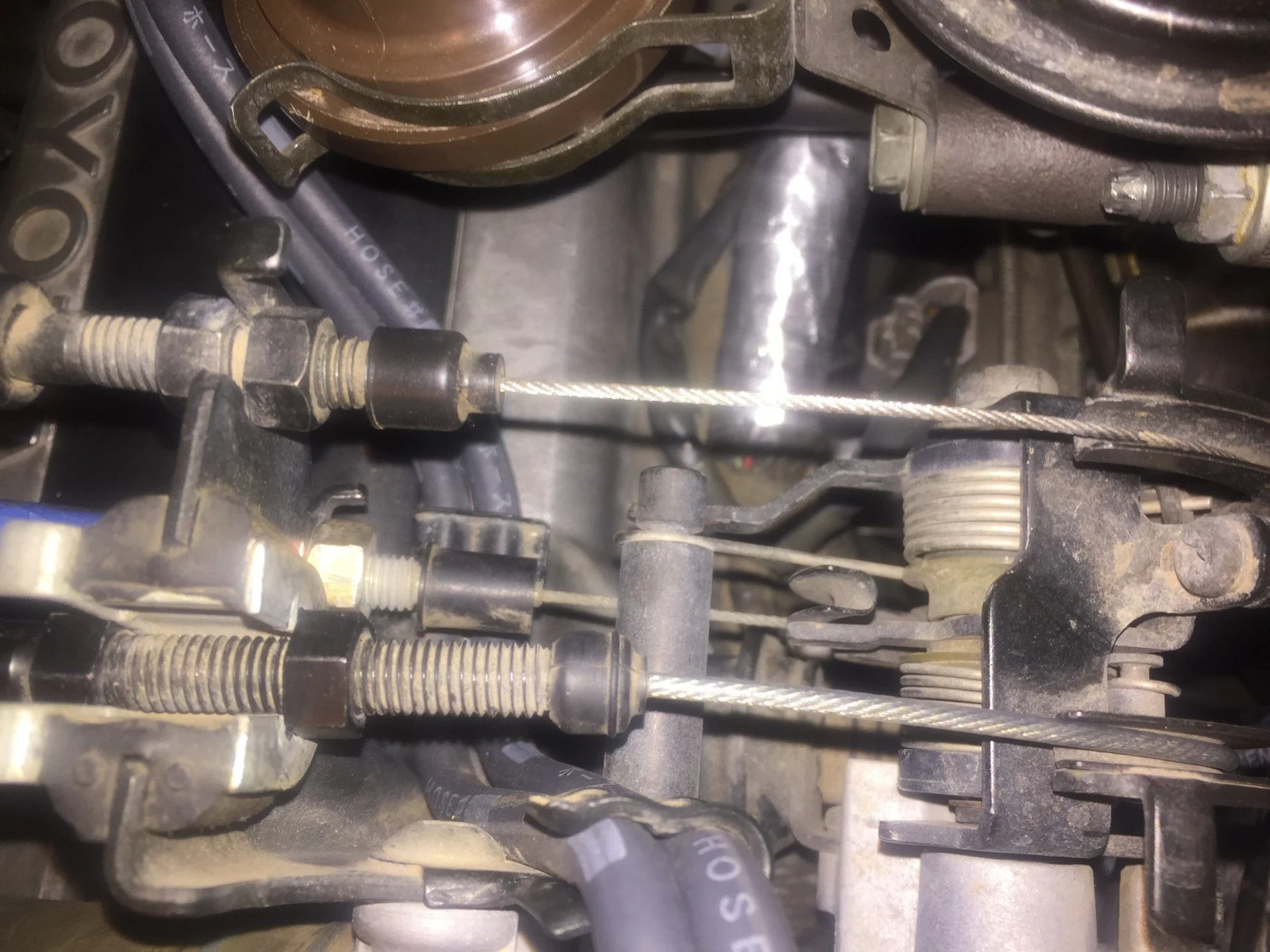

Question related to the throttle cables - I didn't mark the position or better to say I marked it really badly so it is gone. How do I adjust the cables going to the throttle body ?

Run the top two loose as in some slack you don't want those tight, on tranny cable which is bottom adjust to where the nipple comes out of the sleeve by 1mm

Just a question regarding the throttle cables , I have them like this now:
Does it look right ? The upper two cables are bit loose as everybody suggested. I am not sure about the bottom one .

When I did my HG last spring the idle was also low but a cable adjustment at the TB was necessary. I must have knocked it out during all the excitement.
