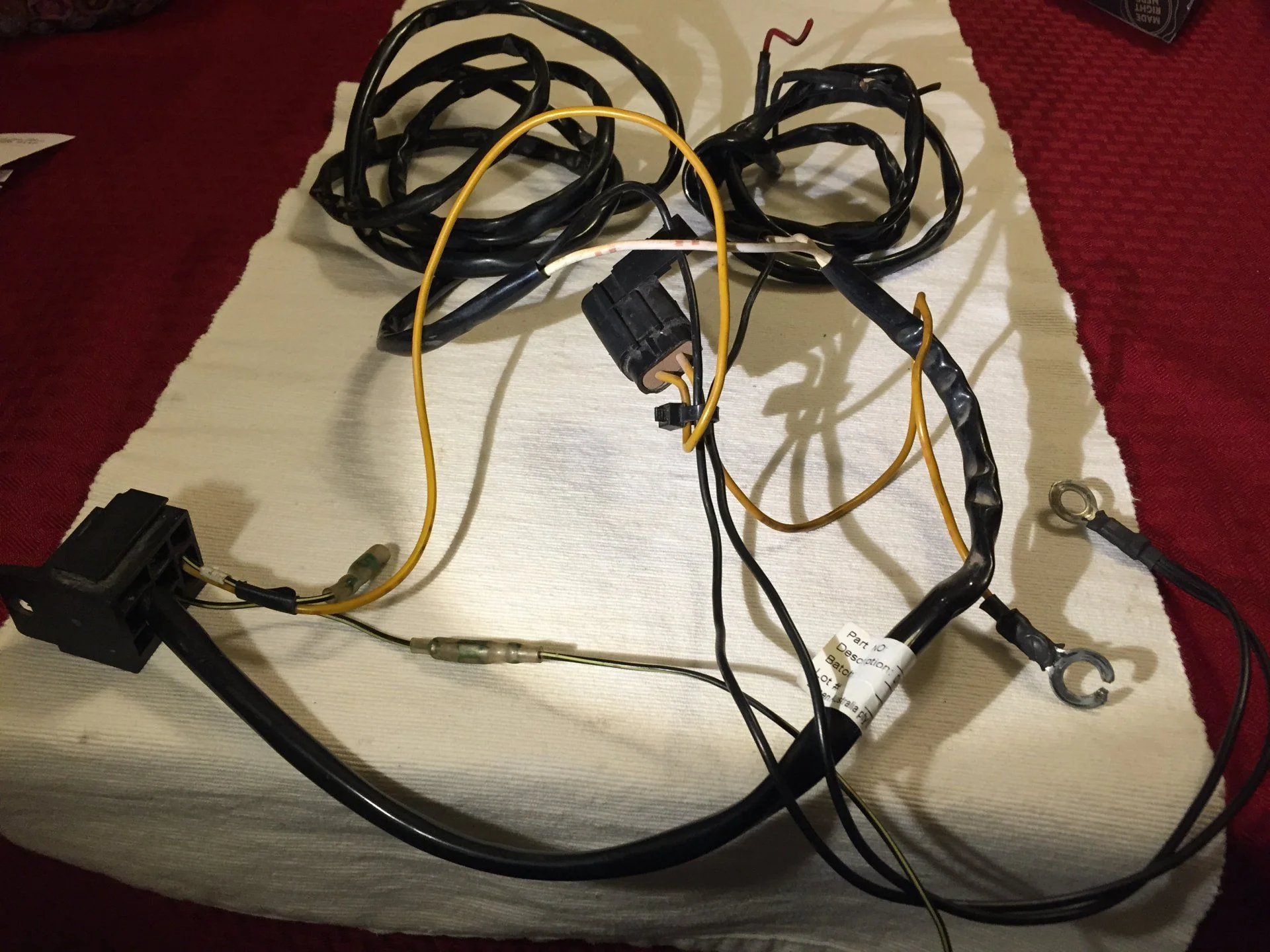

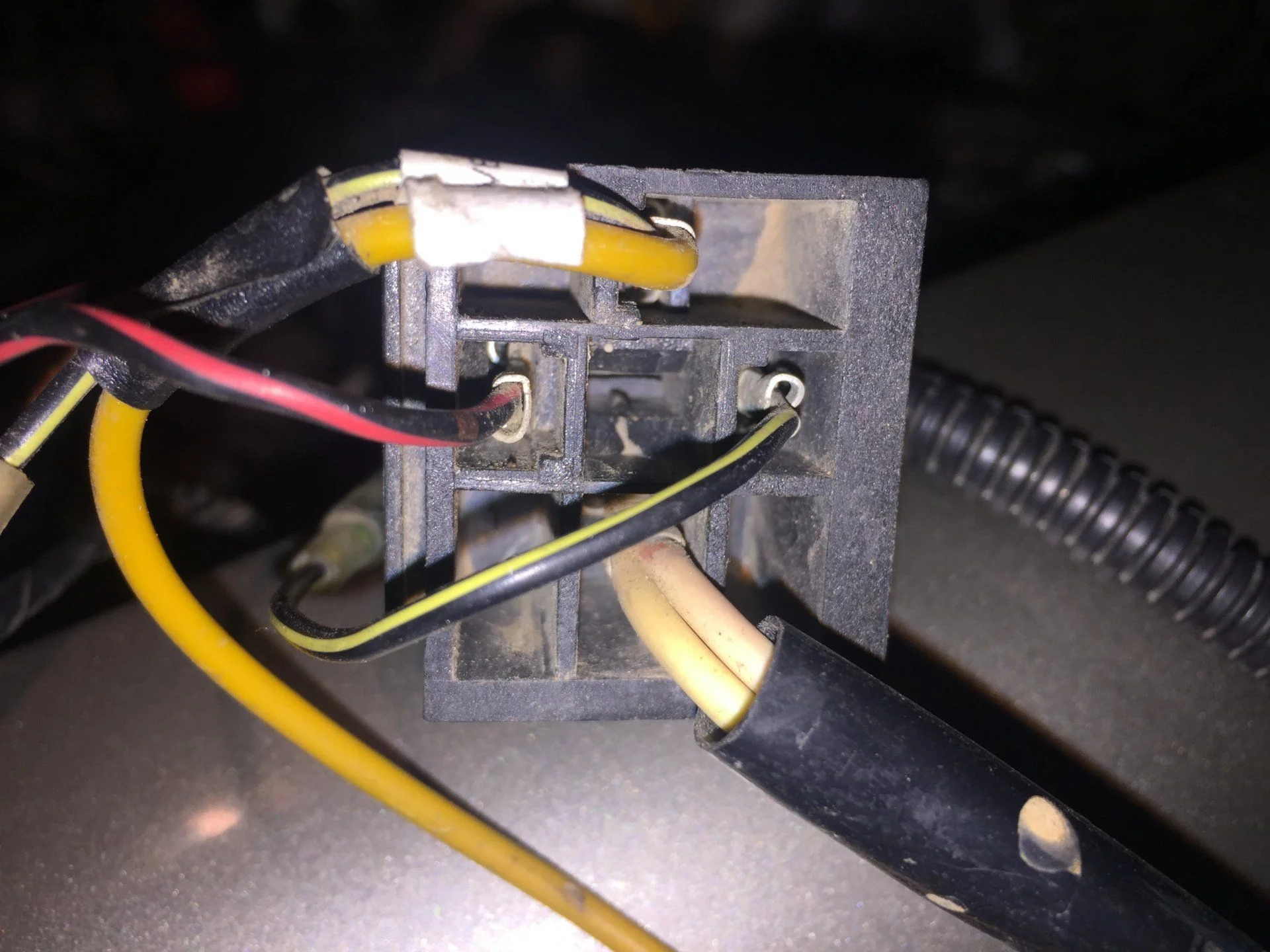

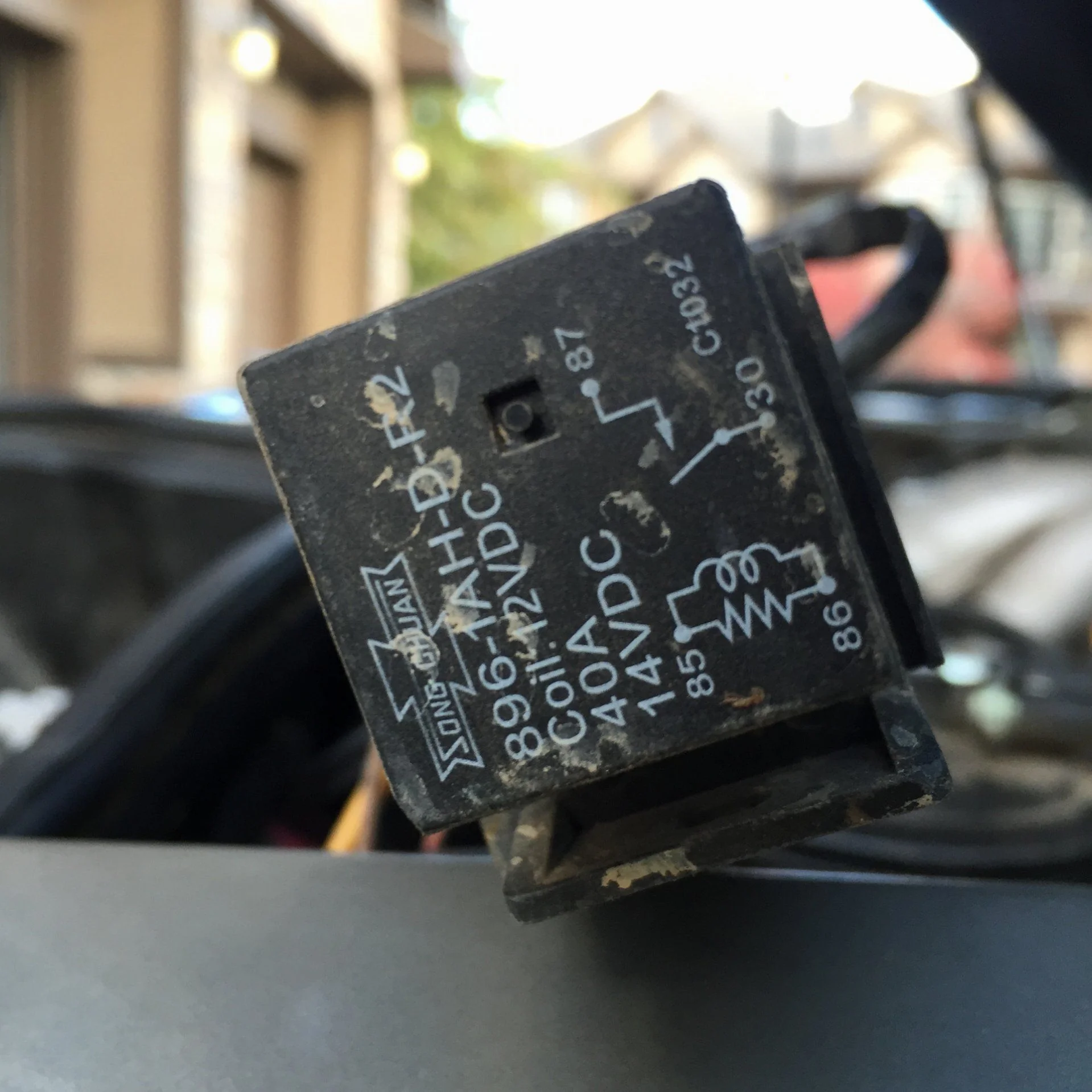

One last issue I have. I had some cables which seemed useless to me and by accident I disconnected (cutted) the cable going from the dash to the harness. The harness is LFDLH896 , there seems to be a coil (896-1AH-D-R2) with four connections , one from the dash which is probably the light switch , one cable is going from the coil splits and is probably going to the lights (two positives, two negatives) , there is one cable going from the coil to the positive of the battery.
As the lights were upgraded with lightforce wiring harness and fyrlyt 150w xenophot lights I thought that these cables are useless. The result is that now I don't have the headlight lights. Honestly I don't like the cables as it seems that only what it does is to power the light switch in the dash board. I tried to look into the wiring diagram but I am not really understanding what connects where.
Attached are the pictures:
The upgraded lights:
The wiring harness itself:
The coil:
Is there any other way how to proceed without putting this weird and old and probably failing in the future harness ?

Interesting, so what you call a coil I think most would call a relay. I wouldn't be too concerned about that going out, lots of people use relays, especially on auxiliary lighting. My 130w IPF's run a relay due to the fact that they draw power direct from the battery. Its not a bad idea to carry a few spare relays anyhow. You can get much higher quality 4 and 5 pin relays from the salvage yard if you go look around. I would just swap that one with a quality unit and put it all back in.
The coil:
Jorge
