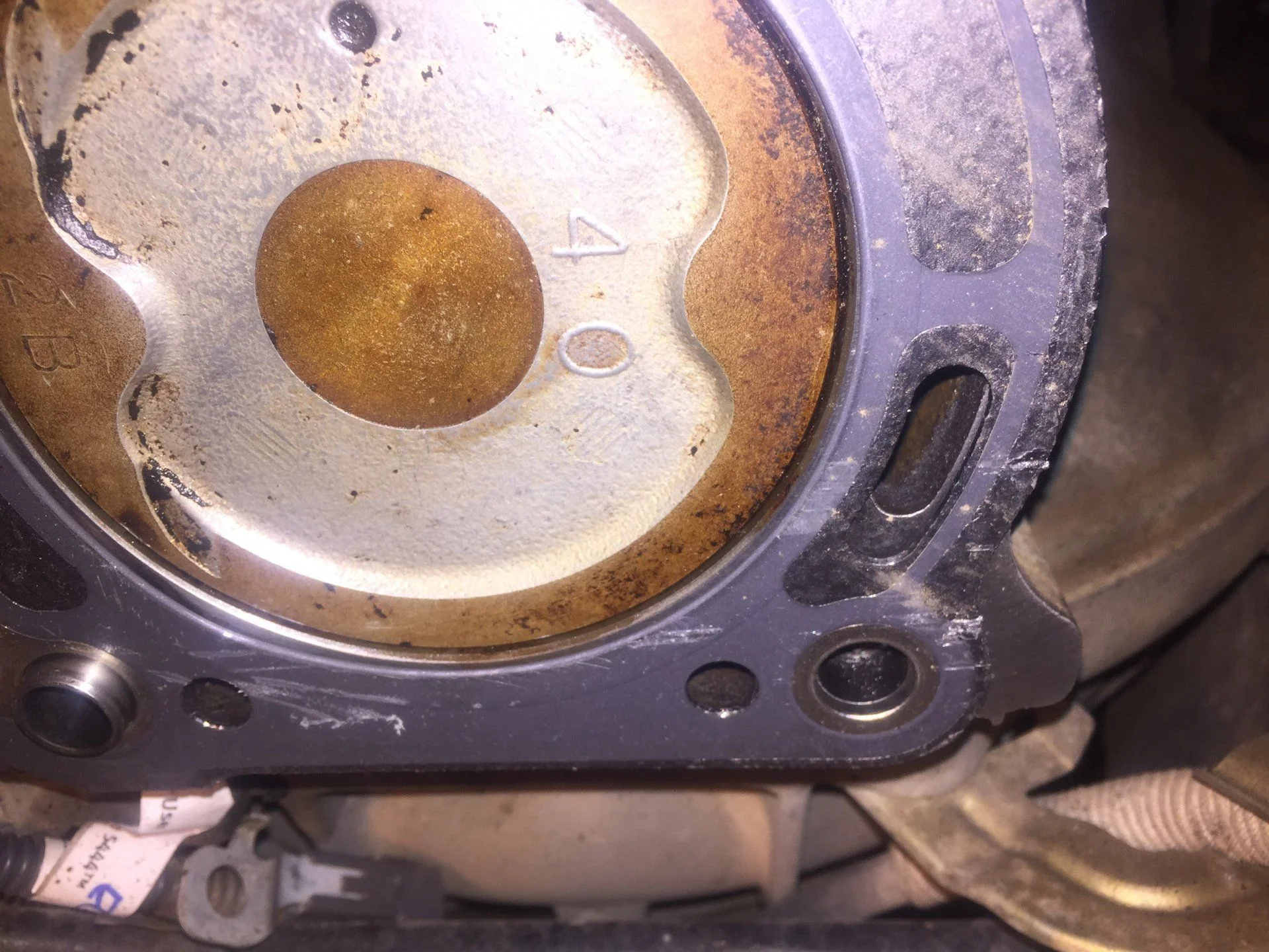

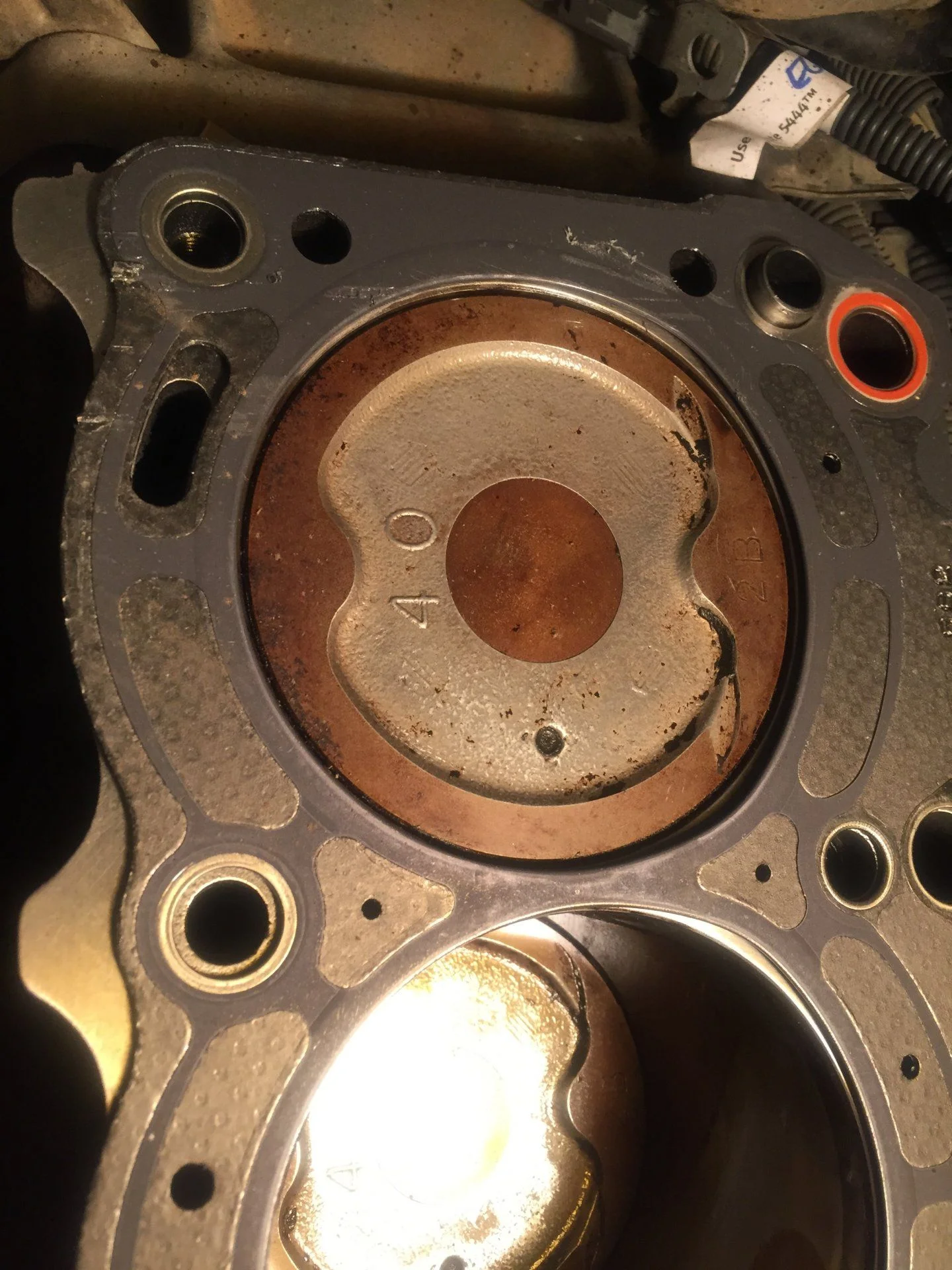

Shall I buy a new gasket, look around the cylinder #6. Seems some debris there even tho I was cleaning really a lot.
I scratched the gasket while trying to put the head in the first try.
@half k cruiser is worried :) I think that I will pay a visit to him just to show it - he also has a new one so could sell it to me immediately. You know if mountain wan't come to Mohammed then ... let's see what he says.

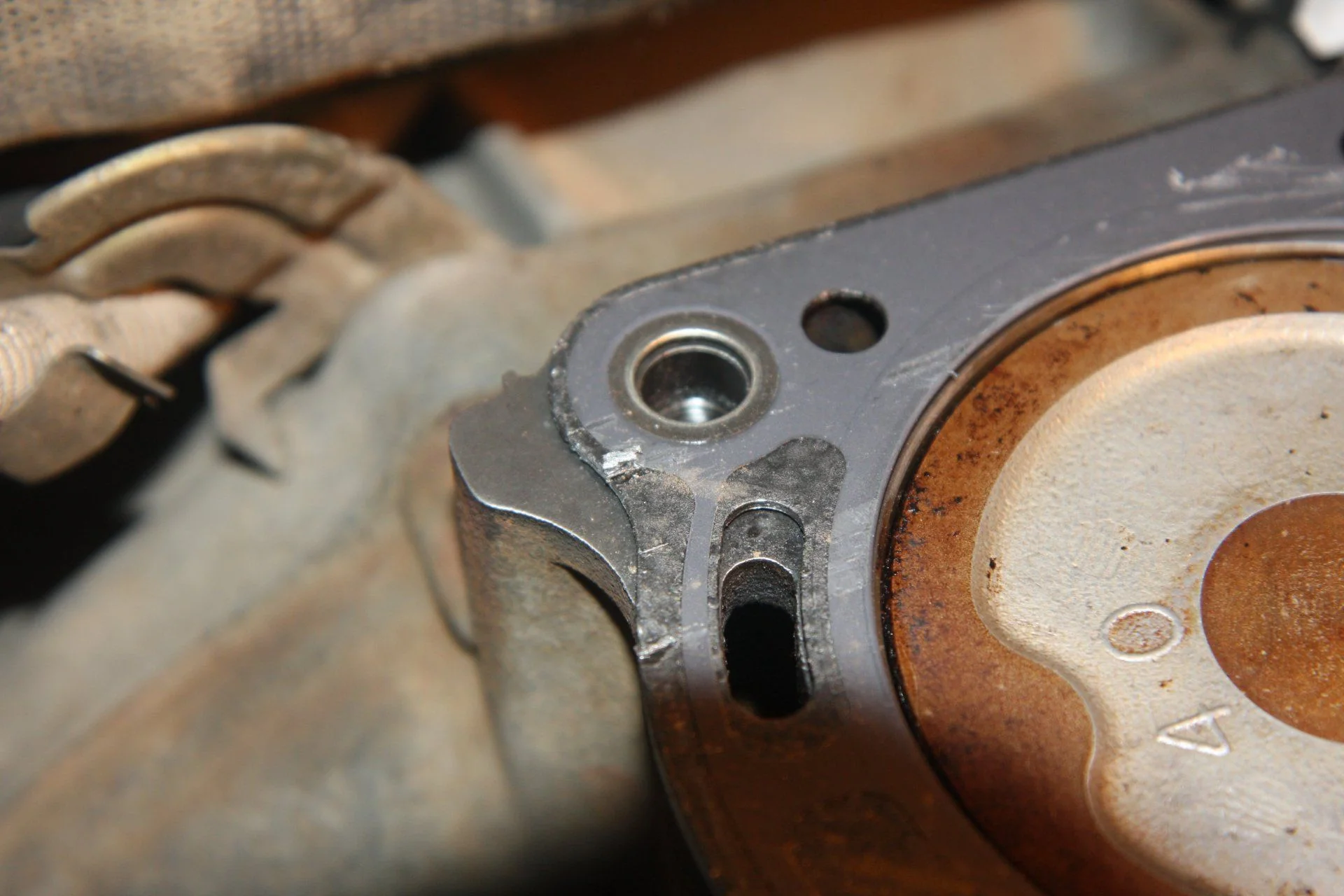

Here is the picture with bigger detail.
It is inconsequential. It looks like it is some protective coating. Aluminum doesn't scratch steel.

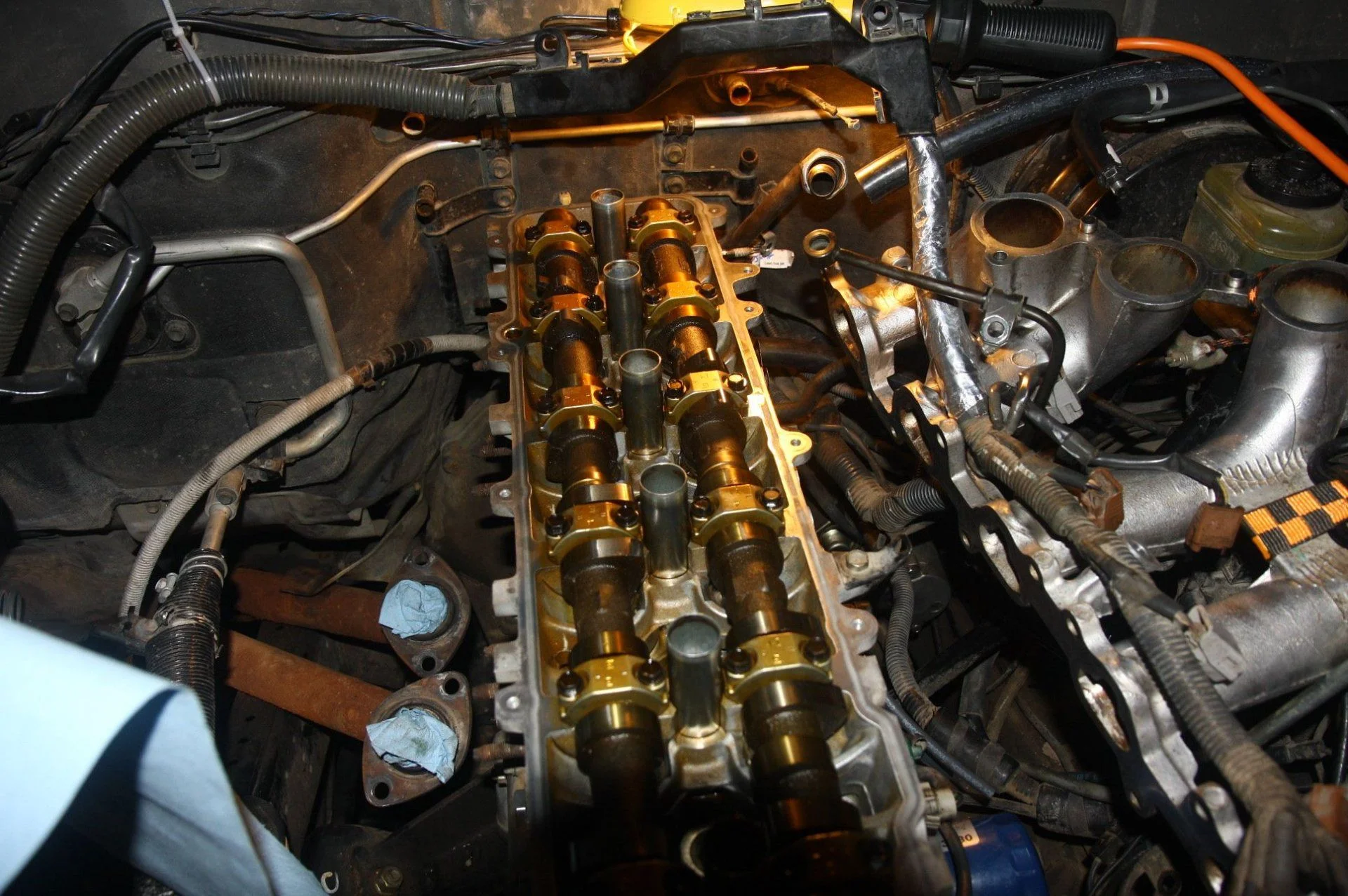

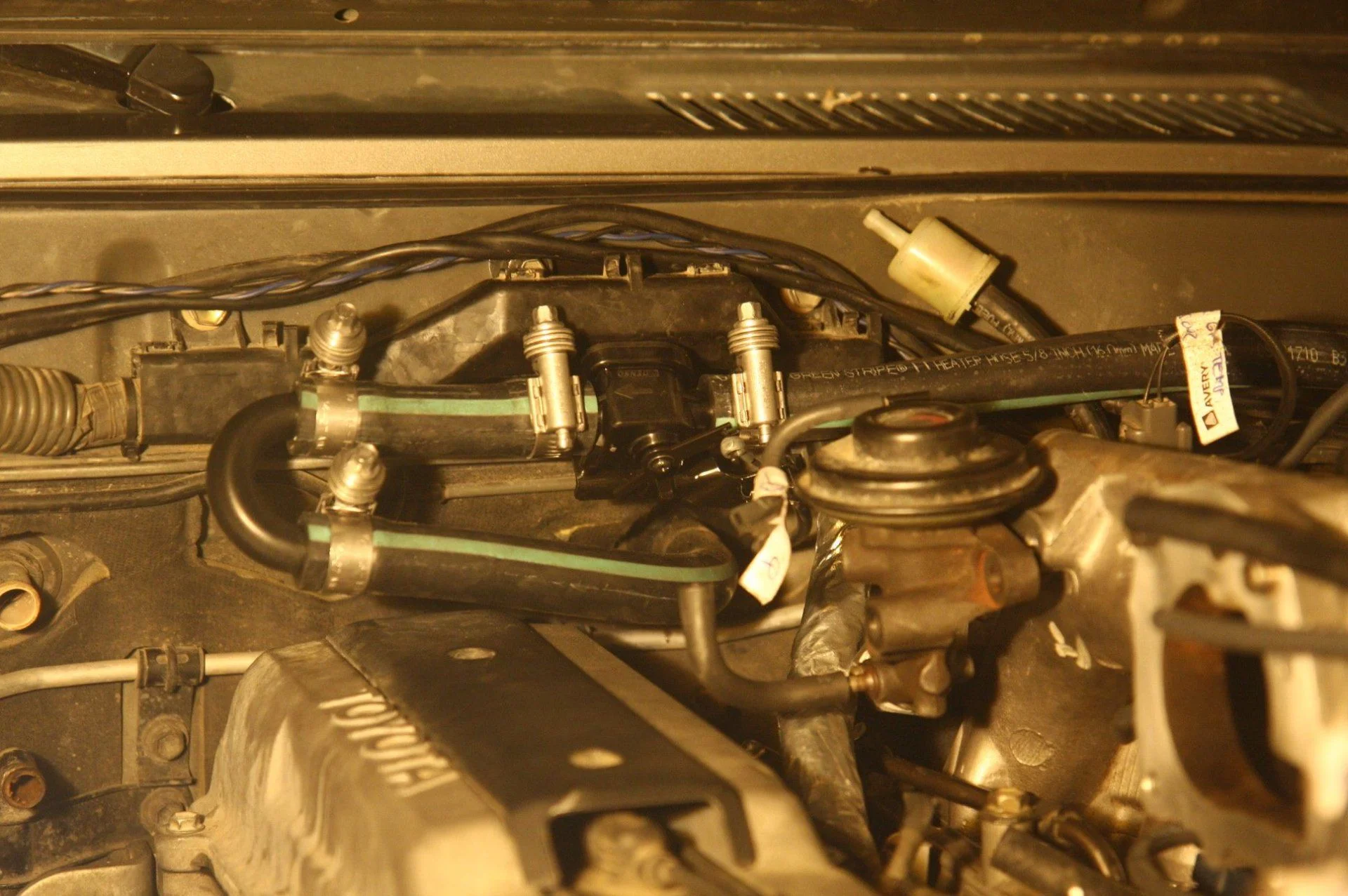

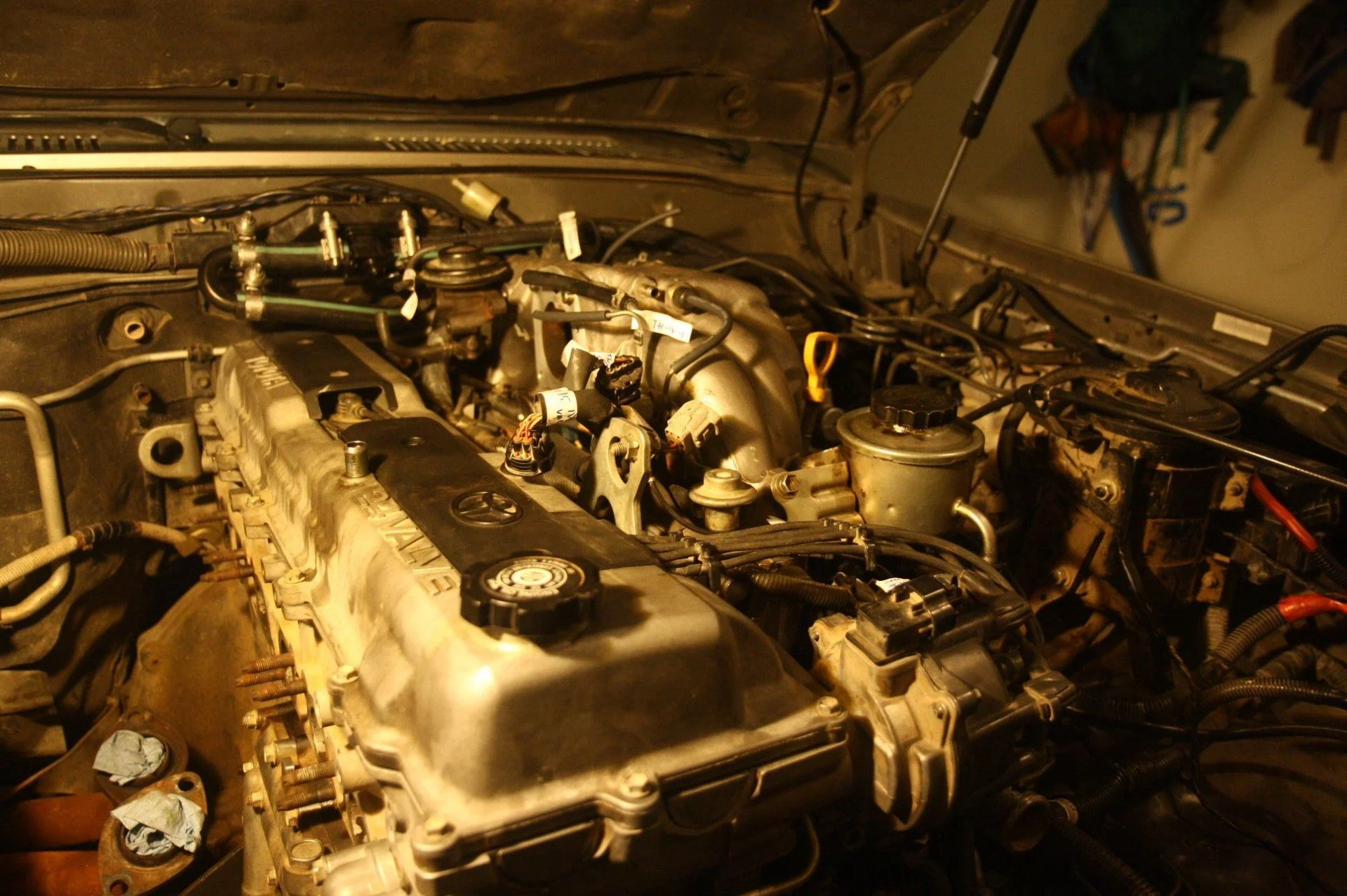

The head is back, thanks to @half k cruiser as he came yesterday and we put it back together. It wasn't that difficult at the end and he gave me a boost of confidence. Today I spent in the garage 8 hours and this is the list what I have done:
  • put valve cover
  • put distributor
  • put the upper intake manifold and bolted
  • water intake pipe
Here are some pictures:

Question at the end. It seems impossible to put the EGR valve back - either I can put it on the nut but then it doesn't go to the studs or if I start with studs then I am not able to put into nut :(
How did you guys solve this one ?
