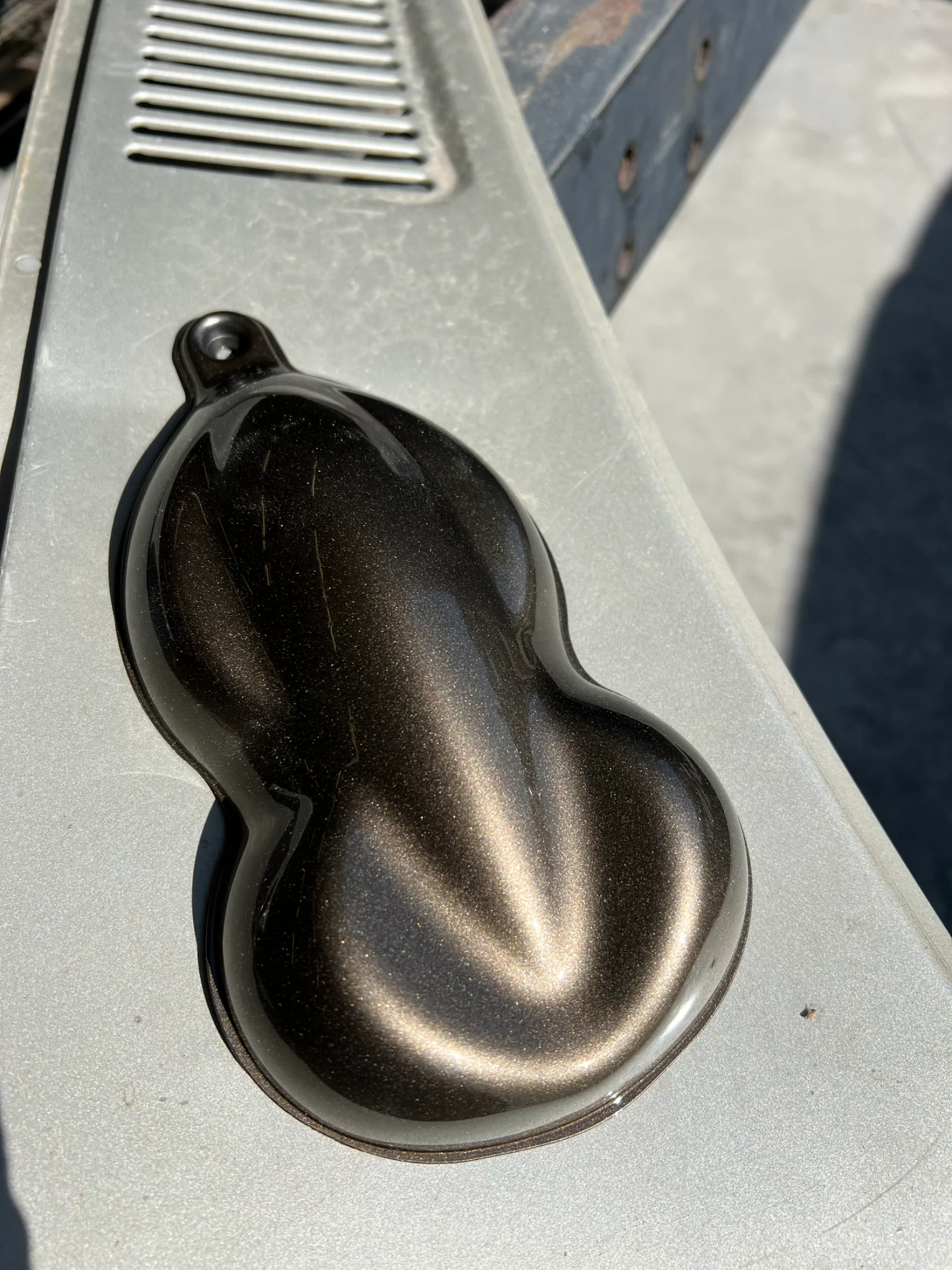

I have been thinking about finish, let’s say, coating on the body.
At one point I was set on a Raptor liner or similar tinted with the stock color code.
Now, not so much. Certainly would be the most durable but also will look the worst in my opinion.
Next in my head was good quality paint in the stock color but a soso spray job since I plan to wrap it.
I had a few days of thinking about getting crazy with paint and lots of clear coat with much less wrap. For example, I had an 80 years ago we sprayed “v8 Toyota Land Cruiser” down the side body line accent and lots of clear on top. Cruiser was dark gun metal with the accent/stencil white, I am a big fan of this kind of thing and think it looks great.
So at the moment not 100% sure which way I am going besides not bed liner. Heavily leaning towards a silver color of some sort, stock color is a beige/silver. I don’t want to go darker in color than a mid dark gun metal. Whether or not I do the paint fancy or not is to be seen as well as how much wrapping vs stencil type work.
Cheers

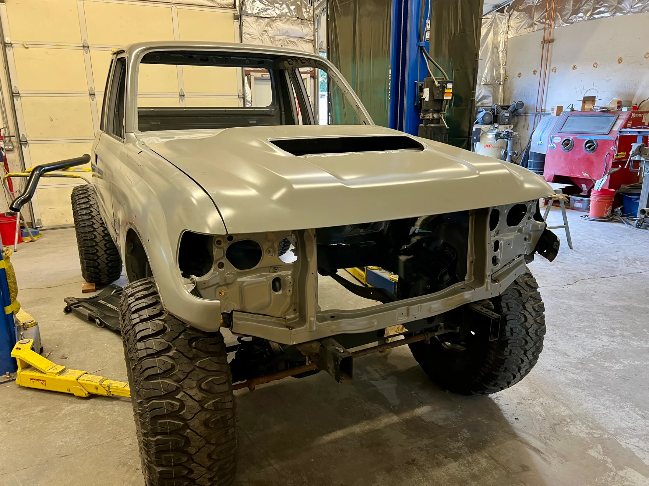

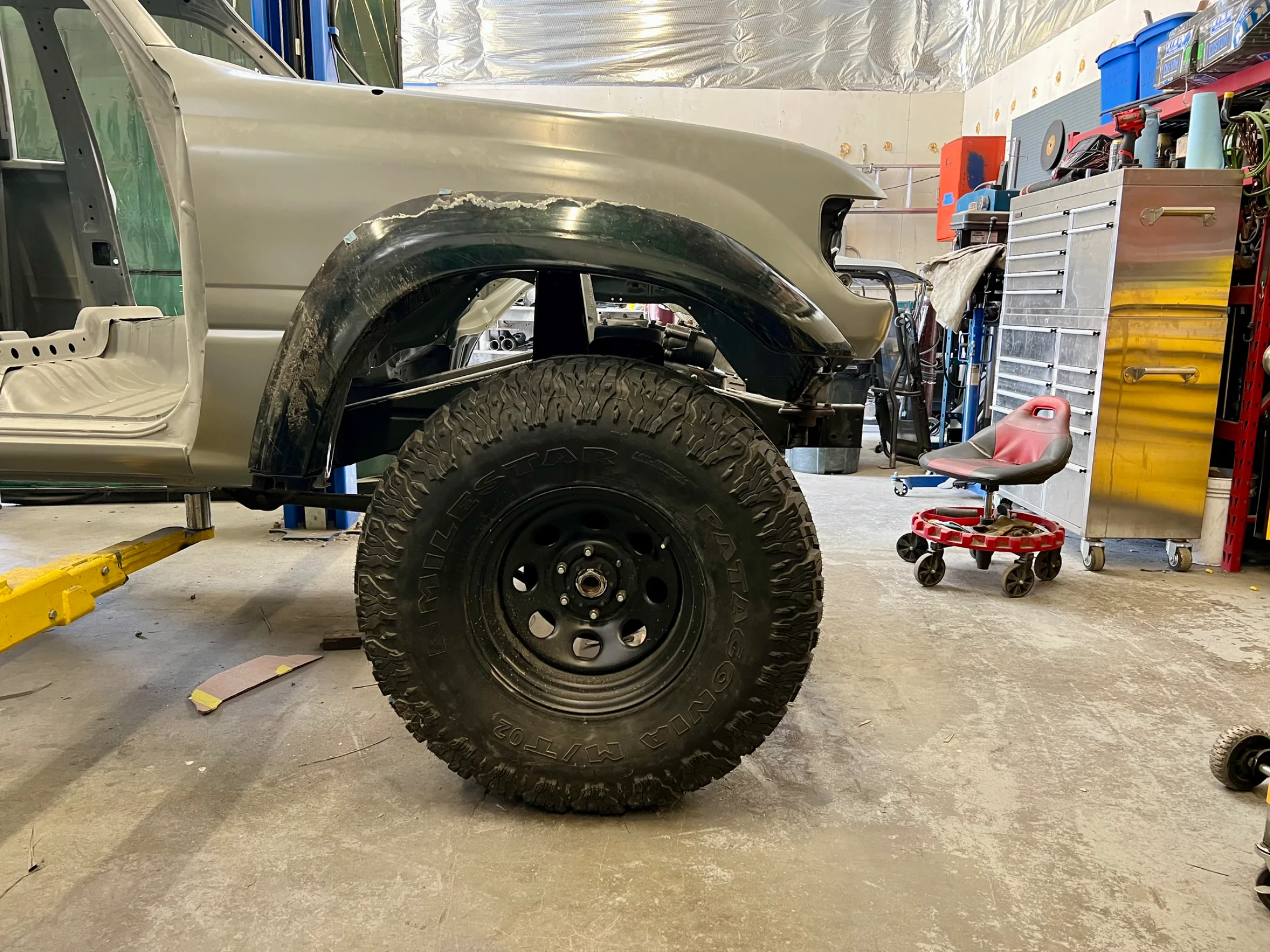

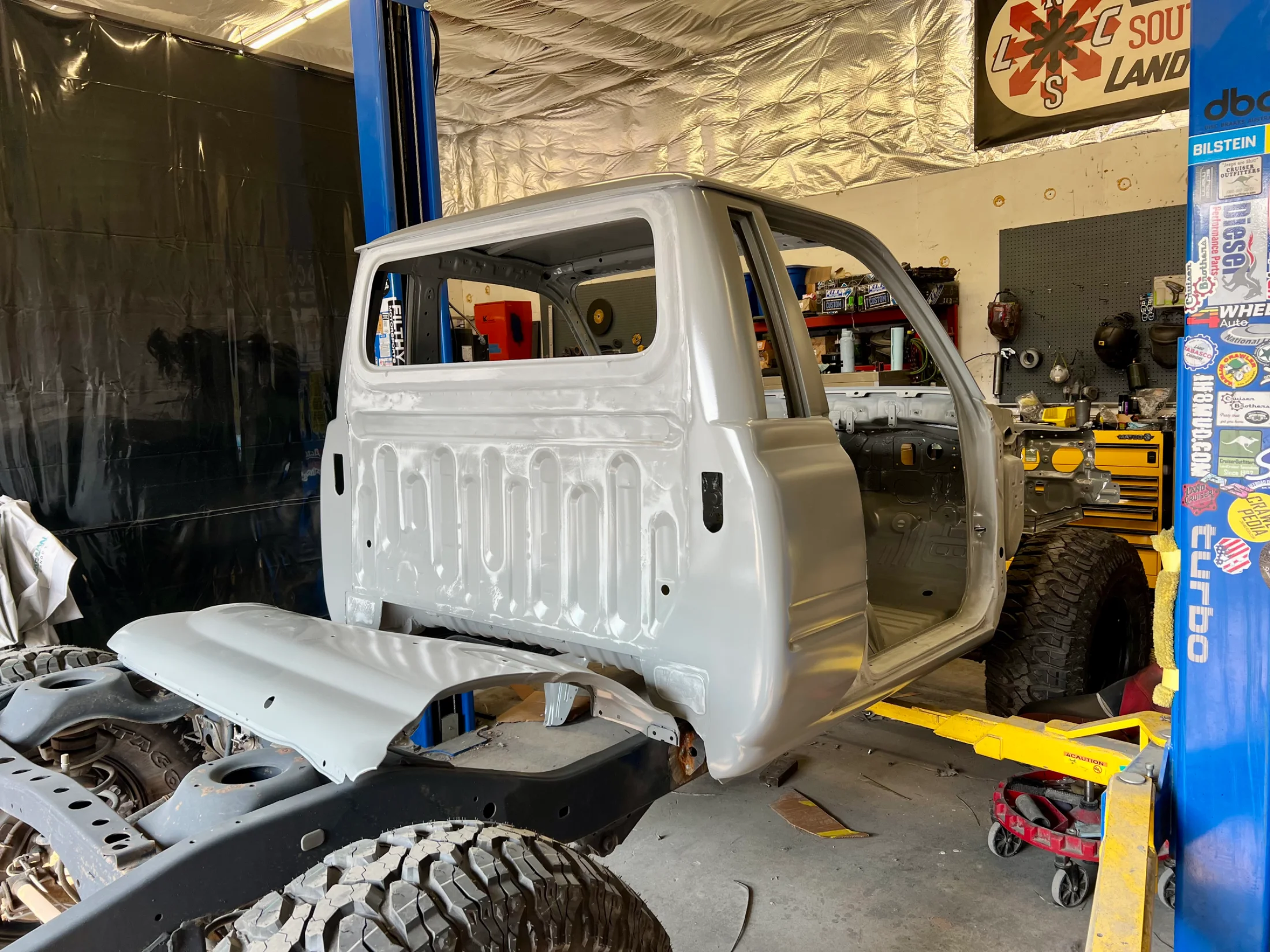

Assembled it mostly, purpose being we don’t want to finish out the front inner/outer fender & core support mods on a crooked body! 😑
Cheers

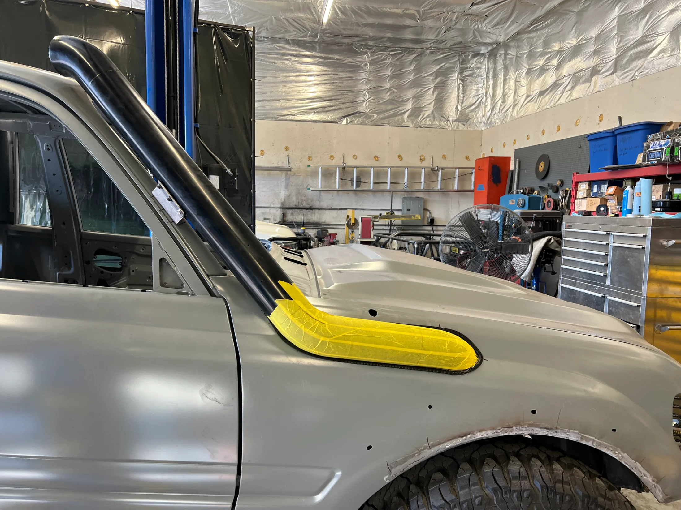

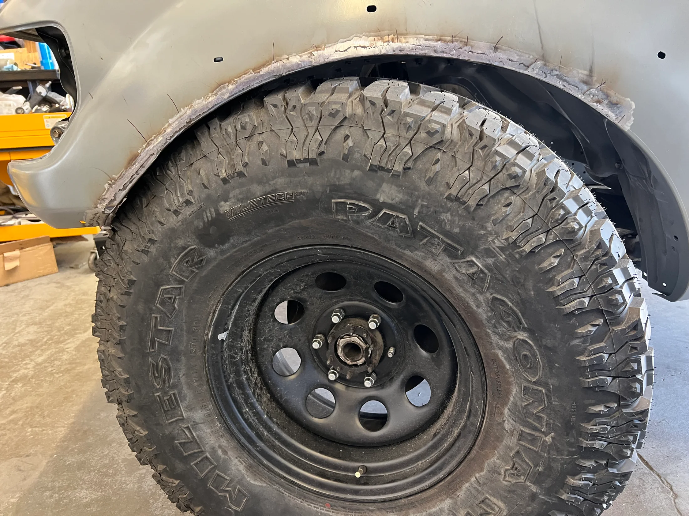

Radius Fab snorkel. Didn’t have the template or mounting bracket so freestyle’d it.
Cheers

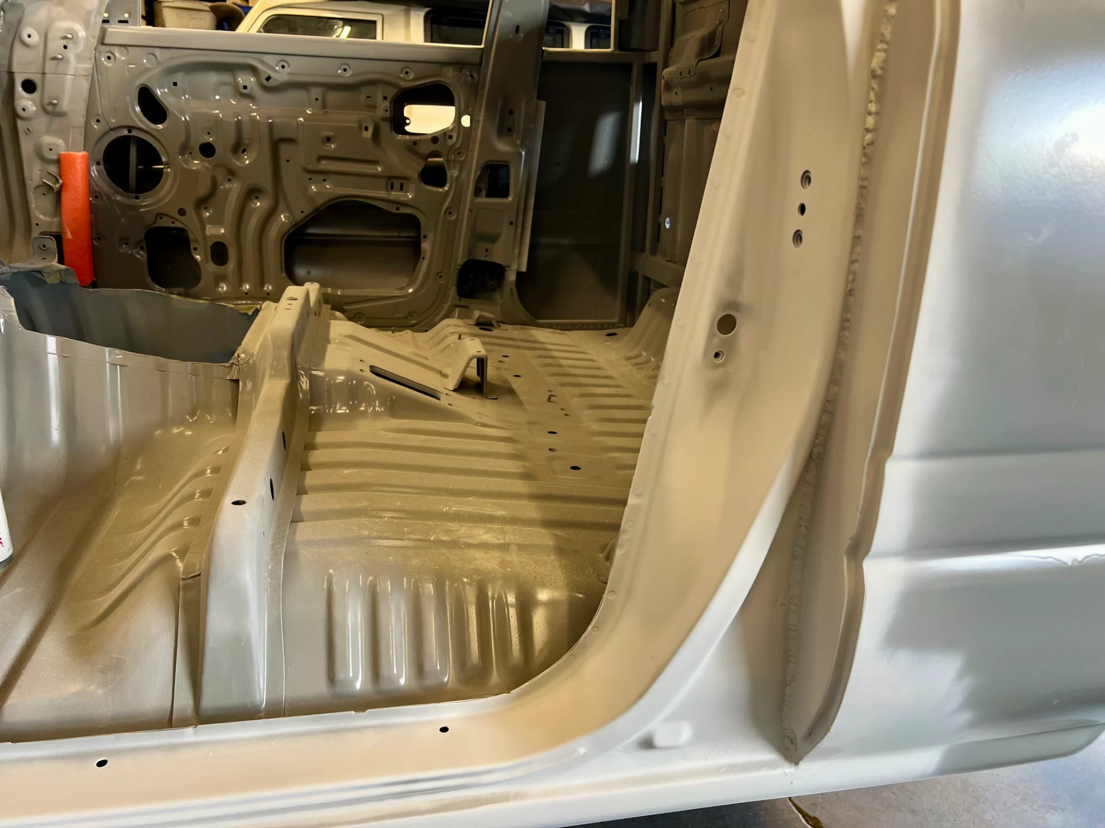

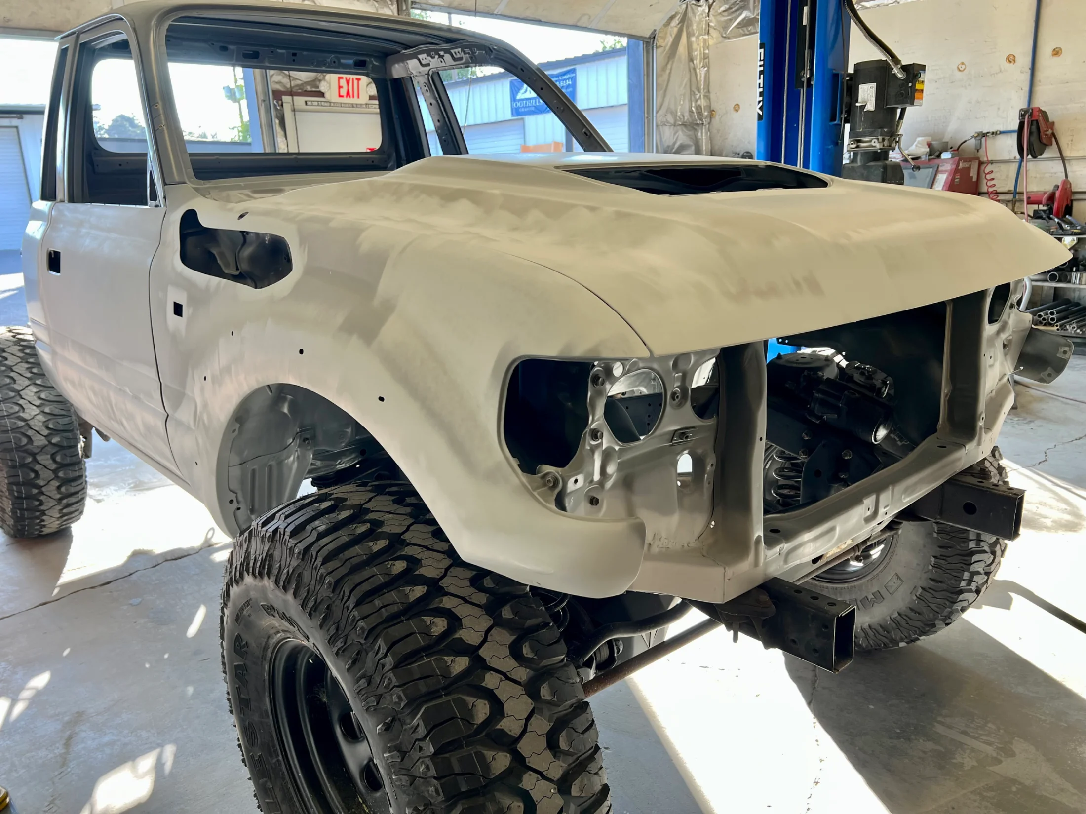

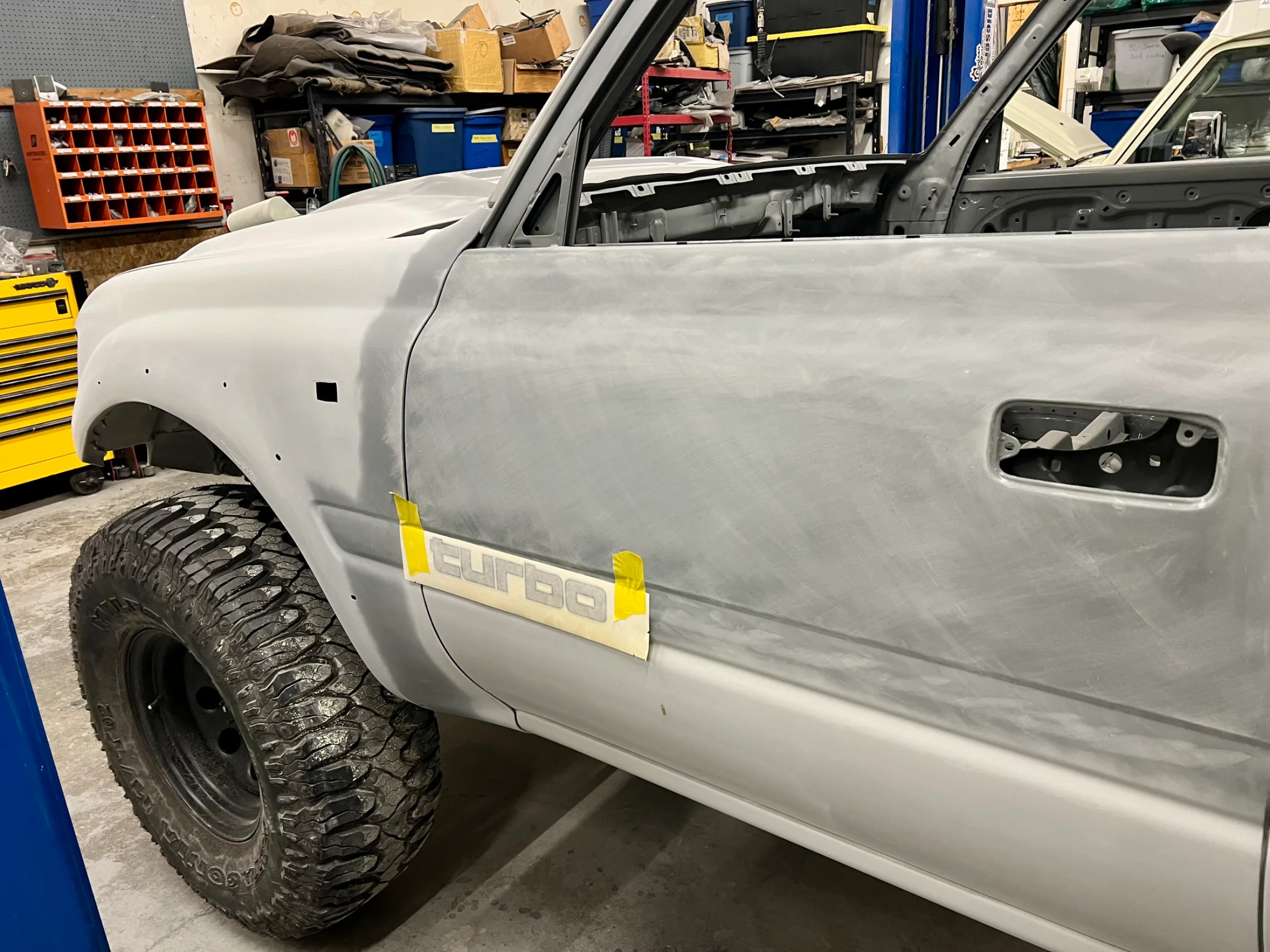

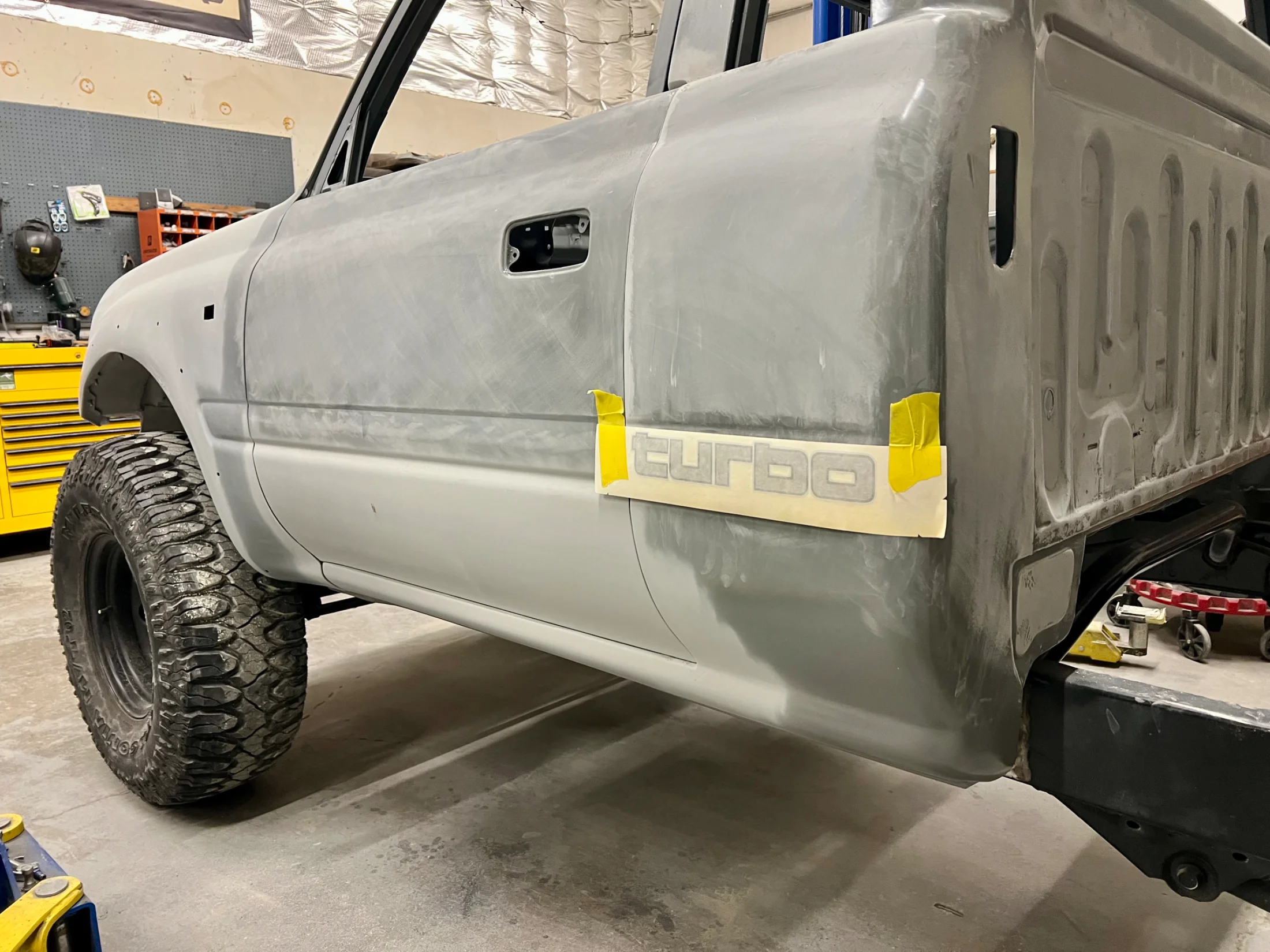

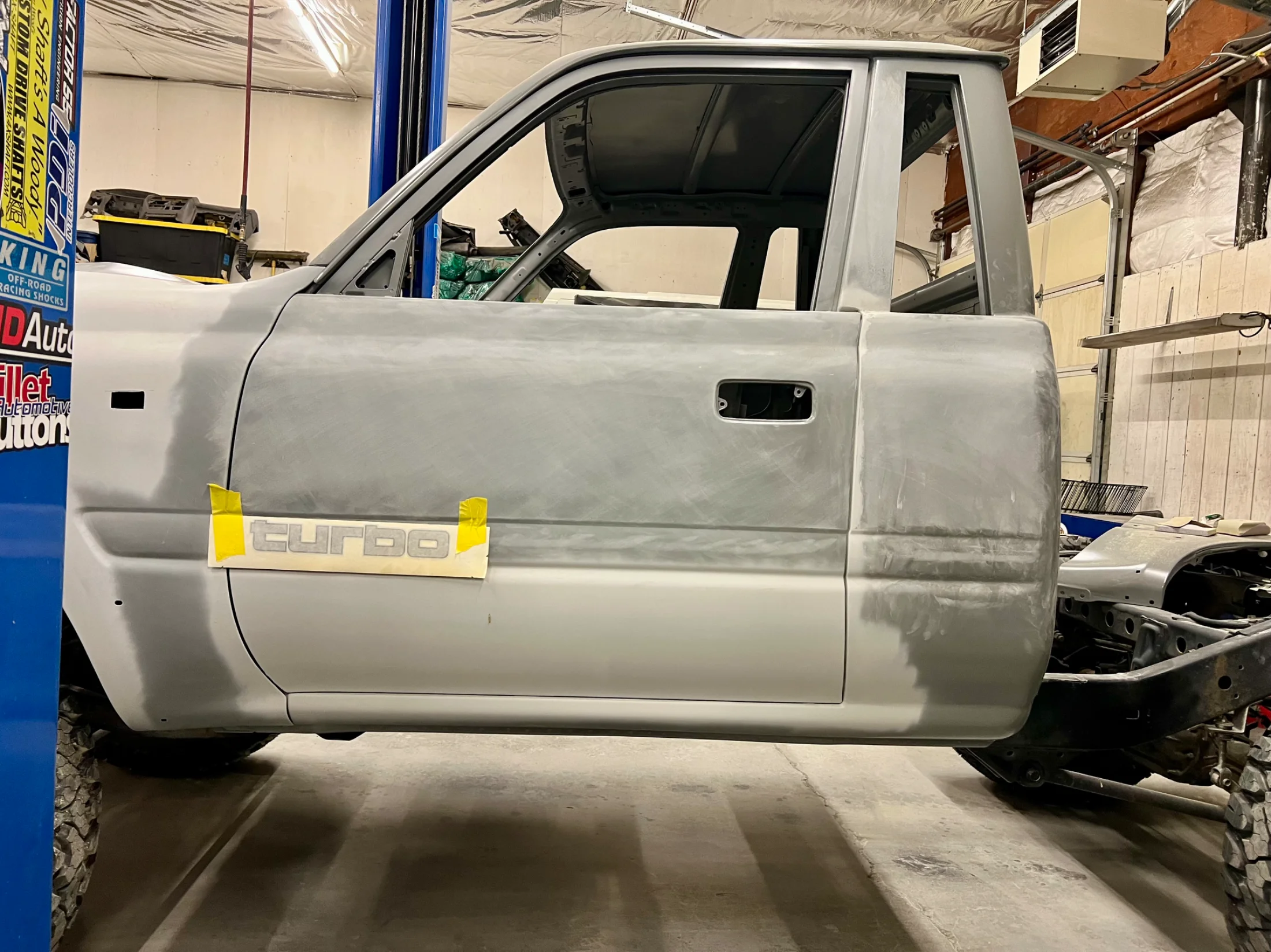

We are done with filler and are now block sanding in prep for sealer and paint. I am going to push through on it and get it in paint before it gets pushed aside again.
Cheers

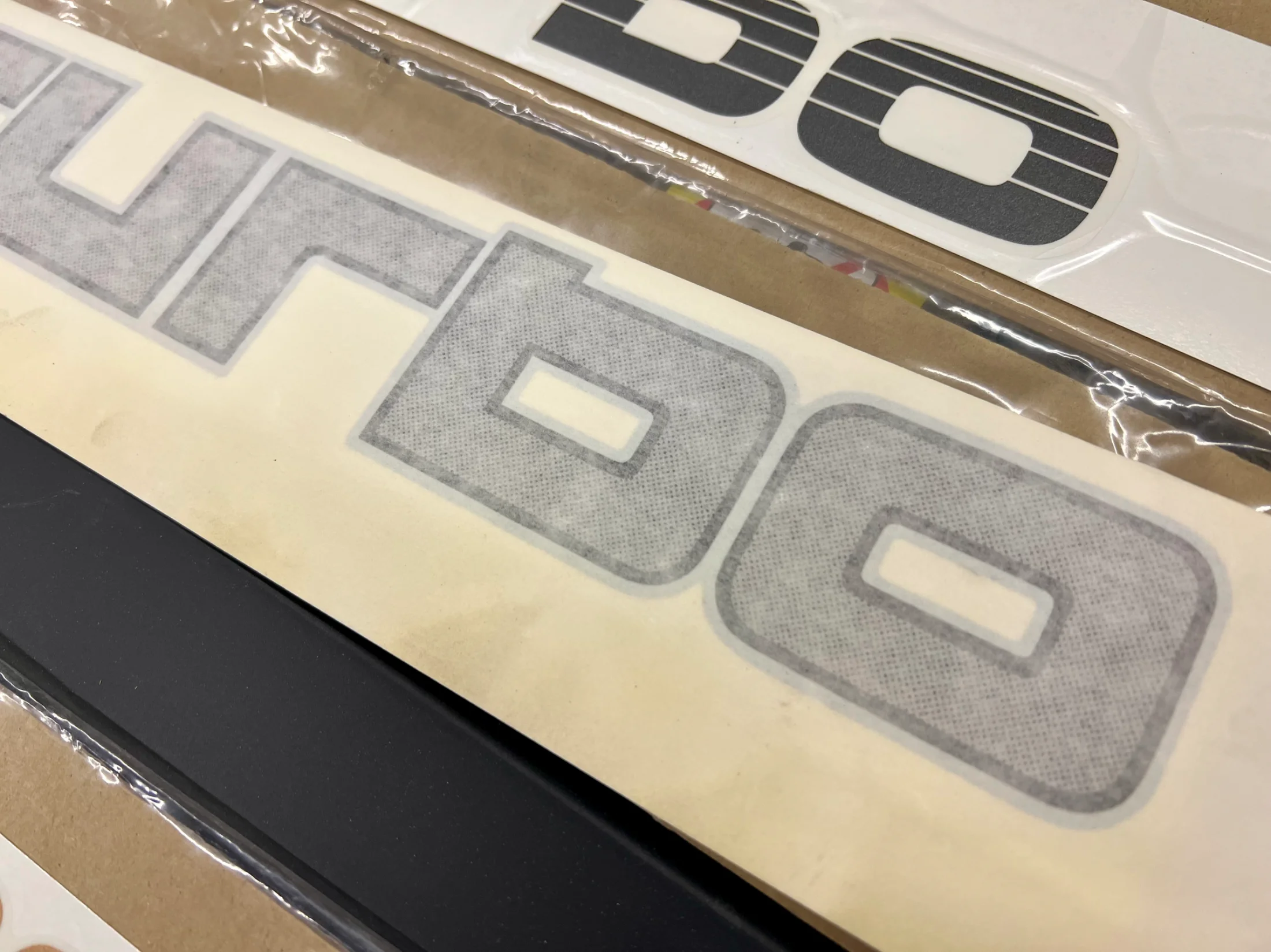

A few OEM accent decals I have. Top is HDJ80/81, middle is BJ74 or HJ60 (13bt or 12ht, I don’t recall but 1980’s), and bottom is HDJ79 1HDFTE.
I Like this one the most.
1HDFTE decals
Anyways, probably going to get crazy with some stencils and some sweet “retro” accents and integrating these decals well.
Thick clear on top of all that! 😂😝🤙
Cheers
