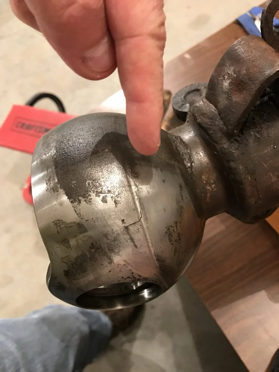

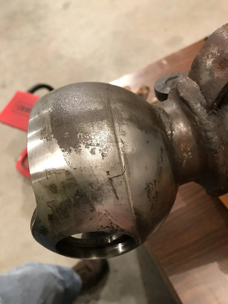

I'm close to ready to start reassembly.
Above 4 pics of the balls show rust and pitting. I'm wondering if this looks okay to proceed with.
That line indicated by my finger is sort of a slight groove. Just wondering if that's cause for concern.

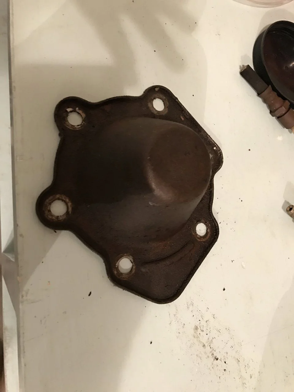

I need a gasket for this transfer case rear cover. Where can I get one? OEM? Anyone have the part number?

I also decided not to use the housing for the later axle I bought. The balls on the ends of the housing are not in great shape. I'm gonna put the later outer parts on the older housing. It's more work, but should be worth it.
