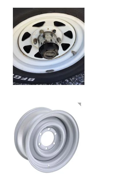

The MP40 came to me with spokers on it. (Top Photo)
I'm liking these Series 12 Vintiques. (Bottom Photo) Does anyone know if 15x7's or 15x8's will fit an FJ40?

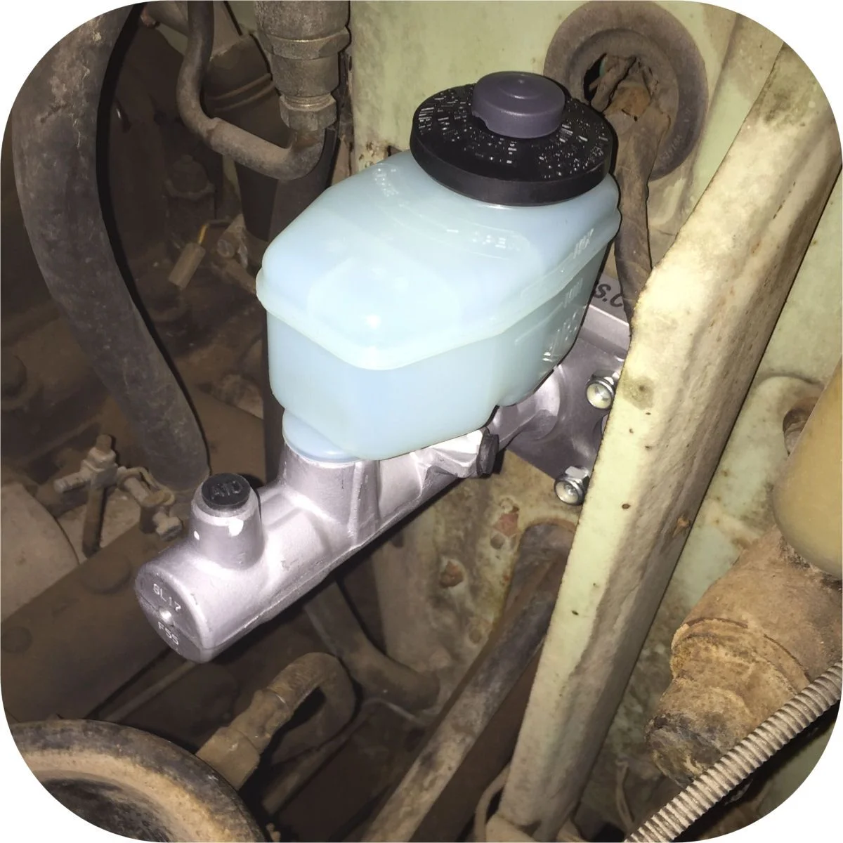

I make a slimmer version of that firewall adapter. I run a large bore, dual circuit non- boosted master on all my trucks. You can do the conversion now, and the disc changeover later, if you still want. Like LITP, my brakes are lock-up solid .

@65swb45 - I like the idea of using a non-boosted, twin-circuit master cylinder on the MP40. So, I'll give it a try. Can I source the slim firewall adapter and MC from you? (I'd also like to buy that NOS wingnut you mention.)
Can you please put up a picture of that adapter/master combo?
If I understand you right, I can install this MC and run my drum brakes for now. Later, when I switch over to discs, this MC will work for that, too. Please make some recommendations for me: When I install this MC, do I need to plumb both front and rear with new 10mm lines? How do I adapt the drum brakes to these larger lines? Is there some kind of an adapter? Or do I plug one of the MC circuits for now and just use all of my single circuit plumbing for now, then change over when I go discs.

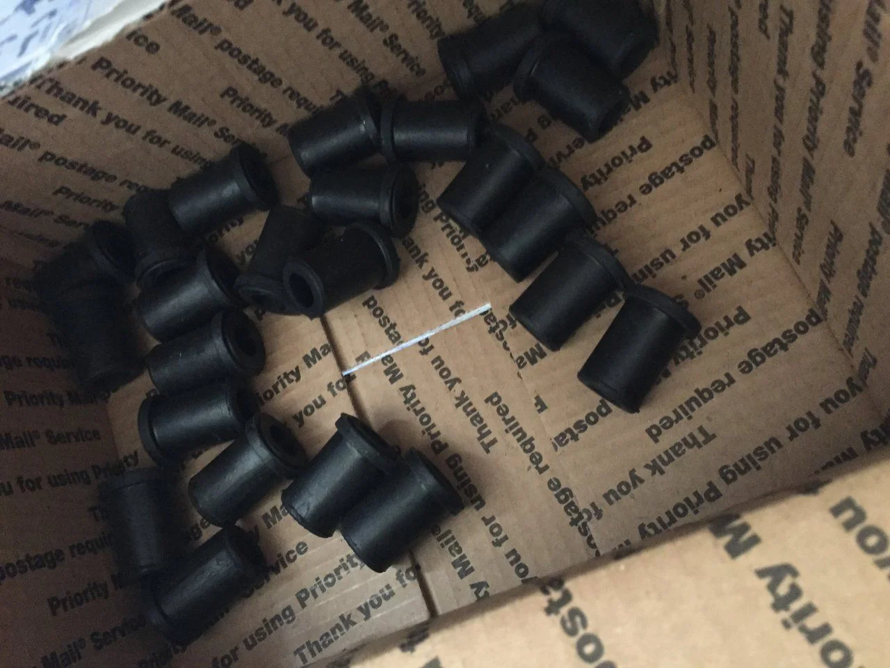

Sprayed PB all over the spring shackles and pins. Gonna be replacing bushings so the advance penetrant will help with that effort.

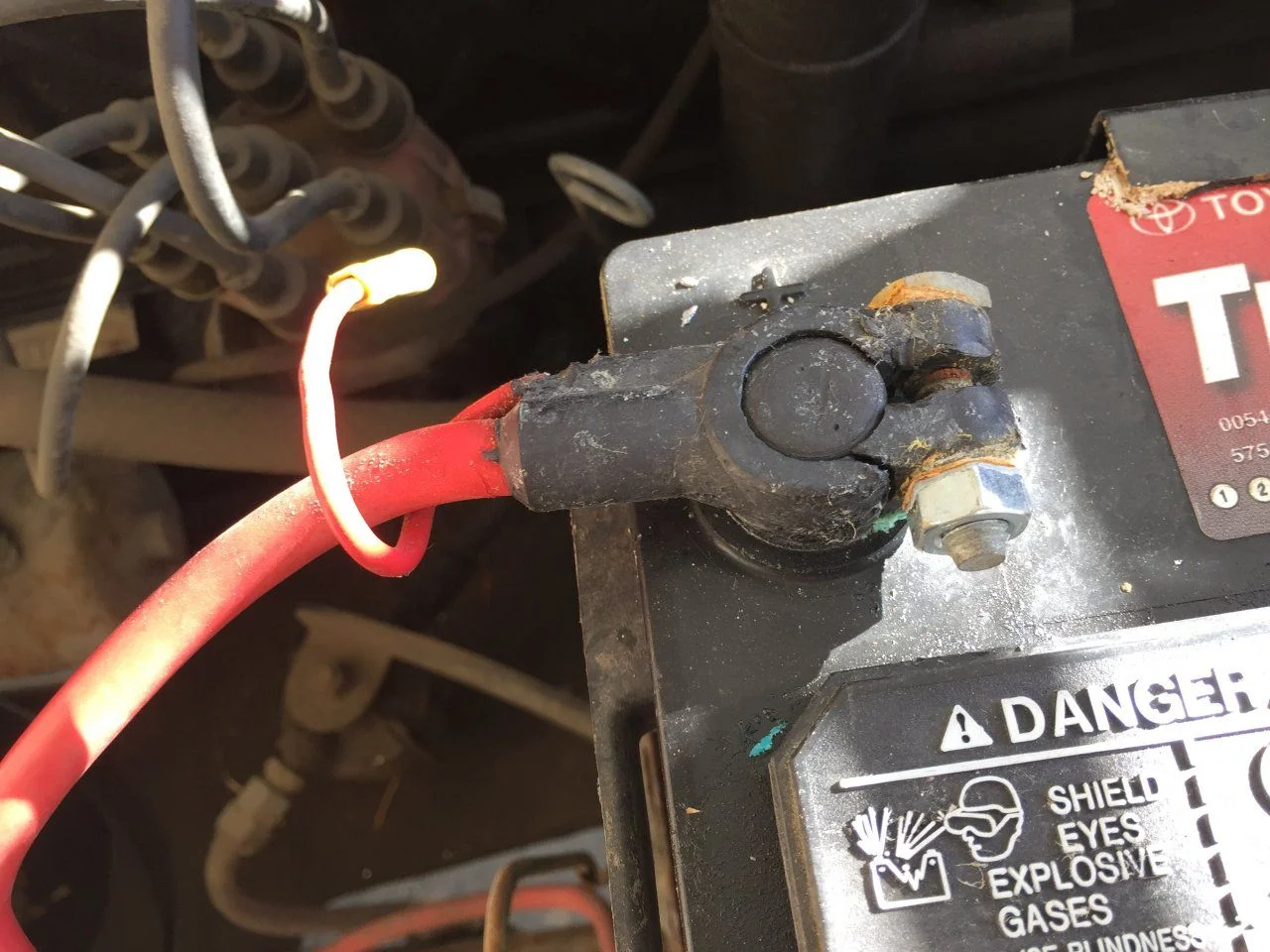

I think this cable clamp is too big for the battery post.
This clamp is kinda cracked.
Alfred
I separate the front from the rear at the battery tray junction, right after the feed to the right front wheel. I modify the line from the single circuit master to go in the forward fitting on the dual, and run a line across the firewall from the rear fitting to the junction block on the passenger framerail where the ground strap attaches.

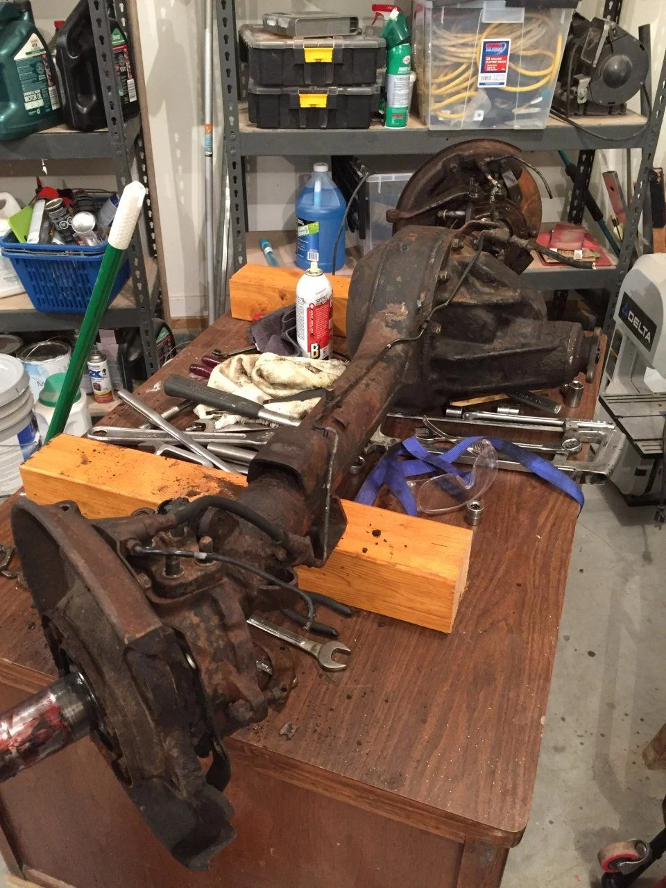

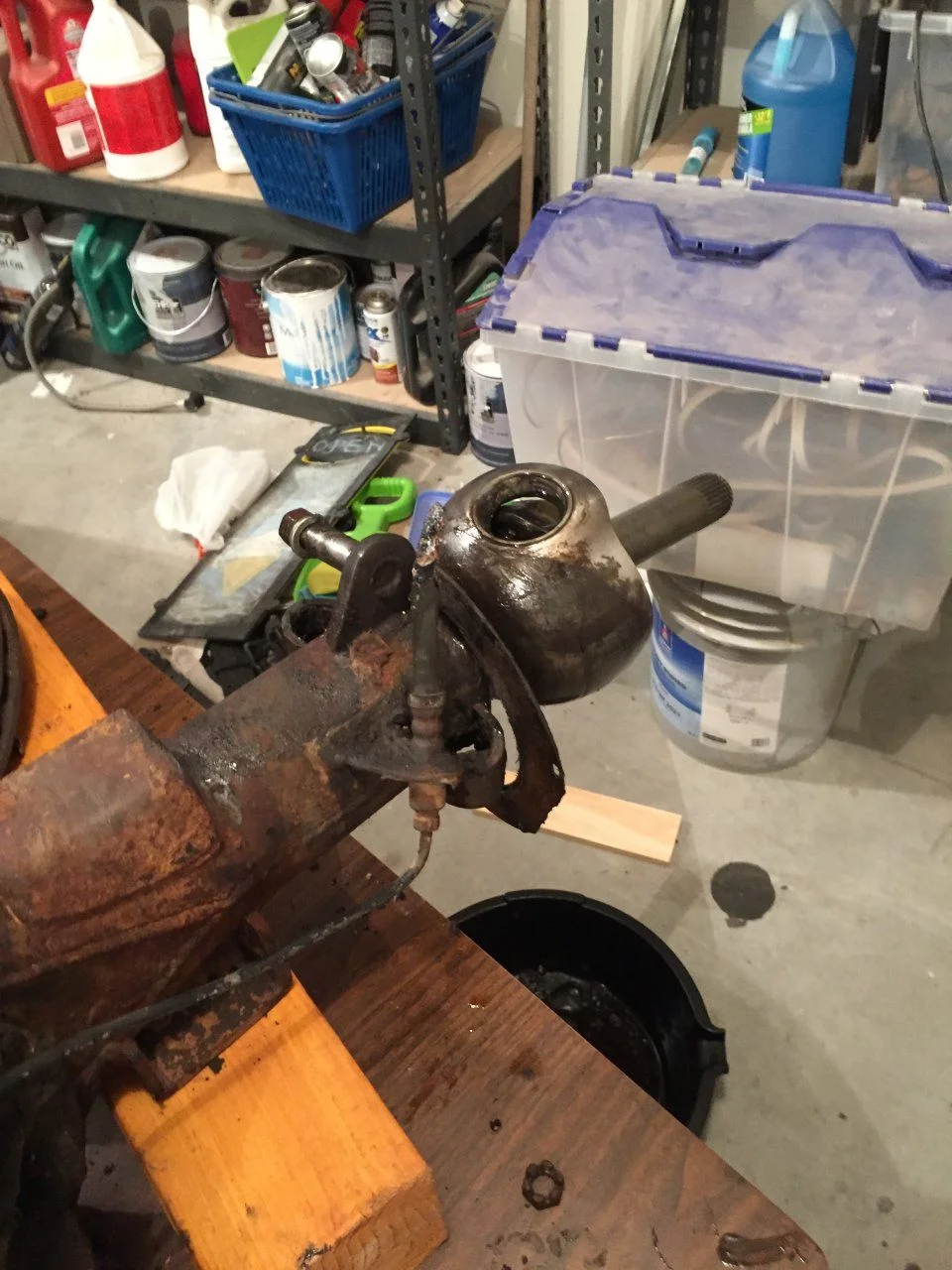

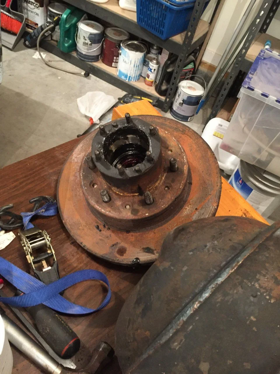

Made a little progress today. Hauled the axle to the car wash. Sprayed most of the crud off it. Got it up on the bench and started the tear down.
