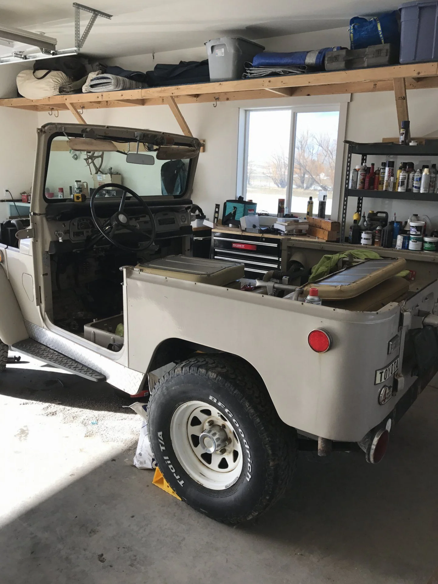

Finished removing the top.
Removed the front seats.
Removed the tranny hump, which was held in with 4 of the original 12 bolts.

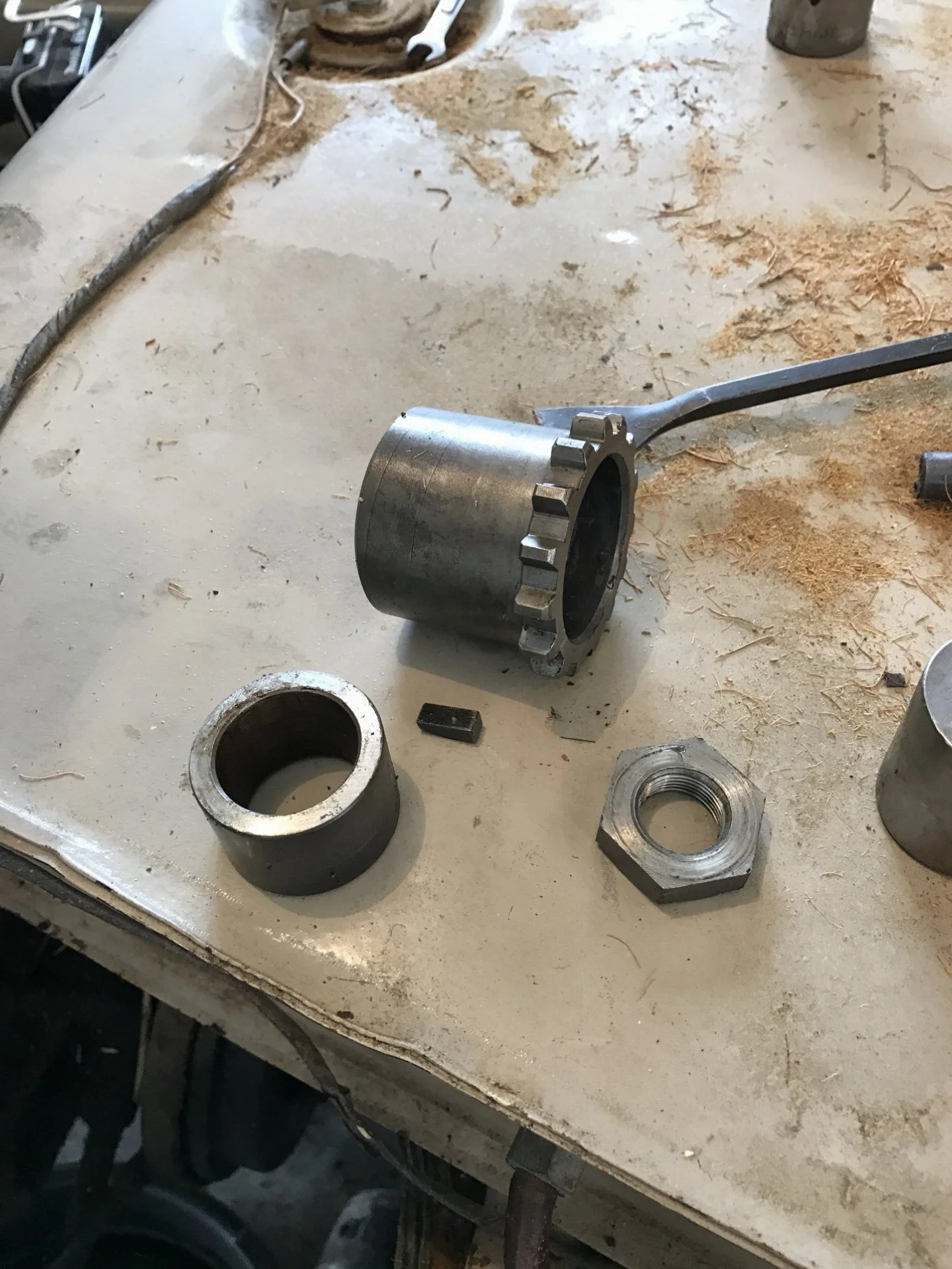

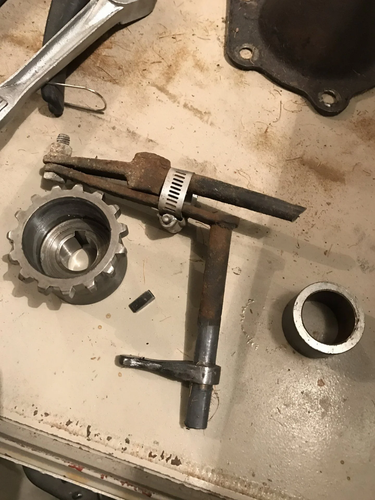

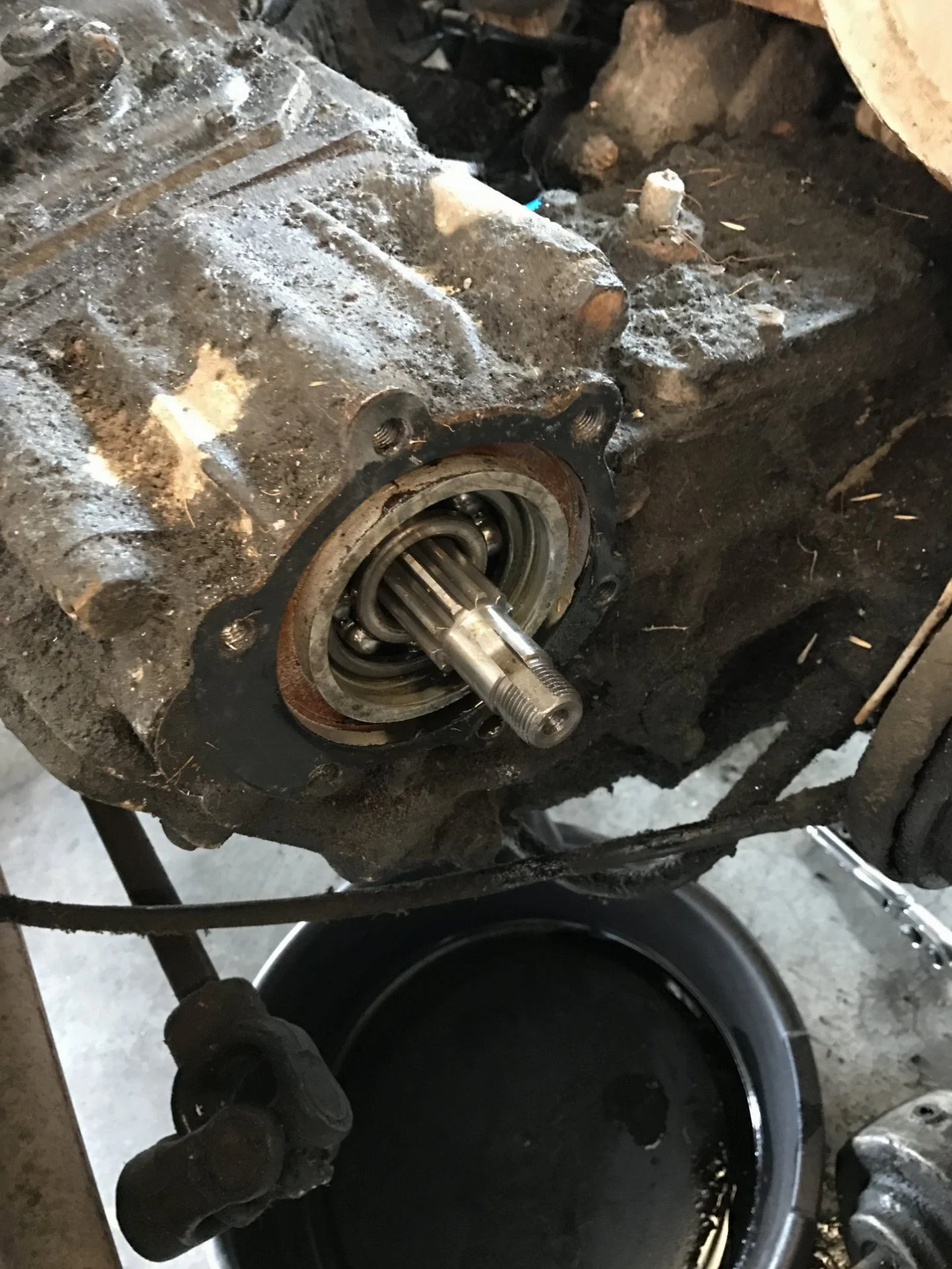

Was then able to remove the PTO winch gear case and the adapter.
I need the sleeve, washer & lock nut. (If anyone has spares, please let me know.)

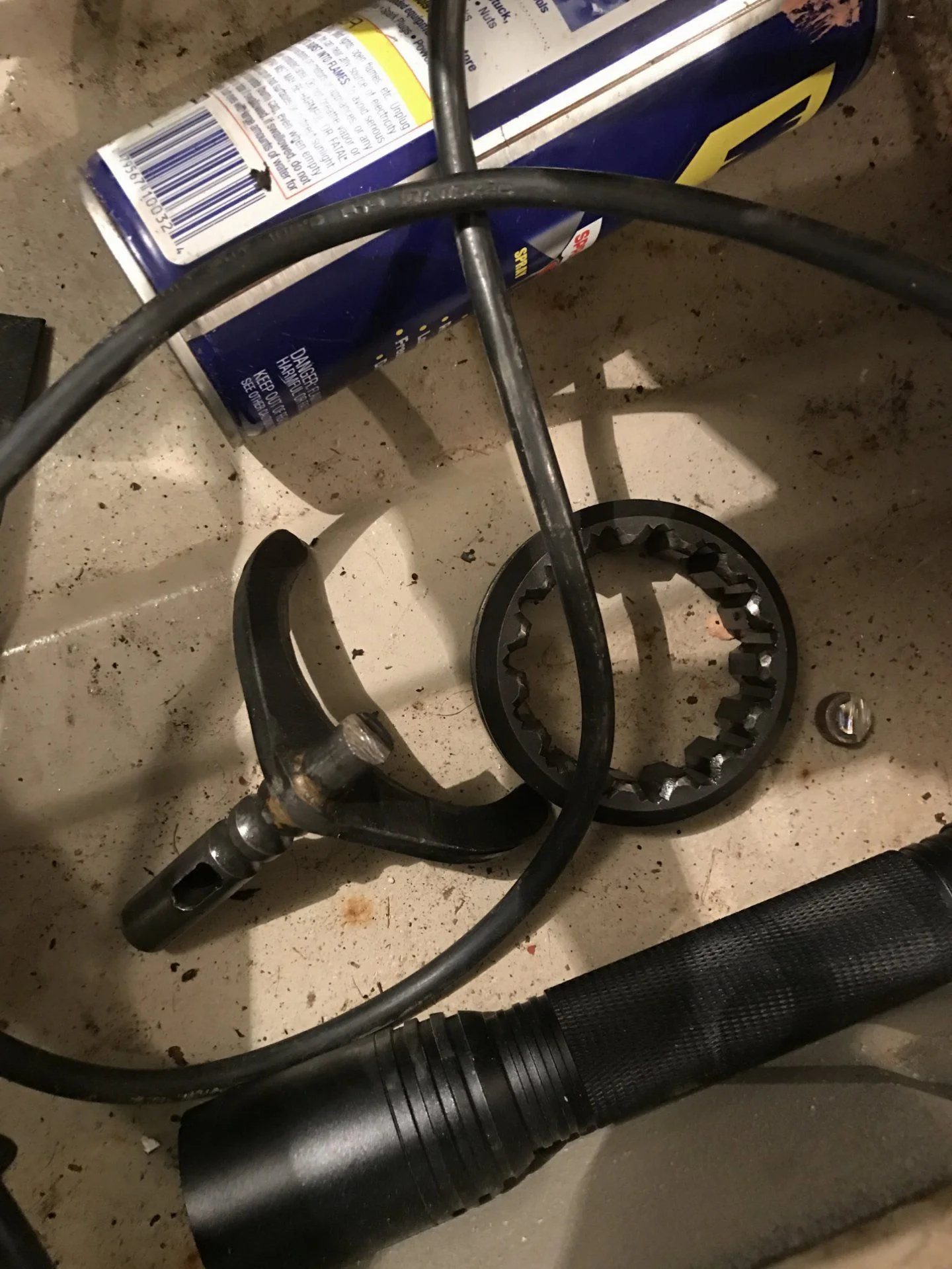

When I removed the PTO, I also took off the sleeve, gear doohickey, shear key, and nut in that lower picture. Now the back end of the case looks as pictured in the upper picture.
I need the stock sleeve and lock nut. Still trying to find the parts diagram for it.
Yes! Thanks!
Where can I get that long spacer and locking nut?
(Also need that gasket.)
But I have the cone.
Does your cone fit over the longer shaft you have? I bet @Poser or Mark Algazy would have a loose spacer kicking around. Bet you'll find one in the classifieds too.
Yes. Right now, the cone fits over the shaft.
(Of course, when those other parts were on there, the cone did not fit. Those other parts were clearly part of the PTO, so I had to remove them.)

OK - I think the bearing that I can see on my case is part #8 in the above diagram. I need parts 6, 7, & 41, plus the gasket, so I can button this thing up. If anyone can help, please let me know. Thank you.

Alfred, I'll look on Sunday.
Paul
Thanks Paul. Appreciate it. I was about to put up a parts wanted post. I'll wait to hear from you.
Also, will check in with @brew8
Ok. I need to close up this transfer case. Gotta get a few parts from @3_puppies to do that. I need the gasket, too. So will have to hunt up one of those.

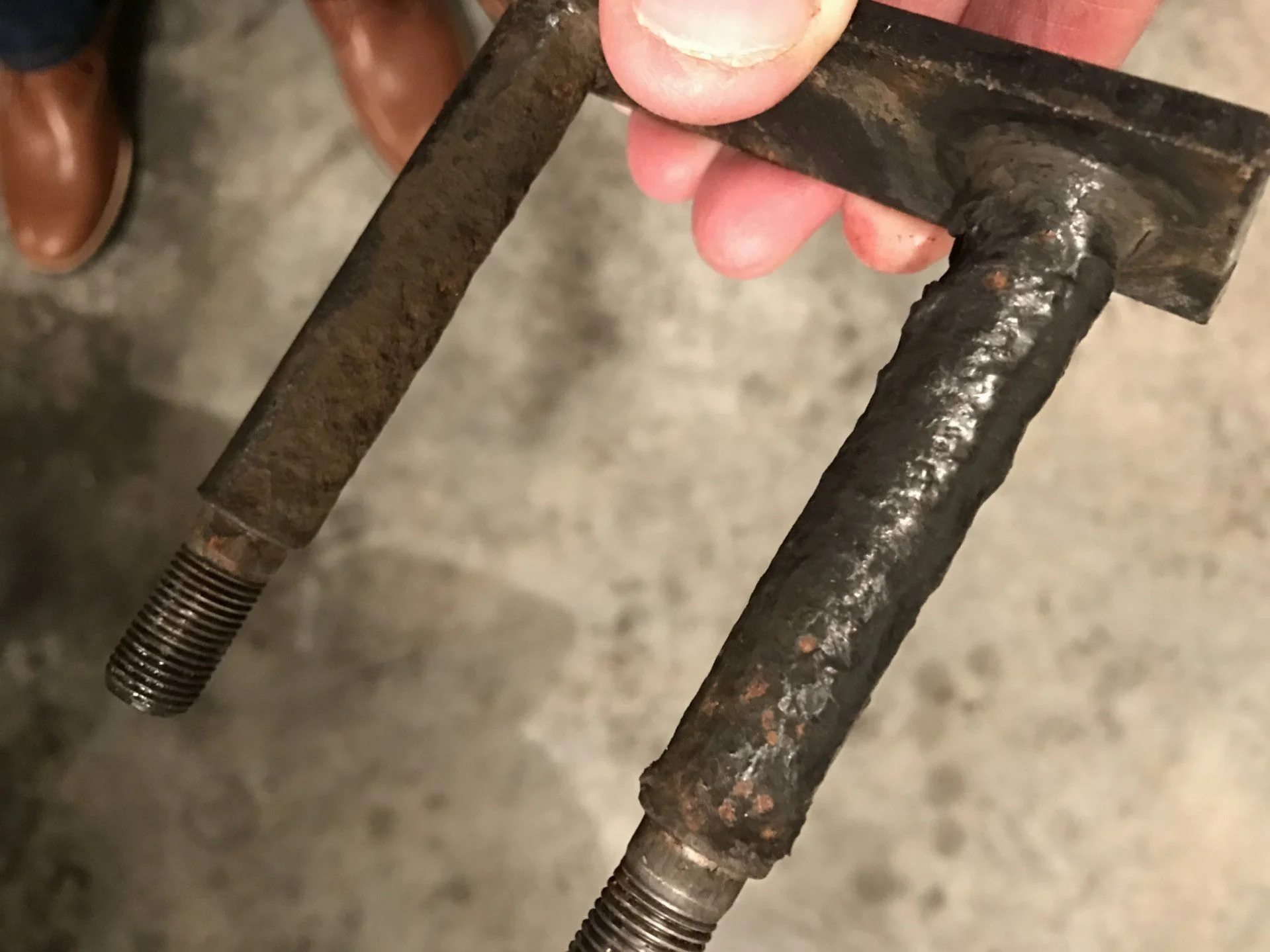

Moved around to the front end again. Gotta get the axle pulled out. Disconnected the drive shaft. Removed the shackles. My shackles are rusted, corroded and pitted. Need new ones. Called @cruiseroutfit and got 'em coming. Asked about the gasket, can only get it as part of a full kit. Anyone got a spare laying around?

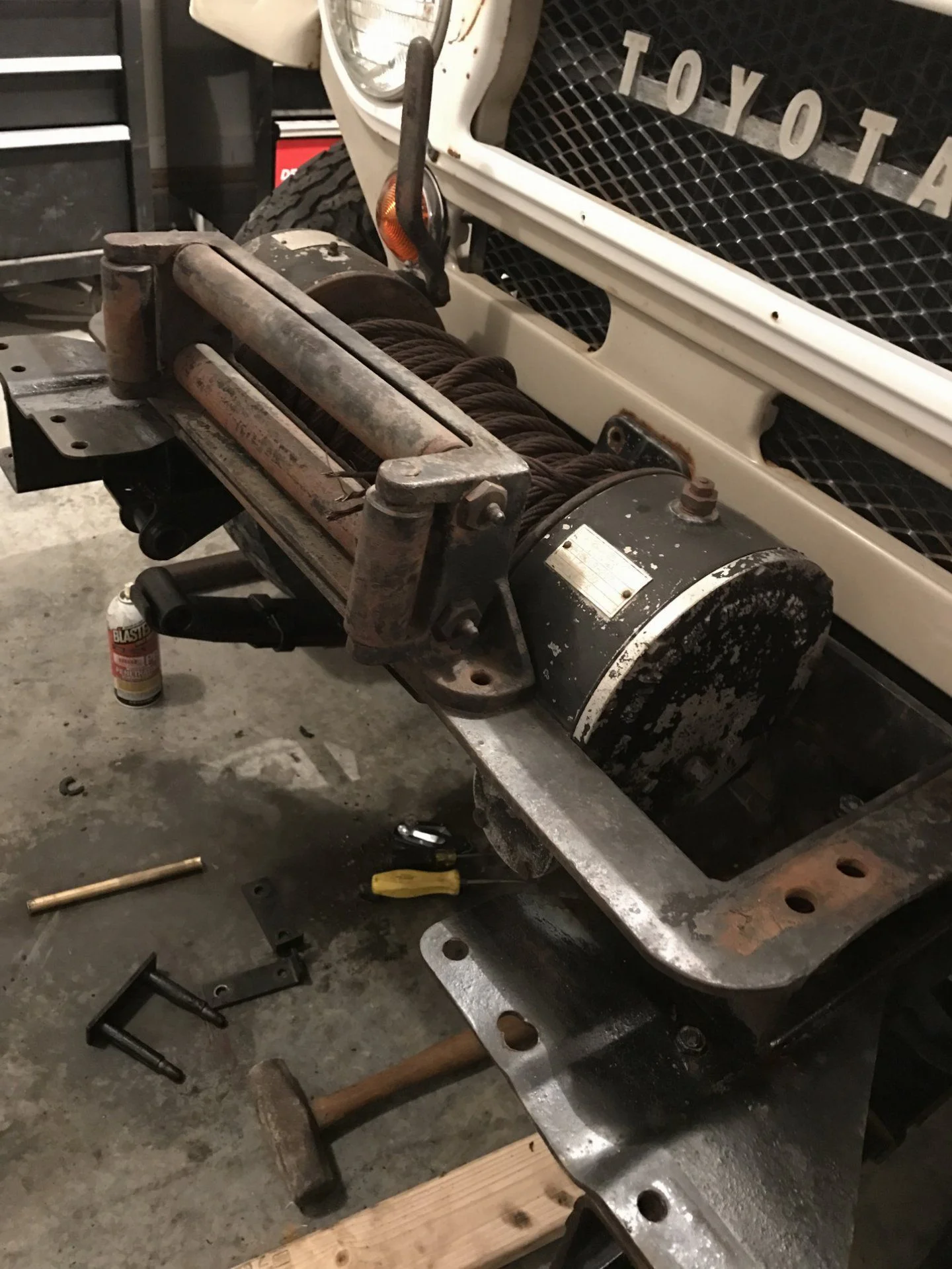

I'm also working on removing my Ramsey PTO winch. Tried to remove it complete and with no damage but had some casualties. Oh well. I'll have a near-complete winch to sell, either in a basket or a bunch of parts that others can use to complete their winch resto.
I have a couple of sets of Tcase gaskets. send me your address I'll shoot them to you, LARRY
