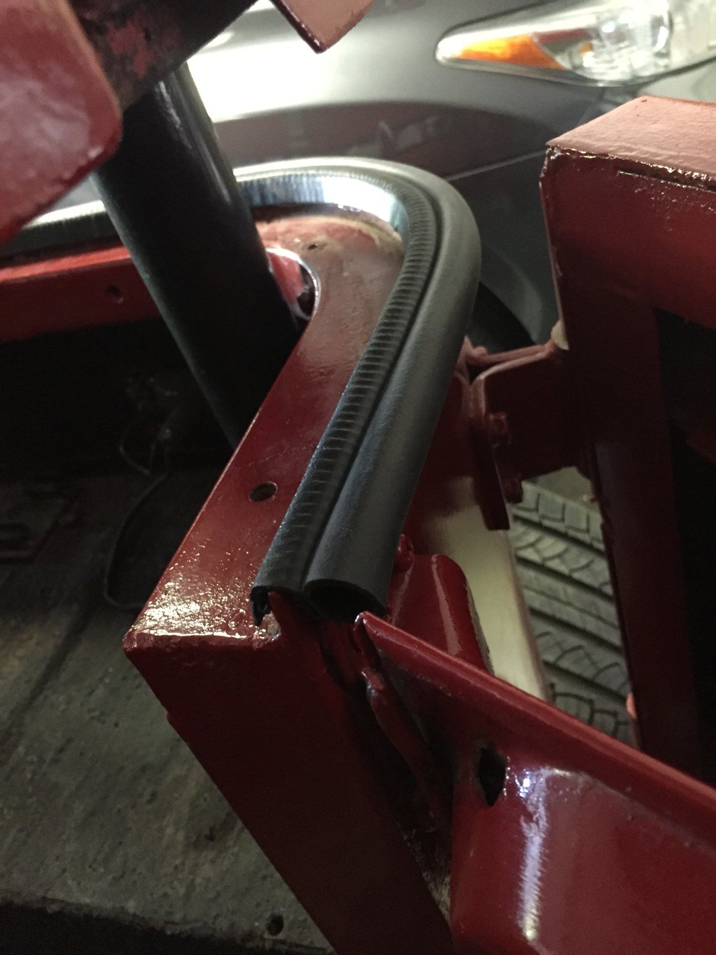

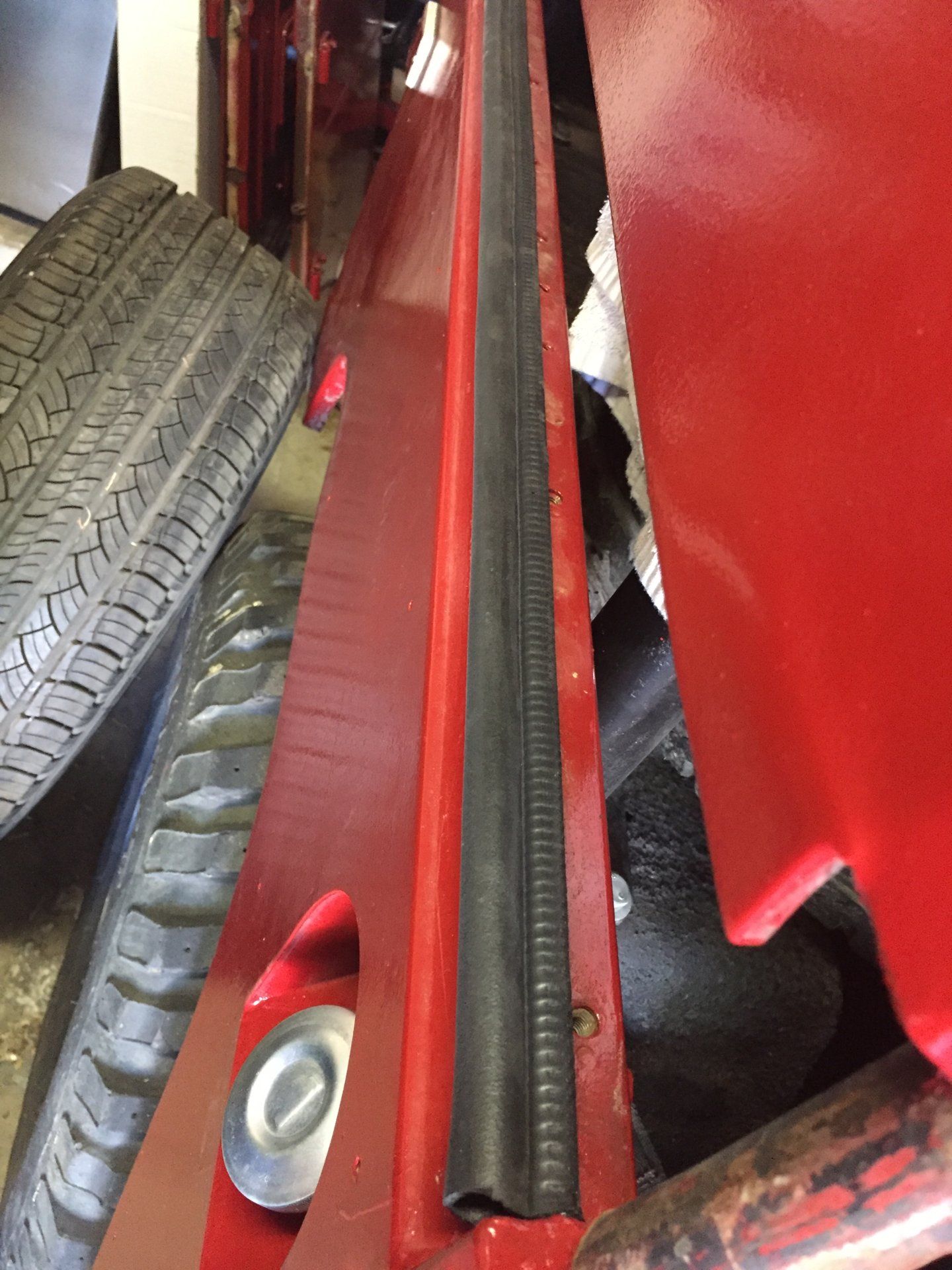

Pics shown below for anyone looking to replicate the method of FJsnoozer. Pics taken before the trimming of the rear weatherstrip "bulb" piece to mimic the CCOT pictures
