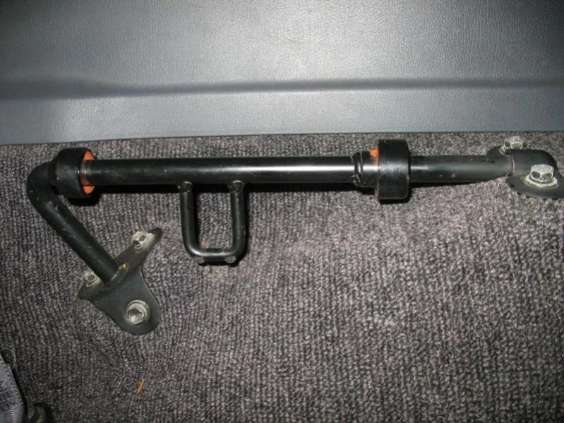

Can you snap a picture of how they mount to the 3rd row seat bar?
In a nutshell, they mount much like the seat does to the bar. The mounting platform has 3/4 circle like "tabs" that slide into the hollow circles on the existing bar:
attachment.php
(Hanna's photo)
https://forum.ih8mud.com/attachment.php?attachmentid=315570&stc=1&d=1239818489
Then there is a large 1/4 inch steel plate that bolts to the floor.
attachment.php
(Hanna's photo)
Trust me, these are not wiggling or going anywhere! To remove it is just the 2 bolts in the floor, slide the rack forward (just like the 3rd row seats) and off it comes.

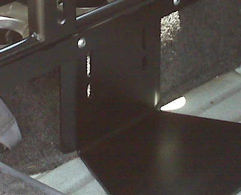

socal_80,
you will see the slotted holes in the vertical of the L- bracket. These are ratchet strap hook points so you can tie down your fridge using these along with the 3rd row points on the floor.
the slotted holes in the braces are also useful tie down points. basically you are adding a ton of tie down points with these holders as well as useful cargo carriers.
also, hold down the water can with a ratchet strap (hook holes in the top rear edge). The bungee will not hold that jerrycan in case of any serious incident.

Good to see the first customer installed set of HQ interiour racks. I like the use of the storage bags.
I do not recommend passing a the tie-down strap under and past the edge of the "floor plate". If that is even what you meant to hold the fridge. The edges of the plate could possibly cut throught the tie-down webbing given enough tension, vibration and time. Any square edge versus a tensioned rope or webbing can cut through like a knife. I highly recomend using the hooks on a tie-down at the given slotted tie points just under the basket as FirstToy suggested.
I second the use of a rated tie-down to hold a water can or any load in the racks.
