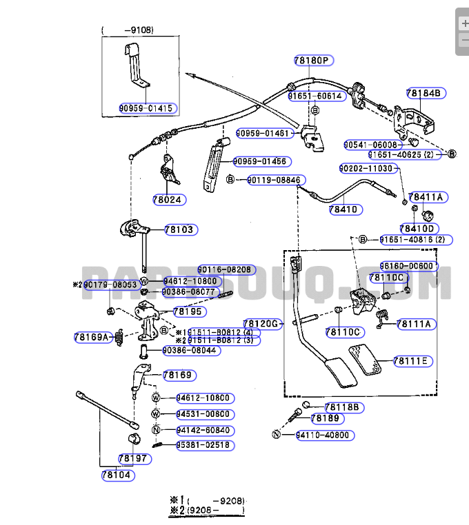

I want to add one to my incoming ('95 HZJ75) Troopy. I have found an OEM cruise control - (SORRY! hand throttle cable) - is that all I need? Is there a floor pedal specifically for the hand throttle?

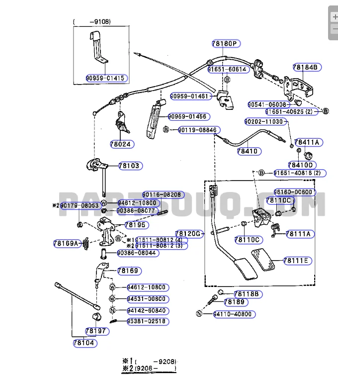

The hand throttle is a dial lever on the dash, and then it connects via cable to the accelerator pedal. It essentially holds the pedal in a fixed position. Here's the diagram (diagram 78-51 on a 1992 HZJ77). You can open the diagram yourself via PartSouq (scroll down to Toyota, choose Land Cruiser, and then fill in the drop downs).
I highly doubt any of this is made any more. You could probably find it on Yahoo Auctions Japan and then order it through Buyee (a shipping proxy). You'll need to add the Google Chrome translate extension. It's a lot of work.
The cable is available.
All of the bits for a hand throttle install are still available new.
