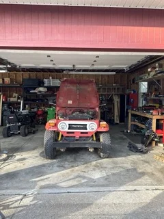

Likely needs a new accelerator pump was our diagnosis.
Carb issues 🙄 sometimes the squirter nozzle itself gets clogged, so I’d check that. Also could be an issue with the 2 check balls (one below the pump, one in the bottom of the squirter nozzle side) although that’s no very common. If I’m not mistaken that was a Trollhole carb that sat on the shelf for a couple years? I wouldn’t be surprised if the accelerator pump was a little dried up and not sealing. Sometimes a little grease on it will help it seal again and come back to life if it’s actually used and doesn’t just sit. 🤷🏼‍♂️ just my 2 cents with minimal info. Wish I could have been there to help
Yeah, it's a Trollhole carb that I won in one of our raffles. It sat for a couple years and we swapped it in. It's odd, because the issue actually started back when I had the stock Aisin carb on the truck. We swapped it out for the THC carb and it seemed better at first, but that may have just been a placebo. Could be that the stock accelerator pump went bad on my old carb and like Rob said, the AP on the "new" carb was dried up from sitting.
@IcutYourCruiser - Do you know if the accelerator pumps on the THC carbs are rubber or leather? I hear that ethanol in the gas can eat up the rubber ones. I plan on changing it out either way, since the symptoms definitely seem to point to it being the culprit.
IIRC you can put OEM leather accelerator pumps in the trollhole carbs. Same with secondary diaphragms.
The top has to come off of the carb to replace the accelerator pump, right? Can't just disconnect the pump arm linkage and take off the boot and pull it out through the top?
Top will have to come off. I'm pretty sure the Keyster kit comes with a leather pump...at least it used to. It's been a while since I have rebuilt one, but I want to say that I got a Keyster kit from NAPA and it seemed to be better quality than most.
I fought off-idle stumbles with my old early trollhole carb for a couple of years in the Crockpot. Replaced a lot of fiddly bits to no avail. I decided to bite the bullet and pick up a Cityracer Fuji carb and it has worked flawlessly ever since. I have one in my 60 as well. Highly recommend.
Like DR said above, yes the "air horn" has to come off of the carb. It's pretty easy to do.
