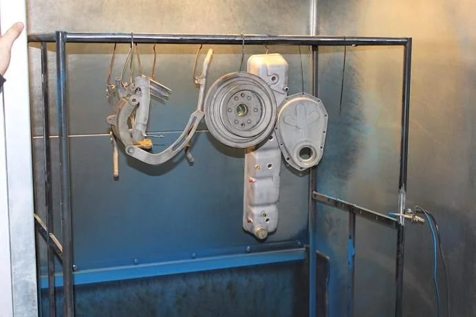

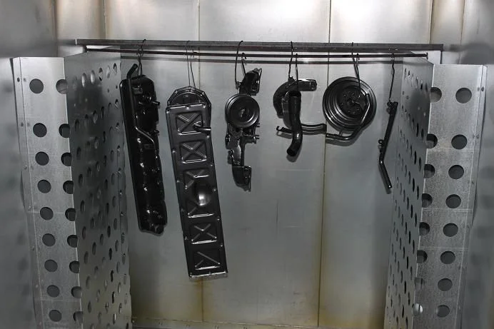

OK so we have been working for the past 2 full days getting parts cleaned and ready for this weekend. As of now everything is cleaned and in Powder and ready to reassemble tomorrow.

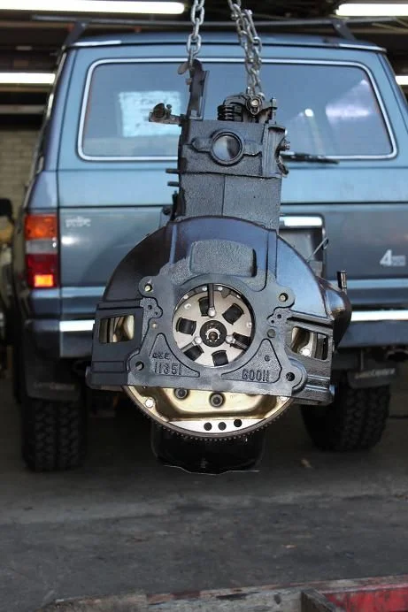

The engine is bolted to the new trans and un-cracked t-case with a New Flywheel, Clutch, Disk, Pilot and Throwout bearing. We also installed a New water pump and will have all new Hoses and Belts installed before it arrives Sat AM. The engine will have all new gaskets and seals as well (Oil Pan, Front cover and seal, Lifter Cover, Rear Main seal, Valve Cover etc.)

This is the engine as it sits but we will have it almost completely assembled and ready to drop in before it gets to the build on Saturday.
