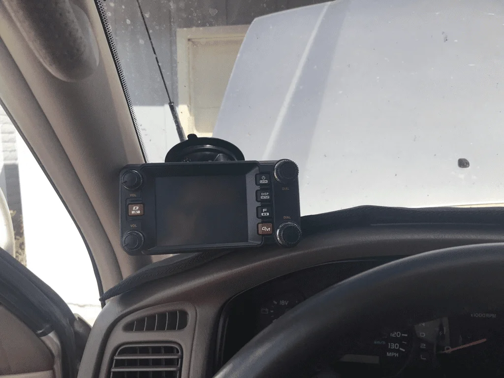

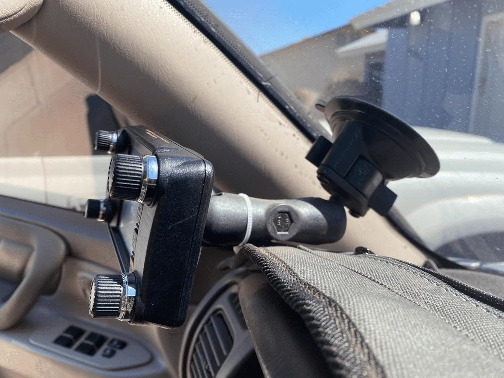

Transceiver: FTM-400 has a detachable face place that can be mounted away from the main unit. Mine is mounted with a ram ball (face plate has a 1/4-20 hole) and suction cup. The main unit is mounted inside the glove box of my 100 series.

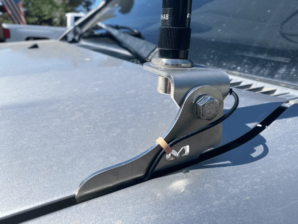

Antenna Mount: This is from Massive Metal and picks up the factory hood latch fasteners
I have this same antenna and initially mounted it in the same area on my 80 series. The coil grabbed too many branches and I had to relocate it to the mounting hole on my ARB bumper.
It definitely catches sometimes, but the mount I use allows the ant to rotate if it catches... only happened a few times (but I also don't see too much low branches out in the desert.)

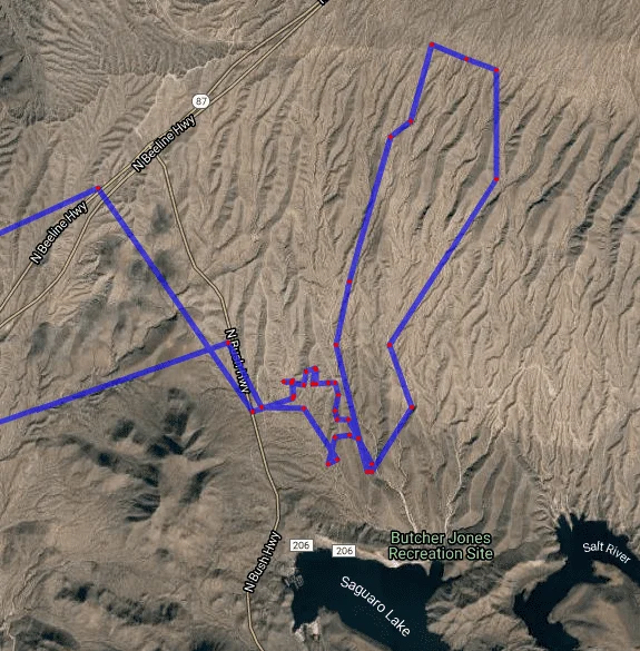

Here's an example of what you can get from aprs.fi if you "track" a specific call sign. This is most of the outing from this weekend, notice that there were some pings that were unable to hit an igate and the pings themselves are not directly on the trail. This is due to the "ambiguity" that you can set with your beacons so that your exact location isn't being given away, you tell it how many decimal places off the back of your GPS coordinates to leave off.

What are you using to beacon, and what repeater were you hitting?
This is all within my Yaesu FTM-400, it has a GPS receiver and built in APRS function. It runs APRS beacons on the B-Band on 144.390
I was hitting igates all over the valley. If you go onto APRS.fi and hover over a beacon it will show you on the map where the igate you hit is
