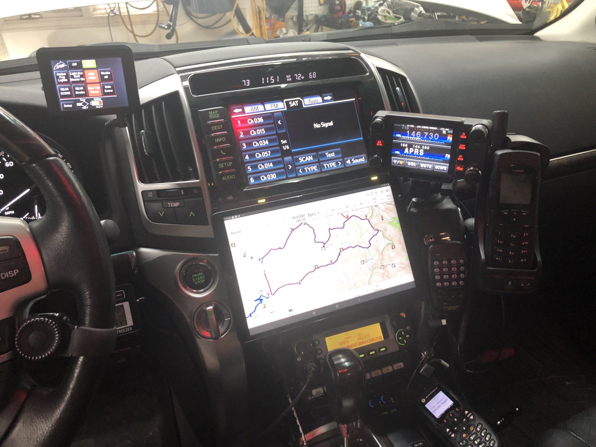

I know it looks crazy, but it works well for me for things I do- I roll with 5 mobiles 3 Commerical Motorolas VHF, UHF & 800, Yaesu FTM-400 & a Iridium in a Beam dock. The Iridium beam dock is Bluetooth and works hands free via the infotainment. I have four Antennas mounted through the roof and two more mount on the rear rack. To support incident management the rig is equipped with the ability to cross band the commercials radios and the iridium to support interoperability- Geek at heart, Nerd by trade.
What’s the round doodad strapped to your steering wheel?
2016077
It is a thumb Control for my Navdy, which is a heads up display- The company is now defunct but the unit still works and interacts well with my iPhone and iPad. I use it for primary controlling music and to complement waze when I am navigating new to me metro areas.
That looks like a meme

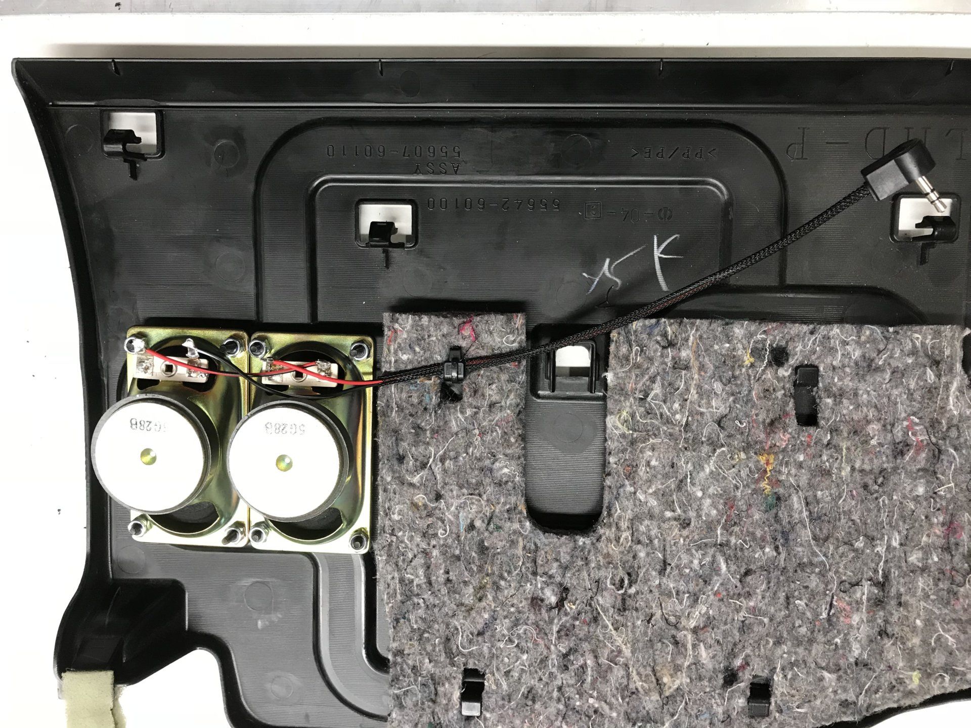

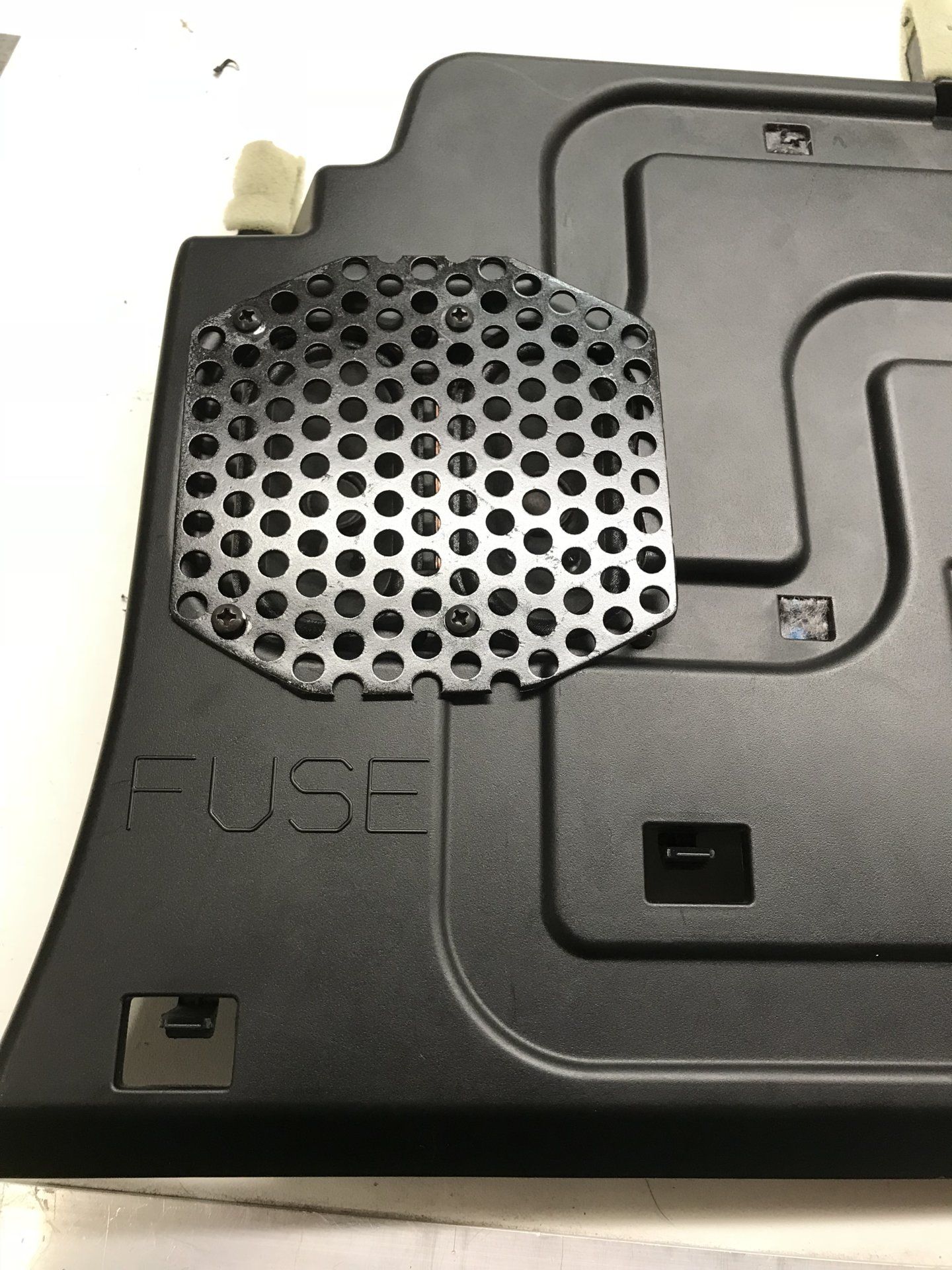

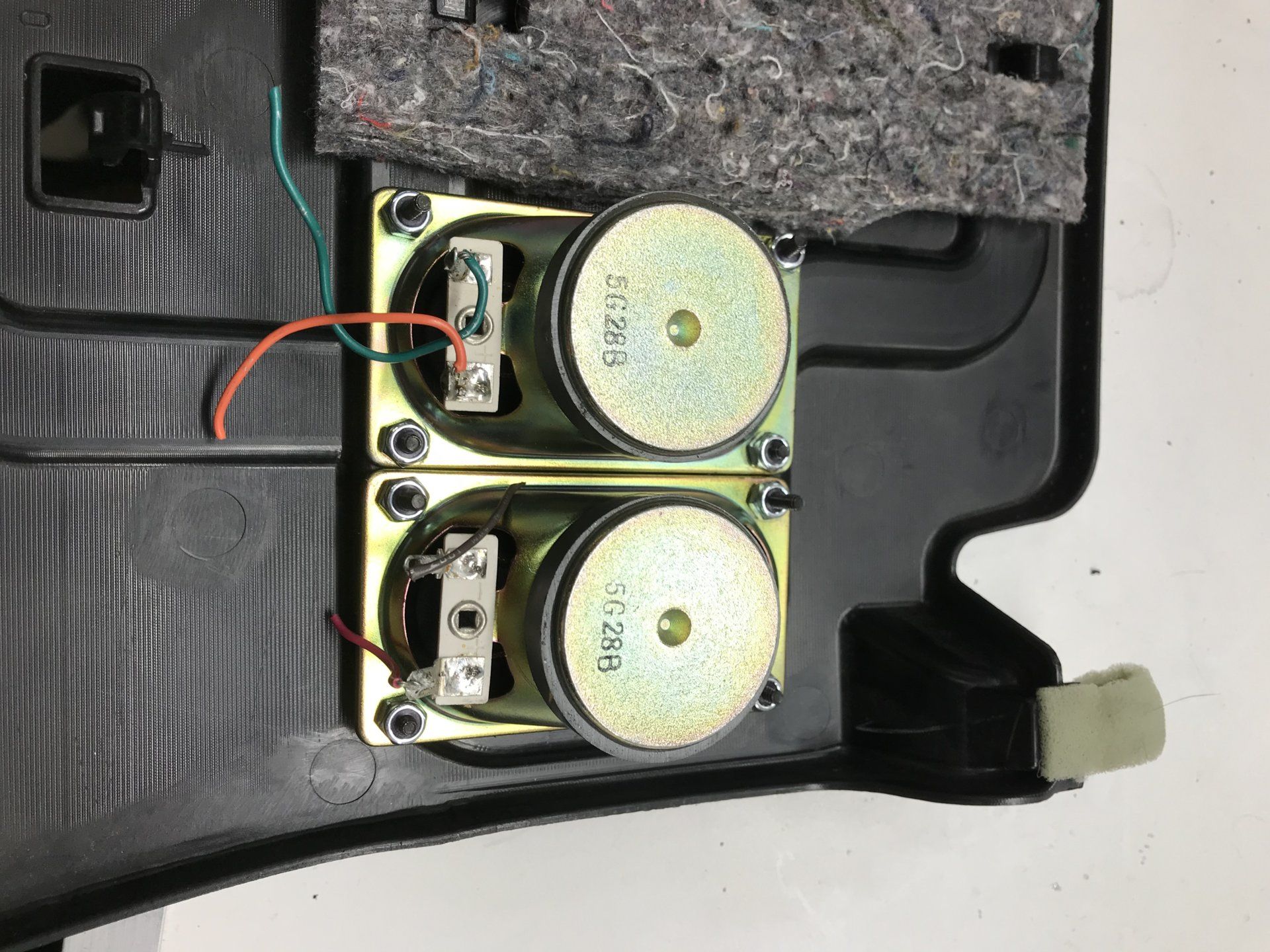

Those of you that remote mounted the T/R unit in the rear with the face up front, what did you do about the speaker? The only reasonable place I can find to put one is on the front lower part of the driver's seat. Not much to mount there there, just flimsy plastic.
I ran the speaker cable along the back of the drawers, and hook and looped the speaker in the little cavity below the third row cupholders on the driver side. It's nice and secure, out of the way and volume isn't an issue even at 75mph with the back stuffed to the ceiling.
I took a couple of old police radio speakers I had and mounted them under the passenger foot trim piece below glovebox.

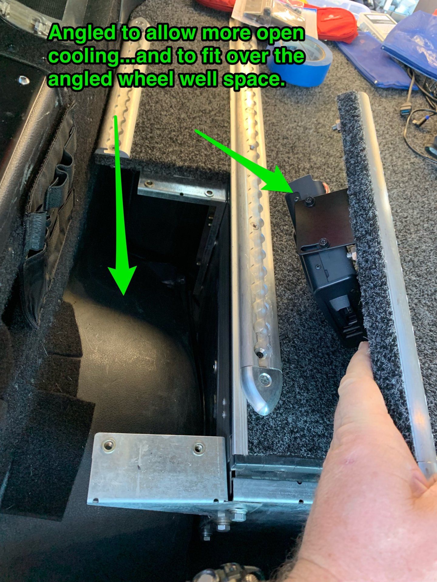

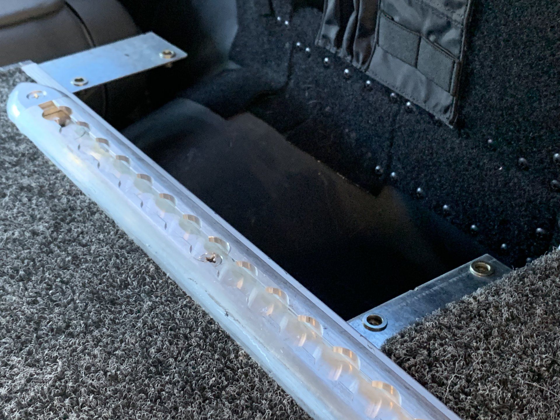

Here’s what I did yesterday (not quite done).
-After finally getting ahold of a longer faceplate cable (has a weird-sized jack...narrower than even an old phone jack), I’m mounting the main unit under the screwed-down piece that’s just in front of the side fit-kit storage on my ARB drawers. It takes only like 15 seconds to loosen the 4 hex screws for occasional (almost never needed) access, and it’s a space nearly useless otherwise.
One nice thing about this spot is that air is continually being moved past it as air is pulled out of the cabin via the out/recirc vents located within the side spaces. These radios can get pretty warm.

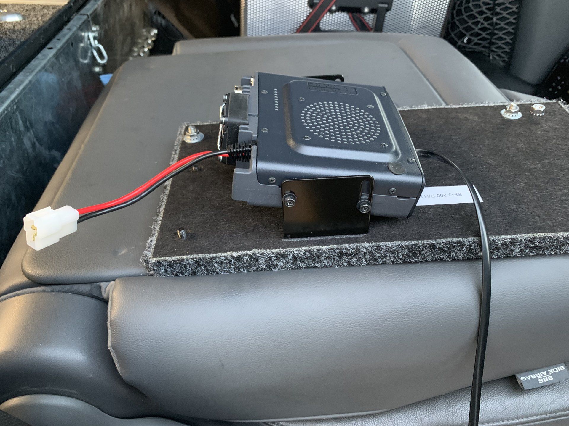

Too funny... that's EXACTLY where I put mine, TODAY. Mine is an older Yaesu FT8800R. Where did you put your antenna? On the swingout? I went with the Diamond clip-on mount on the hatch, I think it was @Romer that posted it.
