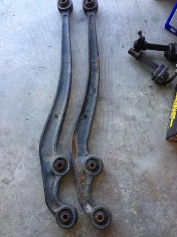

Hey, I have 80 front radius arms, OE rear links and panhard I'll contribute, should you want to endeavor upon the swap.
There'll be a few obstacles, to which you may be fully aware, but I think flipping the front radius arms is the best approach, along with coil overs, both requiring a lot of fab work, the latter getting into $$$ quickly.
Anyhow, if you'd like, you can have for shipping costs. The bushings have 105k old man miles on them, so usable, but would probably plan to replace if going to the trouble.
You make me wanna cry!;) Yeah, the flipped arms was what I was thinking; keeping the arms horizontal while gaining some clearance. And the coil overs seem like they'd be easier to fab for, regardless of their initial cost. I'b be stoked on those radius arms. I have a panhard from the rear axle swap, and was considering using it up front. The rear will stay leaf sprung for now, maybe with an SOA in its future, but the front has always wanted links and coils IMO. seeing the way the springs arched has never been as telling for me as when I parked on that there rock...I had a chance to envision what was going on with it, and the remedy is going to be invasive regardless of what type of suspension I go with. That being considered, there is nothing to it but to do it, and do it right, or do it 2 or 3 or 4 or 5 or....well, you get the idea.

Took an hour to dig down deep into the boneyard, but they're ready to go.
Bushings look good, honestly.
Still contend, after straying from Mr.T's on other builds and some components of the 80 build, that the marginal improvement a heim, johnny, or poly affords isn't worth the incessant complaining they're capable of, especially on a 5 link rear.
Not that any is relevant here.
Anyhow, dimensionally they're ~30 7/8" center to center on the frame rail end and ~31 1/16 center to center on the axle, with 25 3/16" between the frame rails, thought the mounts are outboard of.
I don't have a Pig here to compare, but according to the frame detail, there's 24 1/16" between frame rail webs, at the corresponding area where the frame narrows, which may only be an issue getting a wide enough spread on the PS of the third.
Also have the sway bar and "custom" sway bar drops, if interested in those too.
YES PLEASE! I have not had any luck finding coil-overs sets for less than 1400(and that may be just ONE); I may end up just doing coil springs ala the 80 series...found a set of stock take offs for the right price(free) and might spend the effort instead of the money...I don't think I can use the 80 series sway bar tho- it is too wide AFAIK...THANK YOU kind sir;)
