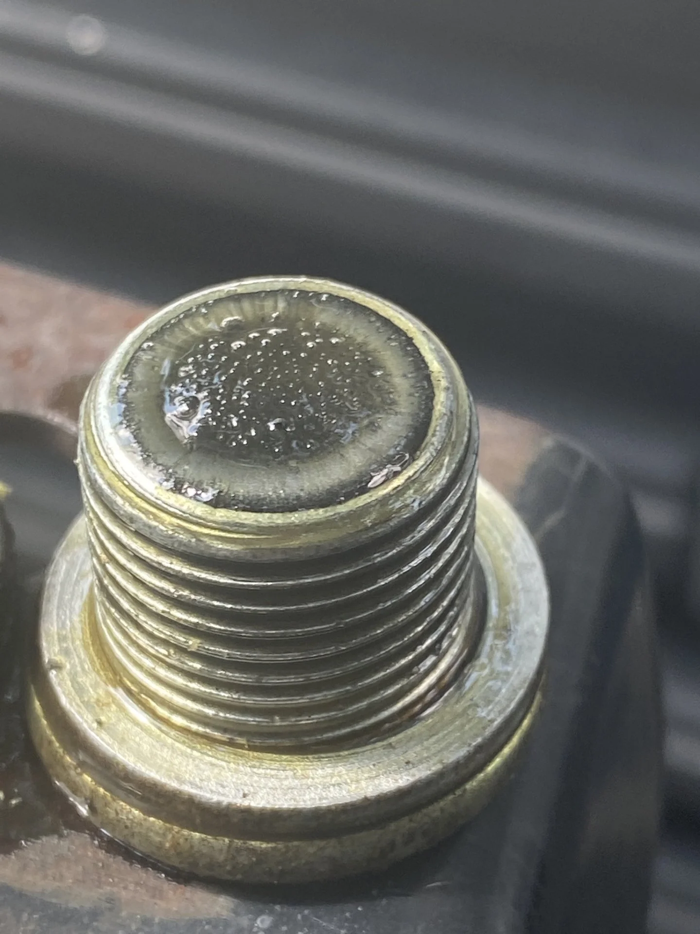

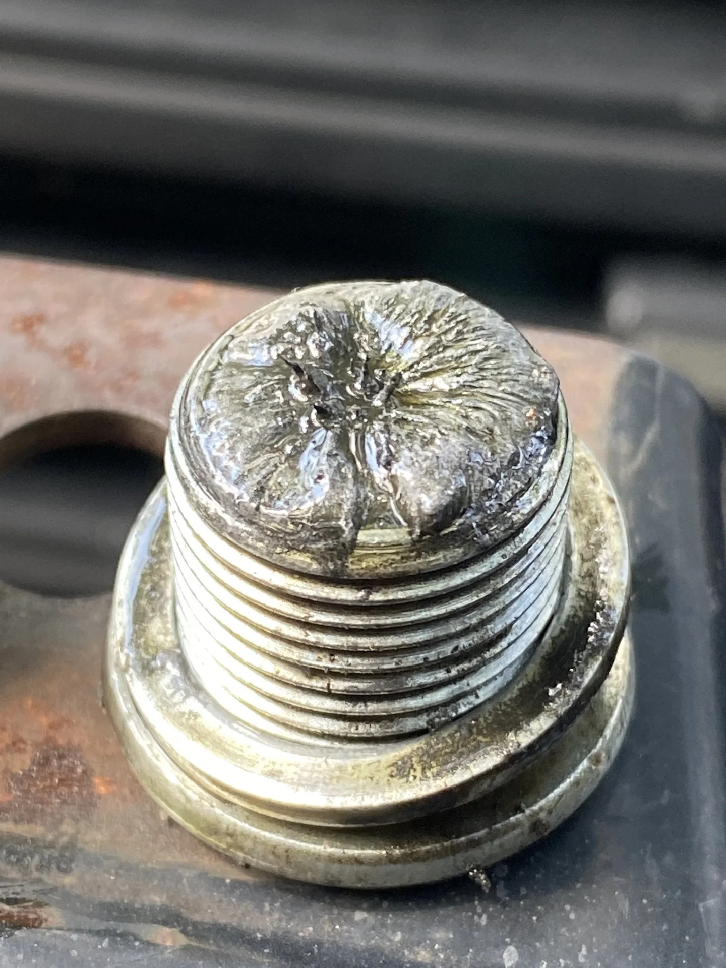

I used normal gl5 for 1000 miles and then Mobil 50 for 35,000 miles.
The h55f and new georg built t case are loving it. I really didn’t even need to change the fluid yet, but I was bored. I’m going to try and run this current fluid for another 60,000 all the way to 400k.
Trans on top with more deposits (brand new) and a rebuilt split case plug on the bottom.
The fluid is a little thick for the first 10 mins and slow to shift, but works great the rest of the day when it’s below freezing.
