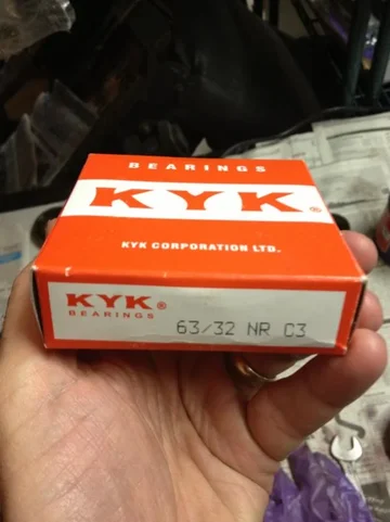

So good news/ bad news on the bearing:
It arrived. $13.11 with tax.
Japanese company

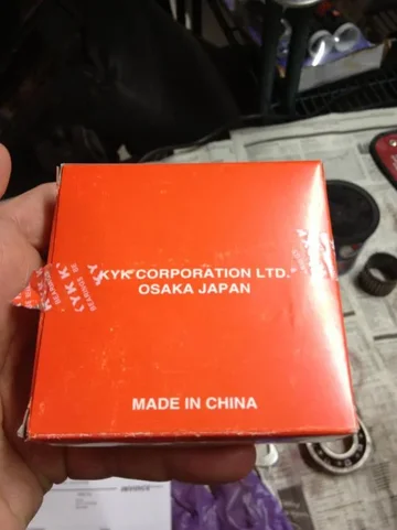

Bad news,
Made in China
At least if the tranny crashes, I can blame this.
You know the global economy is bad when even Japan outsources to China...
Most major bearing manufacturers have plants in China including Timken. Put the bearing in and if it fails we can still blame BOB
If you have been paying attention, China landed an unmanned vehicle on the moon this week, so chances are they can make a decent bearing. Regrettably, their products are getting more competitive in quality while remaining price competitive.
China also said last week they aren't going to buy debt in the future from the US (or anyone else). Kiss not only price competition goodbye but also your gvt pension, the almighty dollar, and your inability to speak Chinese.

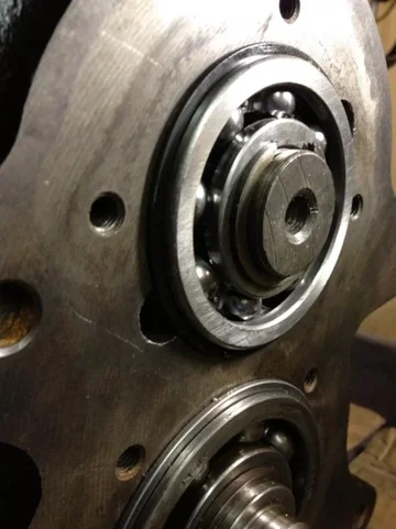

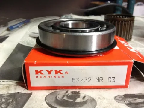

Got the final bearing replaced tonight.
Success
Just to compare the three bearings:
Original and the "kit" bearing. No groove.
New bearing with a snap ring
Bob responded to say I had probably put it in backwards and that they don't come with a snap ring, you use the old one. Then went silent.

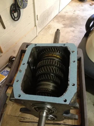

Buttoning the tranny up today. What's the trick to fit the top onto the case so that it shifts?
Chased the threads and the bolts after wire wheeling the bolts to clean them up.

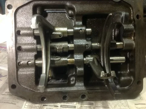

Put the gasket on the top of the case, gasket seal on the bottom layer so I could fit the top and case cover assy a few times properly before sealing it.
Gasket in place
Case Cover Assy

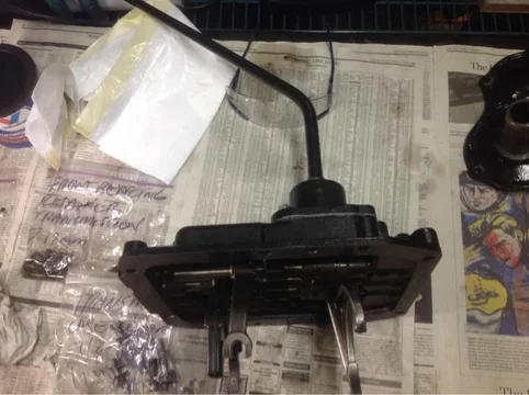

Shots of the cover
From the left side
From the right side
Can you shift into all gears with just the top cover when it is off? It looks like the R fork is too close to the 1-2 fork so that the R fork cannot move with the 1-2 fork in N. Is the 1-2 fork flipped 180 degrees on the shaft?
The mechanics of shifting are simple: The lockout pins only allow one shaft to move when the other two shafts are in N. They can all be in N but after that only one shaft at a time can slide.
Take a picture from the shift tower side of the cover showing where the shifter cane nose fits in. Focus on the slots at the bottom on the shift rods.

shifter top
Hi Vae,
Your top is not in neutral.

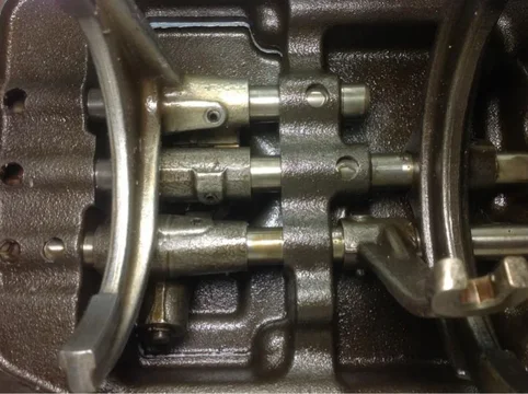

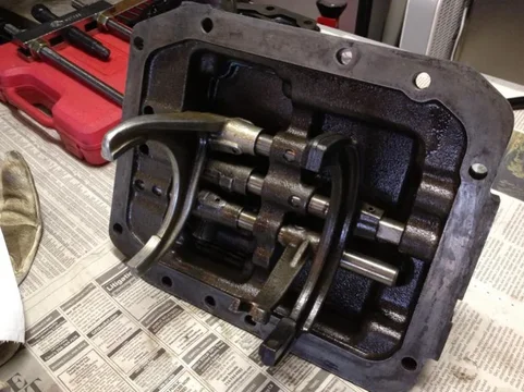

The three shifter rails should form a rectangle with the reverse rail having a spring leaded pin.
I usually leave shifter out of the cover until it is installed, that way you can see down the shifter hole and see the rectangle formed by the three shifter rail blocks.
See the picture from the top with shifter tower removed.You don't need to remove it to see the rectangular slot formed by the three rail blocks.
The picture from the bottom shows the the three shifter forks in neutral.
I suggest you sit down and think your way through what is happening when you move the shifter rails and what it is doing in the box.:)
Hope this helps.
