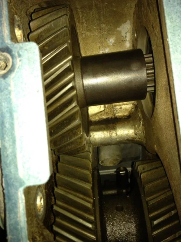

I've taken off the PTO cover on my 77 with H42 to see if it had the PTO gear (no such luck) but as you can see, the spacer goes right out the edge of the case, so I am guessing, the 45mm spacer is probably the one that goes inside...maybe.
Hope this helps. Thanks for all the great info with pics.
It helps! Thank you.

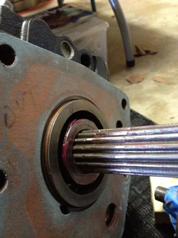

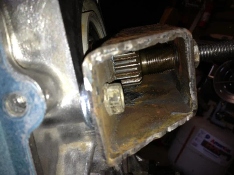

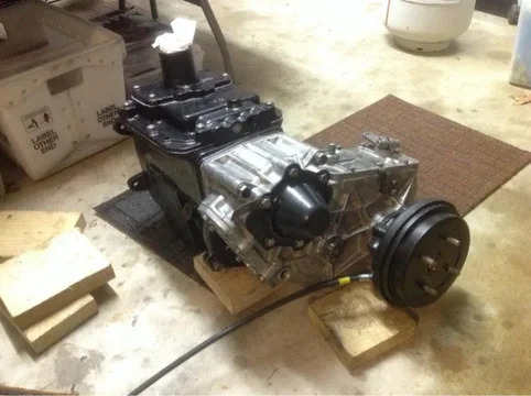

Split the t case from tranny again. Used the splitter to get the bearing to come off the shaft again since it was too far in.

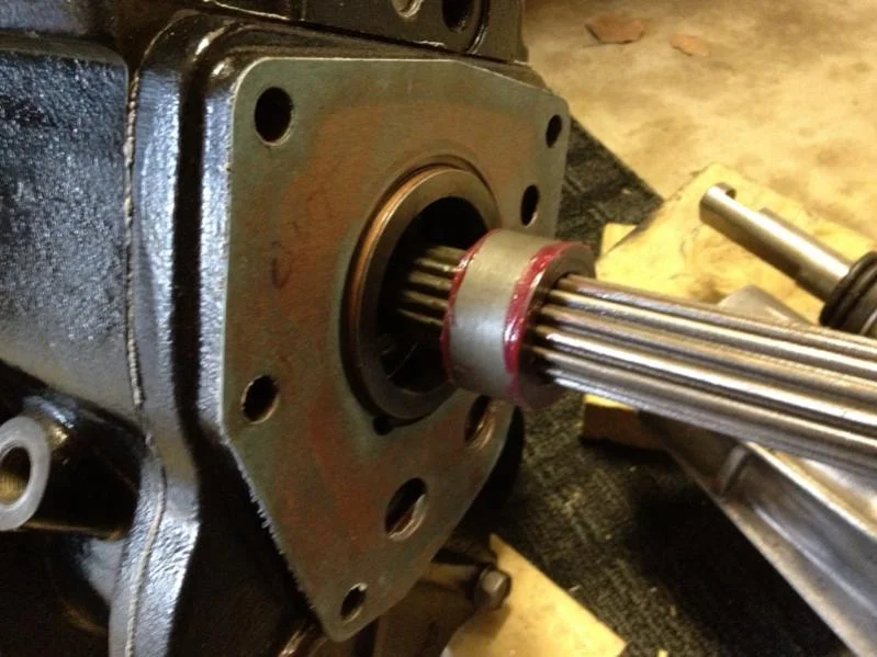

I think I have the spacers on the output shaft figured out now.
Clearly the short one goes on the tranny output shaft first, before you marry the transfer case.
Then you marry the tcase,
then the first drive gear,
then the PTO gear or the LONG spacer,
then the bearing onto the outside of the case,
then the MEDIUM spacer,
then the shims, nut and tail cone.
Short spacer first

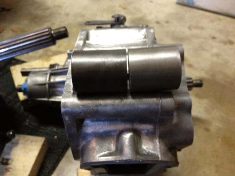

LONG spacer on left, MEDIUM spacer on right.
LONG spacer replaces PTO gear inside the case. MEDIUM spacer goes outside the case after the bearing.

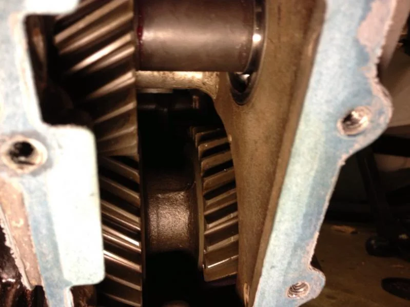

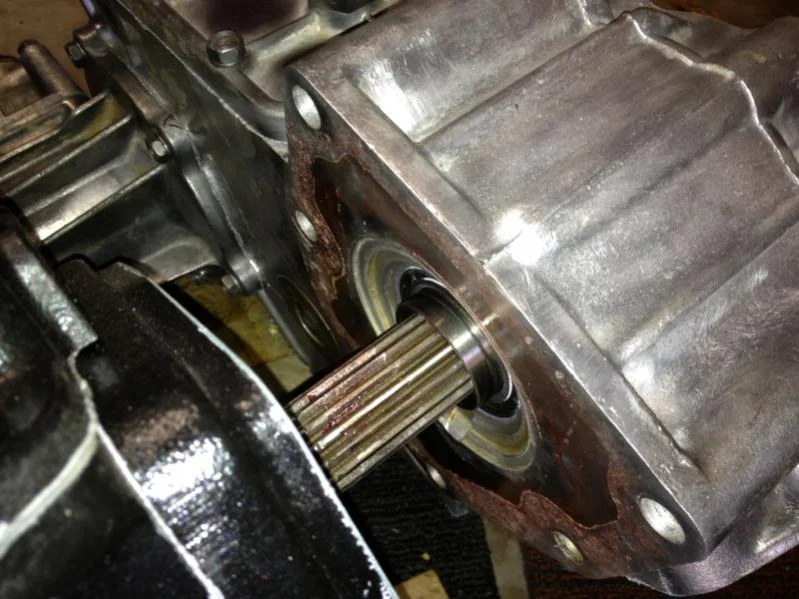

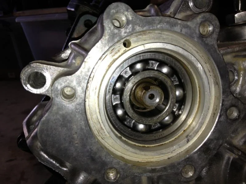

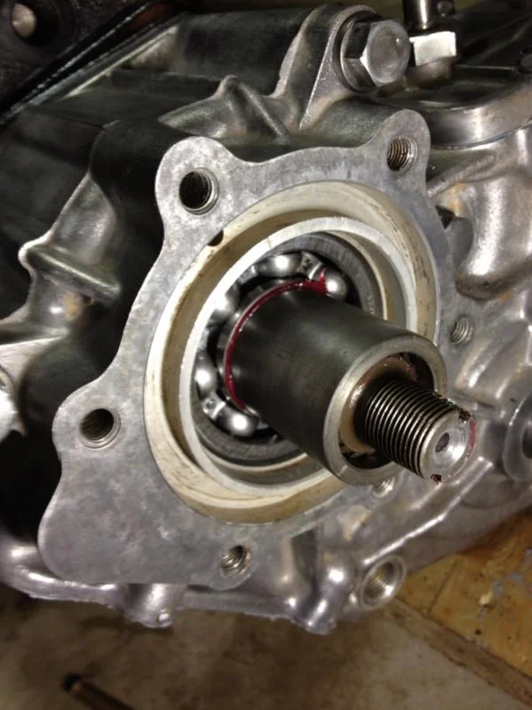

Tap the bearing all the way down until it touches the PTO spacer or gear. The back of the outer bearing should be almost flush with the inside of the tcase as shown below.
(Before assembly, but spaced temporarily by putting the drive gear, LONG spacer and bearing in place.
Bearing location in relation to the transfer case.
(Note: I still need to check all this with final assembly, so this is not confirmed yet. I'm about 98% sure. Hopefully someone will verify this as I'm reassembling things).

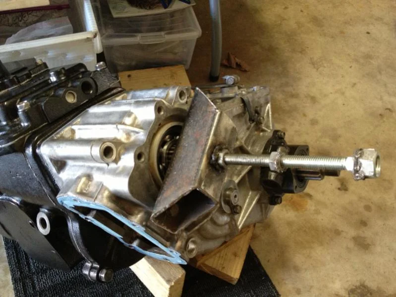

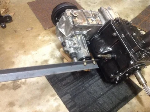

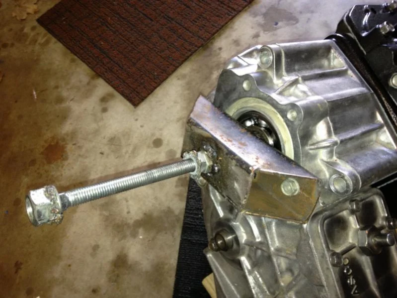

I needed to put the 3 stake nuts on the shaft ends, but to do that, I needed to create a quick SST. I used a piece of angle iron attached to the companion flange. This rotated to sit against the 4WD Hi Low shaft and hold things in place.
Two positions the SST was used to hold the various shafts from moving while tightening the stake nuts with the 27mm socket.
Had I put on this companion flange stake nut before marrying the tcase to the tranny, I could have just rested the SST on the ground, but now the tranny was in the way. This worked fine though.
SST

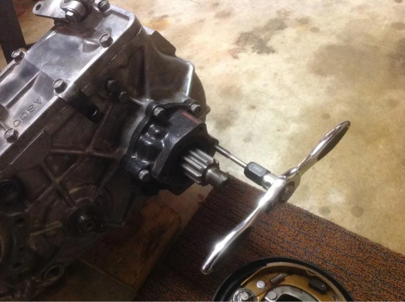

Torqued the stake nut on the companion flange, and the output shaft both to 90 and 105 ft-lbs respectively.

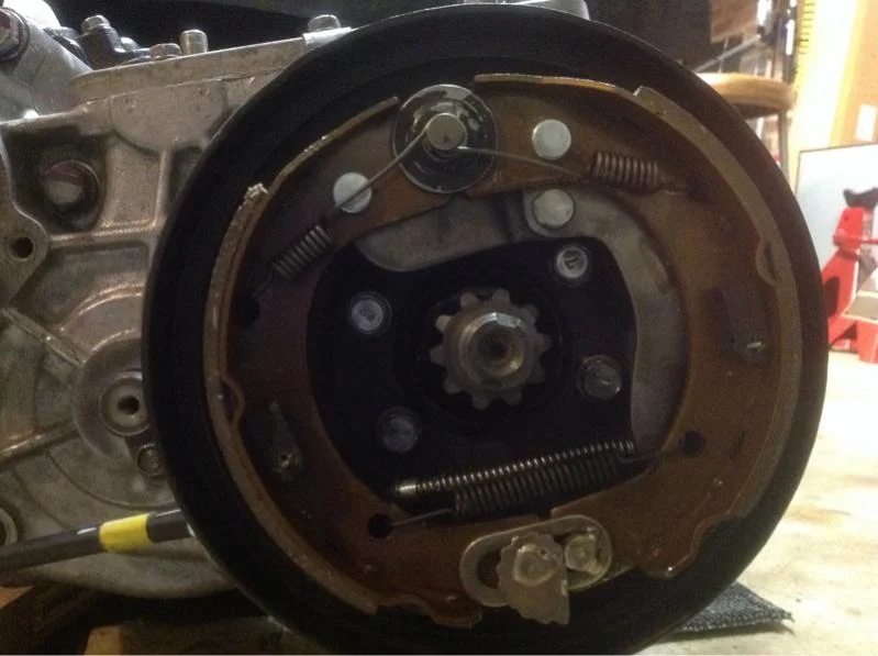

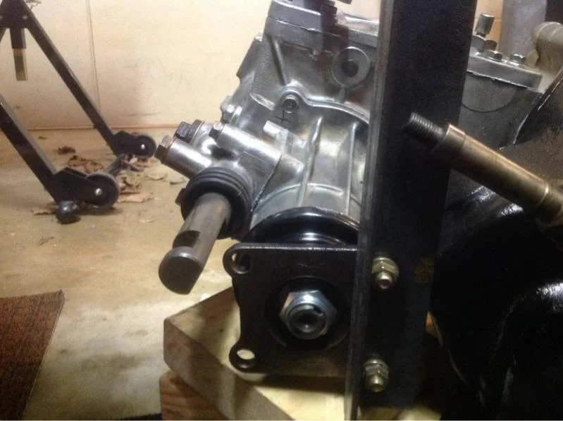

I put on the eBrake backer plate, putting the short bolt on the upper left side, with thread lock on all 4 bolts and torqued to 21ft-lbs. this would have been a lot easier if I'd done it before rebuilding the eBrake guts, as the mechanism gets in your way of 1 of the nuts, making it tough to tighten. You must put the tcase into 4WD to have it hold properly.
EBrake backer. Note short bolt for upper left hole.
Chased the threads first
Top right was hard to tighten while assembled

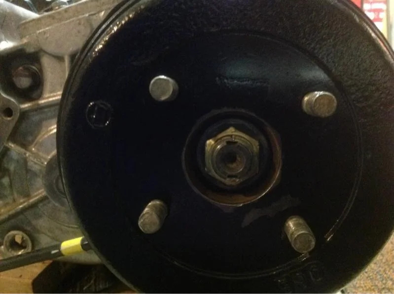

I put the eBrake drum on the shaft, and put the washer/spacers back on and torqued the stake nut to 90 ft-lbs.
eBrake drum and nut
Staked the 3 nuts.
2 of the Staked nuts (I went back and staked them better after the photos)
