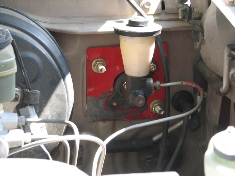

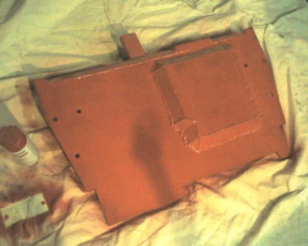

Well my ghetto clutch bucket that I hacked together from the 60 bucket finally collapsed on me so I had to build a proper one. The factory 80 bucket bolts to the dashboard somehow, but I couldn't find that hole on my truck. I ended up making a support plate for the engine side of the firewall and building a new piece for the inside. These are the only pictures I have for now, I will try and take some with the better camera now that it is installed.
It is amazing how much smoother the truck shifts now.

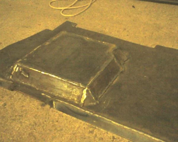

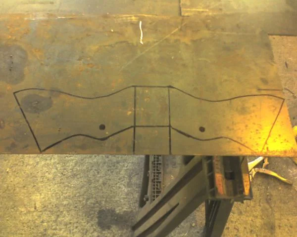

I also built a new skid plate. With the transmission crossmember attached to the front of the transmission on the H42 everything looked extremely vulnerable hanging out back there. I think it should be ok now, although the gear noise is a little more noticeable with this bolted on. I will try and take an installed pic of this too.
Looks good! Awesome metal skills too
