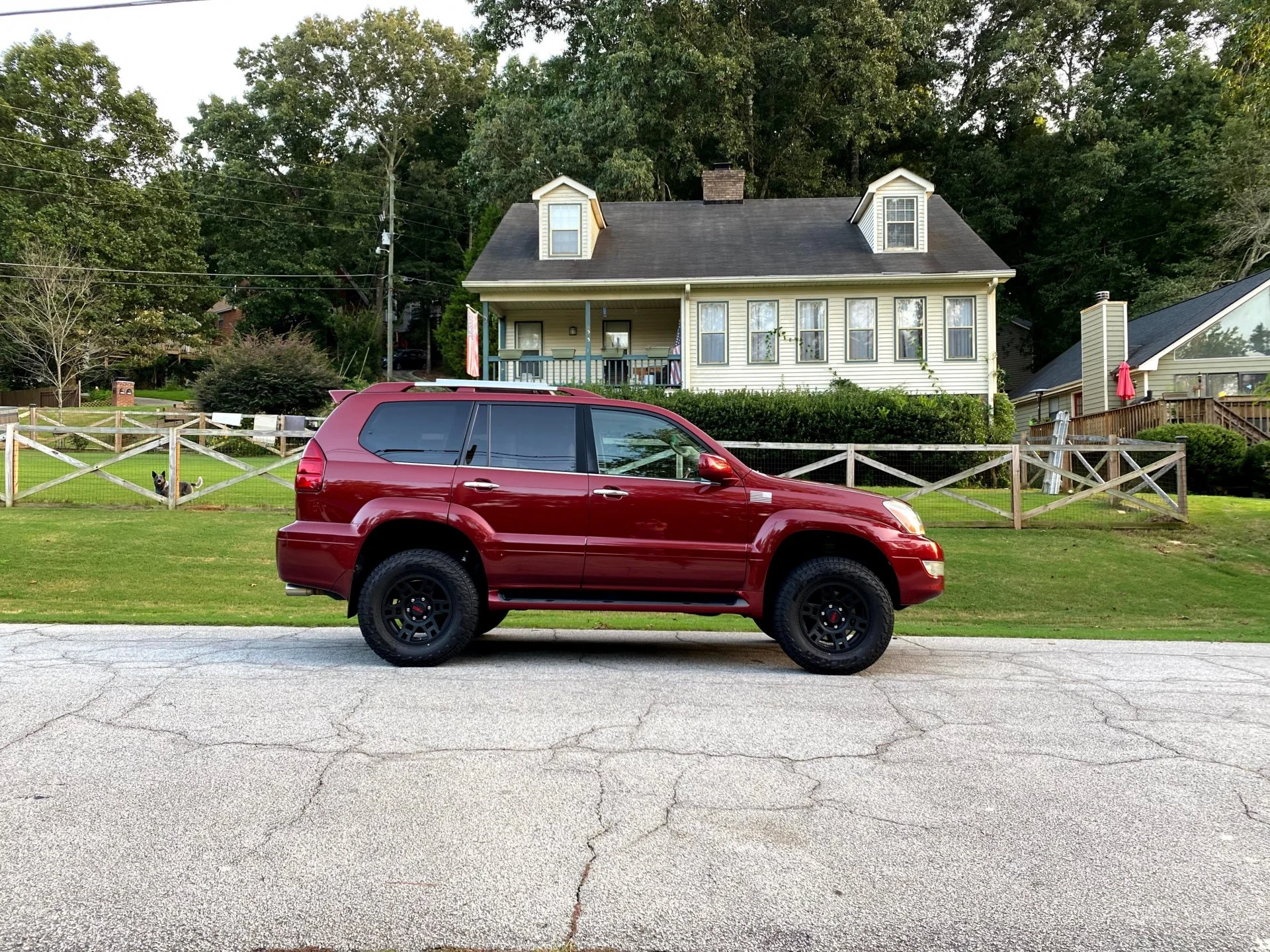

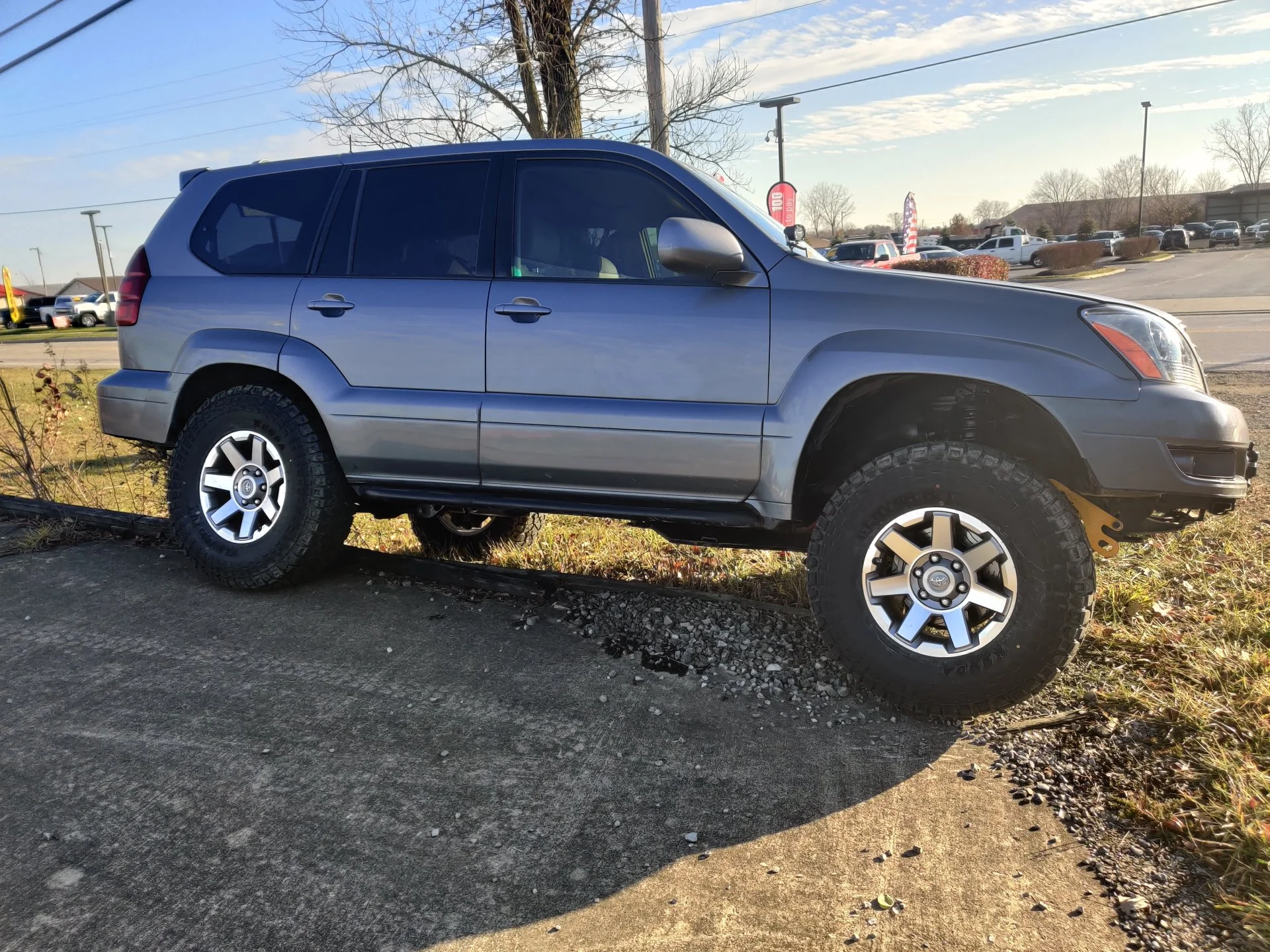

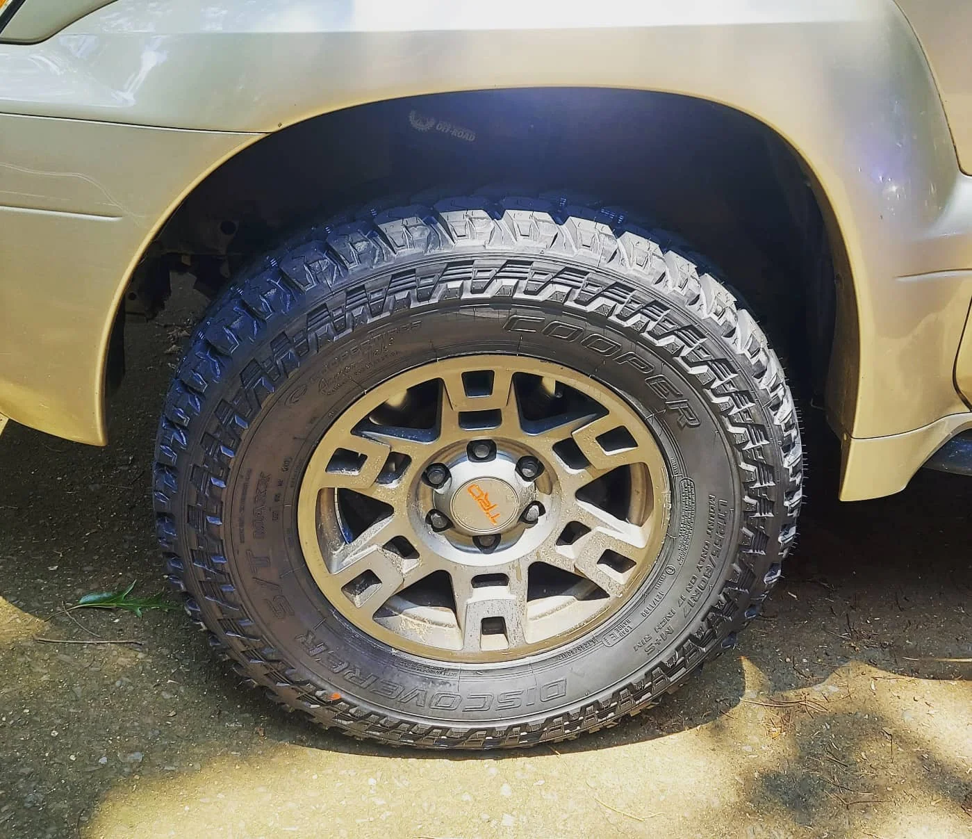

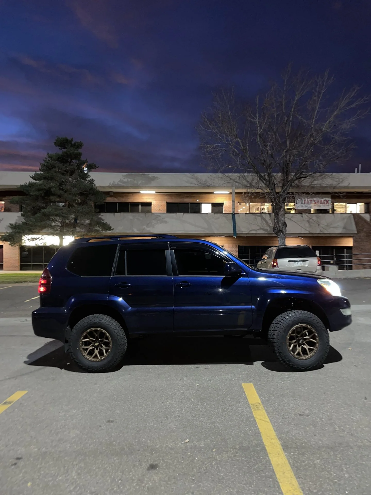

255/80 R17 Cooper Discoverer S/T MAXX
~2.5 lift wit Bilstein and OME springs
Freedom Off Road Tubular upper control arms
I'm getting a bit of rubbing on the passenger side body mount. My caster is 4+
No spare fitment issues with the JW mount.
@journey_gx470 on instagram

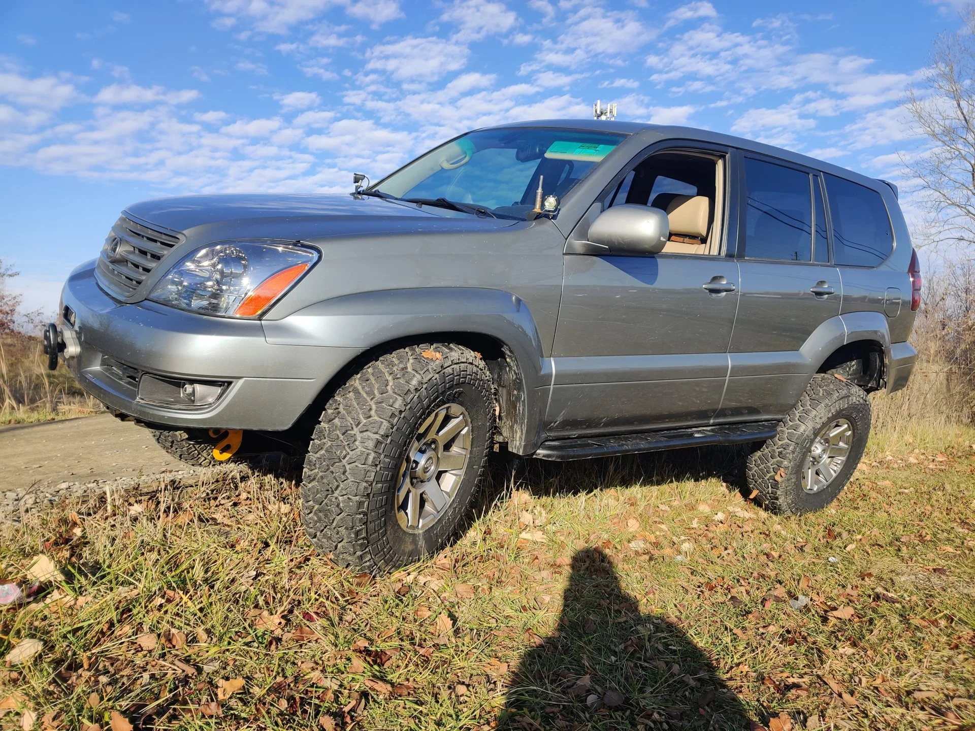

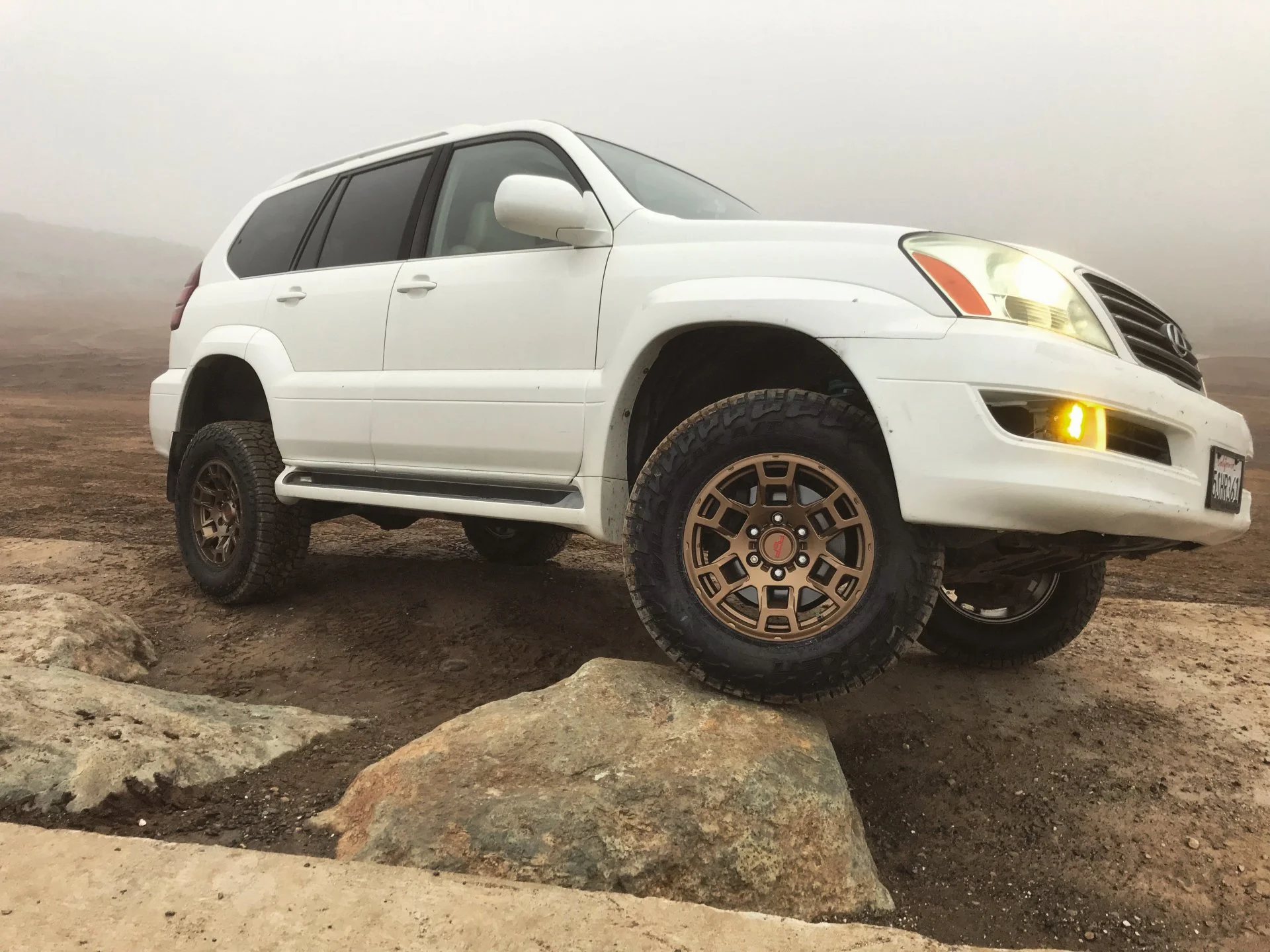

Eibach Pro Truck 1, SPC UCAs, 285/70-17 Ridge Grappler Cs, FJ Cruiser 7.5” wide wheel, a good amount of cutting of plastic.

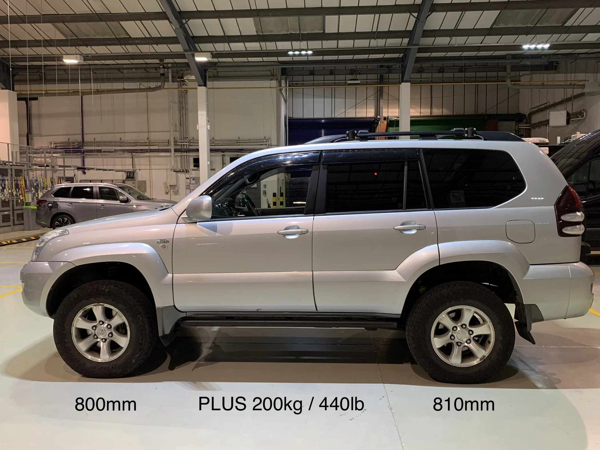

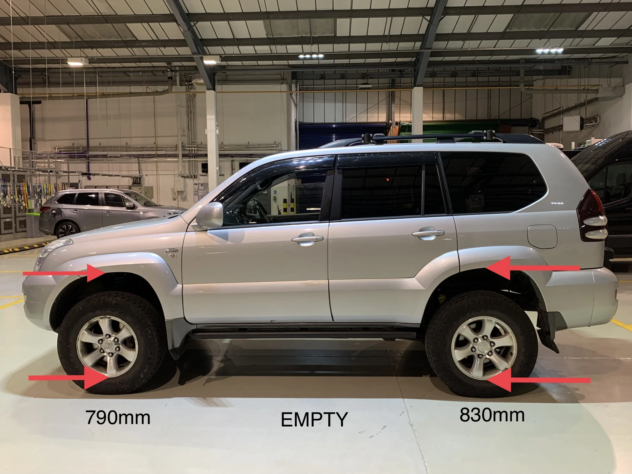

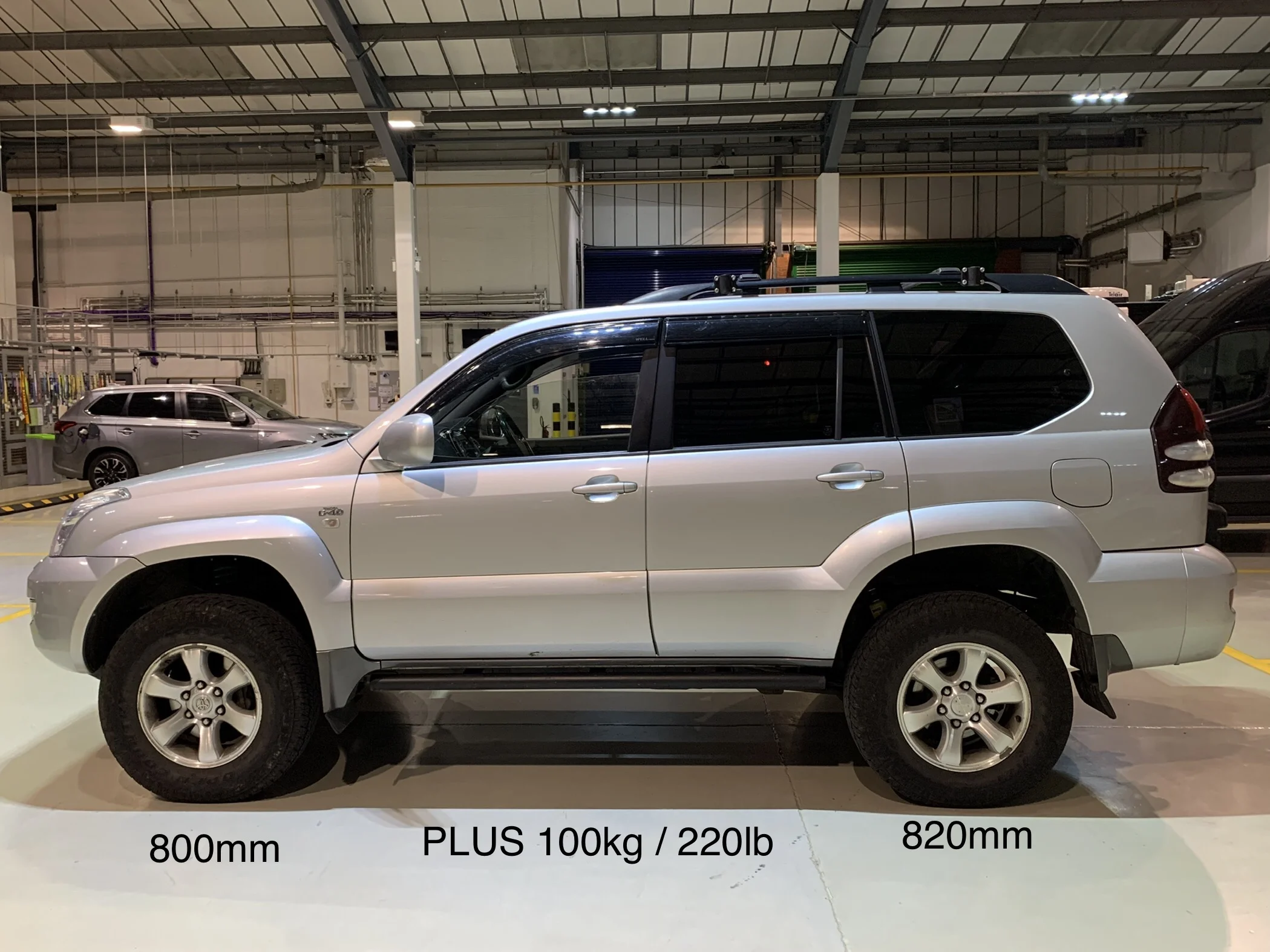

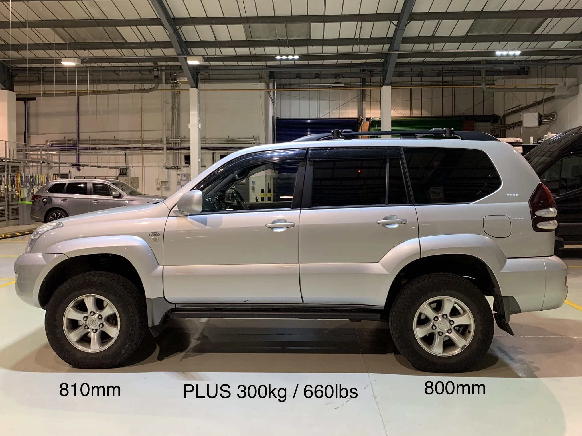

LC120 3.0l Diesel (aparently lighter than the GX)
Toyo Open Country AT3 265-70-17
Dobinsons: Front - GS59-221 & C59-302, Rear - GS59-701 & C59-327
Pre Lift: Front - 745mm, Rear 765mm
Post Lift: Front - 790mm, Rear 830mm (it had sagged quite a bit)
Measured bottom of wheel to centre of arch. (mm to inch conversion - divide by 25.4)
Photos show loads from Empty to 300kg...
Its a bit higher than I thought it would be. Will give it 6 months to properly bed in.

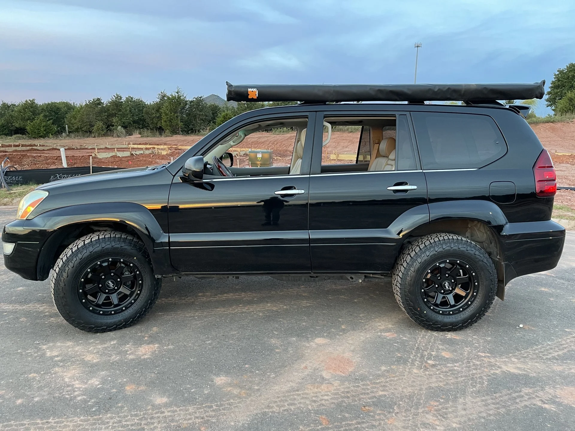

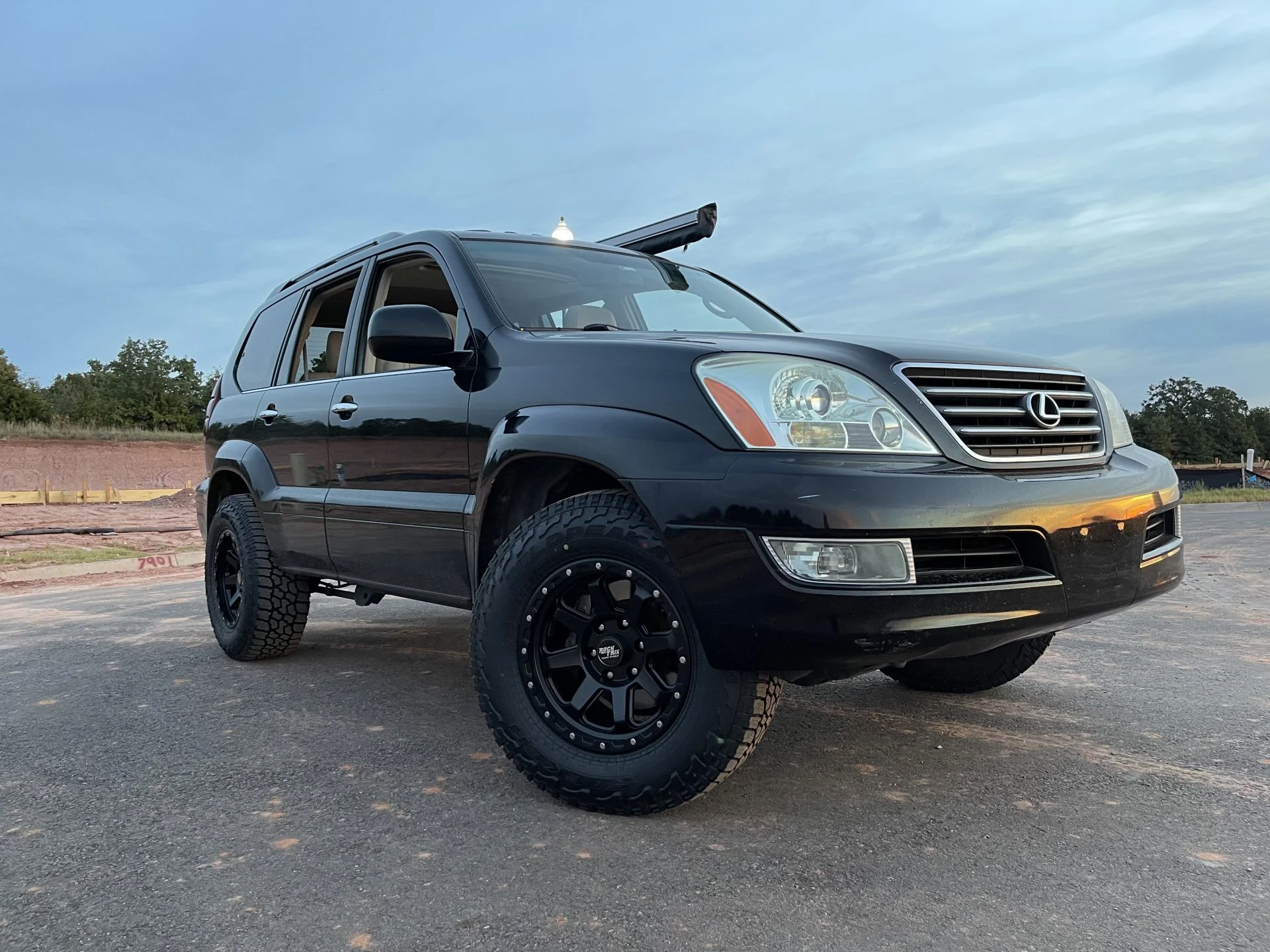

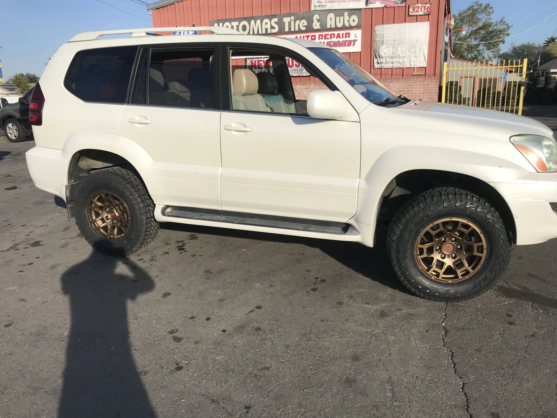

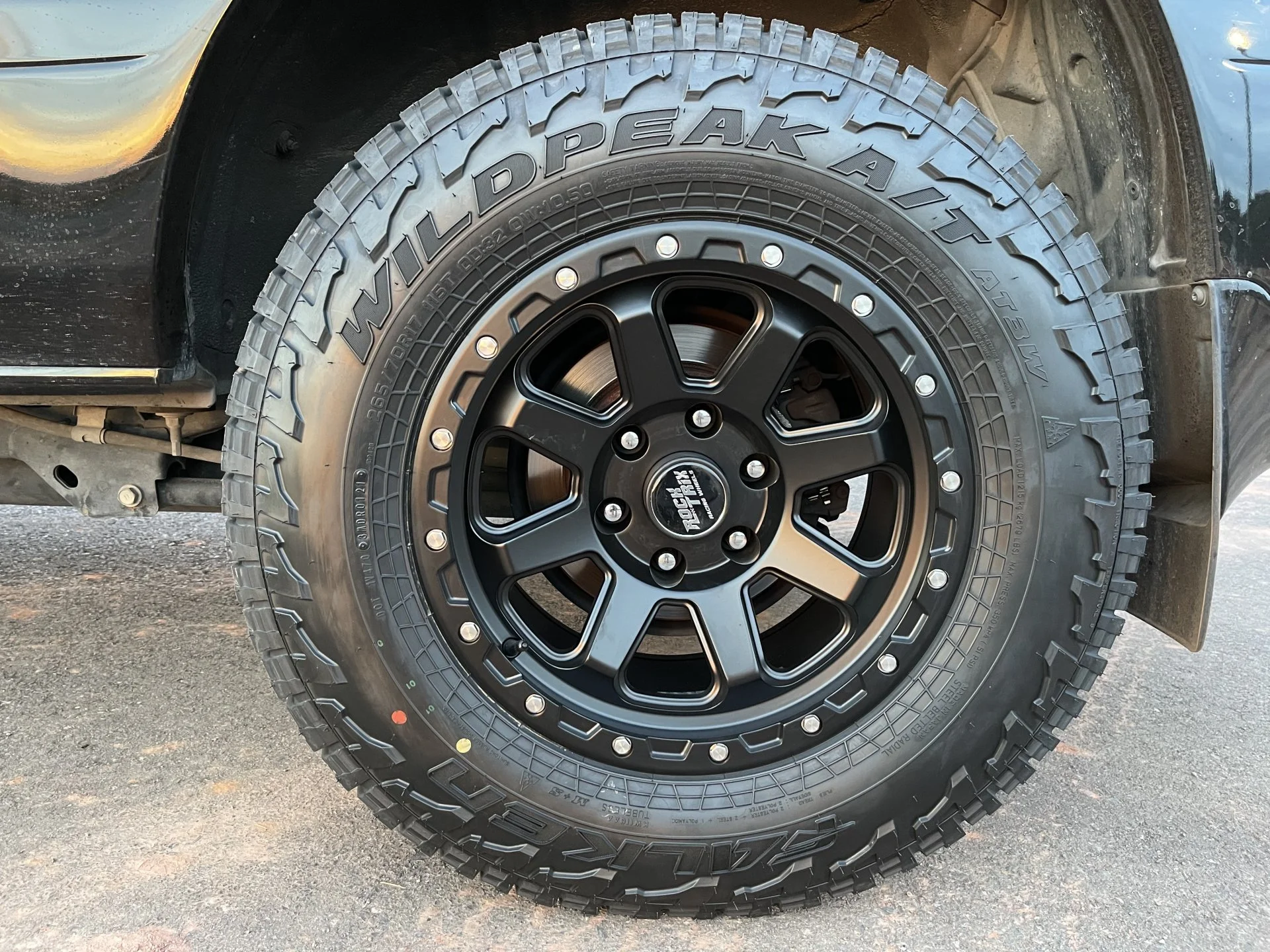

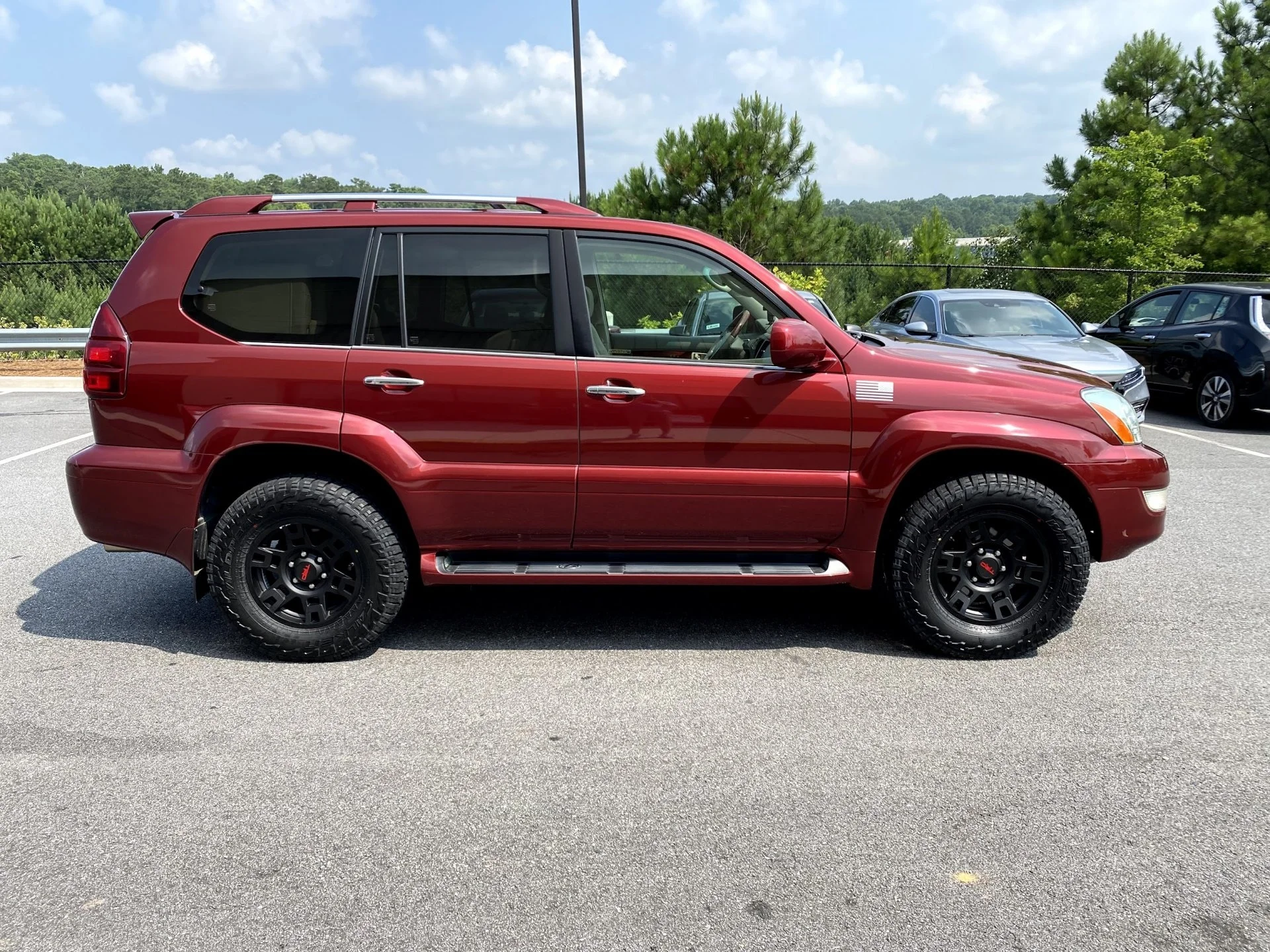

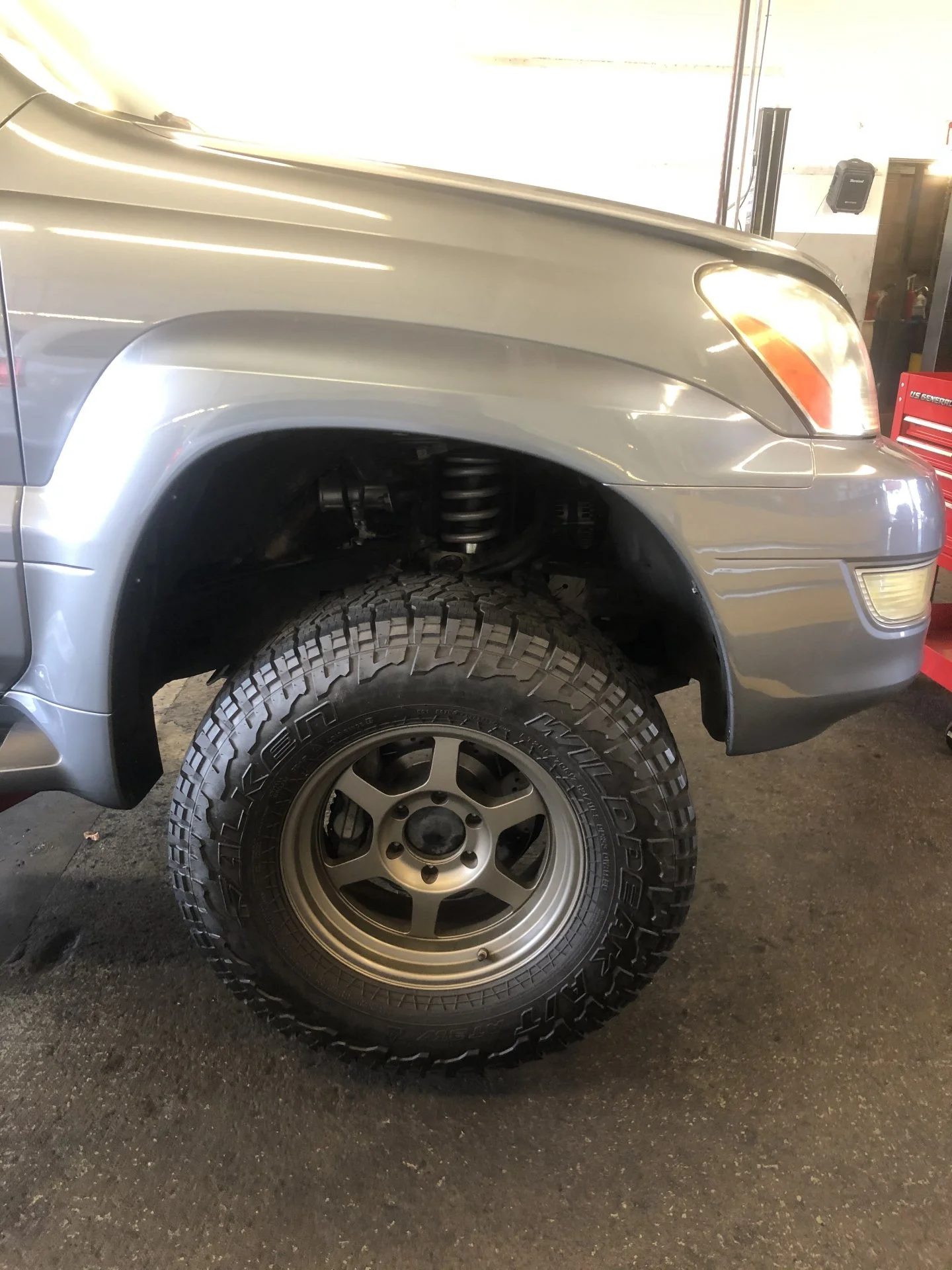

06 with Amazon special $175 wheels (-12mm offset) paired with 275/70 Wildpeak ATs
About a 2.5in lift from Bilstein 6112 shocks and spring.
JBA offroad Upper Control arms.
Stock lower control arms
Rear currently on stock bags, at N setting show in photo

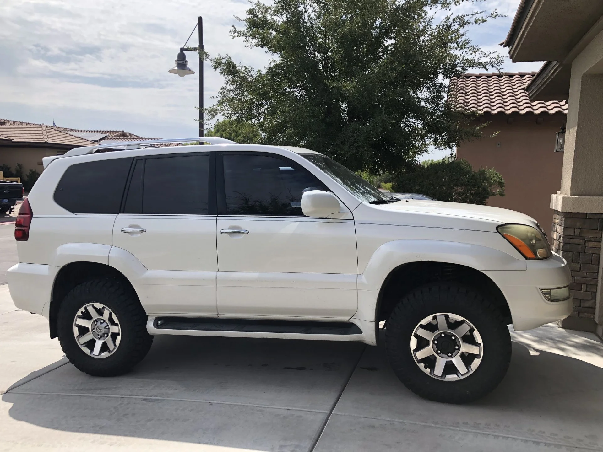

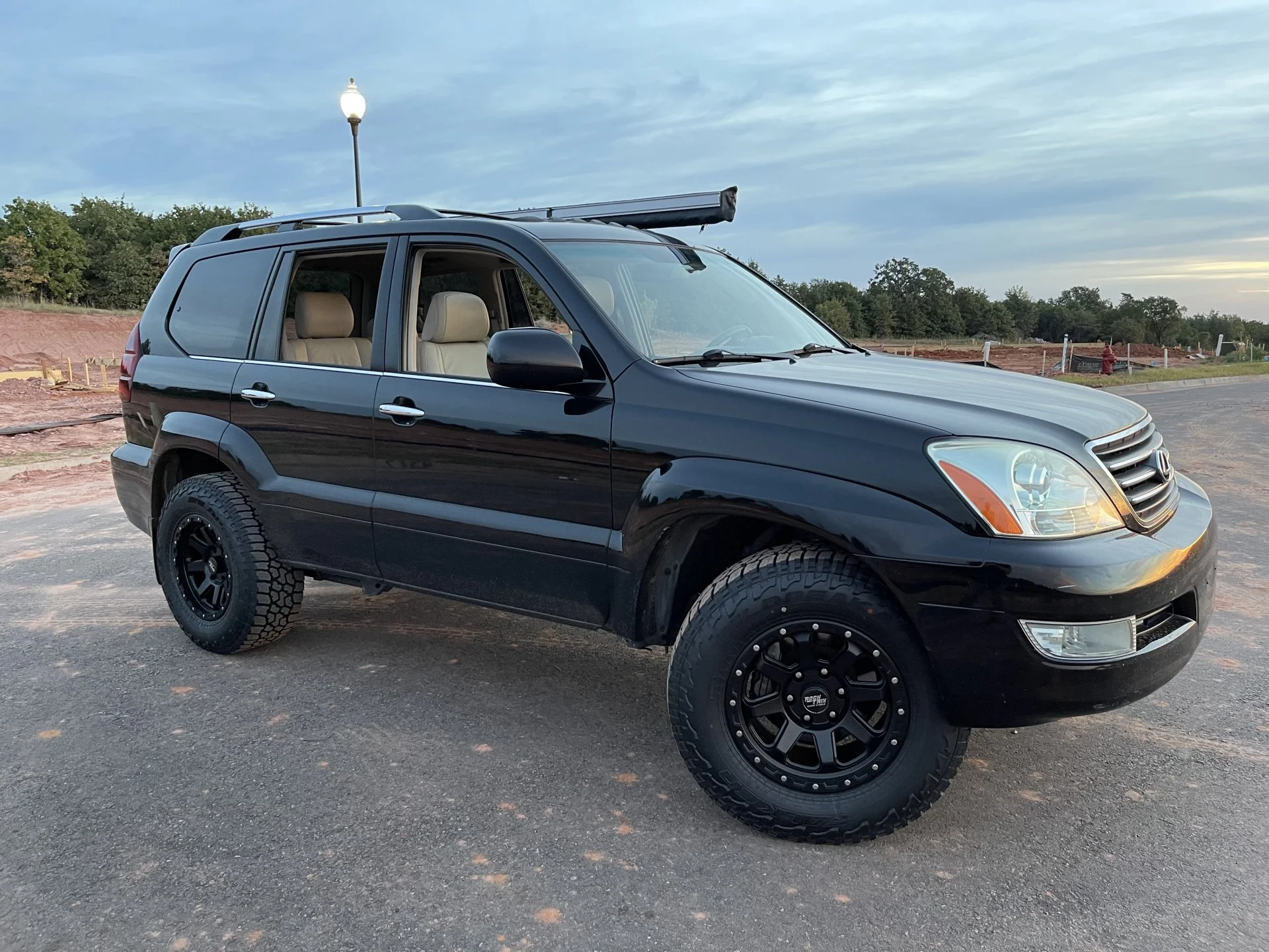

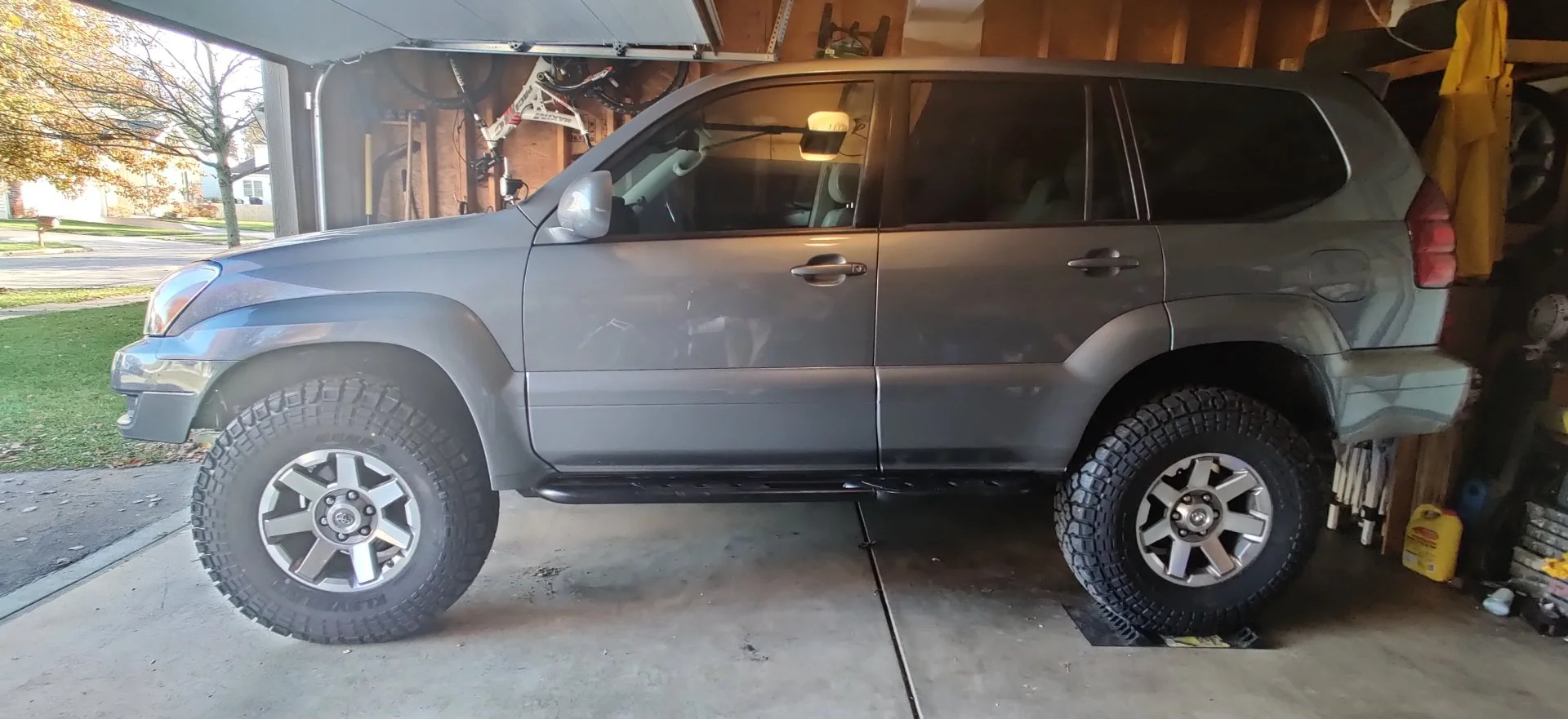

35x10.50r17 Kenda RT.
It fits in my normal 7' garage with a plenty of clearance to spare. Roof rack removed.

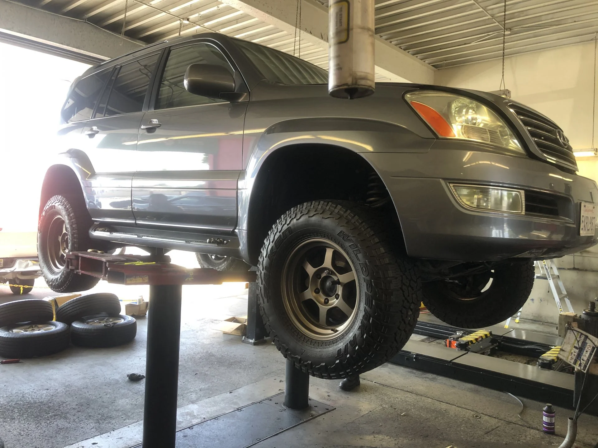

TRD off road wheels with 1" spacer = -10 offset. 3" lift, SPC UCA at E setting, Superpro quad offset LCA bushing to bring the LCA even further forward. No BMC yet, but looks it it need a little trim. Flex test in the garage shows it rub the pinch weld but did not touch the body mount. It might when reversing under heavy torque. Would need to relocate washer bottle as it would definitely get squashed at full flex.
