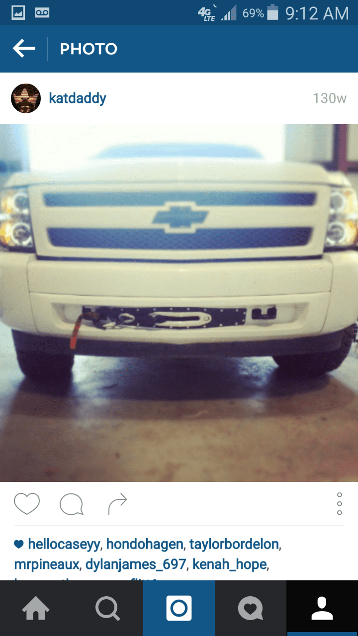

Iv built one in the past for a Silverado and it worked great ...

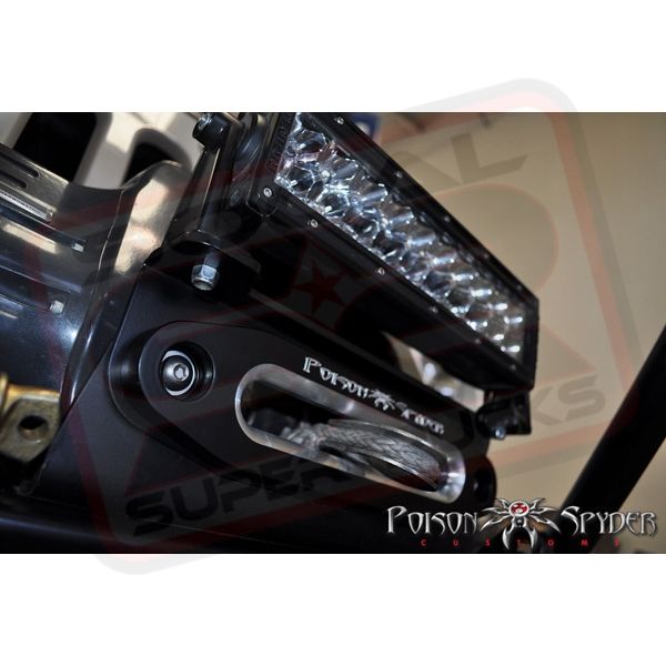

Here is some pics of the budbuilt one. Seems like you could just copy this one as much as possible?
