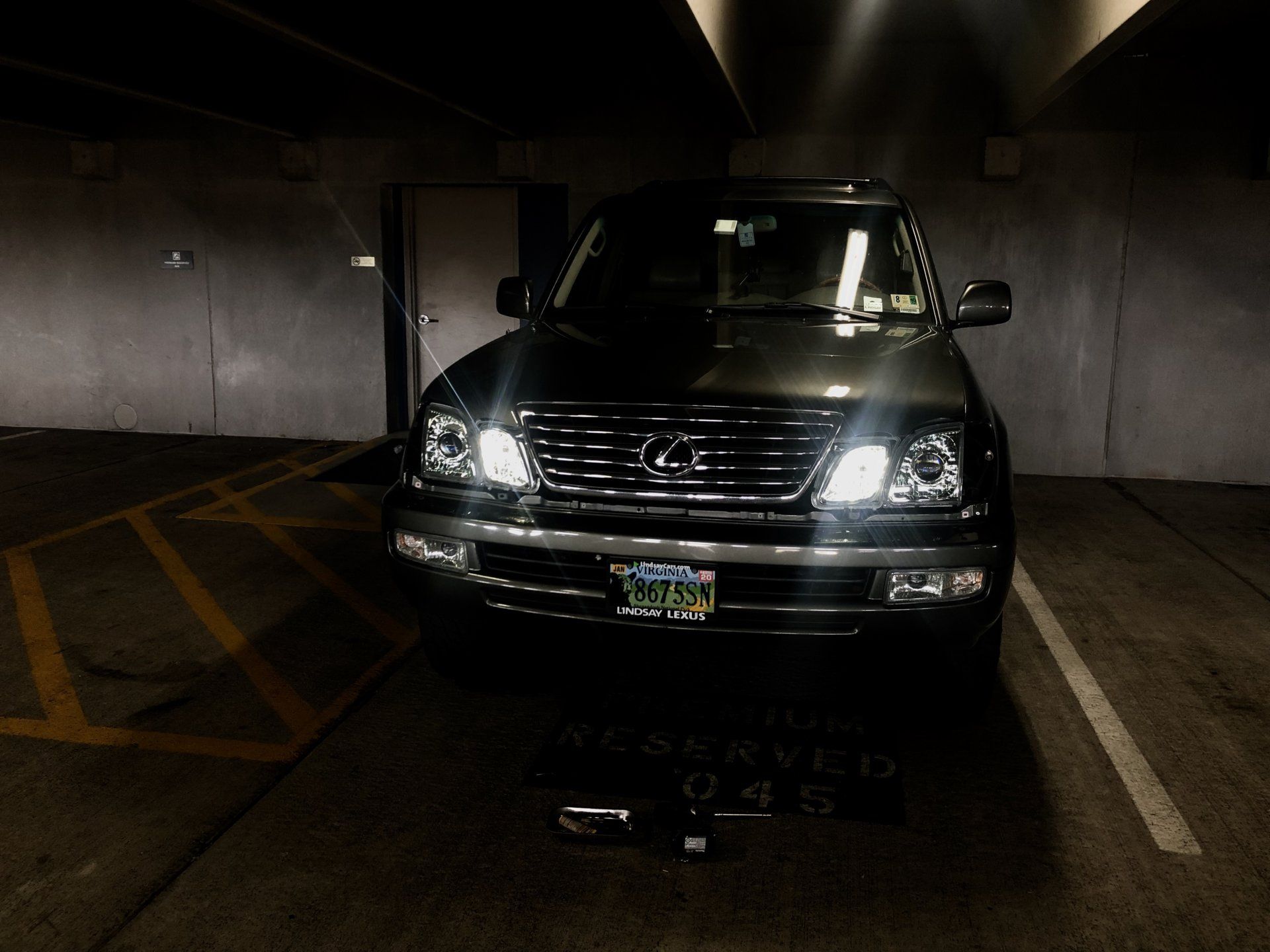

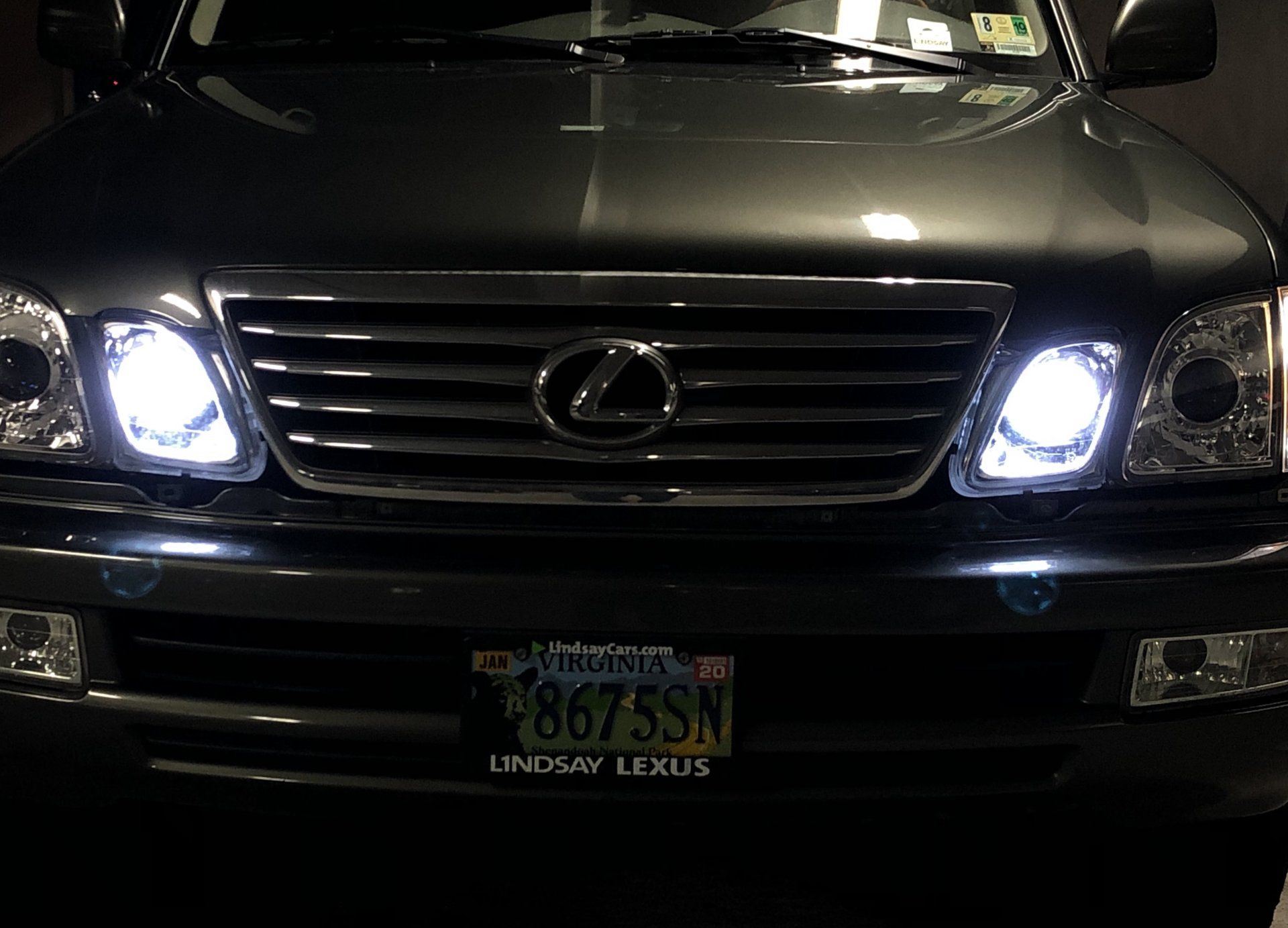

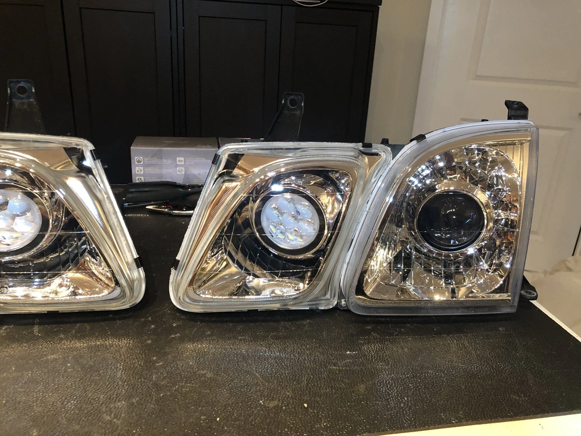

Never finished the GX retrofit but I'm running the LED High Lens as a DRL/High Beam in my LX and @jerryb came up a solution to run the Morimoto 2Stroke LED as a DRL/High Beam in 03-2007 LC and LX. Both are nice and give you a white DRL instead of the yellow color of the halogen and additional high beam for those running a Bi-Xenon in the Low beam location. There was a guy that posted pictures of nice bracket to run a quad setup in the GX and stated production was 3 weeks away.... that was in Jan. Never posted his finished lights, has 8 total post on Mud and went dark. My suggestion would be to buy a 100 or LX470 both are easy to retrofit.

First picture is the 2 Stroke LED and other 3 are the LED HI-Lens
