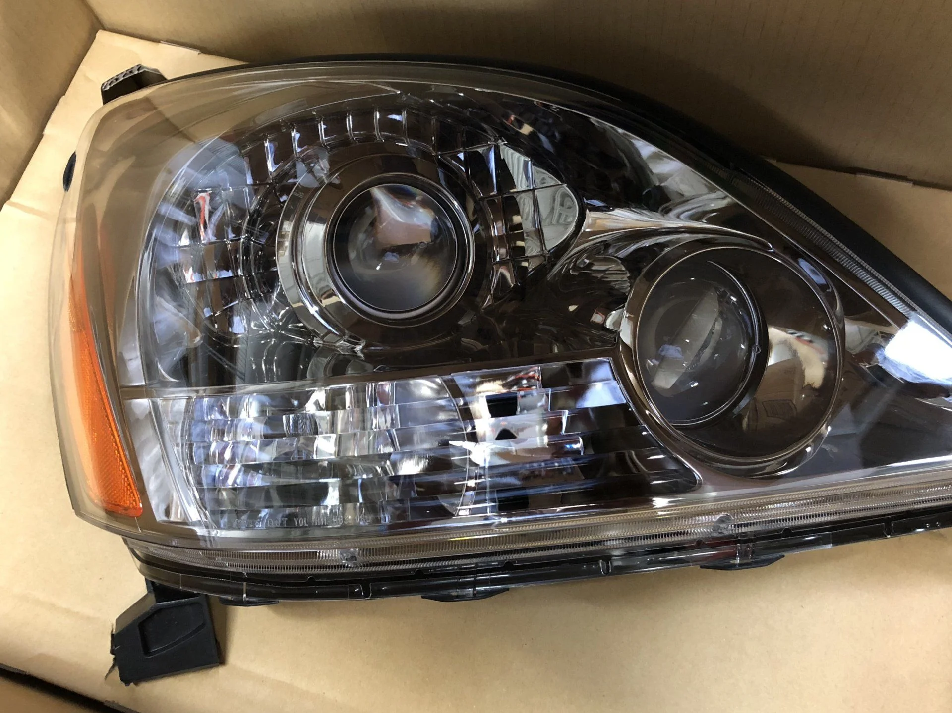

Coming over from the 100/LX470 crowd to check the interest in new OEM headlights retrofitted with a Morimoto D2S or Mini H1 Projectors. I've done quite a few LX470 retrofits including a few quad setups.
The GX470 OEM Sport Package headlight which is smoke color is quite a bit cheaper then the standard light so I ordered one to see what it would take to complete a full retrofit. The light output and cutoff is outstanding in the LX lights I've done so I thought I might offer the GX crowd something new.

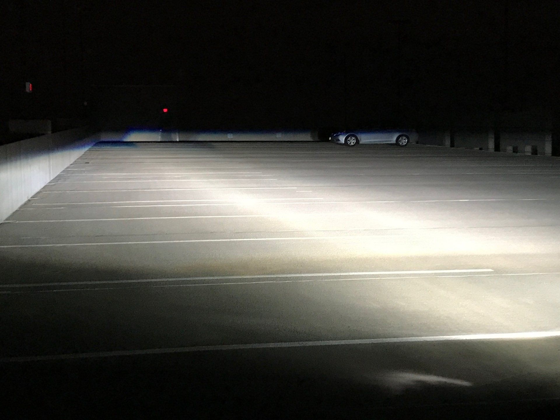

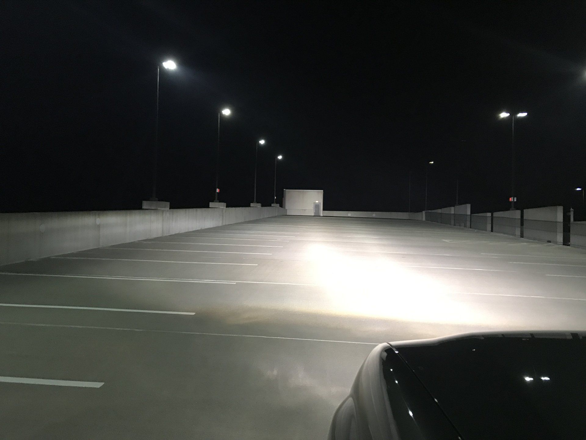

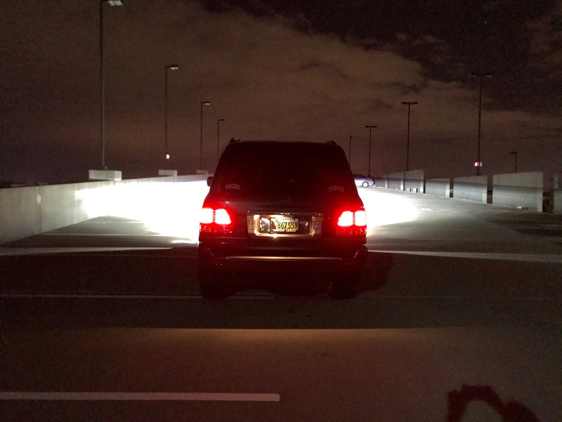

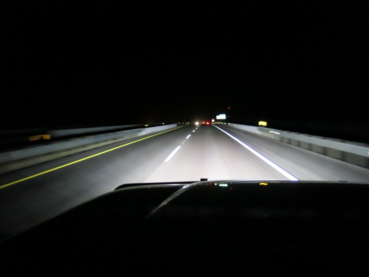

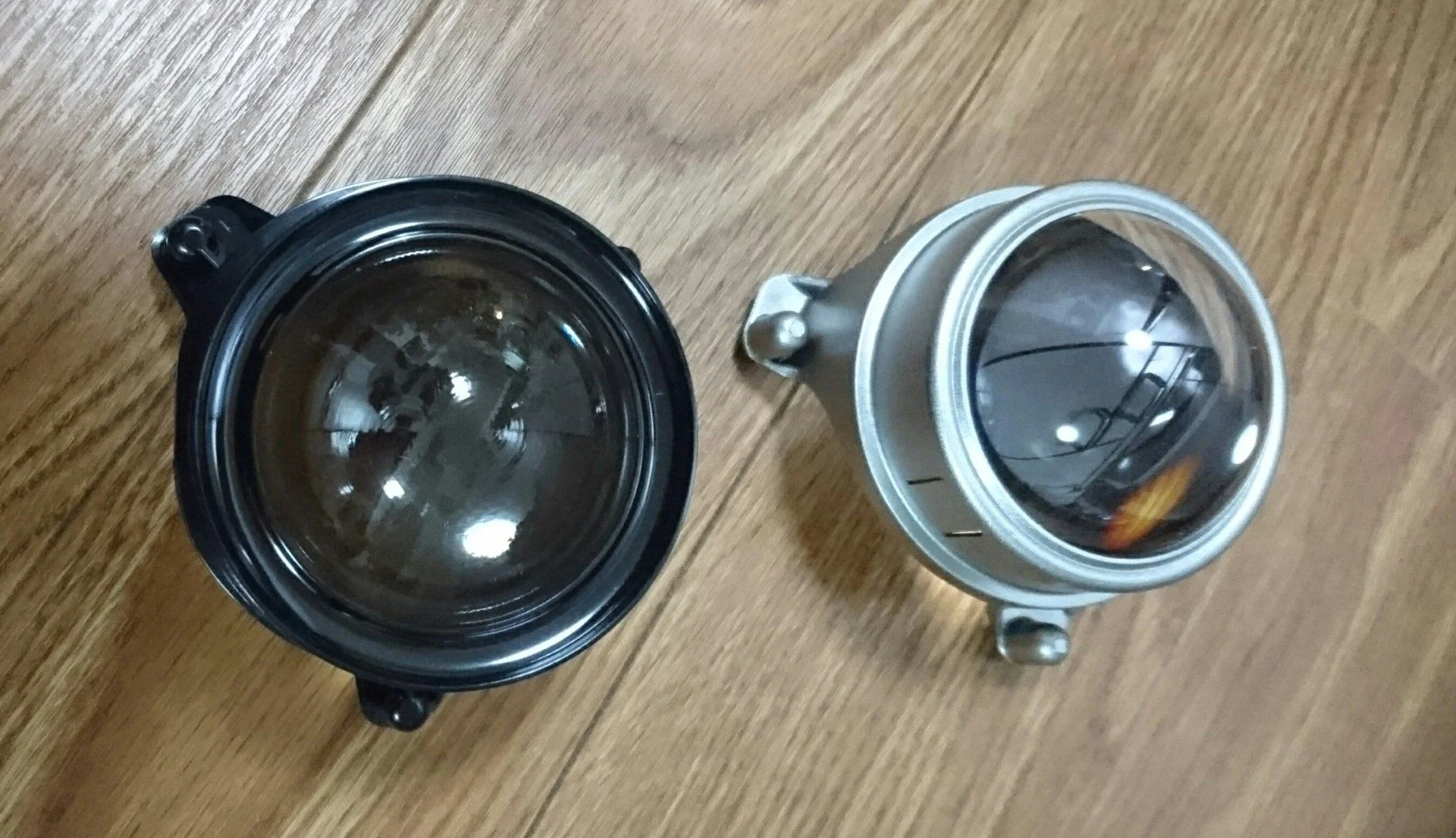

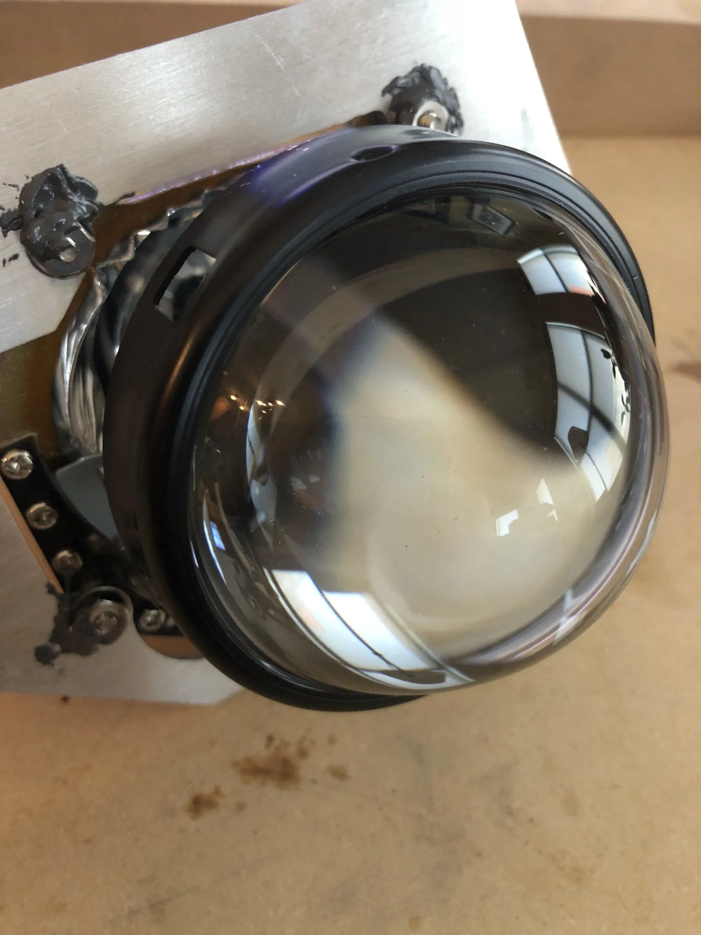

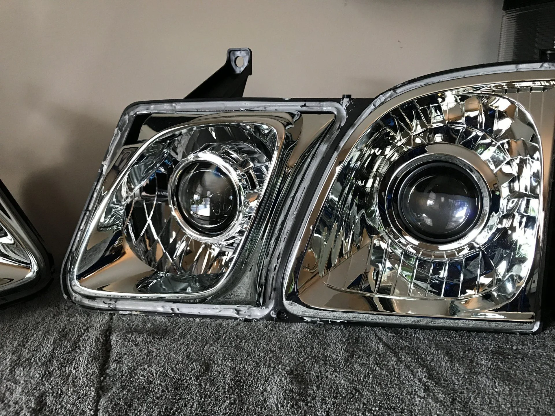

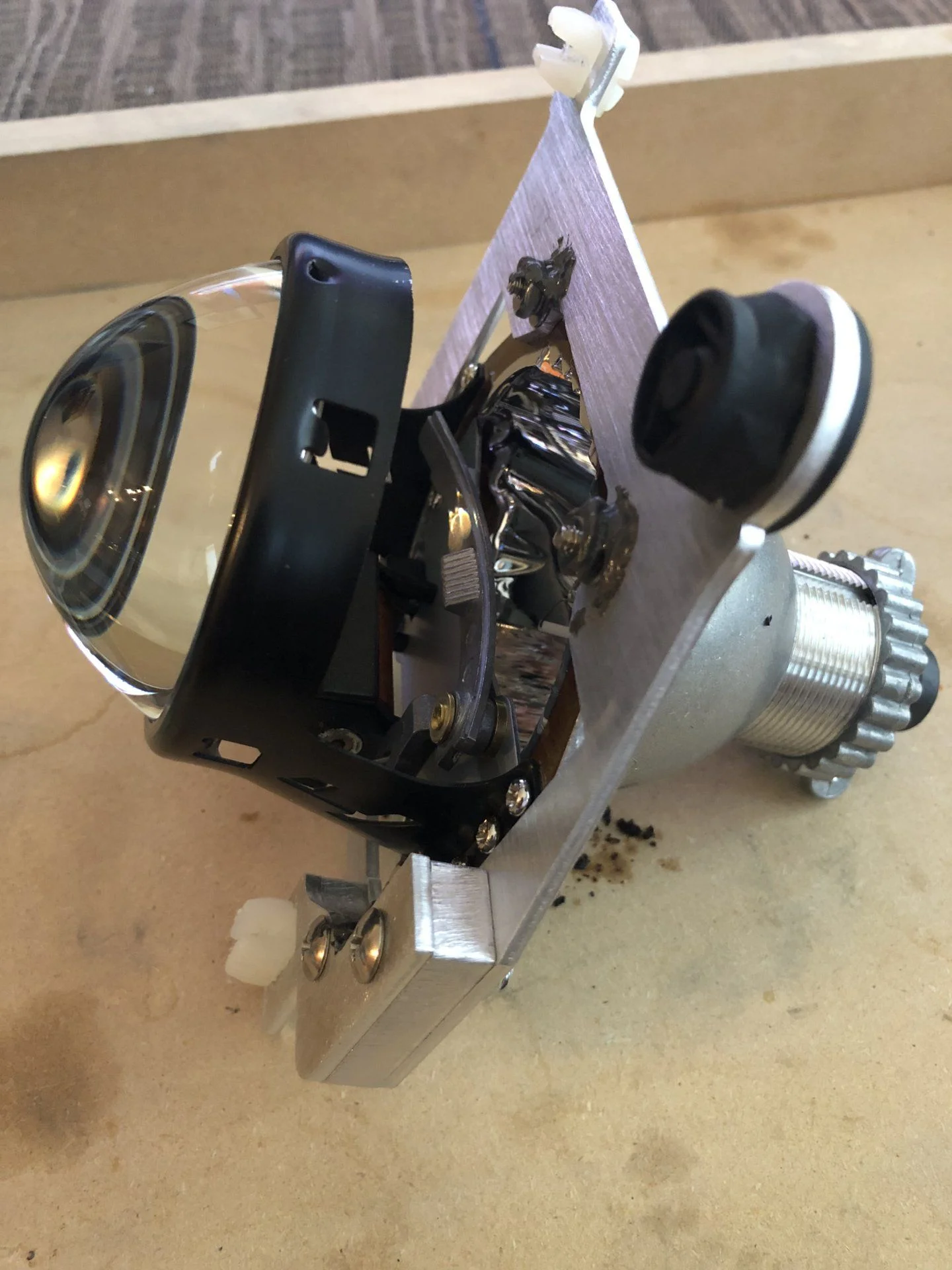

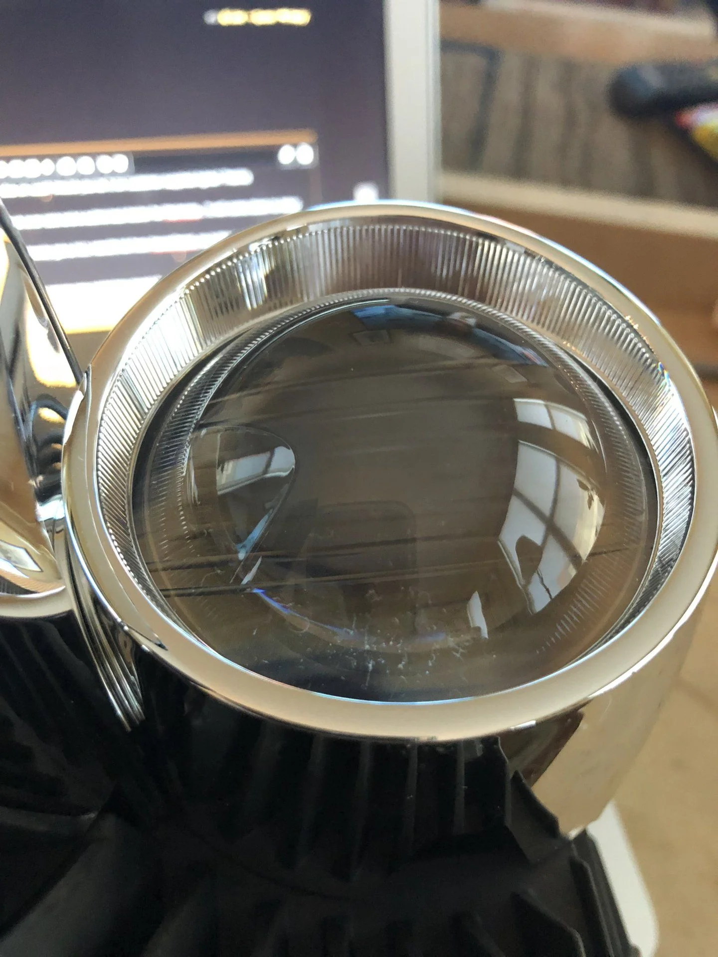

Installing HID bulbs into halogen projectors is a quick and inexpensive upgrade for the GX but there's no comparison in light output or the sharp cut off you get with HID projectors. I fully understand cost to benefit... so when I purchased my LX I installed a kit similar to the one you used and took it one step farther. Opened up the housing and put a clear lens...replacing the factory lens that comes with slight distortions to defuse the light a bit but there was no comparison to my 80 that was running Depo lights retrofitted with Mini H1. So I spent about 8 months and built a bracket to install Morimoto projectors into the LX.. The links in my signature tell the story.

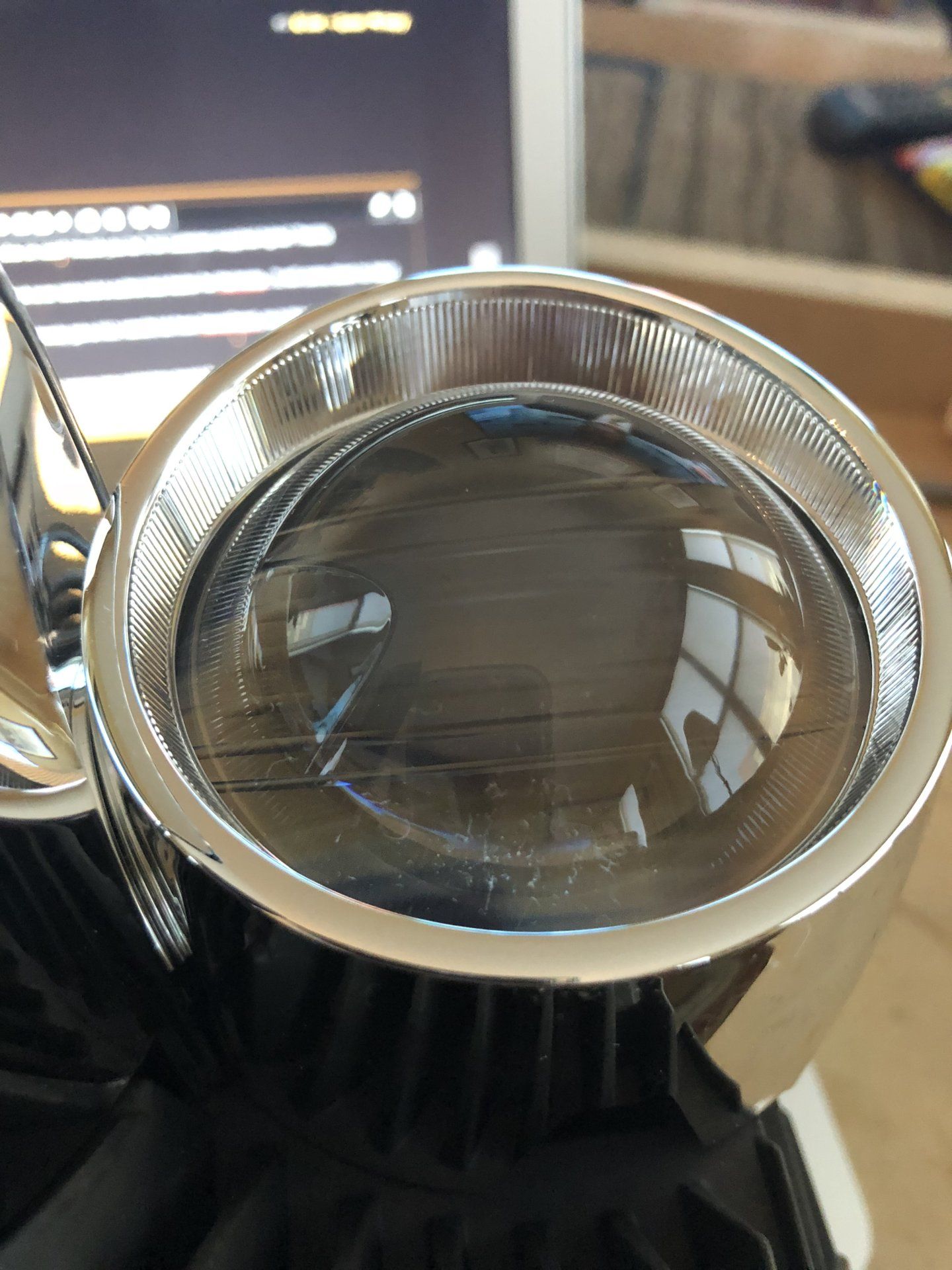

First picture shows the built in distortion in a fairly new OEM Lexus LED IS250

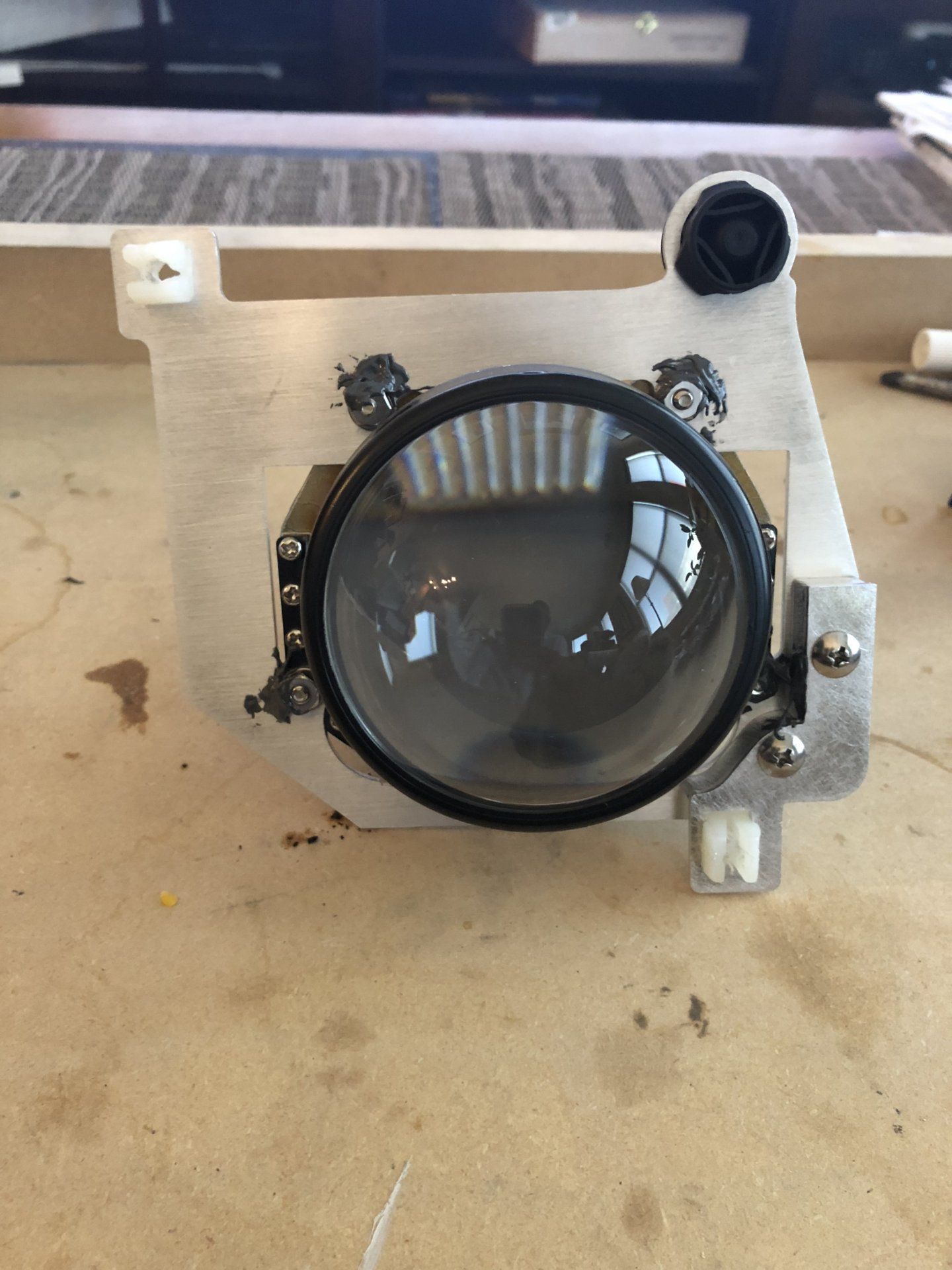

projector and a few pictures of the D2S projector on one of the brackets. If you’re wondering I use a bit of JB Weld on the mounting nuts so they’ll never loosen overtime

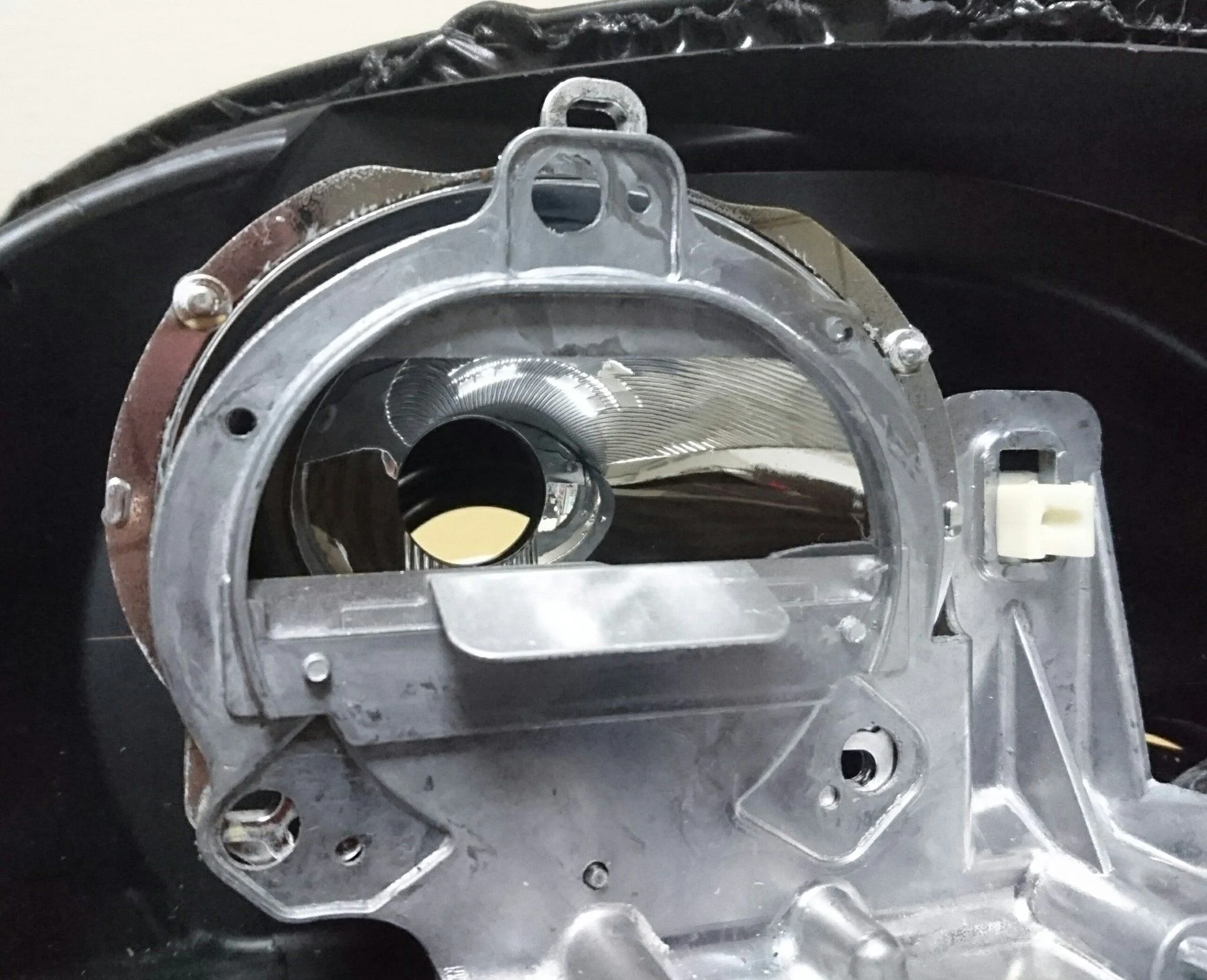

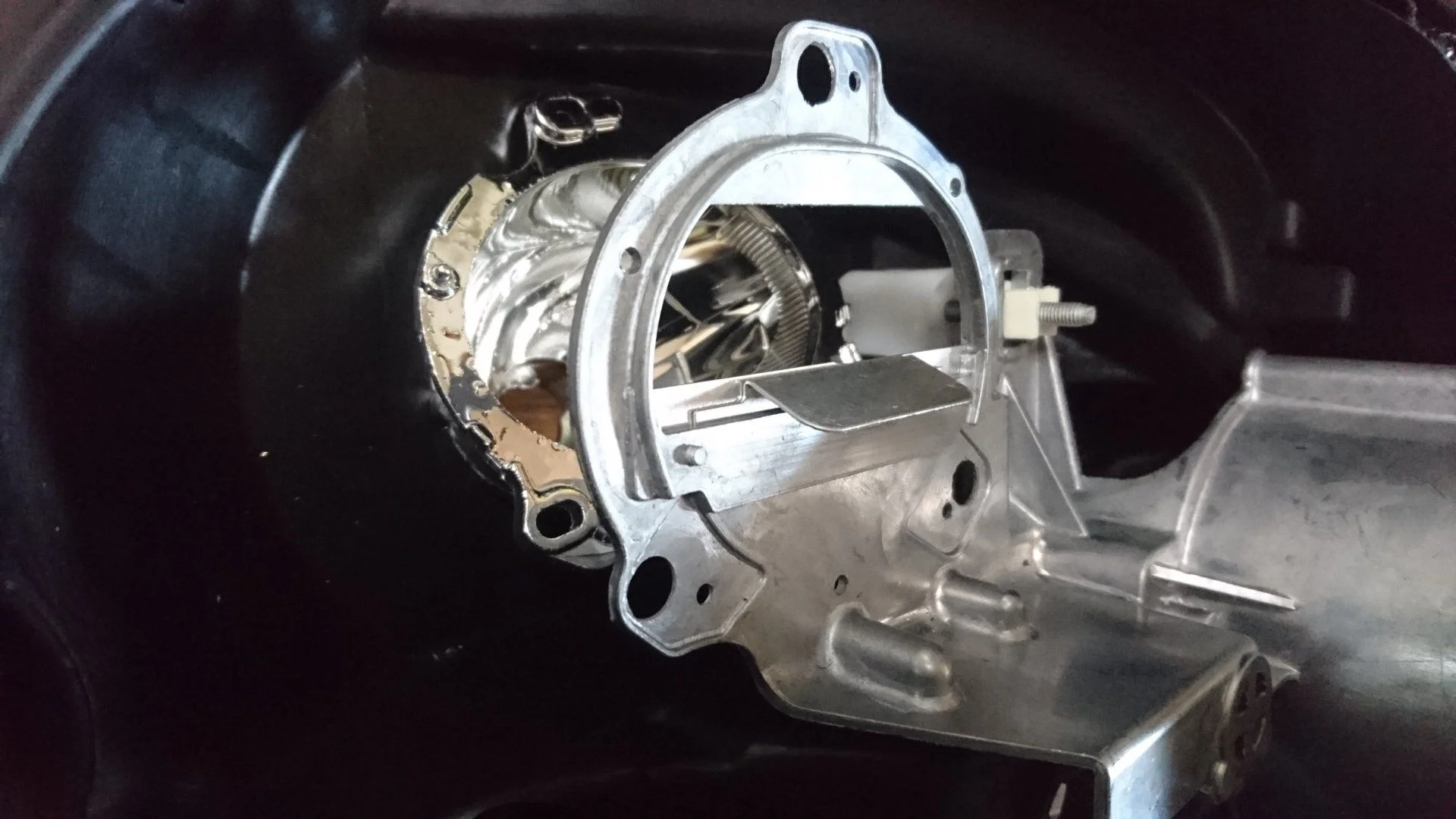

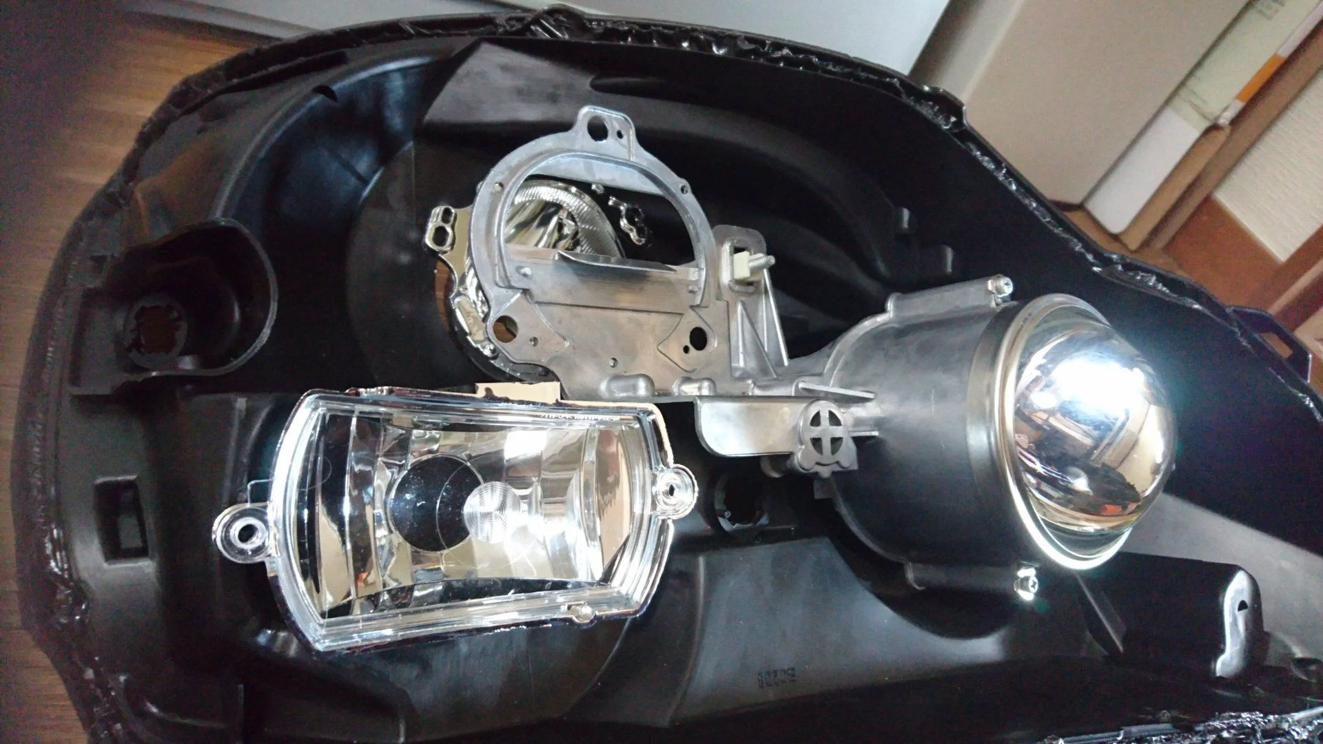

Until I open up one of the lights and see exactly what I’m dealing with regarding mounting and what projector will actually fit .....the D2S projector is 3 inches in diameter and requires the shroud to be opened up to fit that in the LX470 it may be the same for the GX 470
I’ll build one light and see what’s involved and post up when they’re done. I may need Guinea pig who lives local so I can adjust them properly which means you’ll get a great deal

First picture is a low beam output shot of my 80 running Mini H1 with 5000k bulbs and 50w Ballast....
Luke, if you need any pics, I still have mine apart. I'm trying to decide if I want to do any custom LED work while I've got them open.
