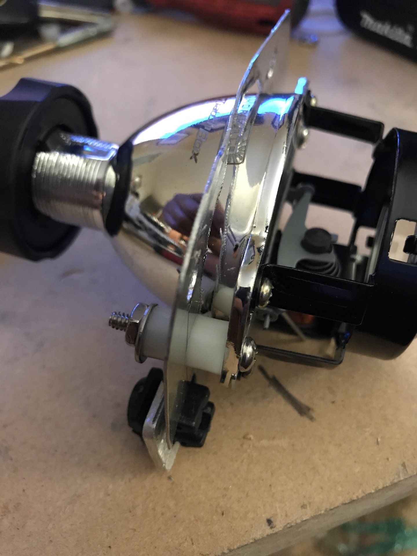

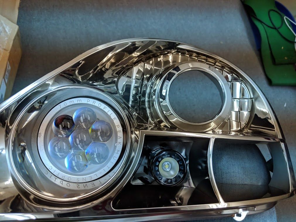

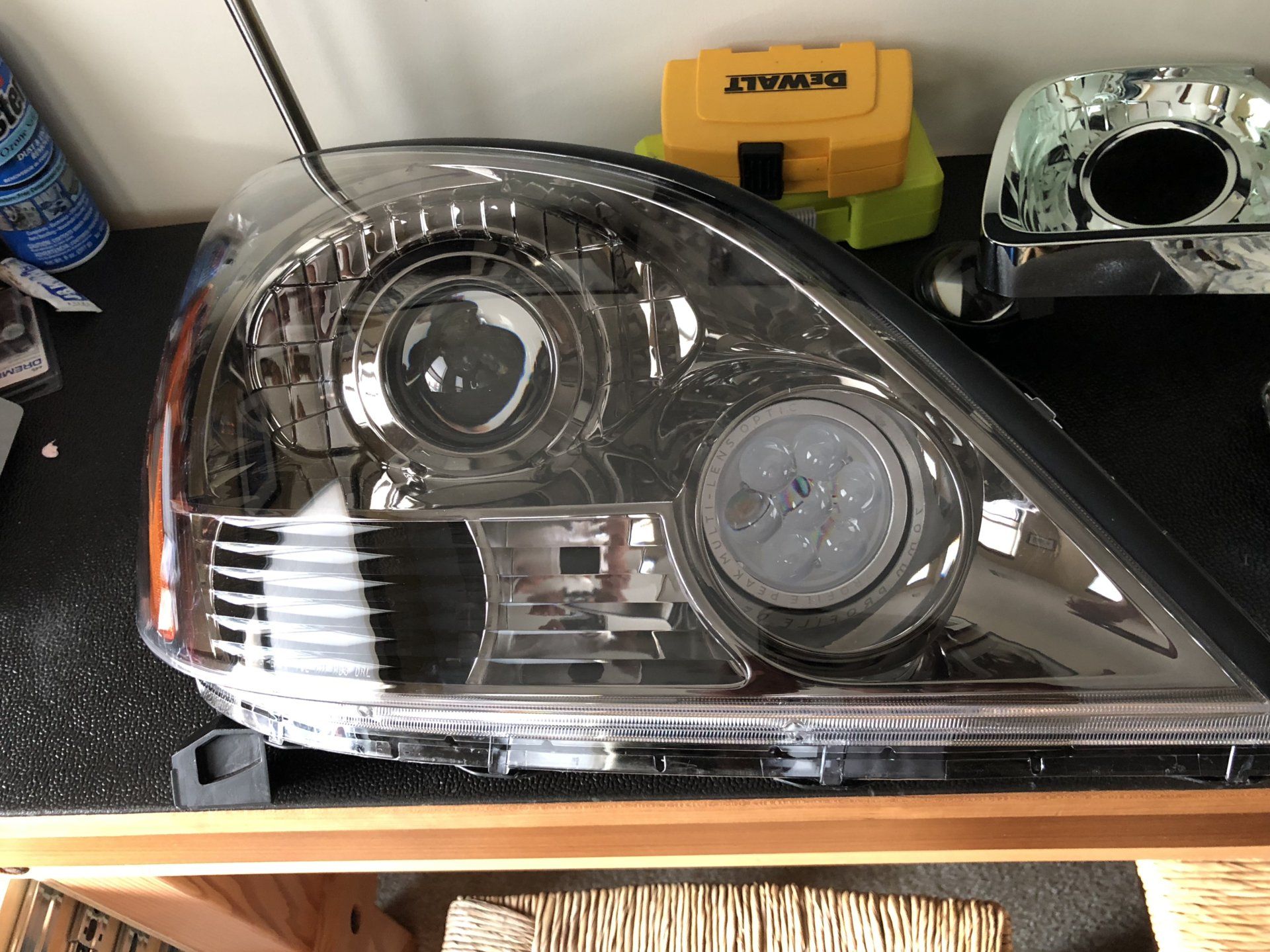

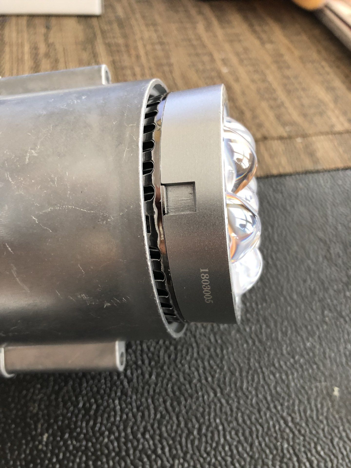

Mounting a D2S 4.0 projector would require some serious engineering but I was able to mount a Mini H1 7.0. To really do a proper retrofit it would require making a simple bracket...
I hacked up one of my Mini H1 brackets
and bolted it to what was left of the OEM bracket.
For the LED high beam a simple cut using a Dremel allow the LED to sit level
and there was just enough of the threaded shaft for the bolt to hold it in place. This would not be adequate for a permanent retrofit but just for the test it worked great ..I’d mockup a different mounting method which wouldn’t be that difficult
I’ll try to far these things up in a couple days and shoot some output shots

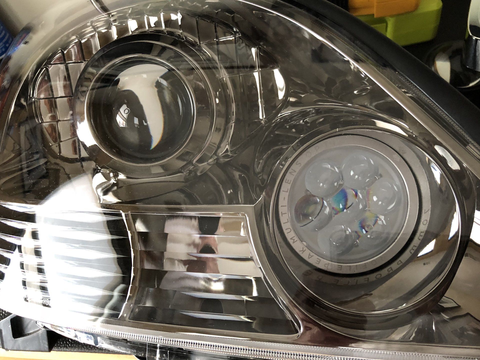

So the RX projectors are not Bi-xenon (low and high beam)? If that's the case the LED would be a great addition. The Mini H1 7.0 that I'm using is Bi-xenon..... so you'd have 4 high beams firing.
No, they are low beam only HIDs. My setup still has the stock GX high beam.
The Hi Lens would be a easy install for you
My high beams are garbage! I'd love to hear more about fitting those into my lights!
Your low beams probably suck also... the install is easy .....opening up the lights and removing the bracket was the adventure...

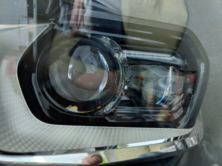

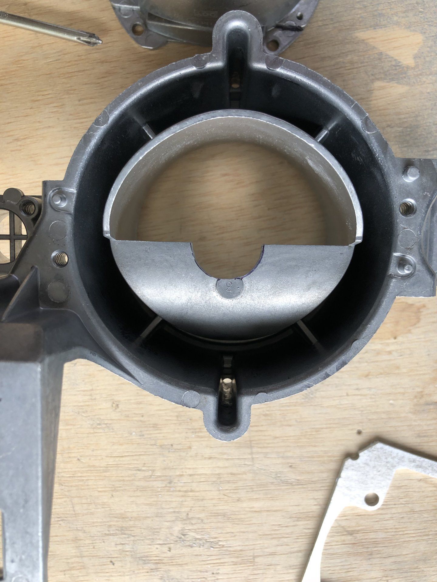

Need to bake and tear the Sienta Lights apart....
Modpod sits really nice in the underutilized section here....
Luke is soooo right with these!

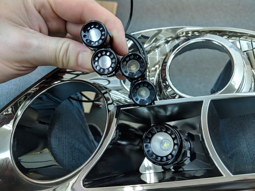

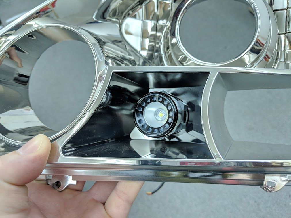

These might be a bit overkill...I really want to utilize the OEM turn signal reflector in some way...seems a waste not too....guess we'll see how it all looks with the Sienta projectors in and the shroud cut. I bought 8 of these mini mod pods, knowing I may not use them in the headlights, but there is so many ways they can be used. I got the switchback version so they can all function as DRL/Turn signals.

We put these in the front turn signals. My son turned the DRL function off and wired the white lights to 12v switched so I now have nice white DRLs that remain on with the headlights. The turn signal switches over to the amber. If he turns DRL function on then they are amber like the stock setup.

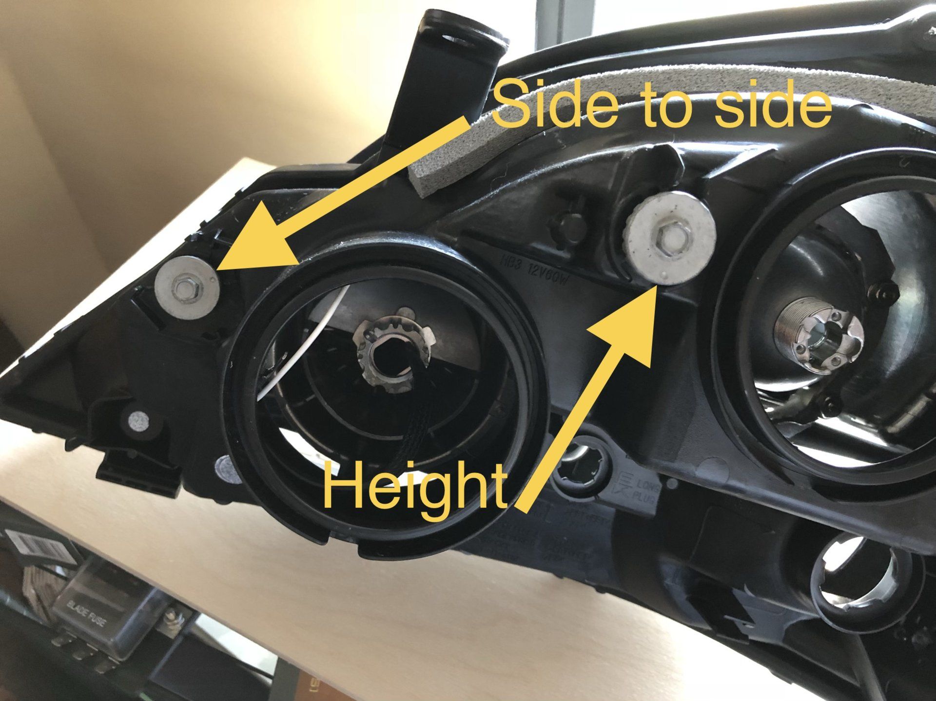

i like the Mini pods but I would suggest you don't cut your shroud until you figure out how you plan on mounting the Sienta lights.. Will they mount on the bracket? How will you adjust the rotation(horizontal level), height and side to side adjustments?

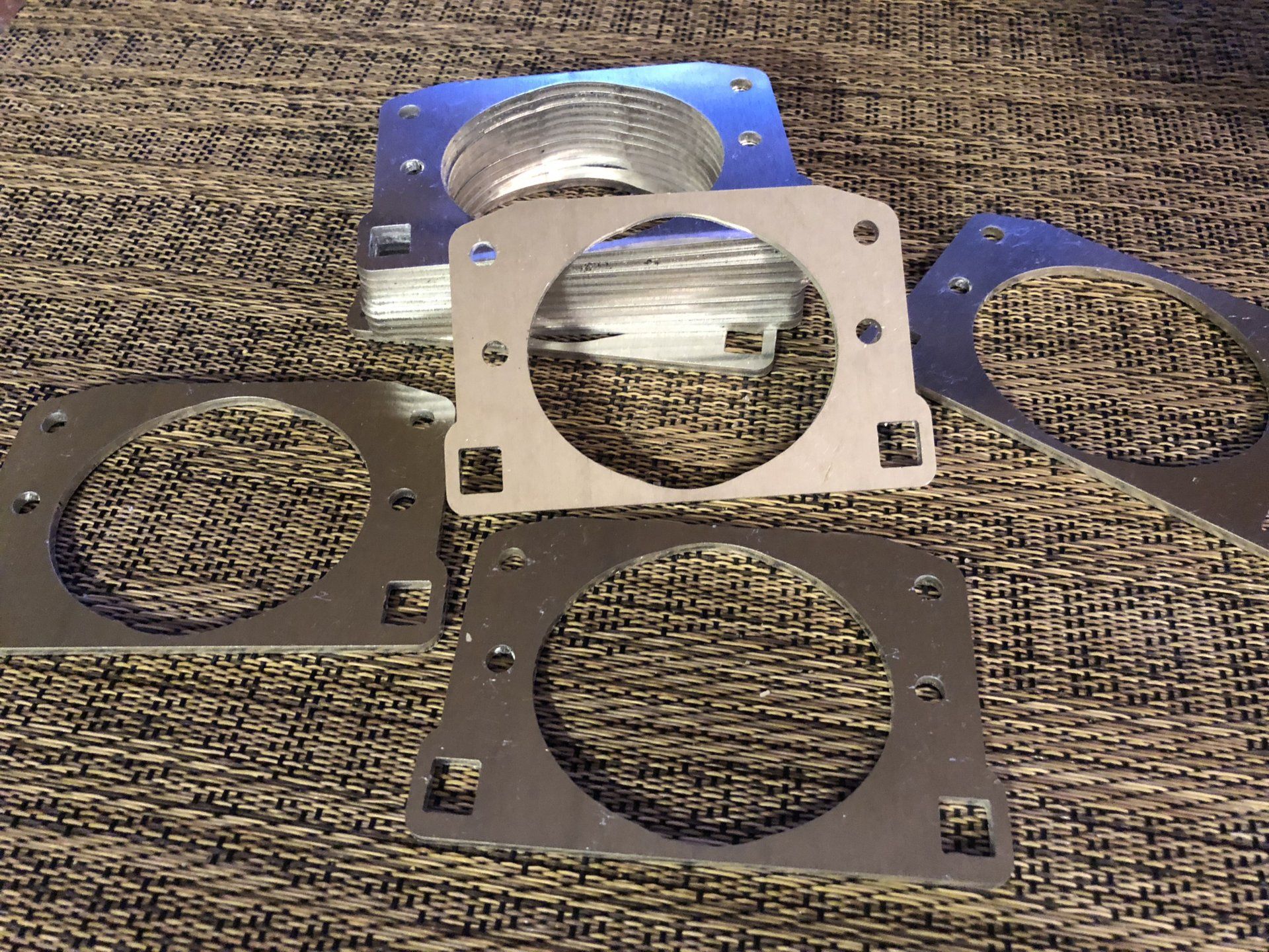

Here’s the Matchbox mounted to a bracket I quickly made out of sheet metal... but have since had a dozen laser cut.. The little Matchbox has amazing light output and a nice cutoff
@Luke111 are you planning to make brackets for the GX470 similar to the LX470?
Not in the short term...the cost involved vs return doesn't calculate... just opening the lights and removing bracket is 3-4 times harder then the LX. The OEM bracket would have to be cut and the new bracket attached to the remaining portion.. The GX has one large bracket housing both low and high beam so a new bracket would have to be attached to allow full adjustment. I'll continue working on this and might offer fully retrofitted lights in brand new OEM housing.
Hoping they will mount on the bracket will definitely heed your advice, no cutting till I have the Sienta lights apart. I was out of the country til last night so no progress on that front yet.
On that topic, correct me if I'm wrong but the GX doesn't have the manual height adjustment? (Small dial) The Prado does, as does the Sienta, so I'm wondering if I can find a way to make that work.
Sorry, I mean electric manual adjustment...as in there is a small motor on the height screw (or possibly a secondary height screw?) that raises and lowers the height via a dial inside the vehicle. The Prado has it, the Sienta has it, I'm just hoping I can retrofit it on to the GX headlights since the motor itself is the same and should be plug and play..
