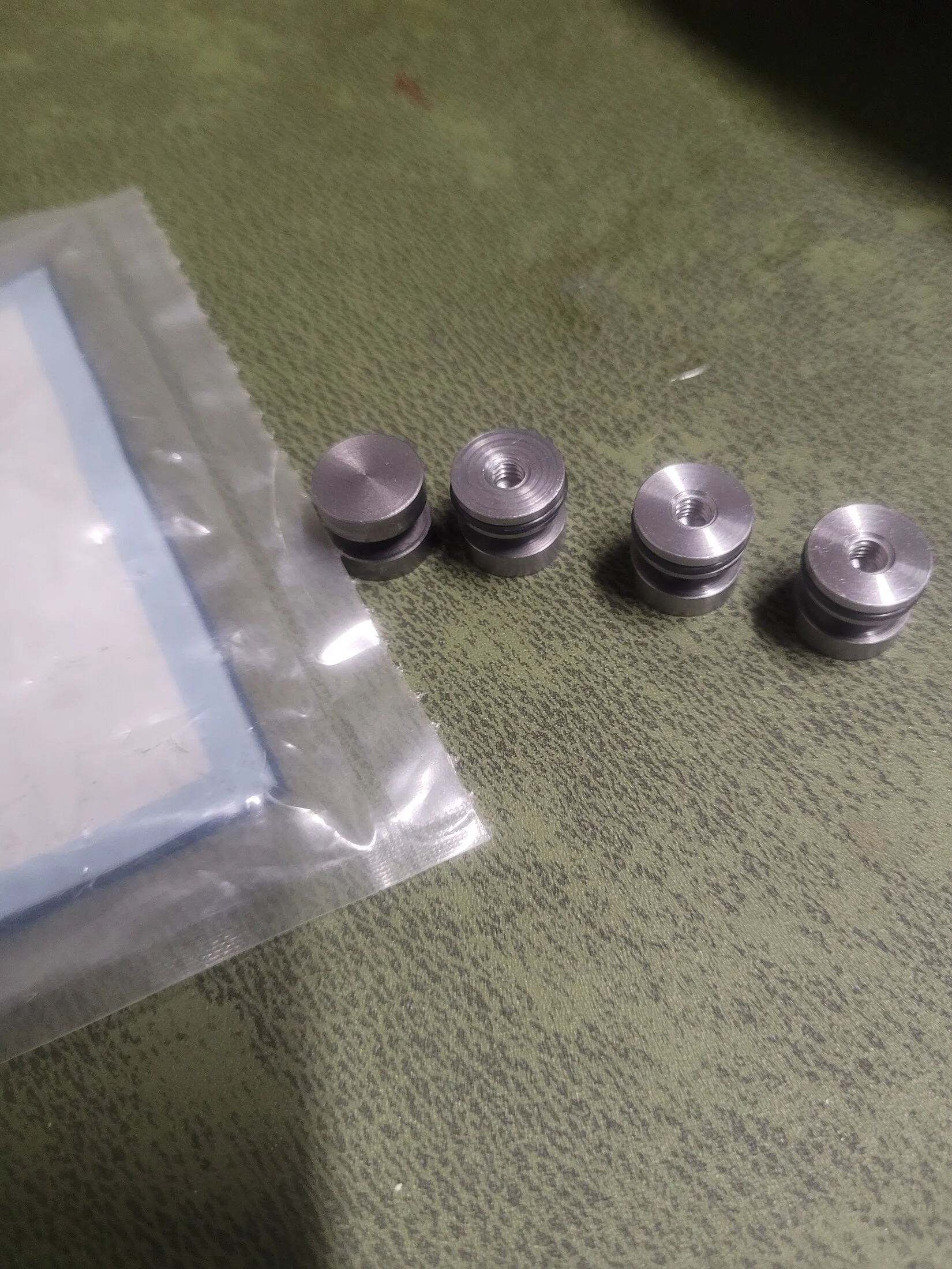

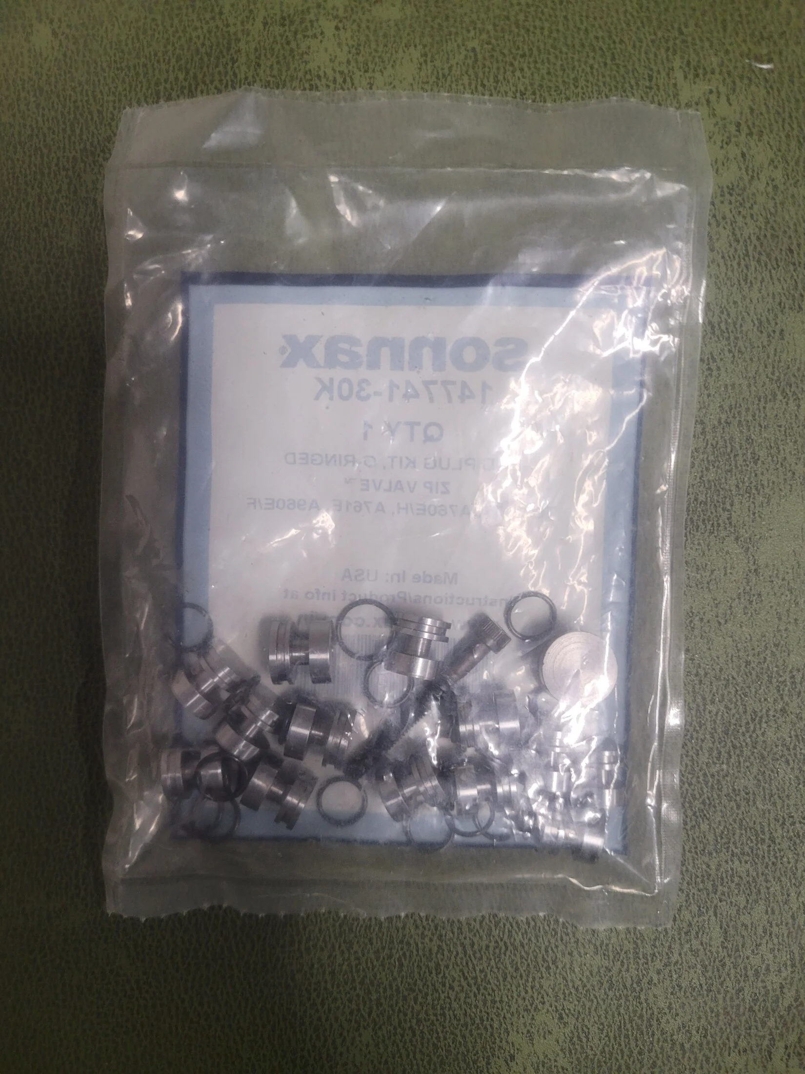

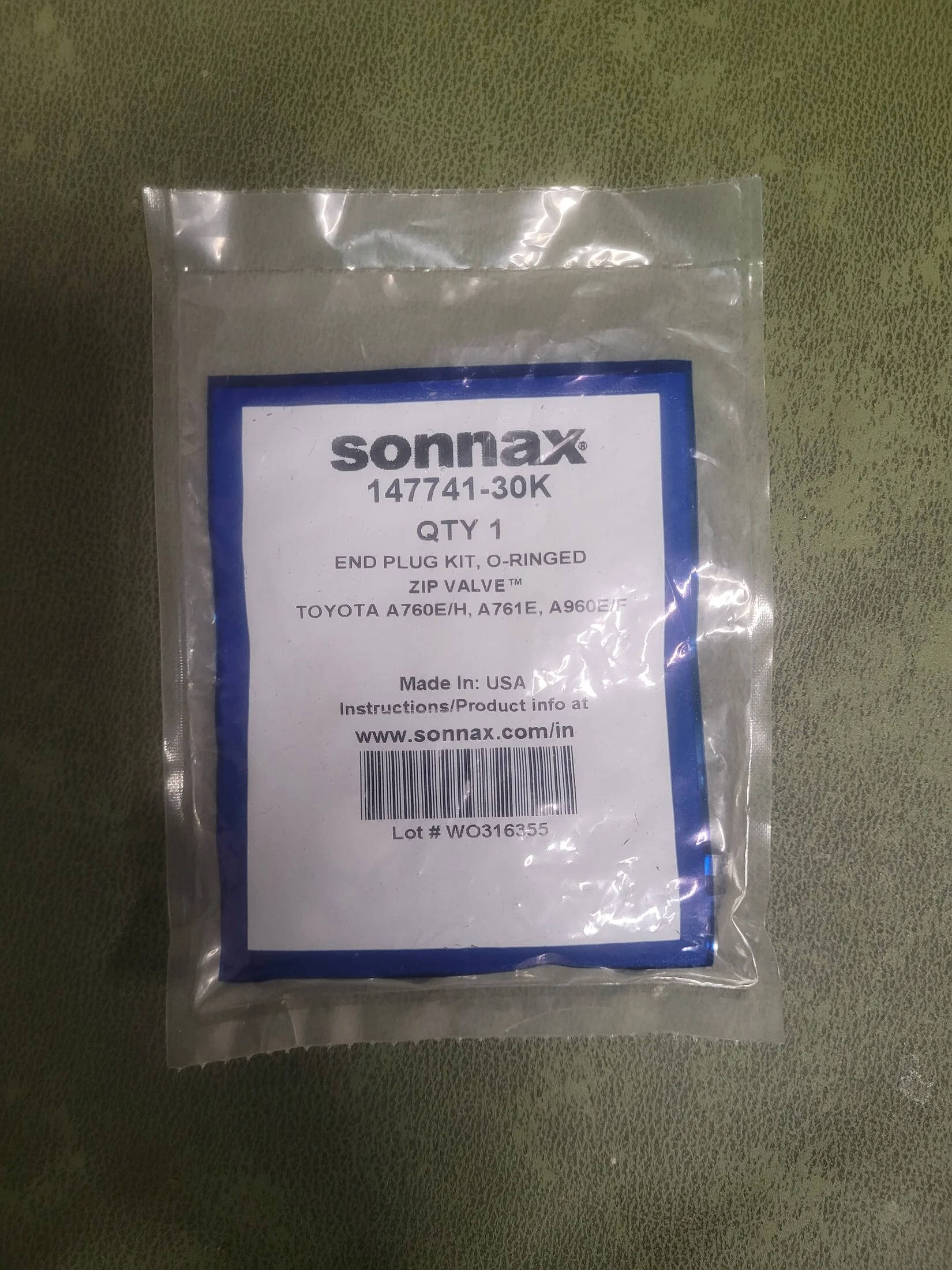

i bought the Sonnax kit from rockauto.com and it arrived last Friday. So what better Saturday activity than to pull the valve body and replace this plug?

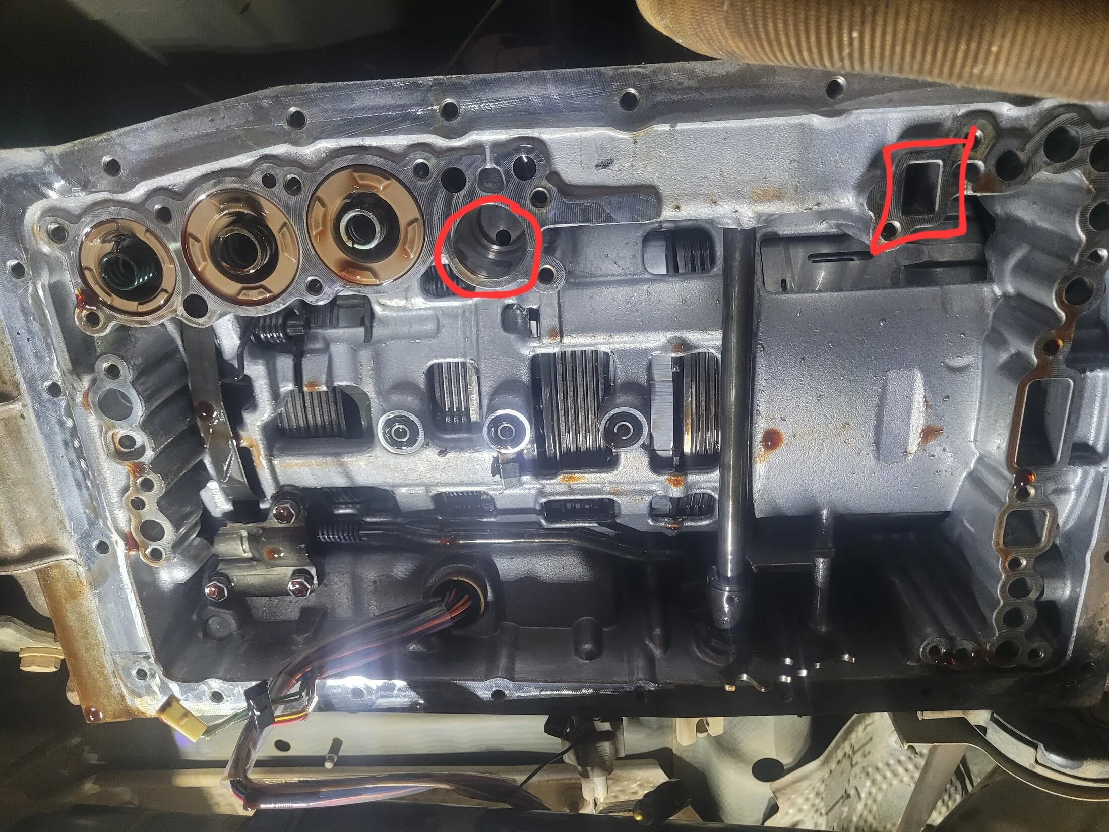

I started a little after lunch draining the transmission pan and pulling all of the bolts from the pan. Leaving me with a nice view of the shift solenoids and filter. All of these have been replaced in the past 10k miles and according to techstream are actuating how and when they are supposed to.
I pulled the bolts mounting the valve body to the inside of the transmission and laid them out in my pretty blue mat in the same orientation as they are in the transmission because these bolts have a few different lengths and my memory is short. I also went ahead and pulled the solenoid that the new plug goes behind.
When I removed the valvebody the actuator piston(circled) and check ball and spring(rectangle) feel out. These are not held in by anything but the actuator is a tight fit and will stay in place during re-assembly.

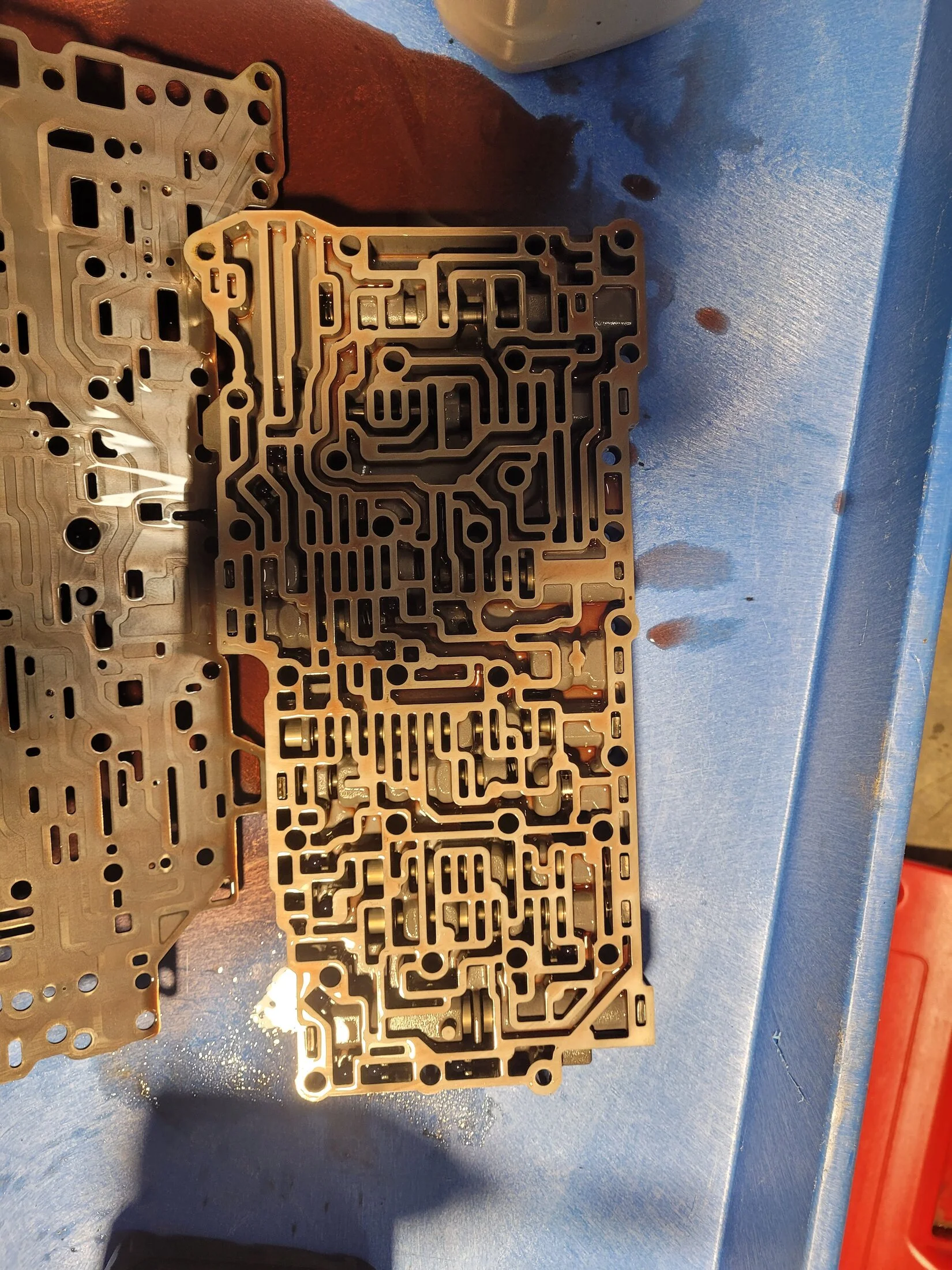

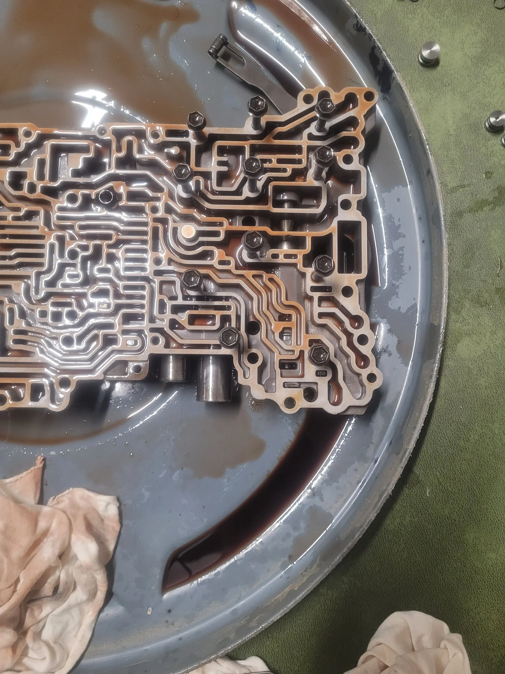

With the valve body out set it on a clean, contained space. I used a Rubbermaid trash can lid that has been washed and dried. It holds in the transmission fluid that is constantly leaking out of the valvebody, makes a nice catch tray for small pieces that might fall off, and it's large enough to hold the fully disassemble valvebody.

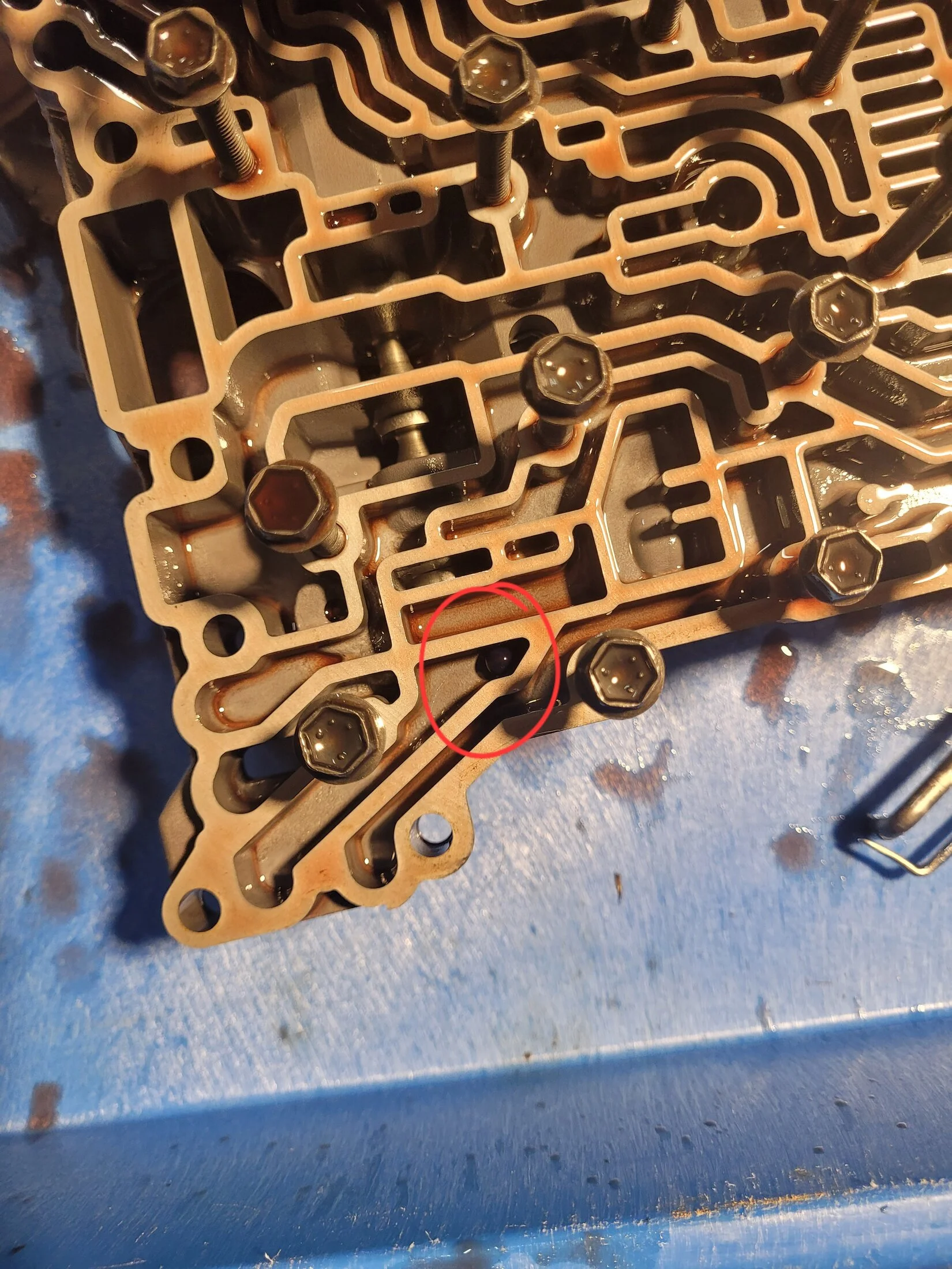

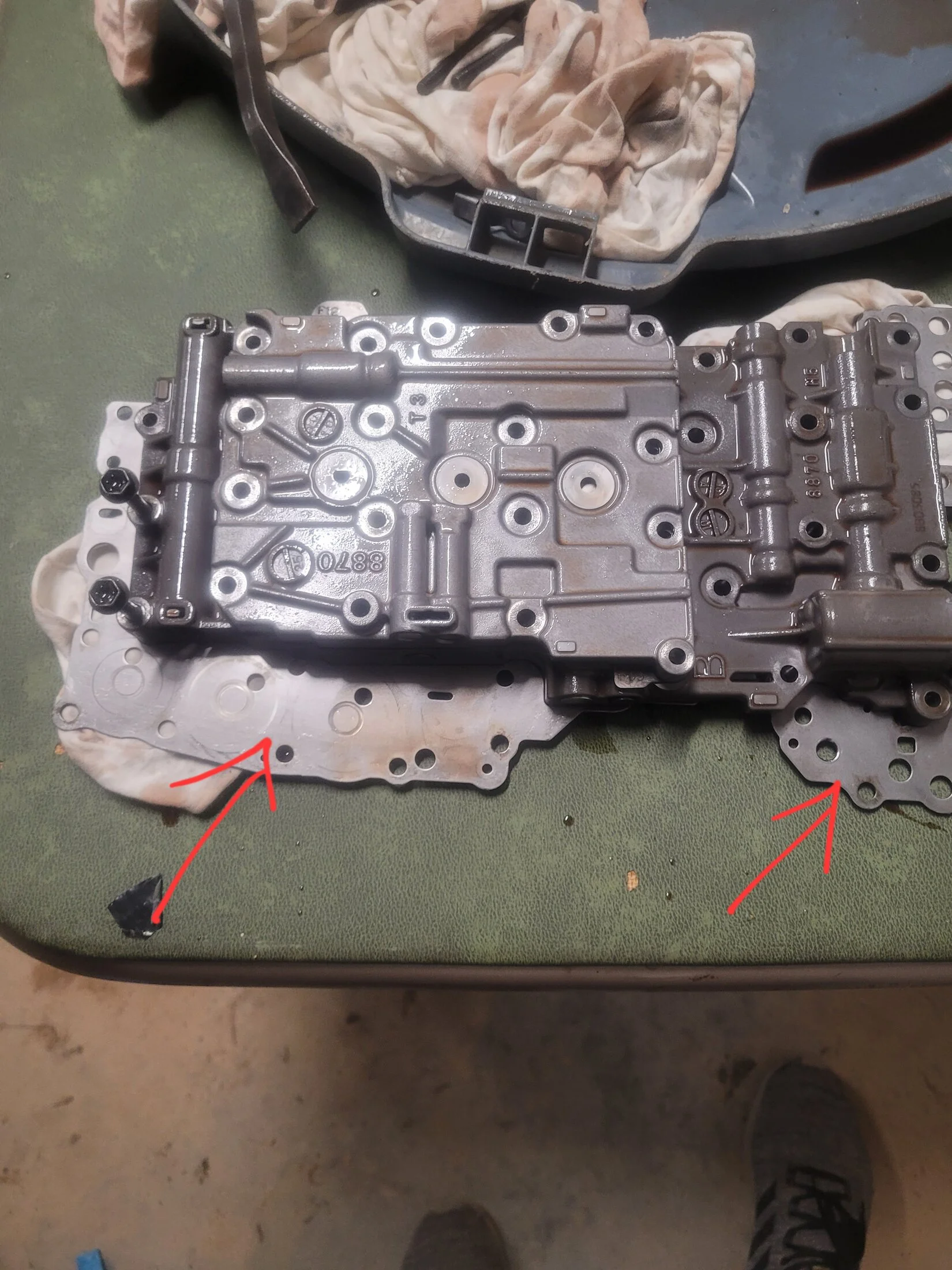

The valve body splits into 3 large pieces with a couple of plates, keeps, and detent balls between the pieces. Start removing all of the bolts so you can separate the pieces. Use the bottom plate(arrows) to pull the top half of the valve body off, if you don't you could lose detent balls and keeps.
When you separate the valvebody place the bolts into the base because they are all different lengths.

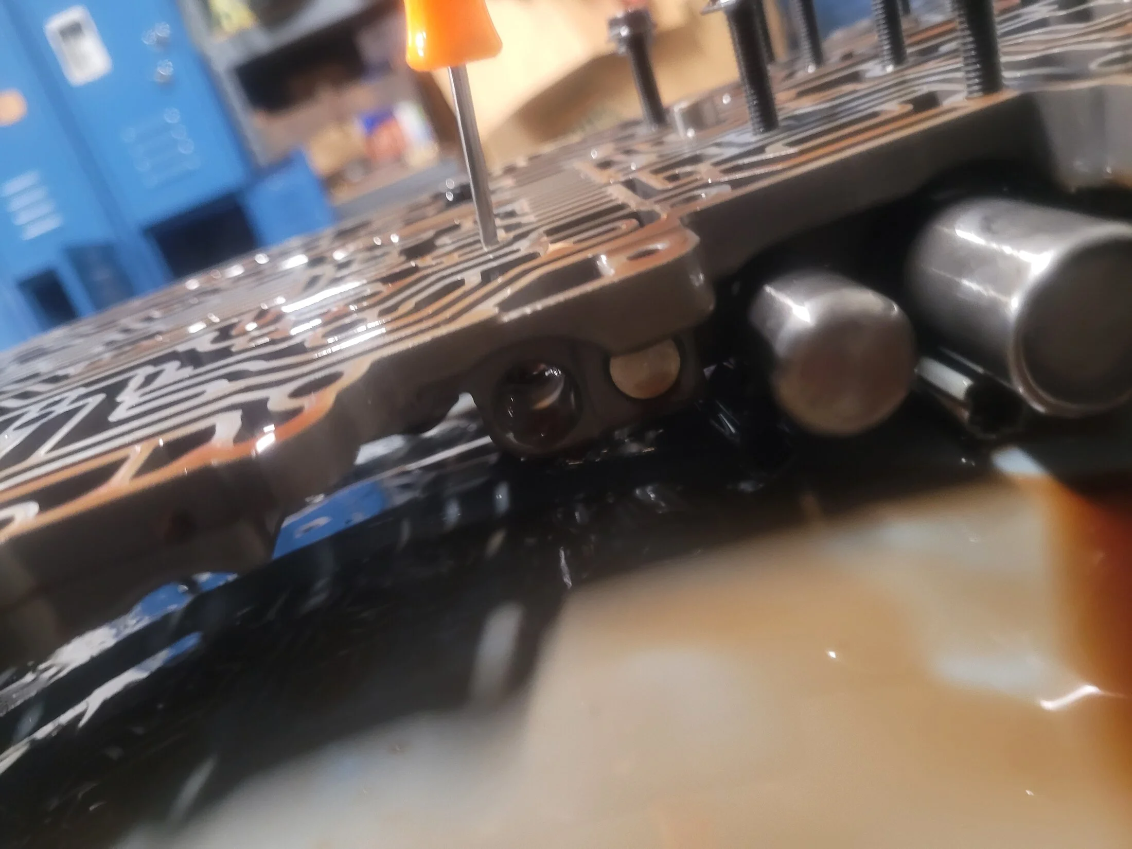

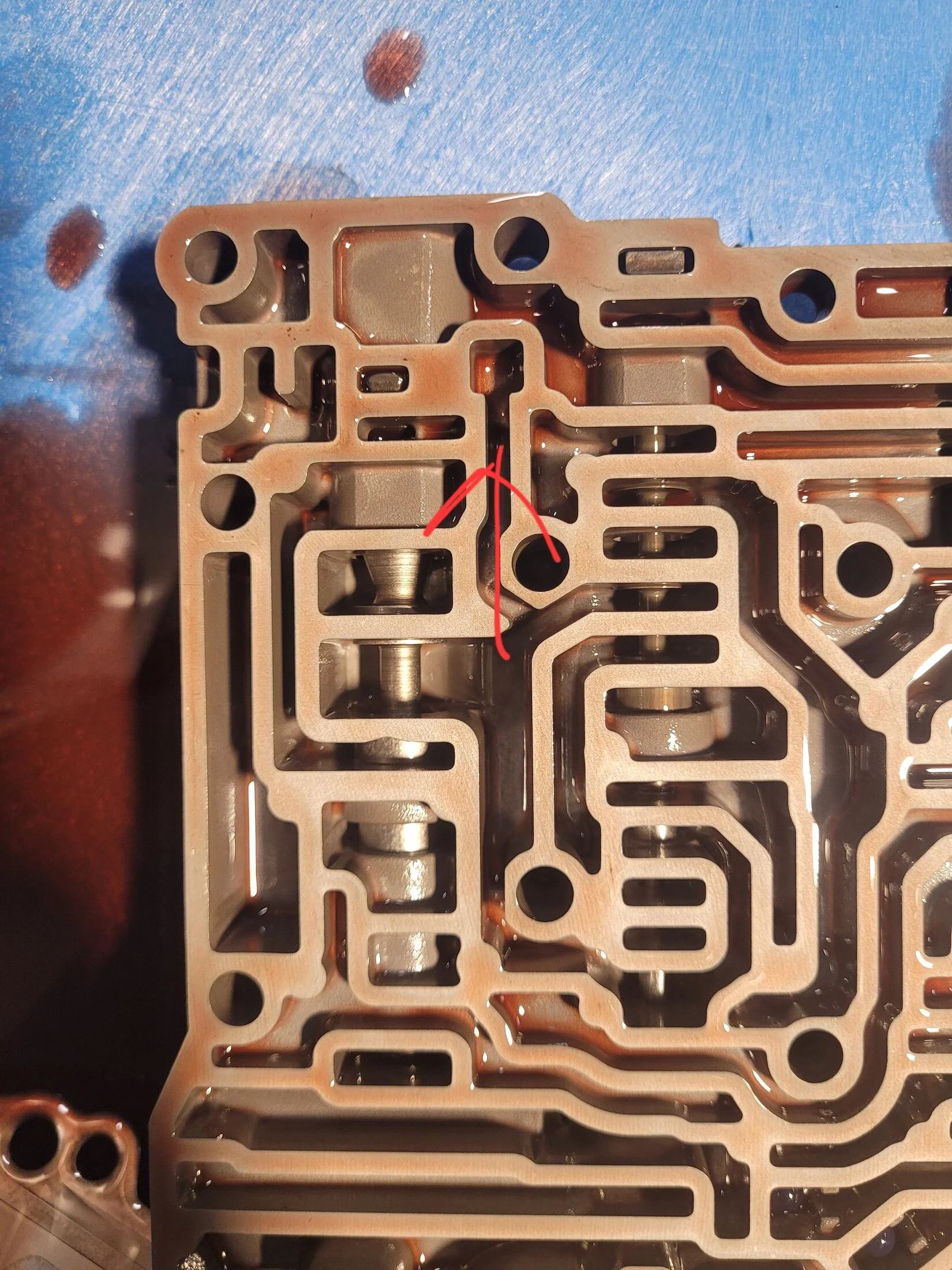

the keep that needs to be removed is pictures above, use a pick and magnet to remove it and slowly work the plug out with the pick.
Use lots of brake cleaner to clean your grime out of the valvebody, insert the new plug and the old keep, them reassemble. You will need about a gallon and a half of WS fluid to refill the transmission.
