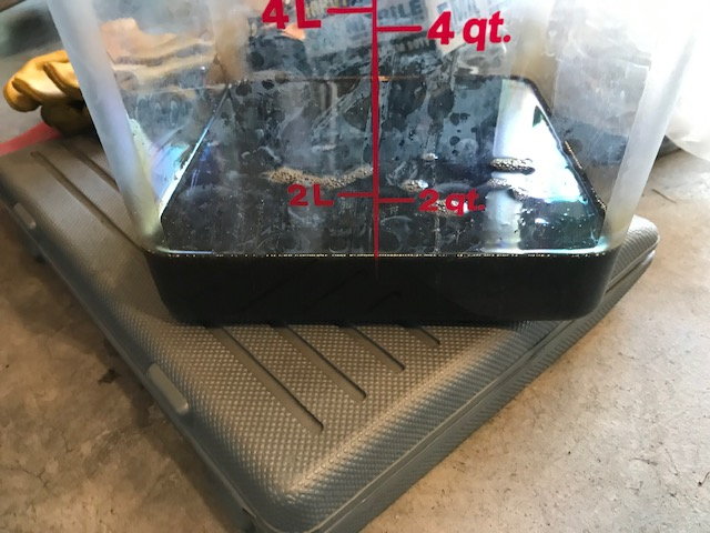

This was fluid on my ‘12 @ 55k miles back in ‘19… initial drain of many was actually just shy of 3 quarts. IIRC I was measuring out the drain as reason why it only shows about a quart here. Prior to my external AT cooler as well.
