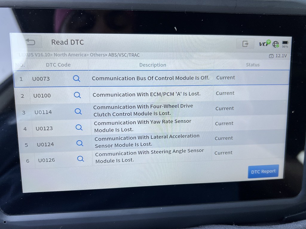

ABS and TCS lights again...
And the corresponding codes
Quick research shows it's probably the Yaw Rate Sensor, which lives in the center tunnel. Which... I've had apart at least 10 times. Guess I'll start there.
Have you done a zero point calibration on it? If its the same procedure on a GX as other Yotas its cake.
Edit: I guess those codes are not quite what out of spec would give, but more like the thing is unplugged..... Supposedly the hardly 'go bad'
Nope but I'll add that to the list of things to try if I get to that point
