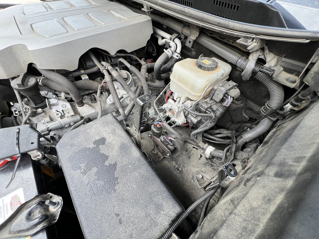

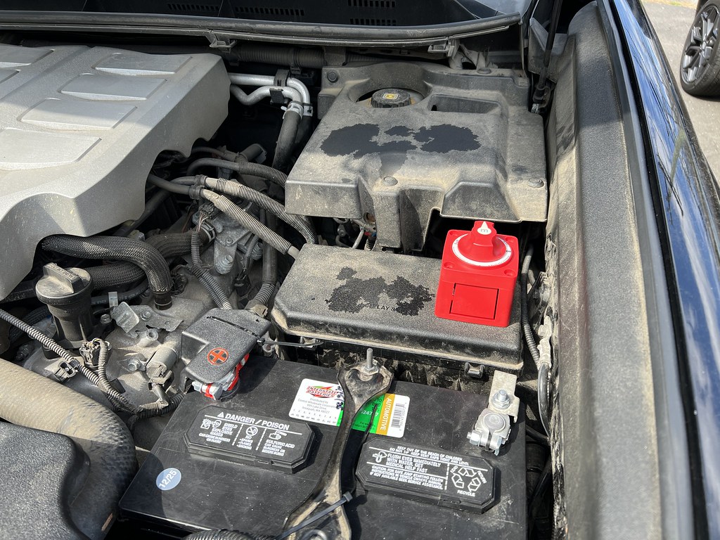

Is there any reason I can't / shouldn't mount the winch shutoff here, and also get rid of this plastic panel altogether?

Nope, that's what I've done. I mounted my air compressor using the power tray recommended on Jake's video above.

Shouldn't be a problem. I have my breaker switch mounted on it for my rear inverter and power panel. Have had it that way for years now.
Thats where I mounted mine. Kit bashing an lfd compressor mount. Just bought all yhe hardware and will get back with LFD about brackets to make it work with the rear heat.

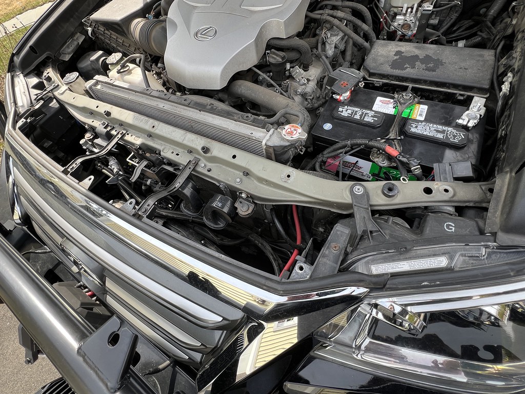

Thanks guys. Any issue driving without this engine bay shroud on for a few days? (The one that goes at the front of the hood by the grille)
Nope, just watch your temps. But should be fine. I have mine off for long periods of time.

I should also add that I cut an a cess for my radiator fill. I need to cut an access for the overflow. Once I remount the retro grill I will put it back on.

That cover is where I keep my air attachments for the compressor. I have clips to hold them in place.
