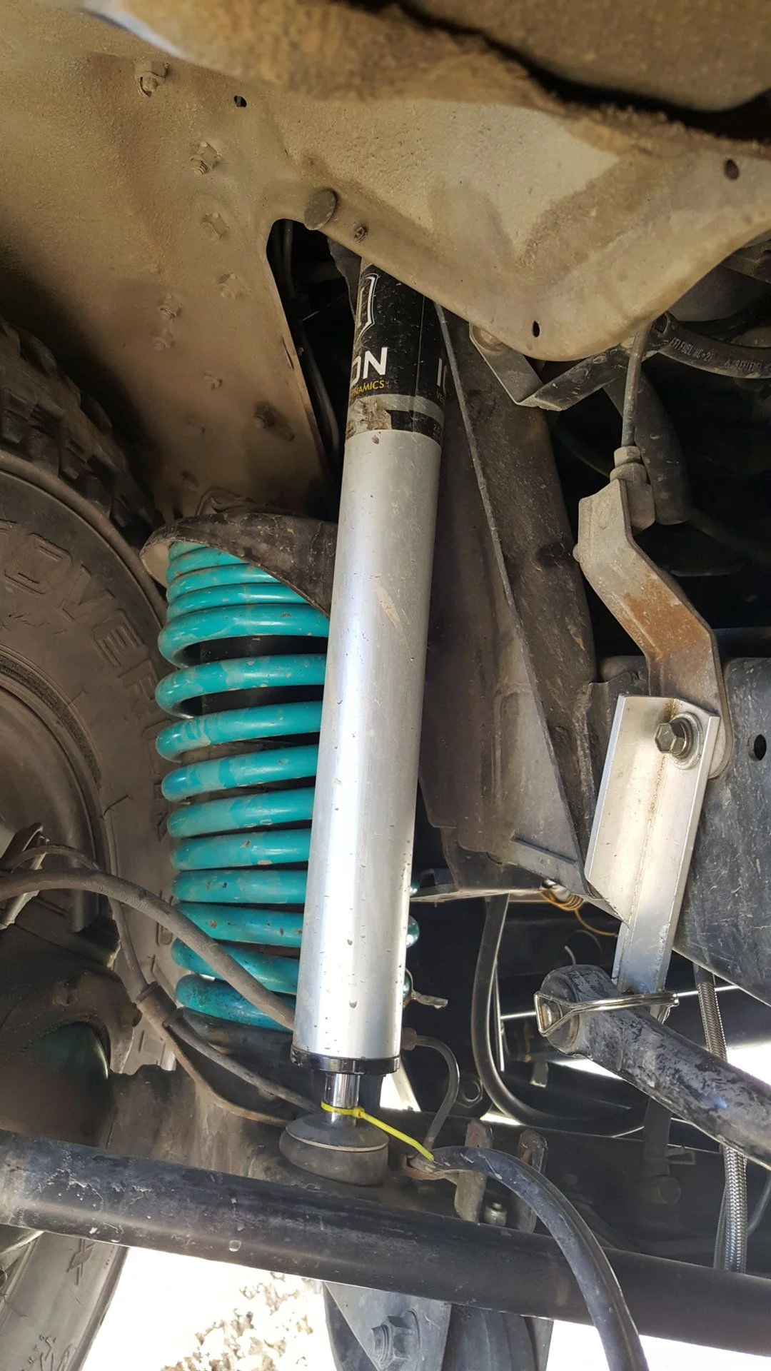

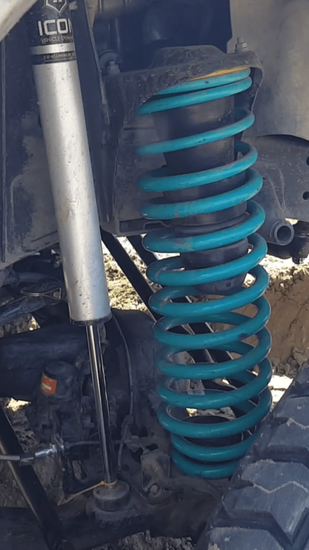

Tested a set of borrowed 2.5" Dobinson front coils. I like them, they are very plush off road, yet have good road manners.
They netted a 22.25" bottom of flare measurement which is about a 2.25" lift. I have about 200 extra pounds up front.
The feel of the 2.5" 140/220/290# tapered coils are a bit softer compared to my 3"/75mm 160/260# Slinky coils.
They give a more comfortable ride on & off road. The front coils flex a bit sooner with less force to the wheel (this is what I wanted).
Now the Slinky's do better going through rough terrain at faster speeds. Bombing runs is were the Slinky suspension shines the best.
Now also keep in mind that I'm comparing 2" suspension coil to 3" suspension coil.
I'm sure it best to compare the 3.5" tapered Dobinson to the 75mm slinky during bombing runs...
Enjoy the vid!

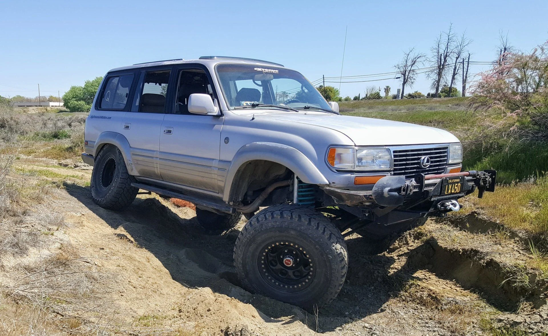

@David Otero

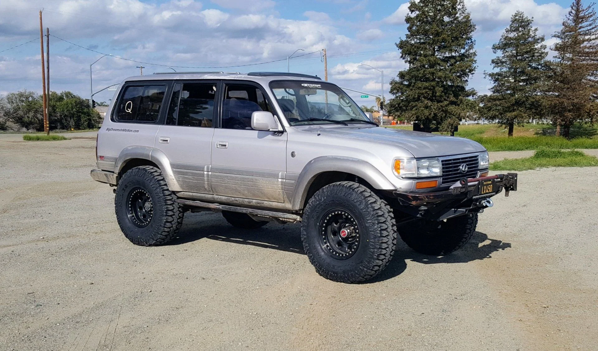

Got sum new digs...
Have about 20 miles on them.
78+45=123lbs​
Are you running the Icon 4"-6" (56511) shocks up front?
Yep, they are the Slinky valved Icon 56511 fronts & the OME Ls in the rear.
@GW Nugget how's the noise level with the 2.5'' dobinsons up front (as in any extra noises from them)? Do your top coils sit even front to back or do you get more squish on one side vs the other?
Any coils that touch or stack make springy sounds...
The video should show you how they stack.
I even moved the rig up & down to show how they move.

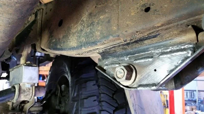

are those a 3" drop? If so, would you be interested in trying some with a 50mm drop instead? (they'd be weld-on, though)

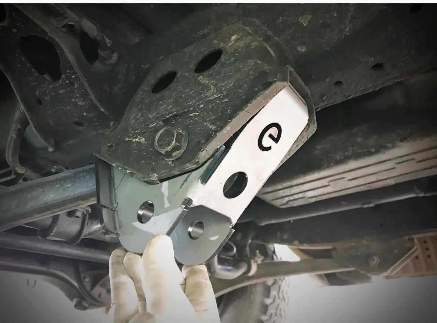

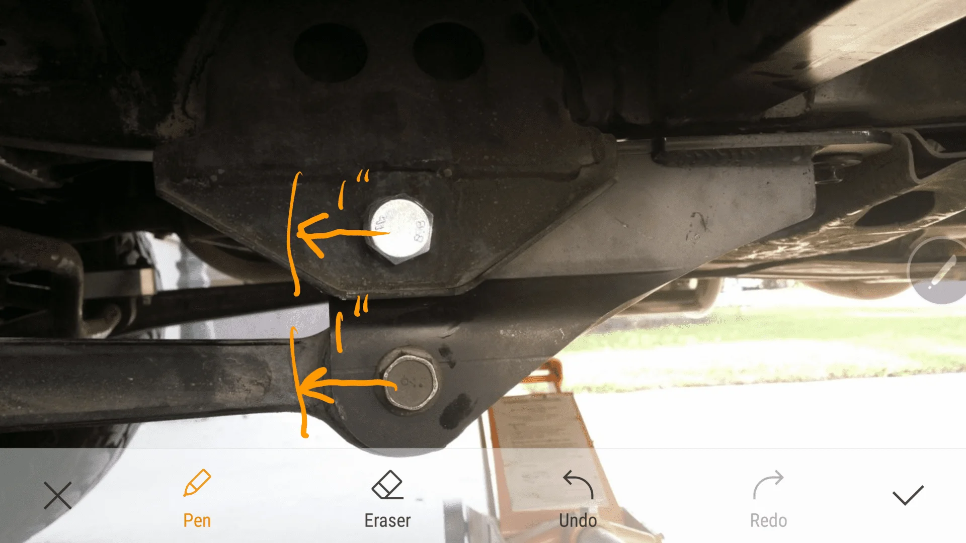

@brosky is trying to convince me into trying the eimkeith front control arm weld in frame mount bracket.
Drilling a 18mm hole 1" forward vs. a weld in bracket. :hmm:
I would have to drill a 18mm hole 1" forward on the frame mount like others have, but have the issue of moving the MAF brackets forward also.
@eimkeith how many of these have you sold?
I know the rear panhard weld in bracket is getting traction. @joez got his welded in.
I would also need to find a way to move the aft two 10mm crossmember bolts forward.​

I biffed it when I put these on the website last week - I didn't add the order page to the item menu, so no one could get to the order page. :facepalm:
I fixed it just this morning.
On the rear with a 50mm/2" lift, does this require one bracket on the axle only or is a frame side bracket required as well?
No need for the frame side bracket in that situation - toss it in the tool box (in case you need it later.)
