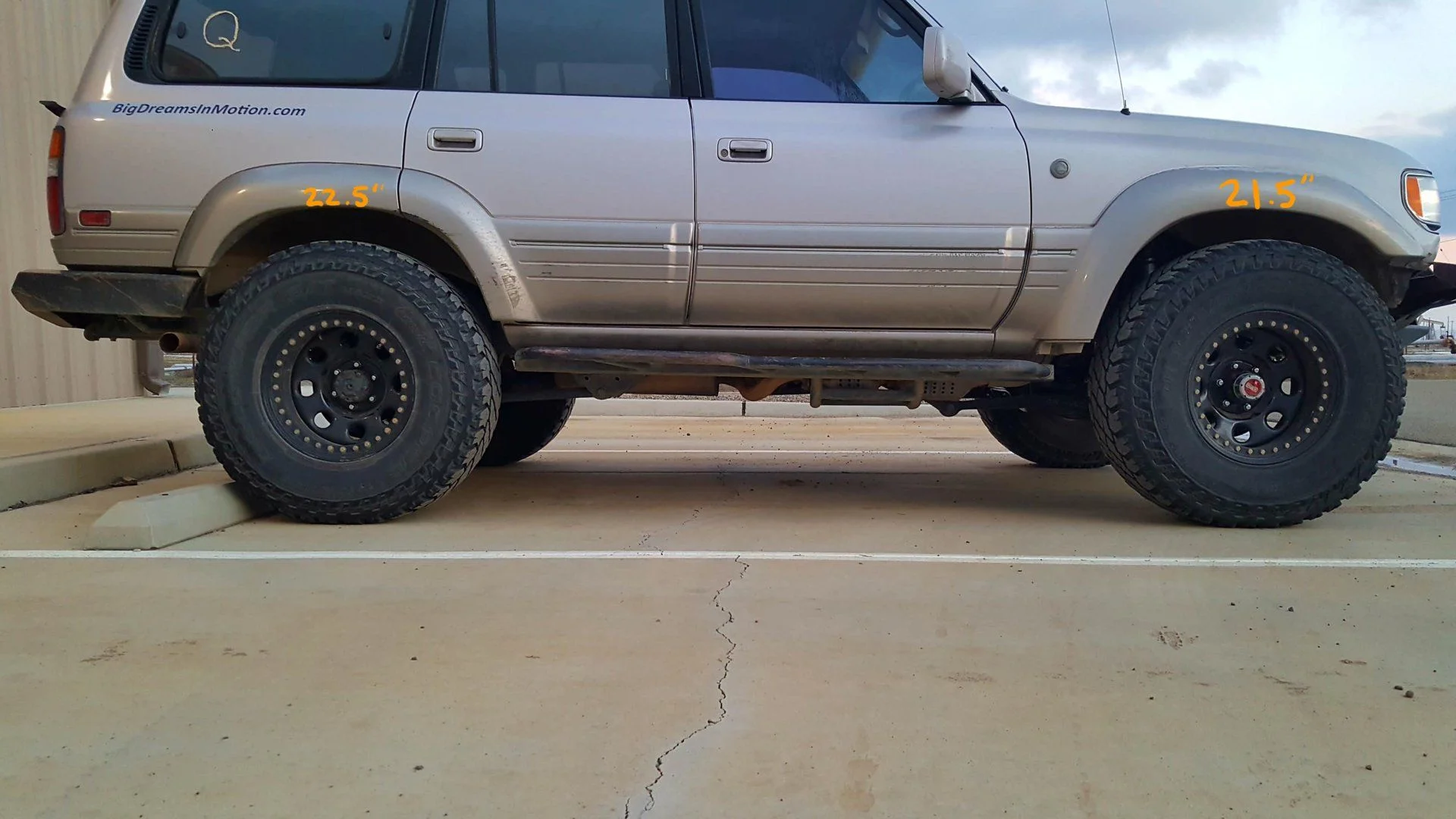

So at this time I have 2" of coils spacers on top of my stock Lx450 coils along with a new set of rear Tough Dog 1" lift coils.
It sits at 21.5" & 22.5" with fresh rear coils.

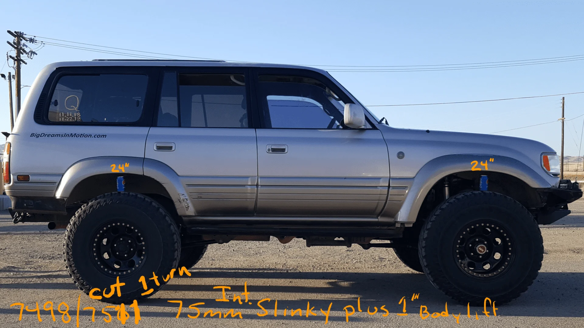

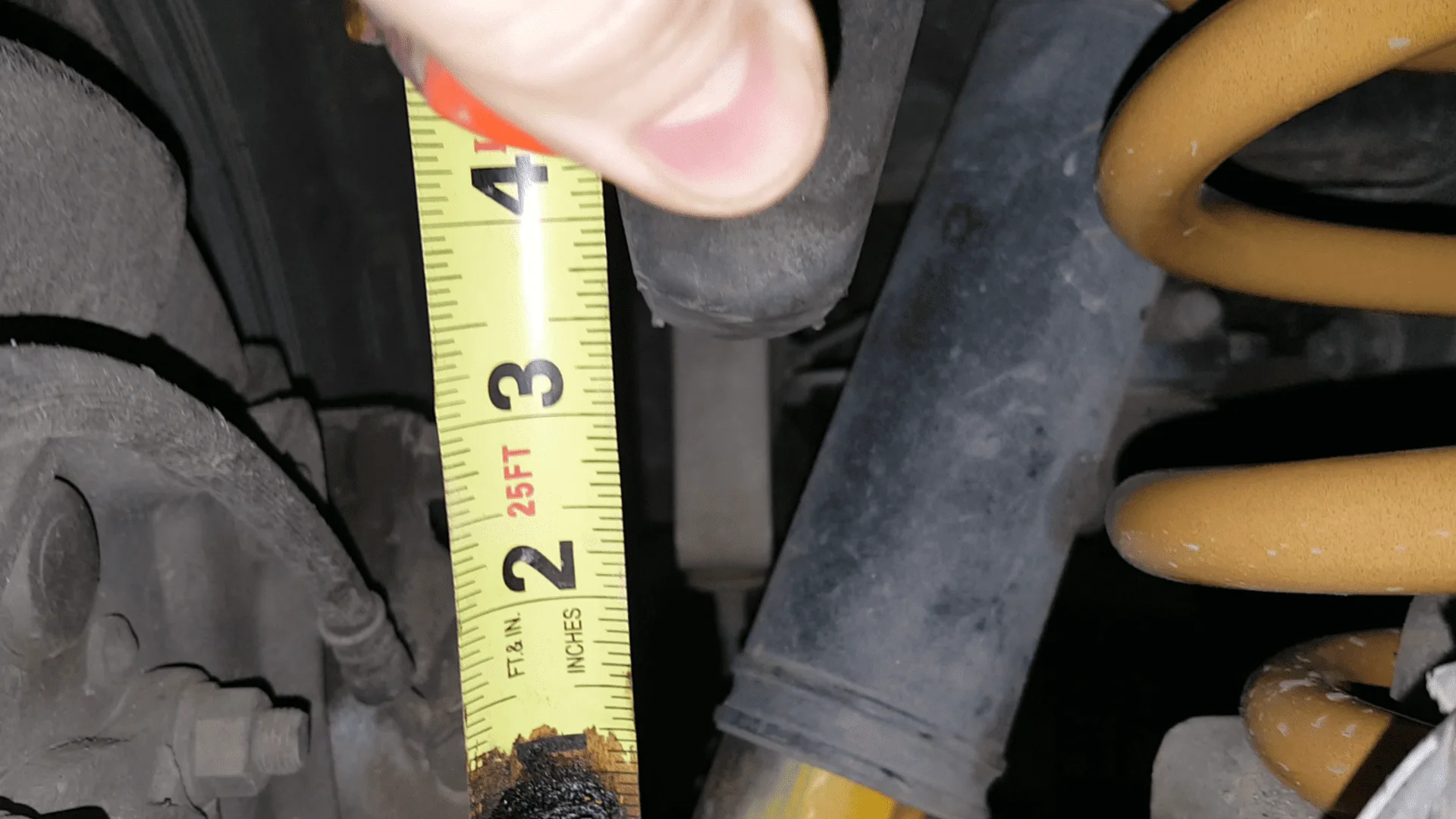

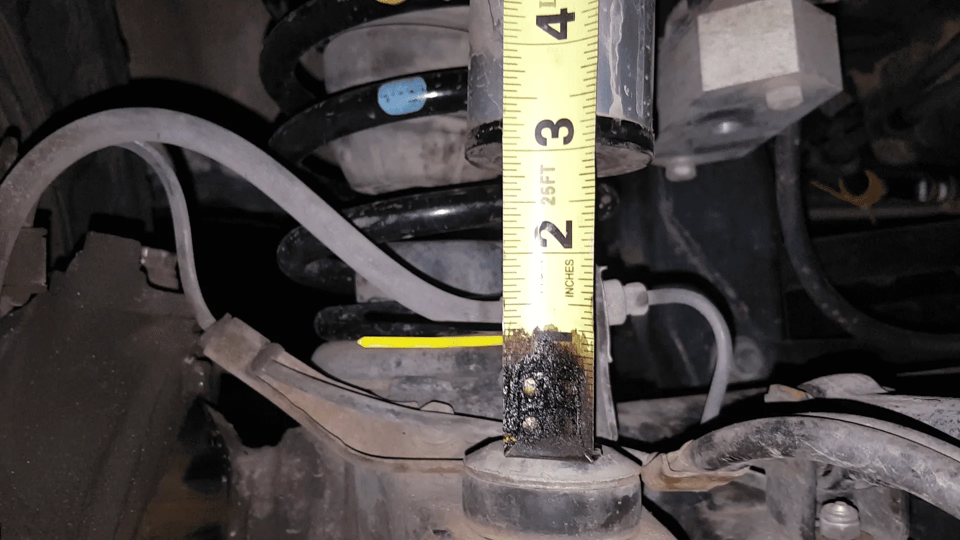

Just for reference with the 75mm Slinky & 1" body it was 24+- bottom of fender with 5.25" shock shaft travel in front with 1" bumpstop.
The rear was also 5.25" of bumpstop gap with 1.5" lowered frame bumpstops.
Now front uptravel is approx 3" & rear is 3.5".
With those numbers in hand doing the math I can achieve 4" of uptravel if I get to a 23" hub to flare measurement which is a 3" lift.

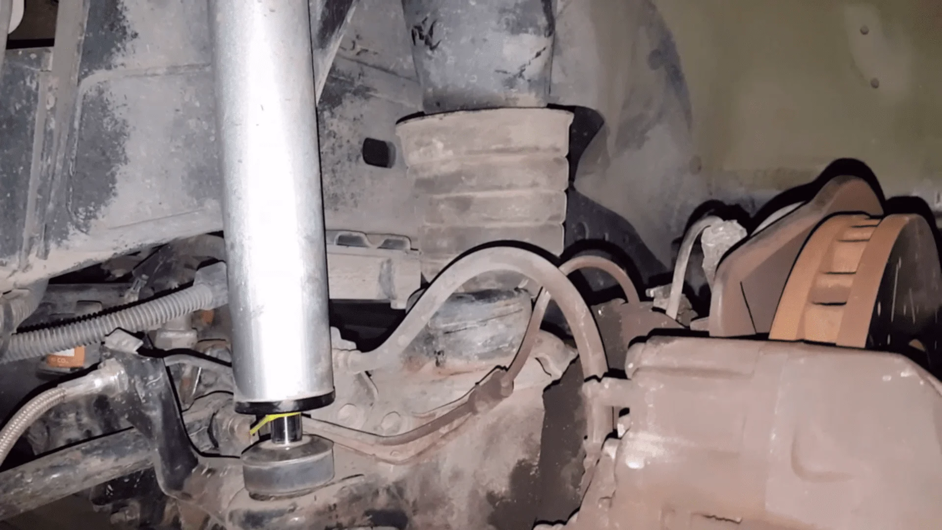

I went to my twist spot today to check the rear cone bumps up front out.
The rear coils settled down a bit & has less stinkbug.
Also to note I didnt think that my last measurements & pics was parked nose down in a angled parking spot.
It sits up .25" more on level ground in the front.
Here it is on level ground.
21.75" & 22.25"
The rear 1" Tough Dogs are exactly that 1" plus the 10mm packer is landing at 22.25"
I have a 37" tire, 42qt frig & approx. 200#s of junk in the back.
Im also testing out the rear cone bumps up front, it turns out they are exactly 1" taller than the stock units with vehicle weight on them.
And yes I will be rounding off, trimming off that edge lip that's sticking out... so no need to make comments about it.
Here is after test drive articulated & dropping off a 2 foot ledge a couple times. Its not much different is it?
