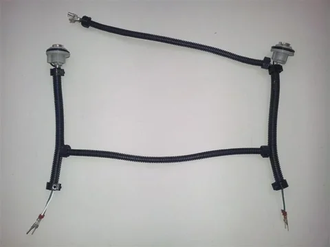

On the ARB harness front. Based on some discussions with Gary, I think the route we are going to take is that Gary will run the appropriate wires needed in every ARB harness so that the buyer can set up their ARB lights as markers, blinkers, or "disco". This will offer the flexibility for people to change up the ARB light function down the road if they desire. Owners will need to reuse the connector that came with the ARB light kit pigtail. I verified that yes, you can get the terminals out of the connector. It takes some persuasion to get them out but they do come out. Then you'll insert the appropriate terminals into the connector from Gary's harness, tape up the unused terminals, and plug in your ARB lights.
This is all pending testing but I believe it should work well, allow Gary to just make one ARB harness for all options (or maybe just make one harness going forward regardless), and offer buyers the flexibility of changing how the ARB lights function down the road as they see fit.
UPDATE on the ARB harness
Gary has a prototype ready to send me for testing and I should have it within a week or so. This harness incorporates terminals for the various ARB light connection options (marker, blinker, disco). Here is a picture (the ARB terminals are at the top):
My truck is getting some work done right now but as soon as I get it and the harness together I'll get everything hooked up and tested. I'll probably make some short videos even of the different ways folks can hook up their ARB lights so you can get an idea of what route you want to take, initially anyway :)
Sorry for the delay guys...My truck is still in the shop :frown:
I hope to get it back this week or early next and then it shouldn't take long to test the harness and post up.
So hopefully I'll post up some information before the end of the month and you guys that are waiting for the ARB version can start placing orders. Really the only question, assuming the harness works as expected, is to verify the length of the ARB pigtail. It needs to be long enough to reach the ARB lights and offer the owner the ability to swap what terminals go into the ARB connector down the road. I had Gary build the prototype longer than I believe will be necessary but we'll see.
