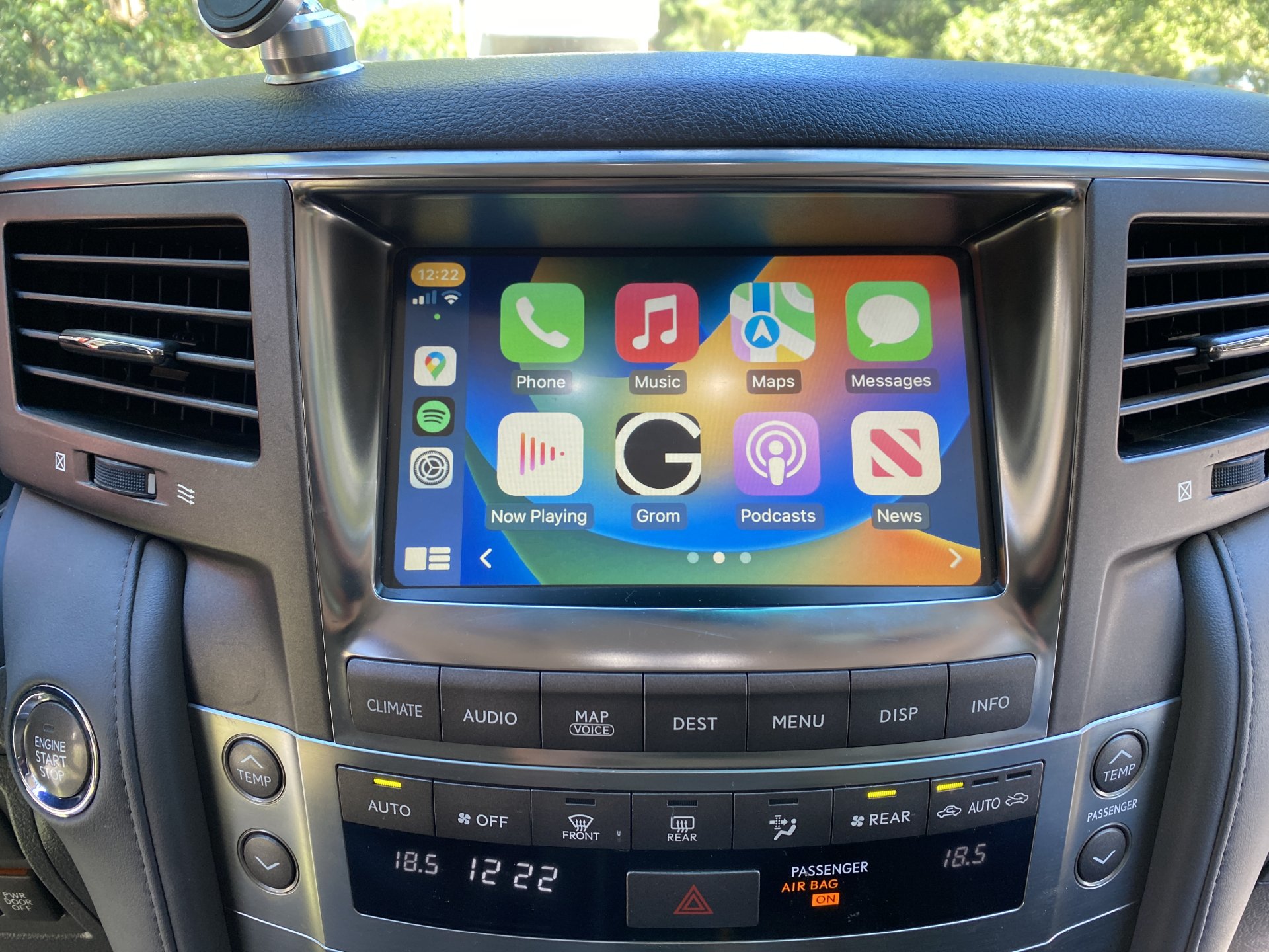

How do you feel about the resolution on your 2010 with the GROM? I have a 2011. I had a GROM in a 2006 GX and sent it back bc it looked like 8bit Nintendo. Any pics or video?
Can the RES still be used while using the Grom?? Kids in the back need entertainment and I need navigation and Amazon music…
I have an 08 and resolution is fine. Not being able to tap and drag is way more of a limitation than the screen resolution.
So you have to hit the arrows to move to the next screen? Not a big deal for me bc 8 apps should cover me.
Yea it’s fine most of the time but some Android native apps like Gaia are useless without multitouch.
so GROM has an open ticket about looking into adding swipe feature to Carplay.
They had initially replied to my question that our OEM screens were no optimized for swipe gestures which makes sense.
so they didn't allow swipe in carplay
in android mode it can swipe but I fine it to be kinda bad....
but I'd like the option of swipe or arrows
But I sent them videos of EC Offroad units allowing for swipe in carplay so I think they are working on it.
Maybe if you guys also email regarding this feature they will work on it quicker
